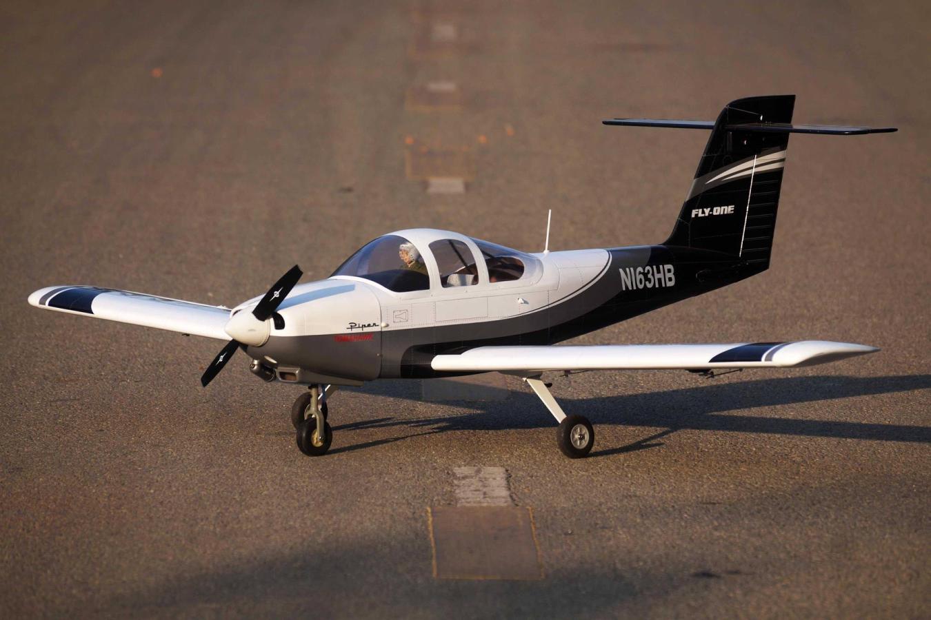

    The PA-38 Tomahawk is a two-seater, low-wing cantilever monoplane boasting a T-tail and enclosed cabin. Boasting a fixed tricycle landing gear, it is powered by a Lycoming O-235 four-cylinder piston engine, along with a twin-bladed tractor propeller. With two front-hinged doors for easy cabin access, the Tomahawk was Piper's response to creating an affordable two-place trainer. Before designing the aircraft, Piper closely collaborated with flight instructors on the design, who requested a more spinnable aircraft, as current two-place trainers were designed to fly out of a spin without pilot input. The NASA GA(W)-1 Whitcomb airfoil solves this problem, requiring specific pilot input for spin recovery, allowing pilots to develop their spin-recovery skills.
    The Nexa PA-38 Tomahawk is a .25 size electric scale series civilian trainer aircraft with a 1860mm wingspan, constructed primarily from balsa wood. This ARF requires assembly and installation of your choice of servos and power system, and includes two piece wing with aluminum wing joiner, fiberglass cowl and spinner. A large battery tray provides ample space for any size battery you require.
    Features:
    • Complete Balsa and lite-ply construction for rigidity and durability
    • Two piece wing with aluminum wing joiner for easy transport
    • Large battery tray provides ample space for any size battery you require
    • Functional cabin door and well appointed throughout
    • Fiberglass cowling and spinner for strength and durability
    • All control surfaces come out of the box pre-hinged and installed for convenience

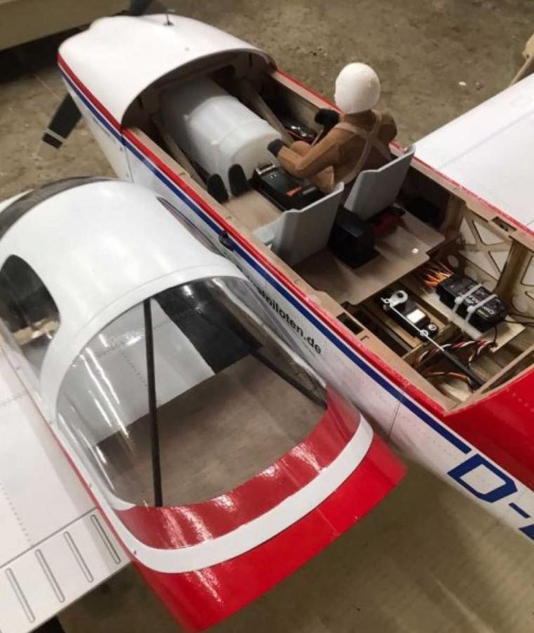

      Any pictures of battery hatch access?plane looks nice just need to see battery access
        • 8228
        Here you go!
        Click image for larger version  Name:	Capture.jpg Views:	0 Size:	75.8 KB ID:	392621

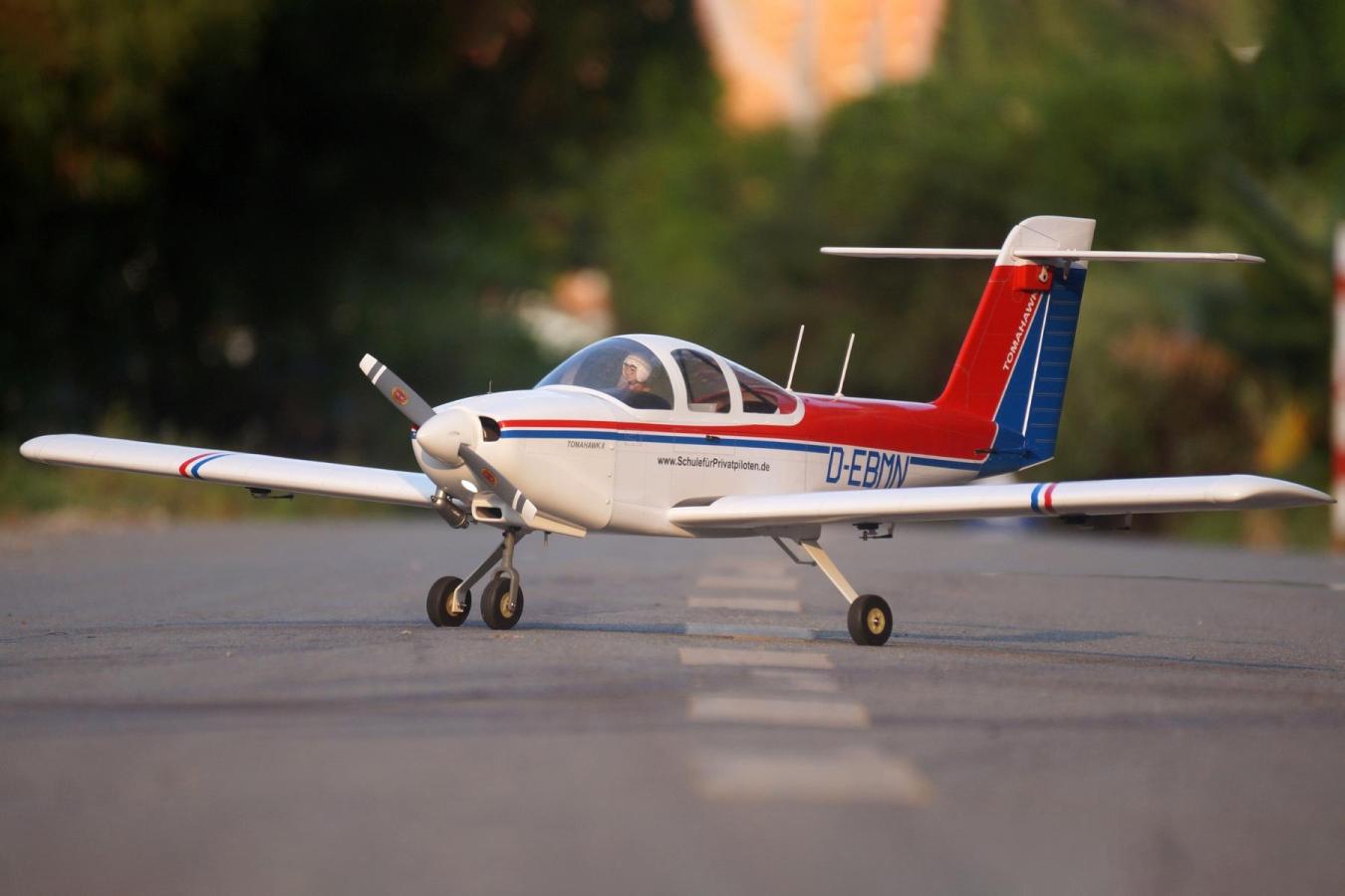

                            I changed out the pilot, changed the wheels and added chrome spinner. I used the right size servos that fit. I have not maiden yet.
                            • jlsmith54
                              • Apr 2024
                              • 4
                              Piper PA-38 Tomahawk waiting on weather to maiden

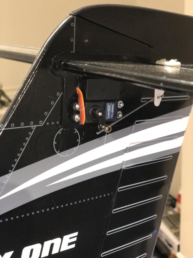

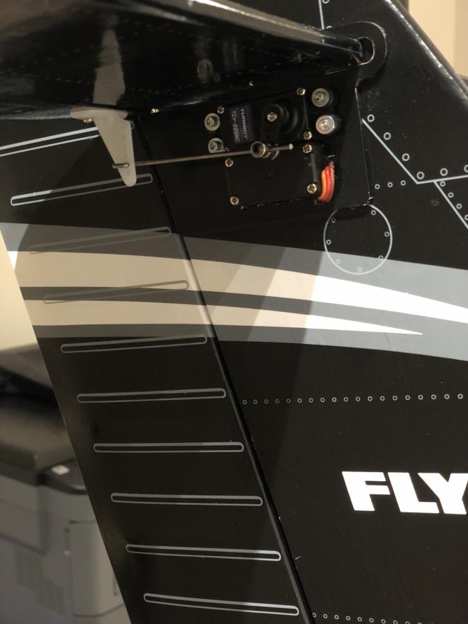

                                      Can someone please post some pics of how they installed the elevator servos (HS-225MG) in the tail while managing to hide the wiring? Unfortunately, the installation manual is extremely poor in providing sufficient details.
                                      • waterboy007
                                        • May 2024
                                        • 3
                                        #20
                                        I was able to get the servo installation sorted out. This may not be the best way to install the servos, however this solution does work.
