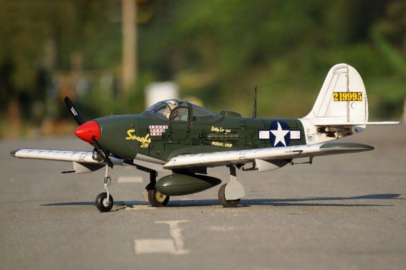

    P-39 Airacobra 1580mm (62.2") Wingspan - ARF from Nexa - NXA1064-001
    Click image for larger version  Name:	master.jpg Views:	102 Size:	96.5 KB ID:	392113
    The Nexa P-39 Airacobra is a 1580mm (62.2") wingspan ARF replica of the Bell Aircraft fighter used by the United States and Soviet Air Force during WWII. It was one of the principal American fighters in service when the United States entered combat. The P-39 was used by the Soviet Air Force, and enabled individual Soviet pilots to collect the highest number of kills attributed to any U.S. fighter type flown by any air force in any conflict. Constructed with high-quality, precision-cut materials, this aircraft is sure to offer consistent and reliable performance in the air.
    The P-39 Airacobra is a .50 size electric or gas option scale series warbird with a 1580mm wingspan, constructed primarily from balsa wood and covered with a fuel-resistant covering. This ARF requires assembly and installation of your choice of servos and power system, and includes flaps, painted pilot, machine guns, antenna and other scale details. The large battery hatch affords ample room for either electric or gas setups. Impress at your flying field with this iconic stunner!

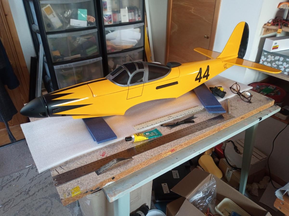

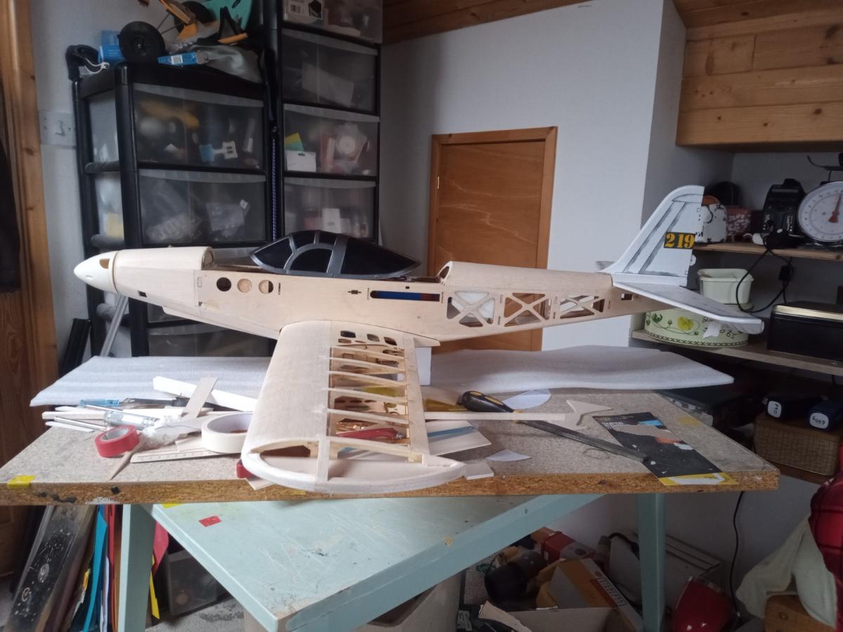

        Flew well until a couple of months ago when I lost orientation and spun into the ground, broke the wings in 2 destroyed the wing tips, disintegrated the engine cowl, split the fuselage and broke the tail off. Whilst I was stripping out all the part for a use on my VQ Yak 9 I decided to rebuild it as a racing cobra 1400mm wingspan, rebuilt balsa nose and I am part way through the rebuild. I will post photos when finished. Scheme is roughly based on a 1946 yellow and black Cobra 2 Racer https://www.aerialvisuals.ca/Airfram...p?Serial=86812
Name:	Airacobra rebuild photo 2.jpg
Name:	Airacobra build photo 6.jpg

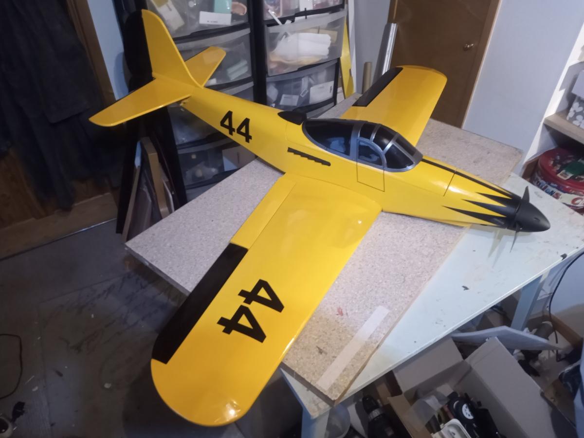

          Just about finished the rebuild, just need to set up servos etc
Name:	Airacobra rebuild photo 7.jpg

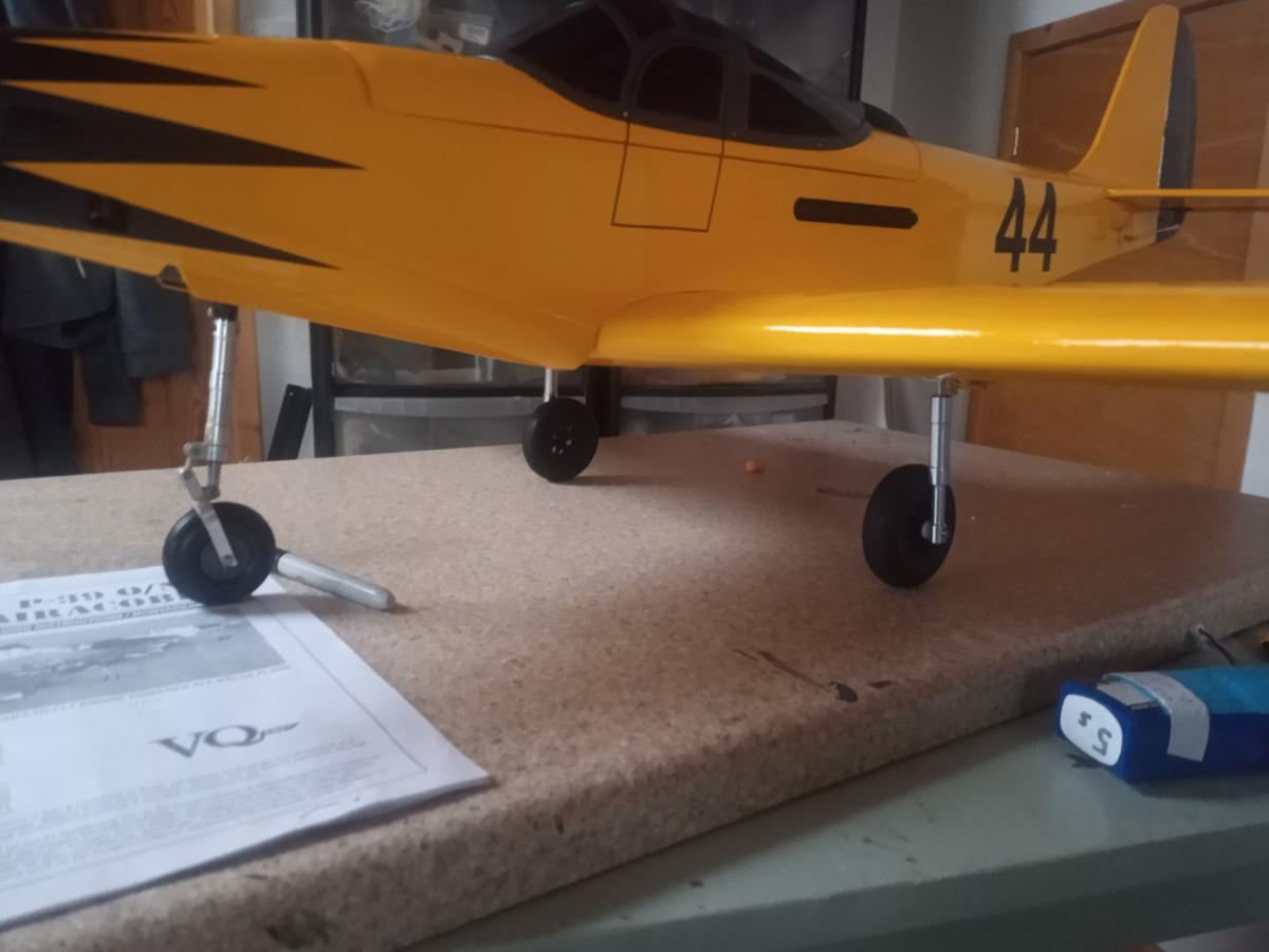

              No rotating, you are better off getting the kit and deciding where to go from there so that you can allow for choice of electric retract, pin sizes, oleos etc to suit yourself. I used substantial mains with 5mm pins, overall length of oleo and wheel 120 to 125mm nose wheel 4mm pin overall length of oleo and wheel 145mm. Look through Motion r.c. retracts, servos and oleos and you should be able to find gear to suit. I set the model on a flat level surface with tail near horizontal and measured down to suit. Manual states flying weight at 2500gms, but you are probably going to be closer to 2900gms with 4000mah 5s setup.
Name:	Airacobra retracts photo.jpg

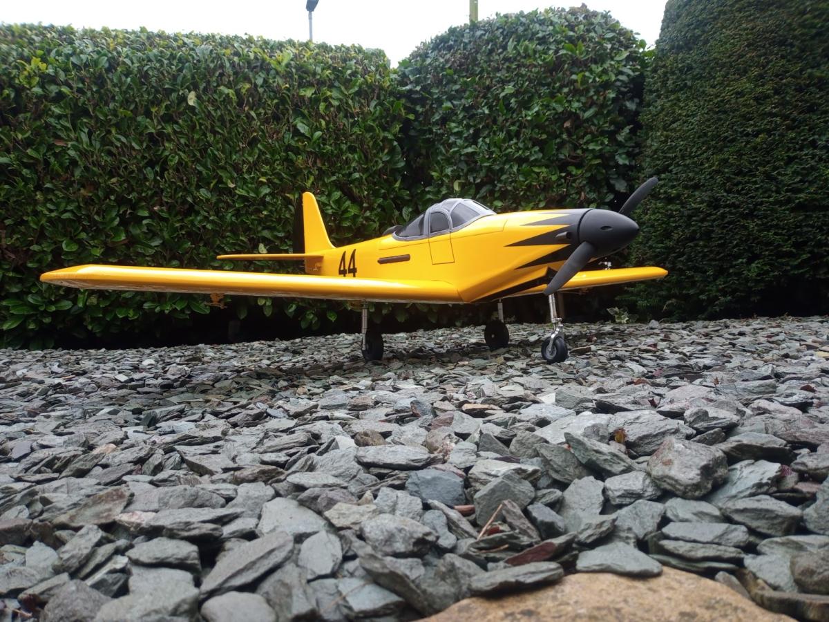

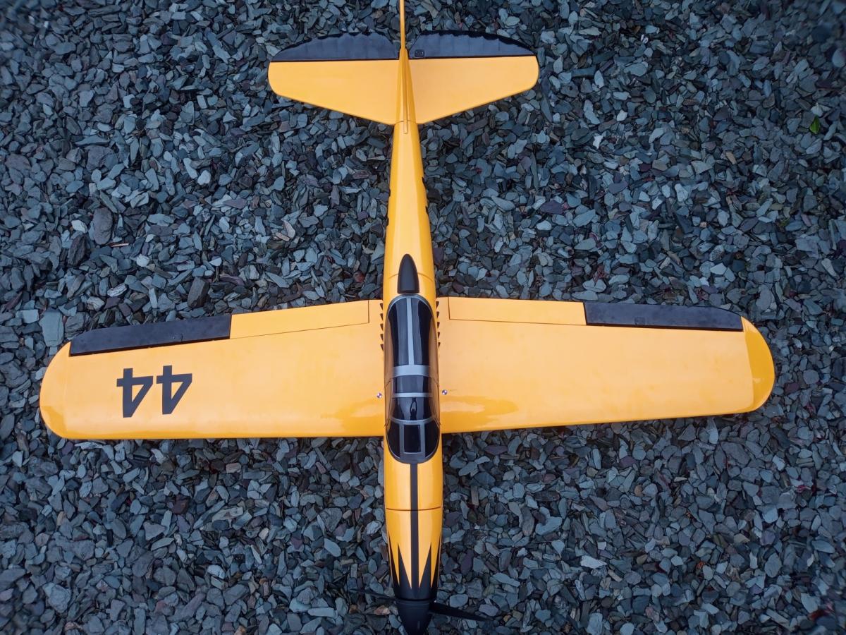

                          I have now finished my rebuild and I am awaiting good weather to fly ,
Name:	Airacobra rebuild photo 11.jpg
Name:	Airacobra rebuild photo 12.jpg
