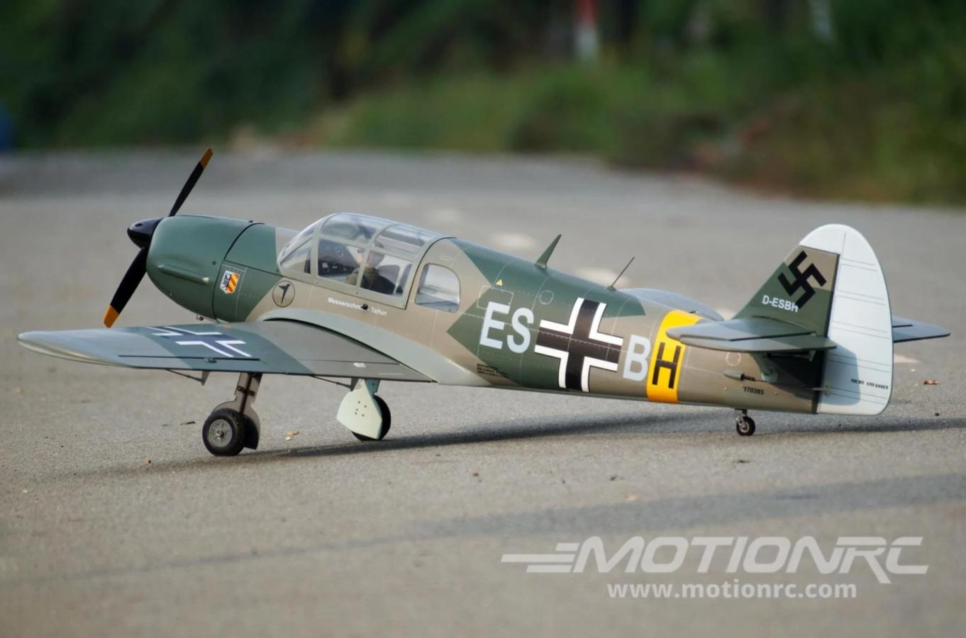

    BF-108 Taifun Camo 1625mm (64") Wingspan - ARF from Nexa - NXA1068-001
    Step back in time with this beautifully detailed model of the BF-108, meticulously crafted to mirror its full-sized counterpart. With a high-quality printed covering that replicates the authentic markings of the original aircraft, this model offers an exceptional level of realism for scale enthusiasts.
    Whether you prefer electric, gas, or glow power, the Nexa BF-108 provides versatile engine support to suit your flying style. For electric setups, the large battery hatch makes quick battery changes at the field a breeze. Plus, with optional retractable landing gear, you can add a whole new level of fun and excitement to your flights.
    The precision laser-cut balsa and light ply construction ensures both strength and reduced weight, giving you smooth, agile performance. This model’s convenient design also allows for fast assembly and disassembly, making transportation and field setup quick and hassle-free.
    A rare gem in the world of scale RC planes, the BF-108 stands out as a unique and captivating choice for anyone looking to add something special to their collection.

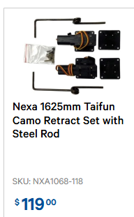

      Does anyone know what retracts to use with this model?
      • #4

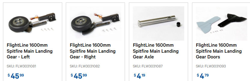

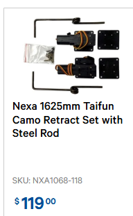

        The suggested retracts are pretty poor. They do not fit well and have no shock absorption capability. After buying a set for over $120 and reallizing the same set was sold by others for less than $40 I was pretty disgusted with them. They are totally inadequate for this plane.
        I discarded them an bought the retracts for the 1600mm Spitfire which includes the doors, wheels and metal hubs. They also have compression struts. All in all a far superior product, at lower cost. The are not a perfect fit, they require some tweaking. The wheel well openings have to be enlarged and the gear doors needed to be heated and taped down while cooling to conform to the shape of the wing. They do not go all the way inside the wheel well leaving about 1/8" up at the far edge of the wheel well opening. I can live with that.
