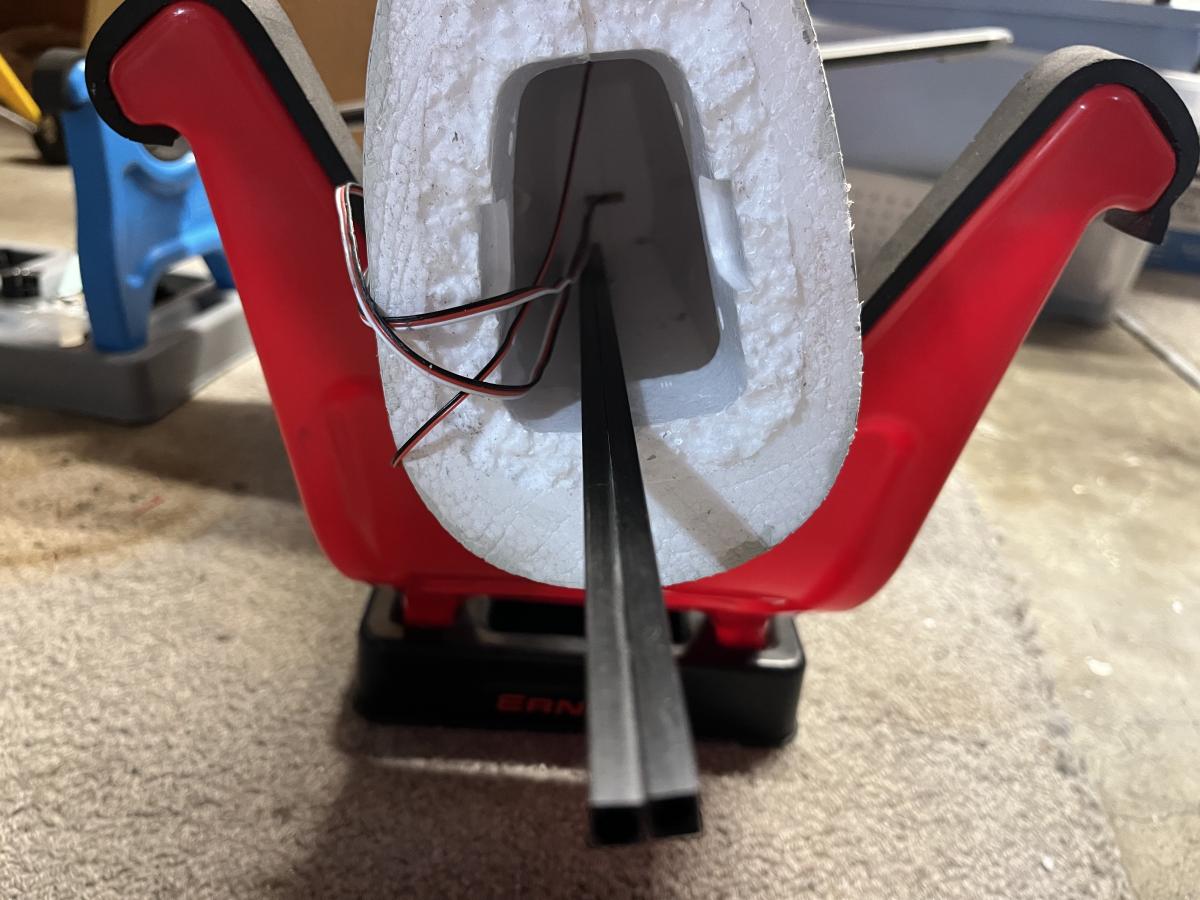

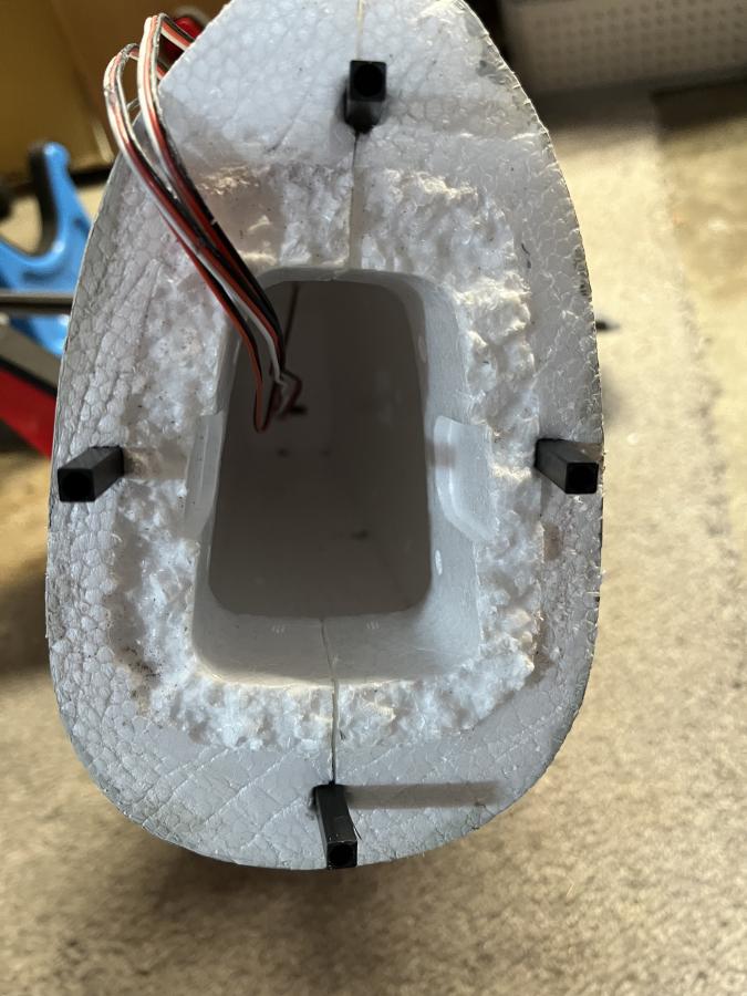

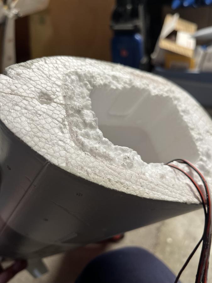

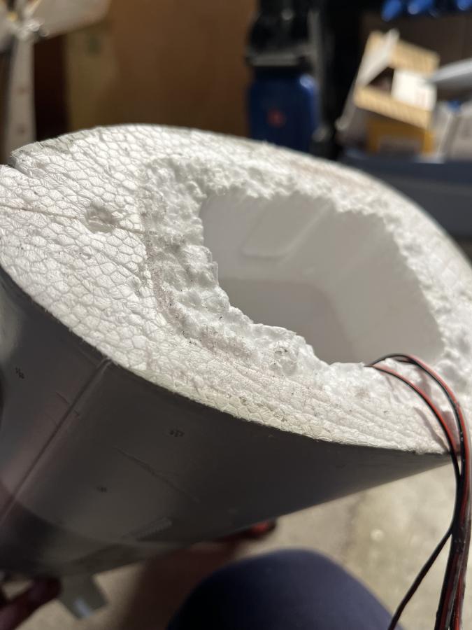

ID:	423533 Hey all,
        I have some info to share. I was asked by some YT influencers to post this. This is specific to Avios Super Tucano.
        Last weekend while flying that lovely bird.. I was practicing touch and go’s at a new field to get my muscle memory for landing.. well on my last approach I came in too shallow and some of the taller grass which surrounds the asphalt runway caught the Tucano and it dropped straight down about 2 feet and plopped onto the ground, as it hit the Fuse/Tail sections (where they meet and our glued) broke on me. When I say broke.. I mean the male/female foam that joins the 2 halves were still epoxied together. It clean snapped all around it (see pics).
        so after several chats with some more senior foam repair pilots in our club and online.. I got some very good ideas on how to repair this tragedy (can you tell I LOVE this bird).
        To that end, I proceed to round up all the bits needed to make her flyable again.. and not just flyable but better than the original design (why is the beginning of the 6 million dollar man running thru me now).
        I ordered square tube carbon fiber, 5 min starbond epoxy to do the job.
        As you can see by the pics I took 1 piece of the CF rod and cut into 4 equal 1” lengths and used those as my placement markers for both sides. Put them where I believed would give me the best success at strength and thick enough for the rods to fit on both sides.
        of note. The one CF rod at the top center faces the cockpit mount point, so you have about 2 1/2” from the break to where the foam runs out before the cockpit installs.
        i marked that particular so I knew how deep I could go.
        the other 3 CF rods I split 50/50 to take the stresses.
        placed all the rods at the best places as already aligned by the short pieces used earlier (see photos).
        Then I did a trial fitment to verify it all aligned.
        Final piece is to disassemble it all, mix the epoxy up, syringe it into the previously made CF square holes. Sand all sides of the CF rods and Paint brush all 4 of them with the epoxy and press it all together. Make sure any drips/runs can be wiped off asap.
        I’m going to let this all full cure (24 hours) and take her out for basically a new maiden.
        Let me know if you have any questions.

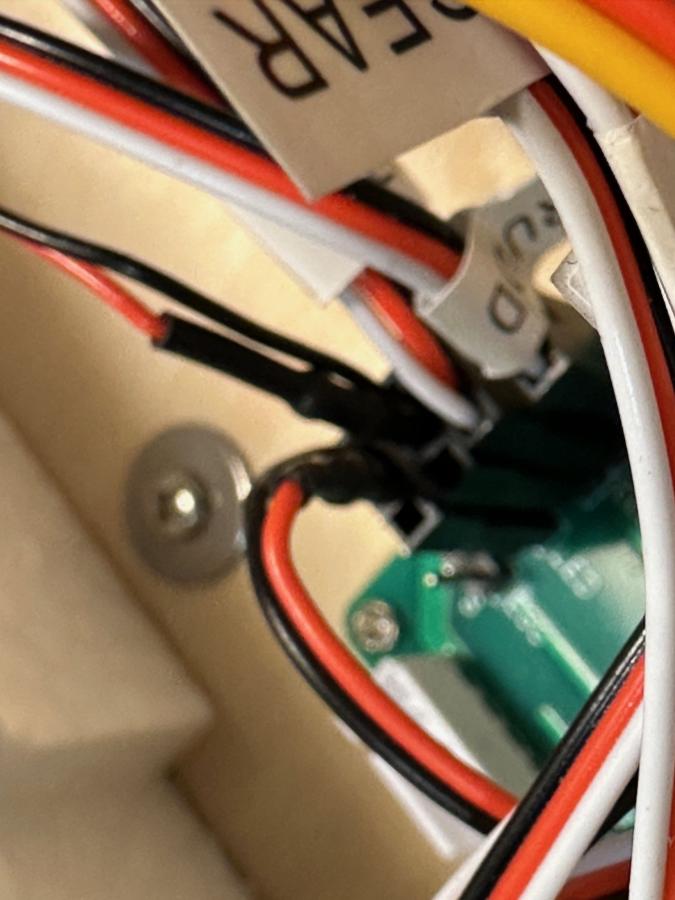

              on the super tucano the LED wire from the tail section where does it plug into the wiring block. It looks like the LED wire coming from the front of the plane is plugged into the only LED spot on the wiring block
                • 8797
                I have 2 of these planes in my hobby room at the moment. Here is a picture from one of them. You can see where the front light wire plug goes in. The one from the tail is plugged in between the front light and the AIL pins. It doesn't really matter which pins you put the rear light plug in. It can be any empty one as it only needs the plus and negative pins to work. Click image for larger version
