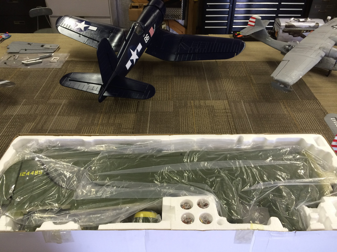

    I finally found a NIB Sonic B-17 (Thanks Bob!) and will post all the mods and updates here.

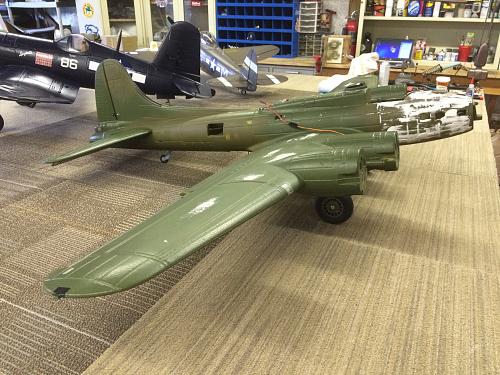

    First thing was to completely disassemble everything so I could re-paint it everything and replace all the servos.

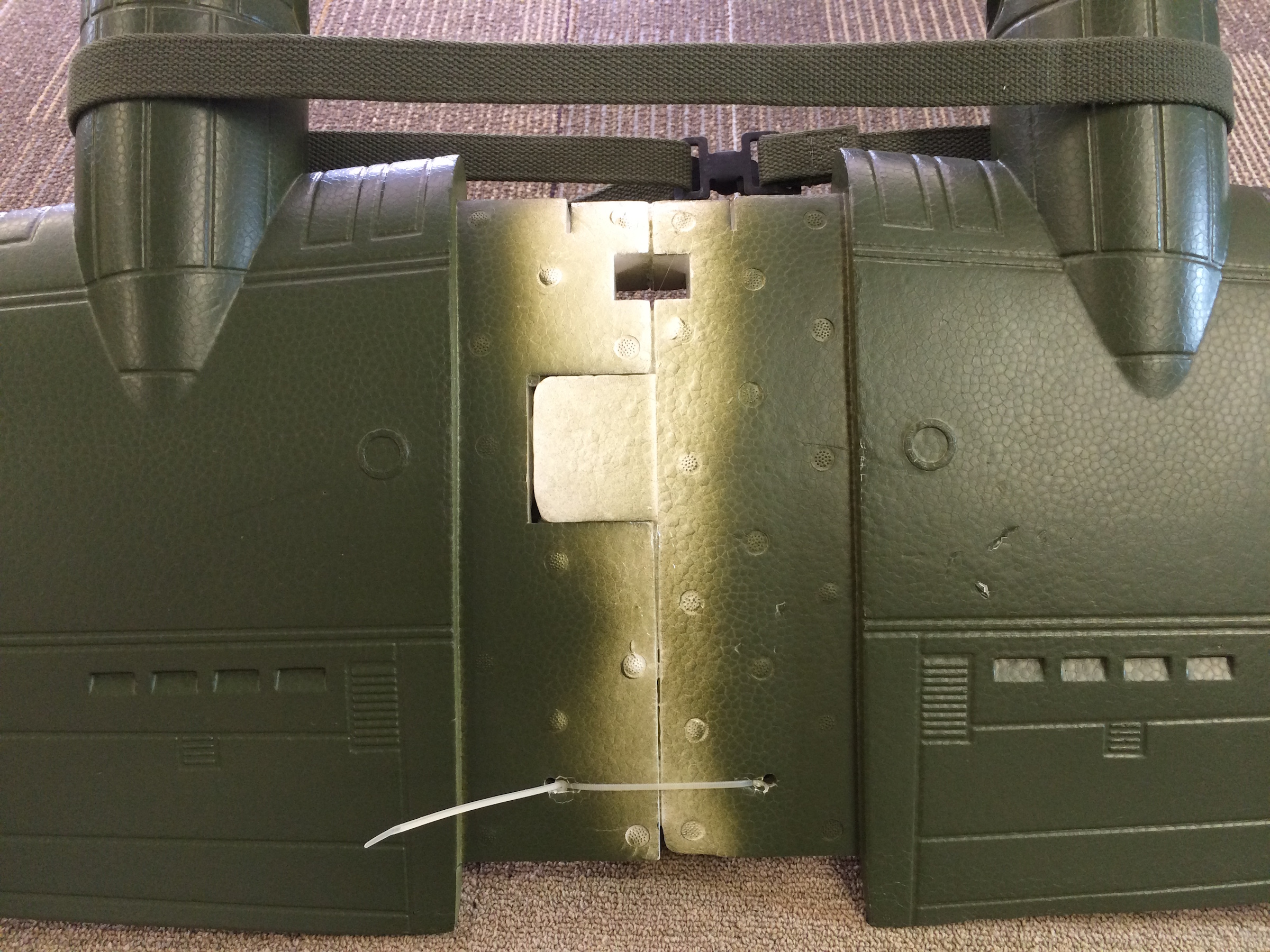

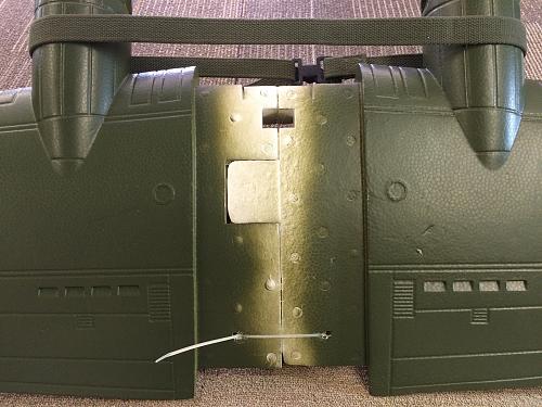

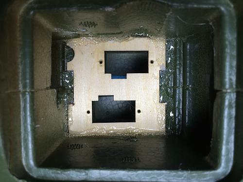

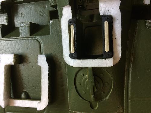

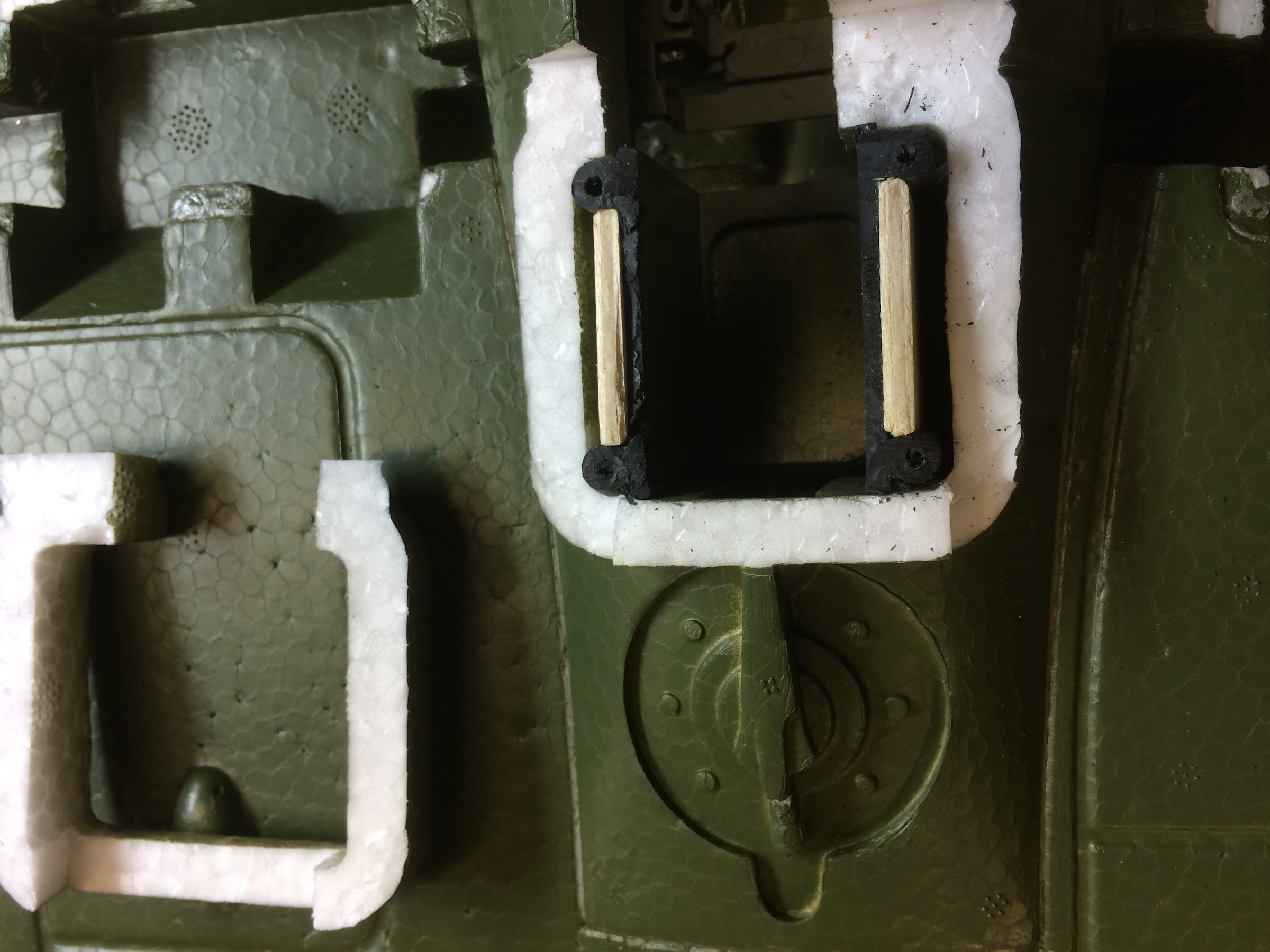

    Reinforced the fuse servos mount.

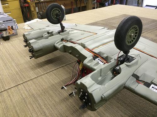

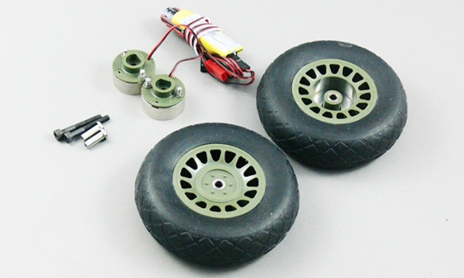

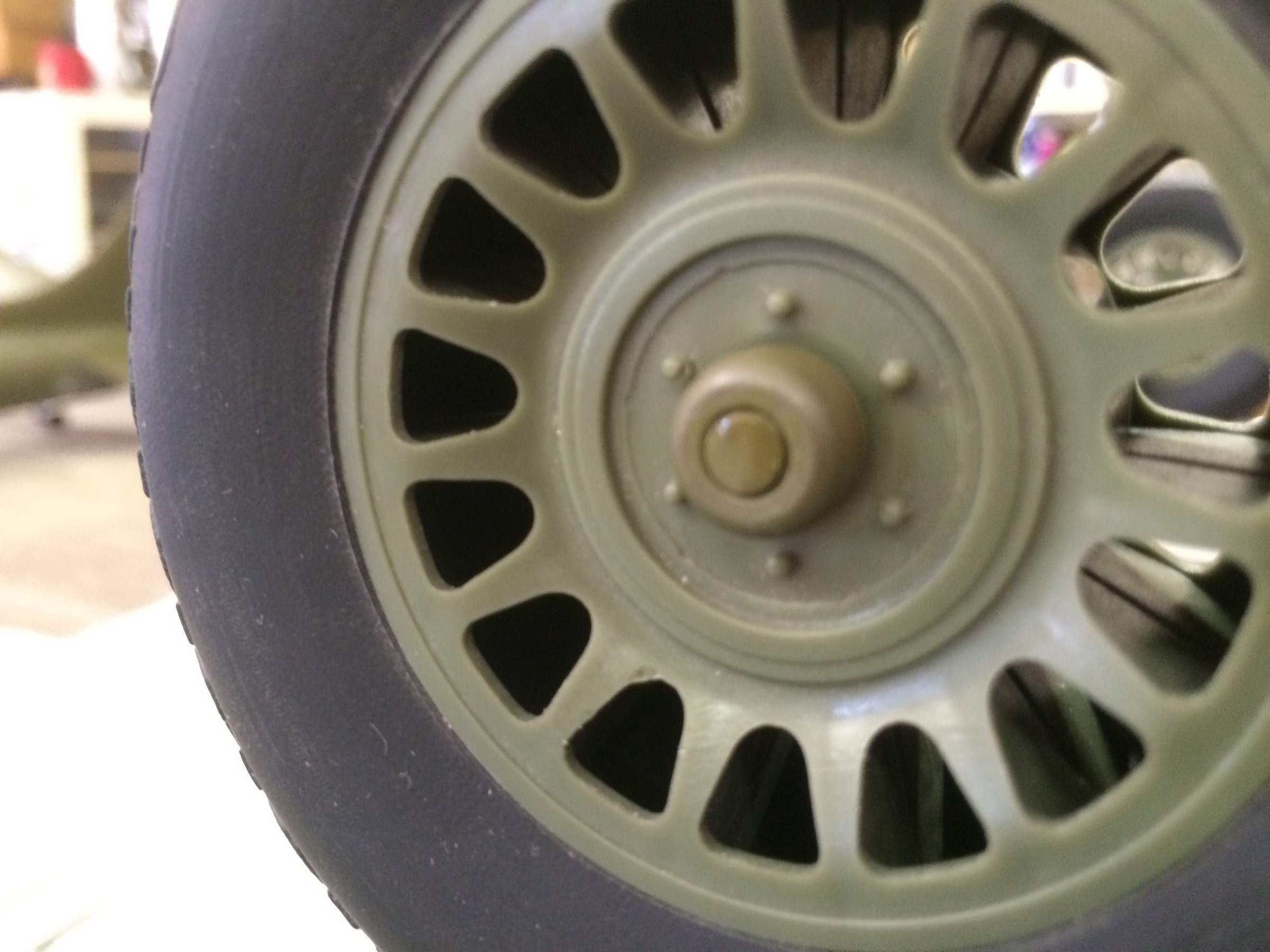

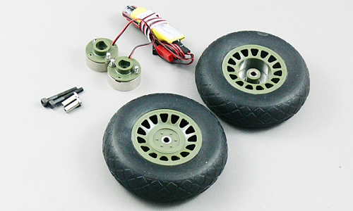

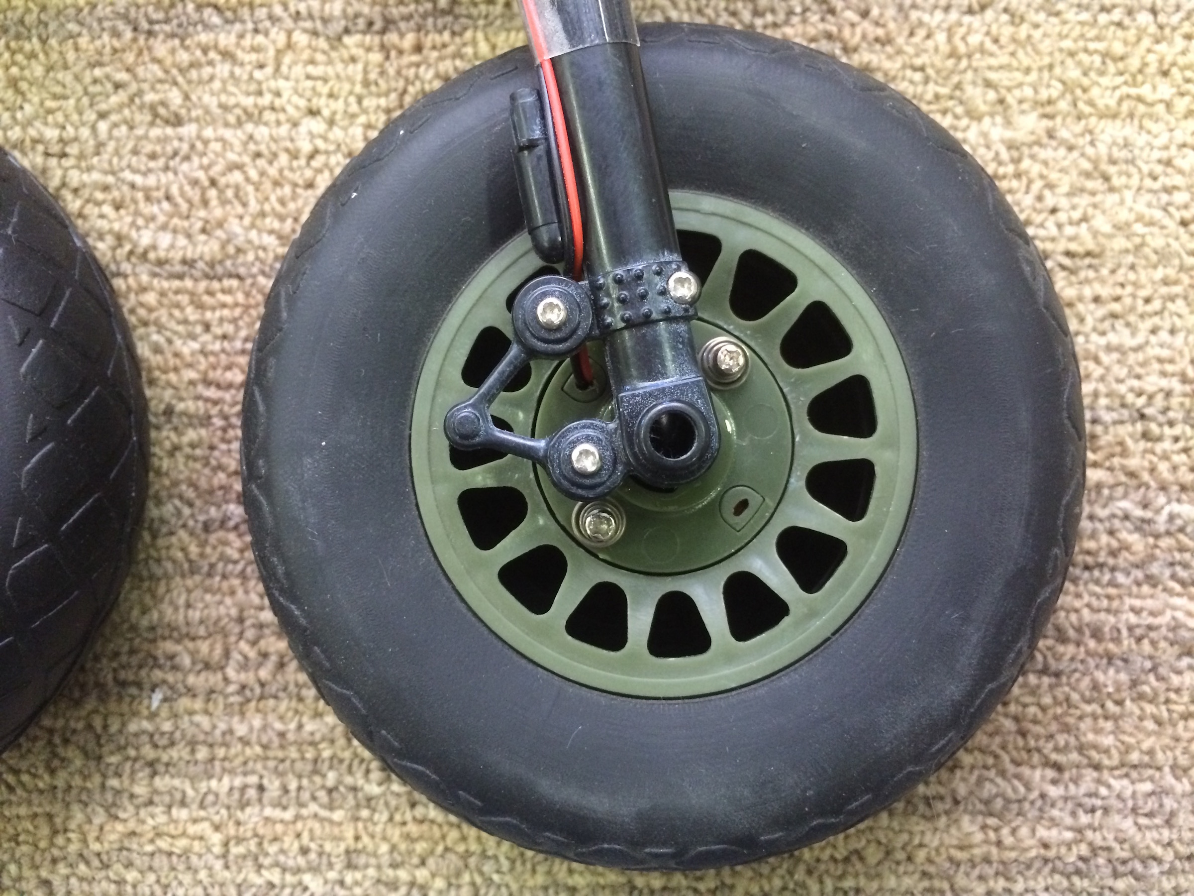

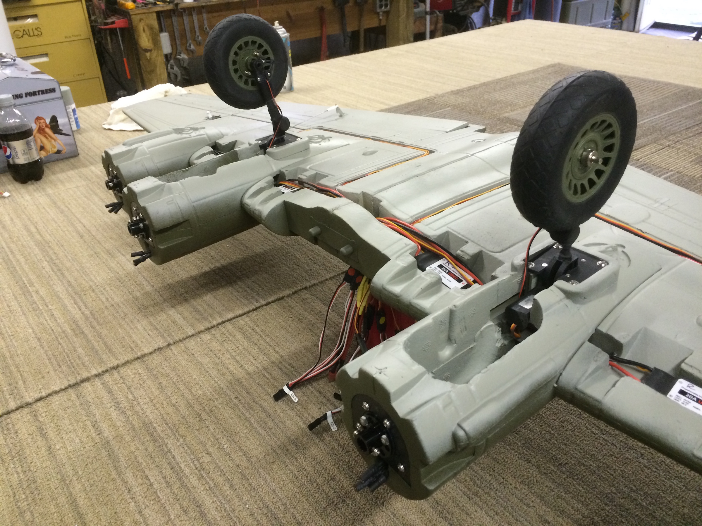

    I used a set of wheels with brakes from and LX B-25.

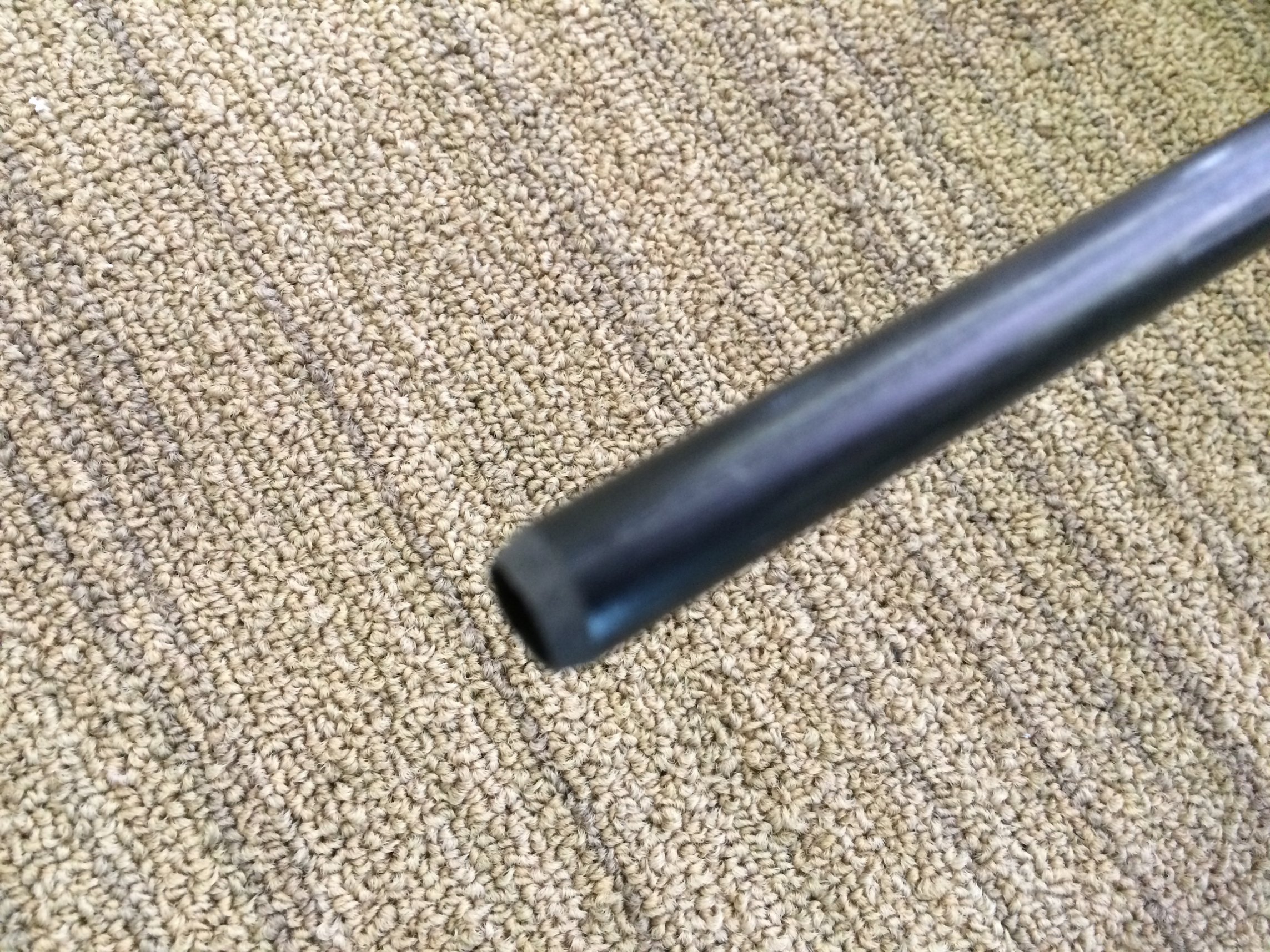

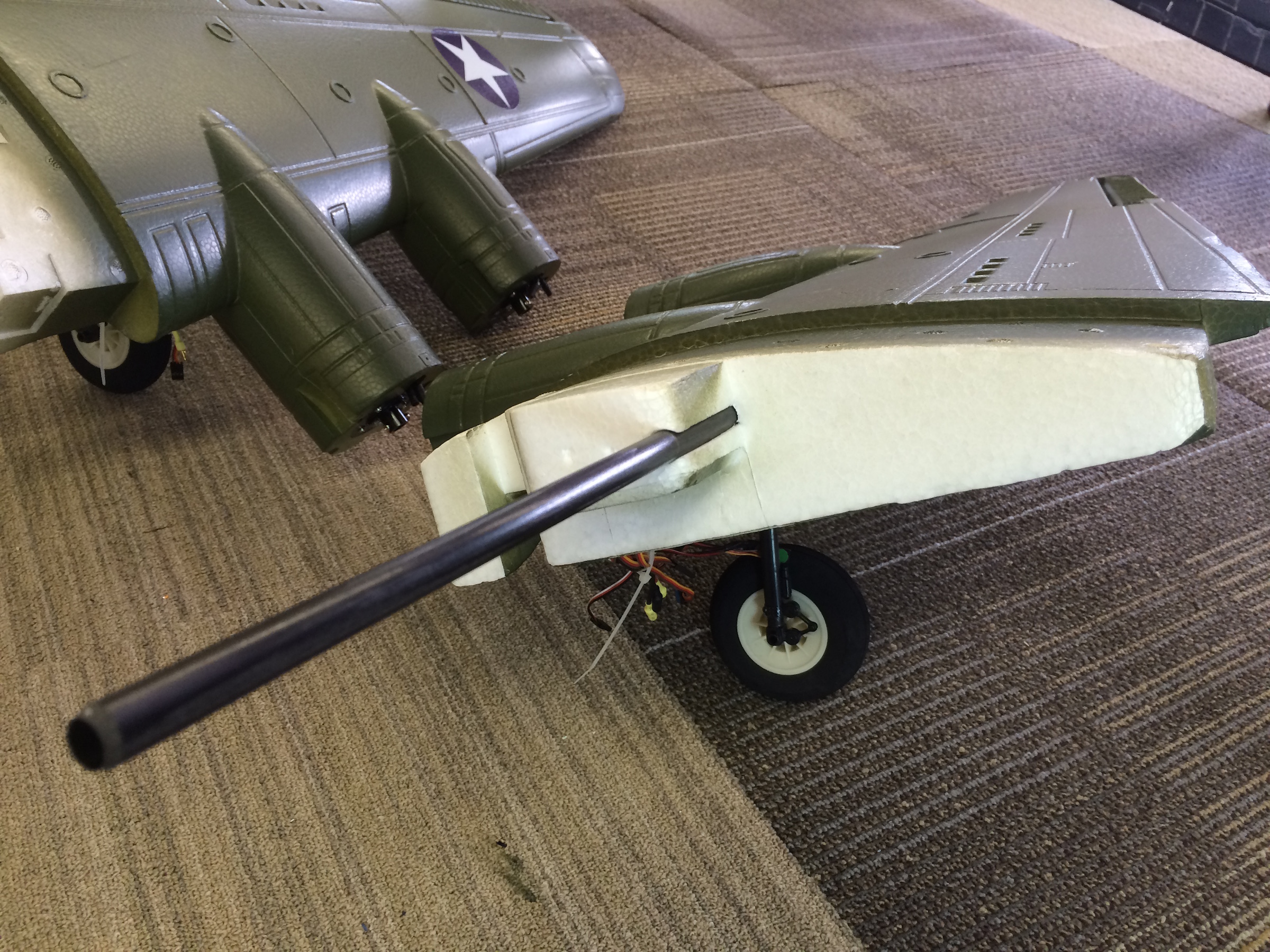

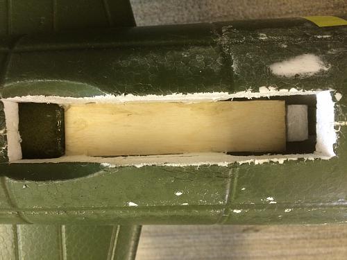

    The wing didn't have a spar and probably didn't need one but hey it didn't needs brakes either.

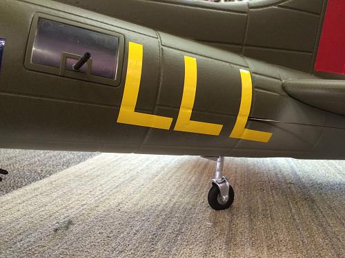

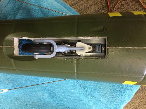

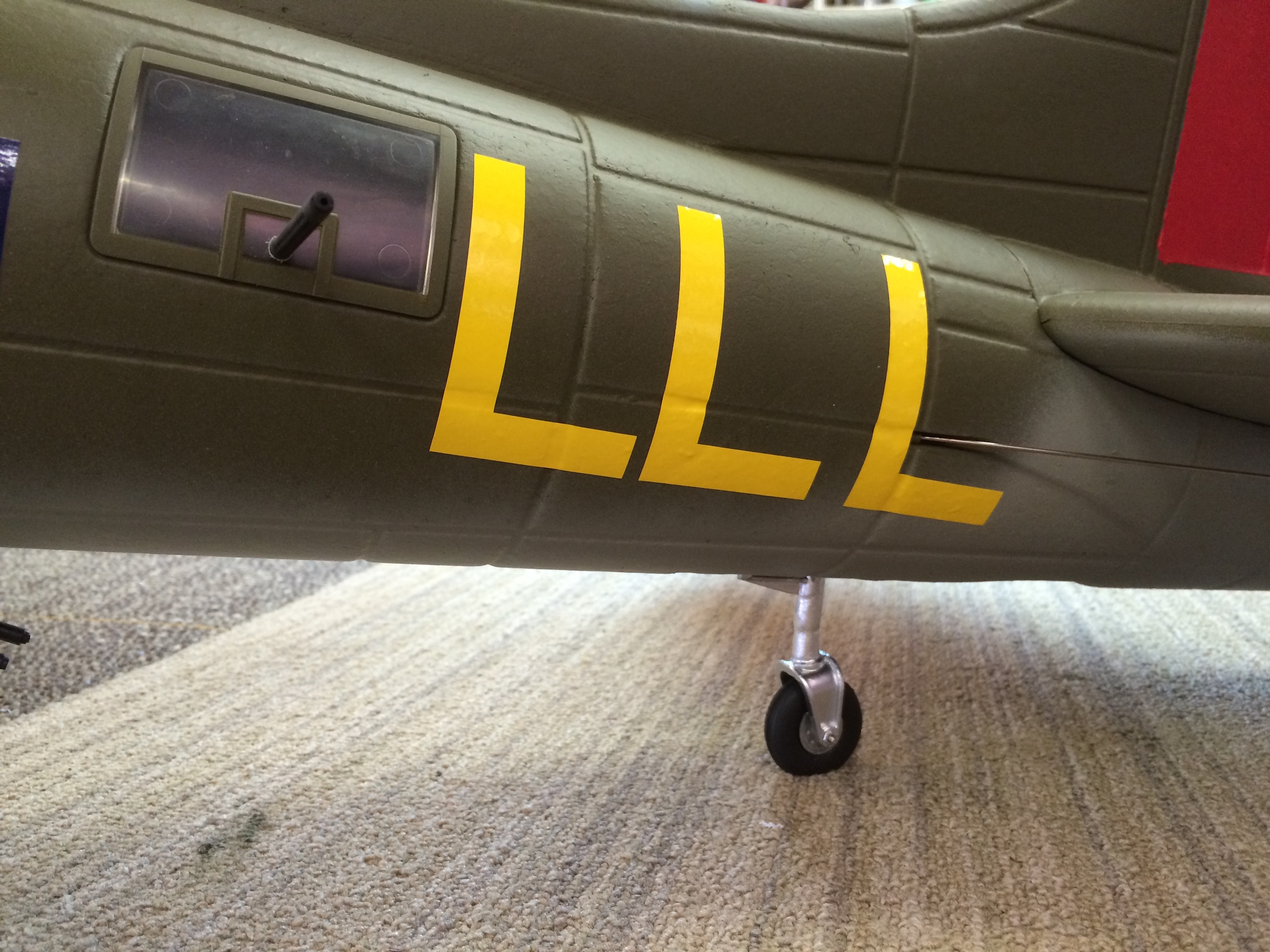

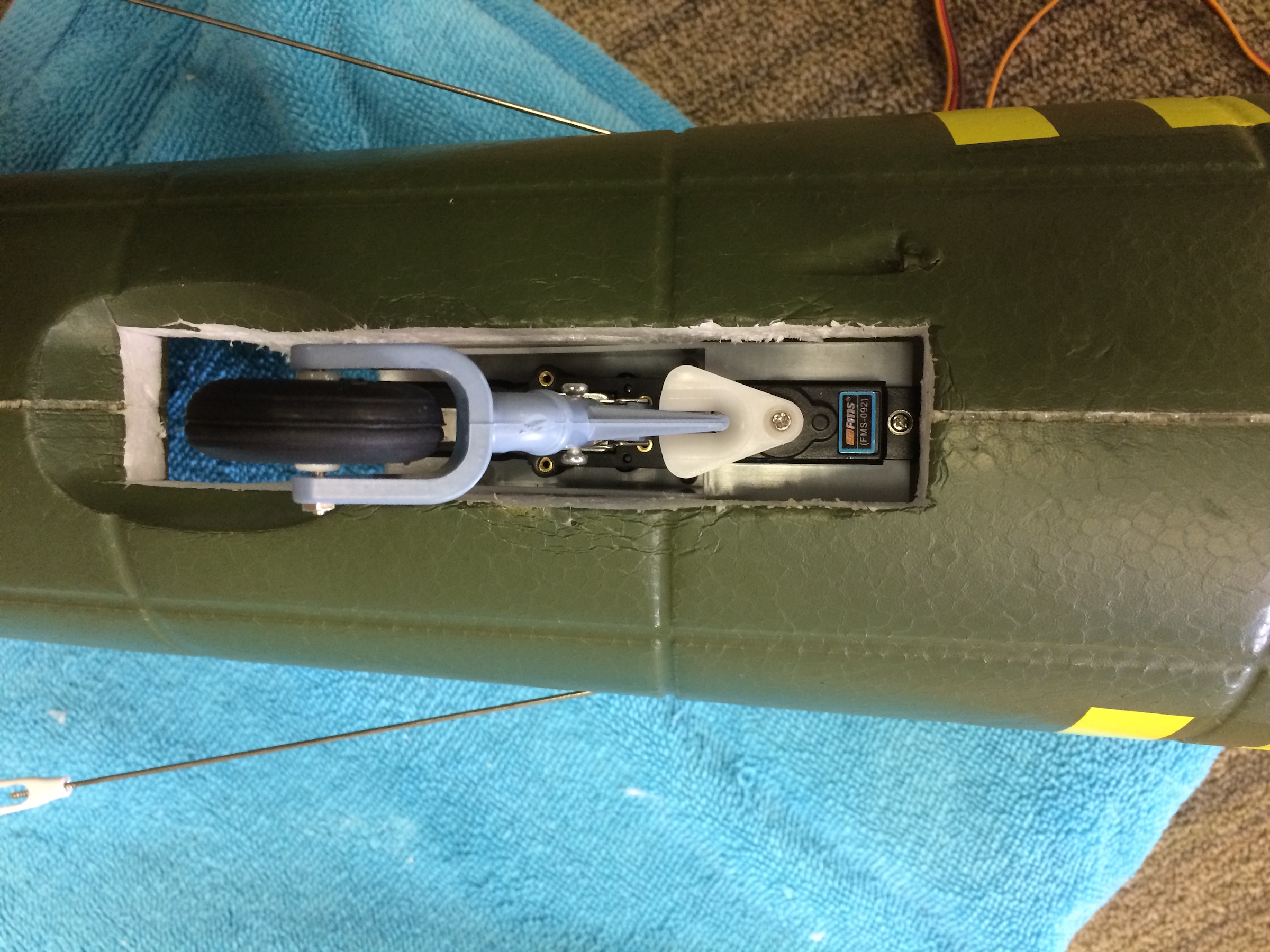

      Replace the tail gear with a BF109 retractable gear.

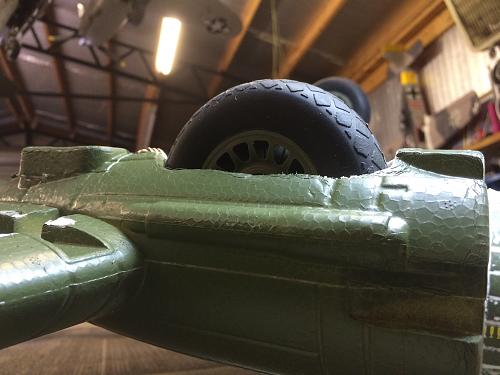

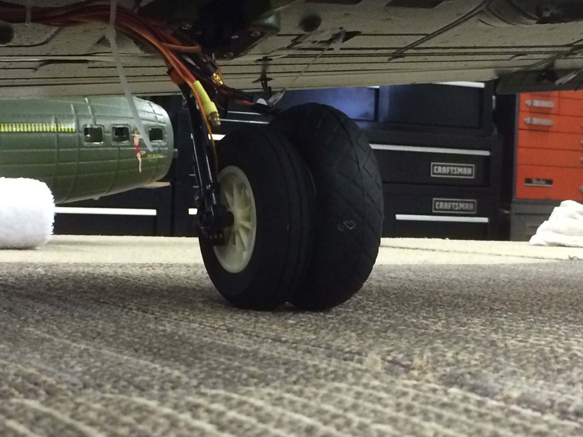

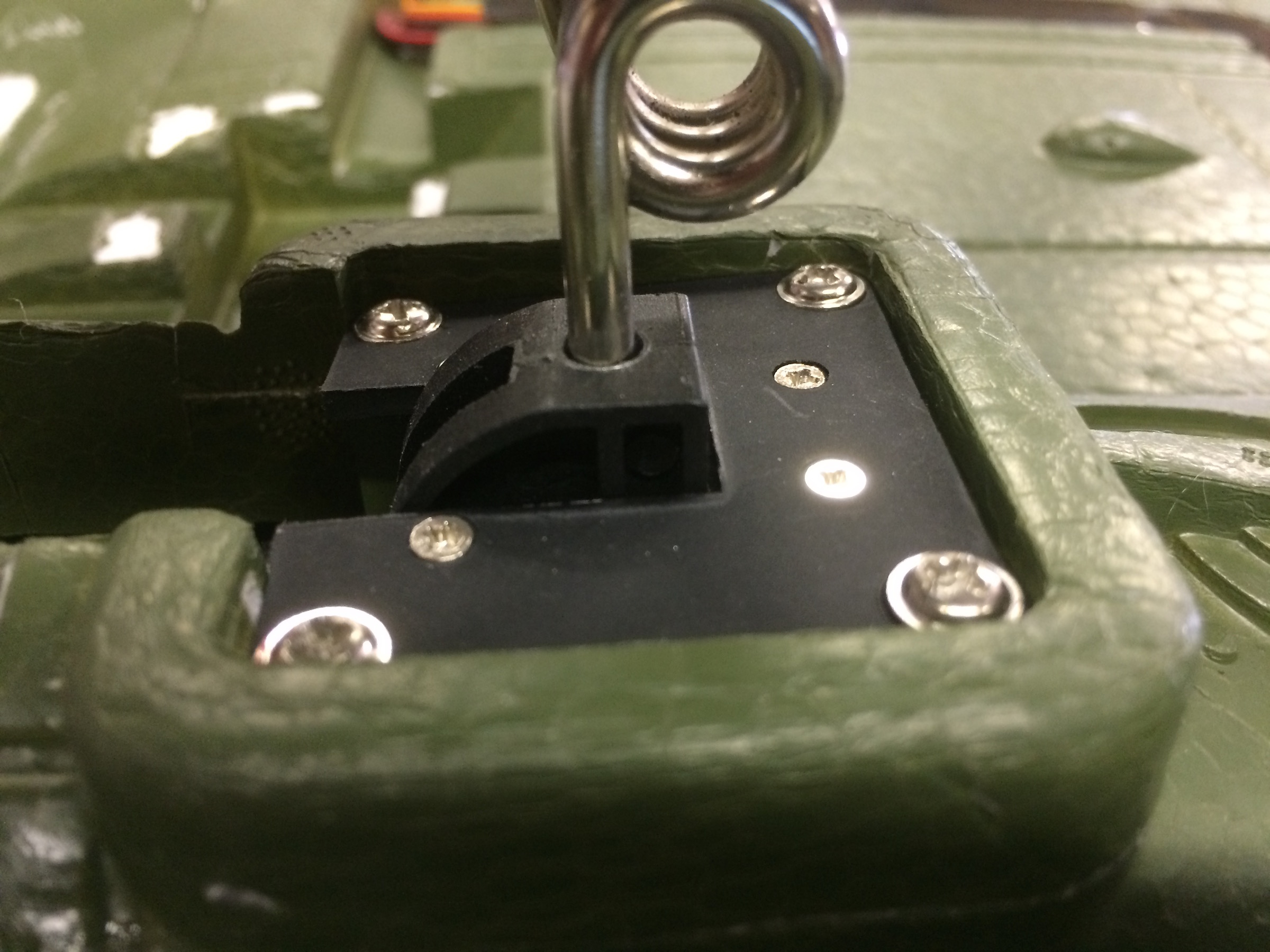

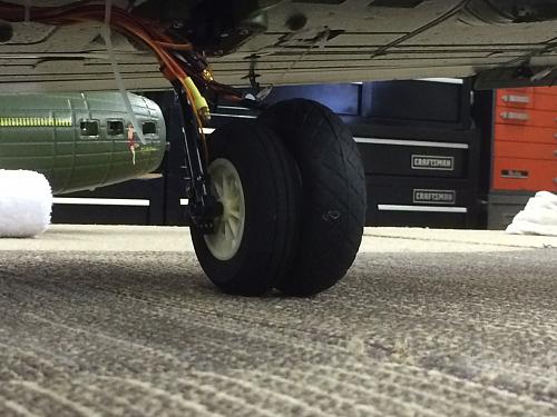

      To get the nose back down after adding the larger tires I recessed the retracts and angled them to add more rake which will help eliminate tip over.

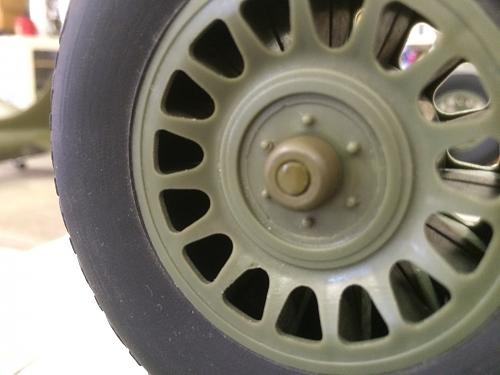

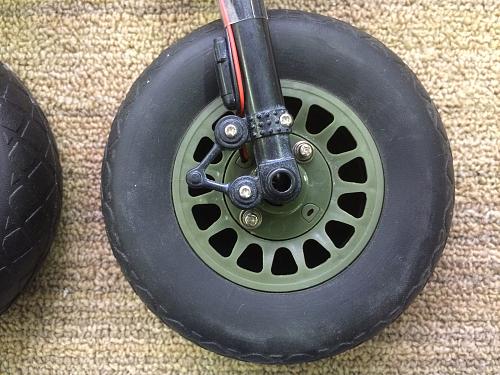

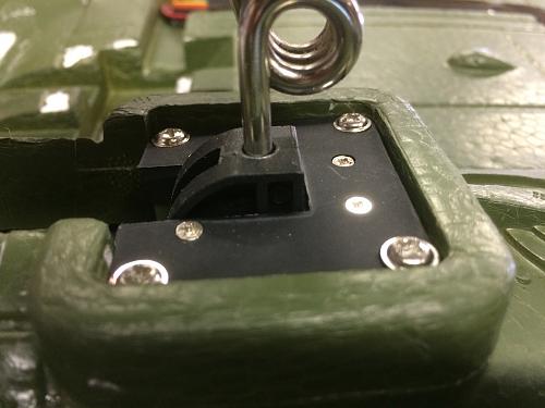

      The brake hubs fit really good on the stock struts.

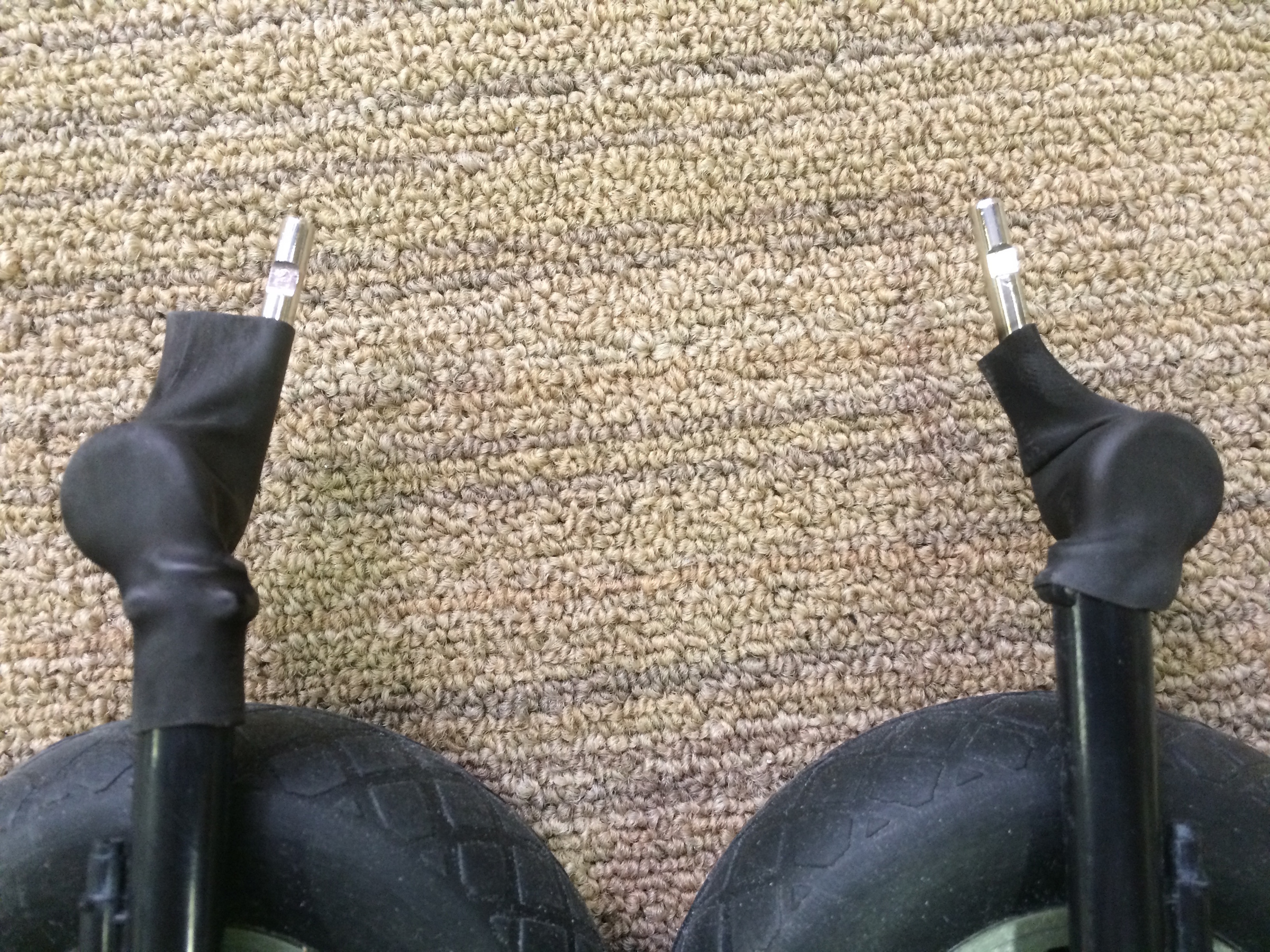

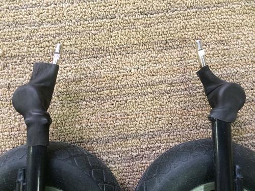

      I always hated the look of the coils so I put some heatshrink over them.
      Minor trimming was needed to use the 3.875" tires, stock tires were 3.5"

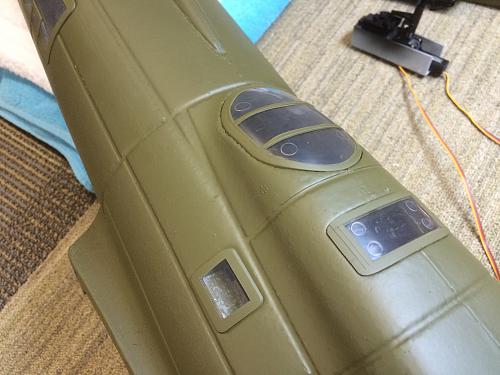

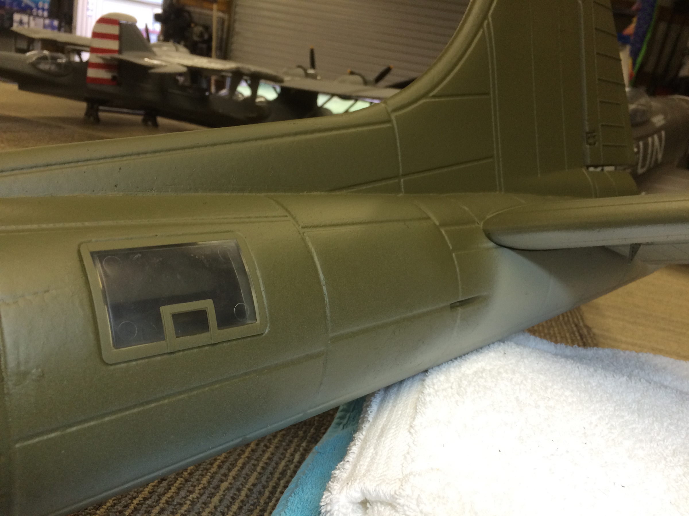

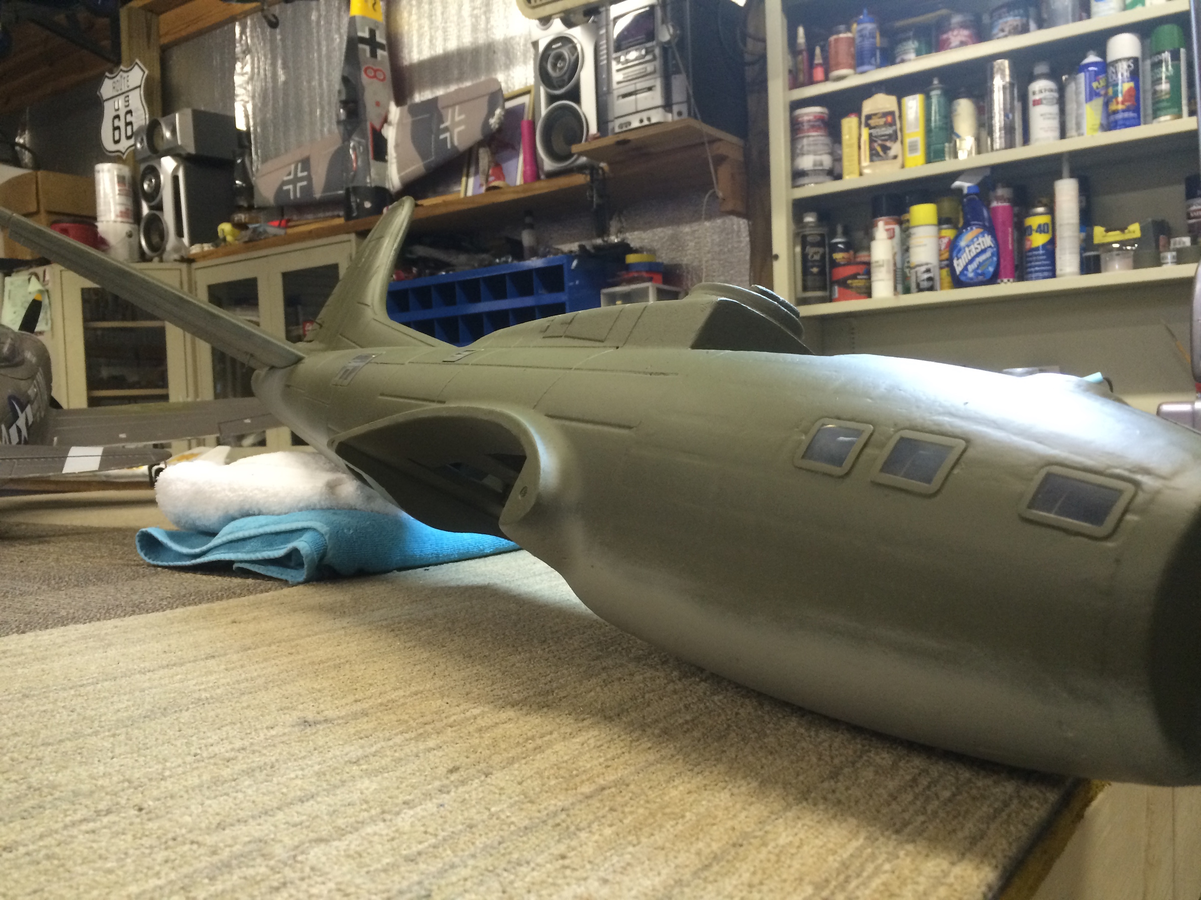

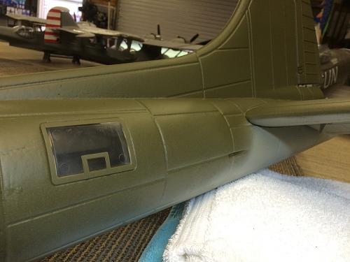

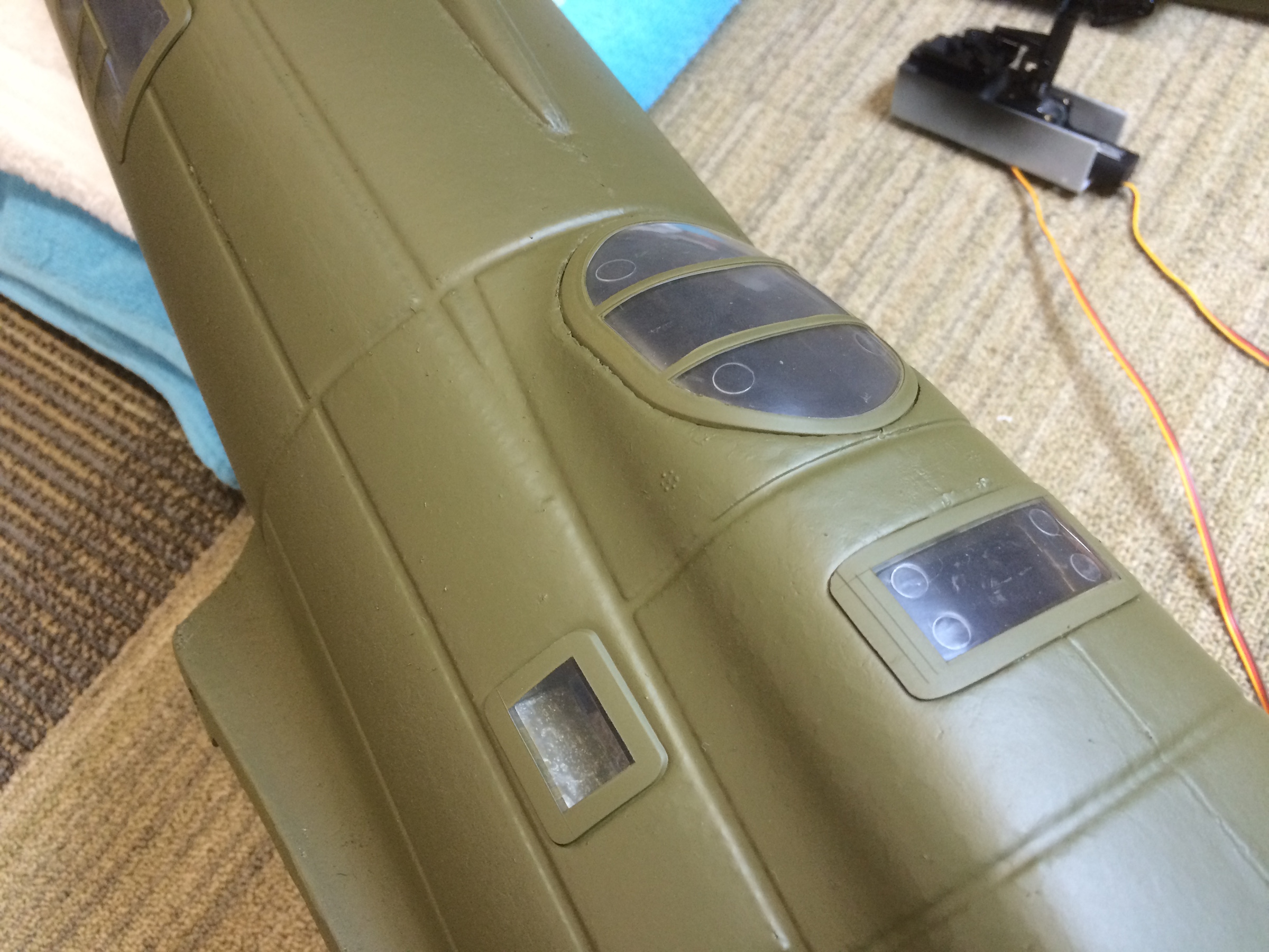

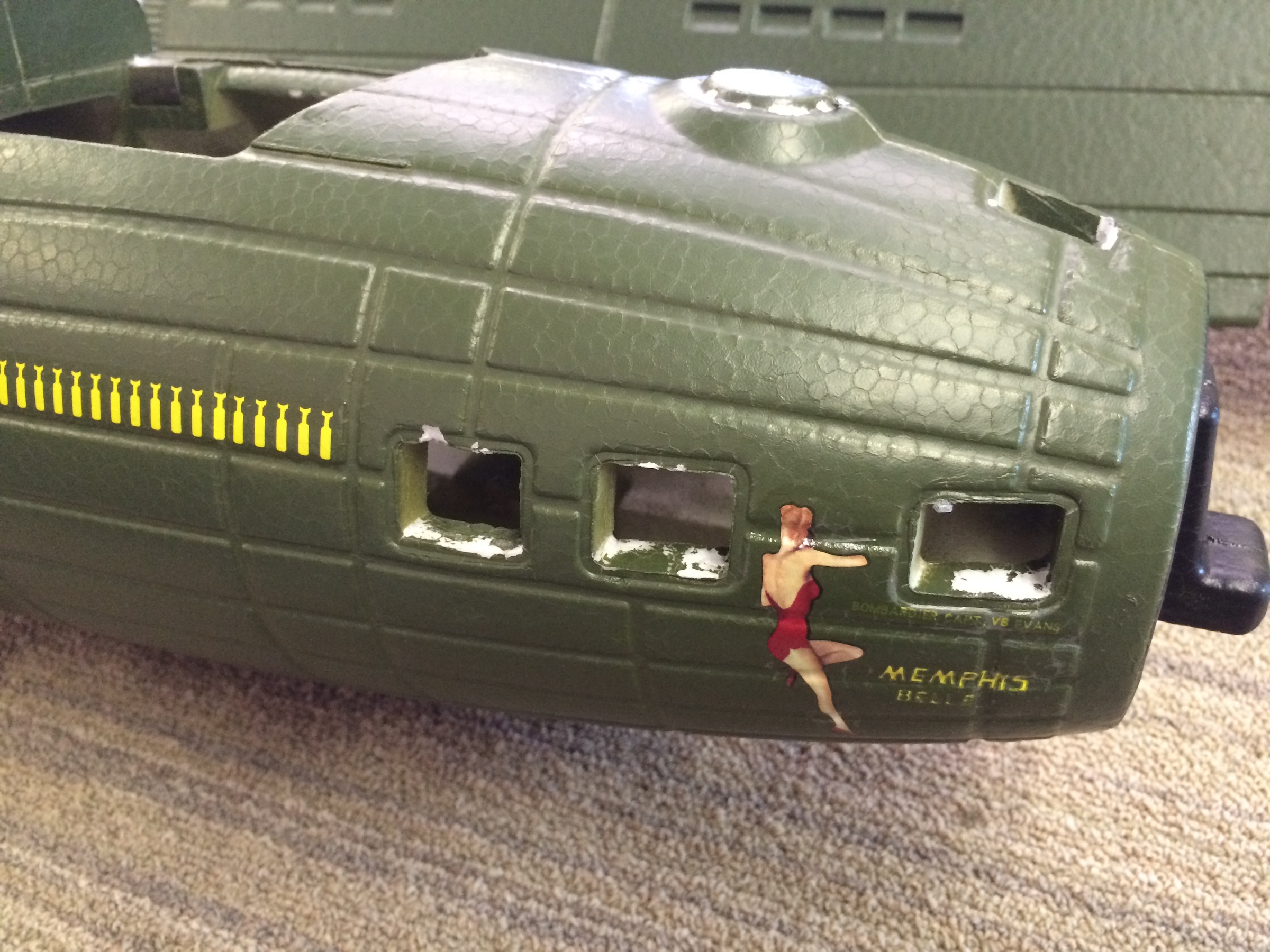

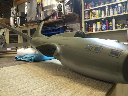

        Filled in some of the nose panel lines and filled over areas where needed.

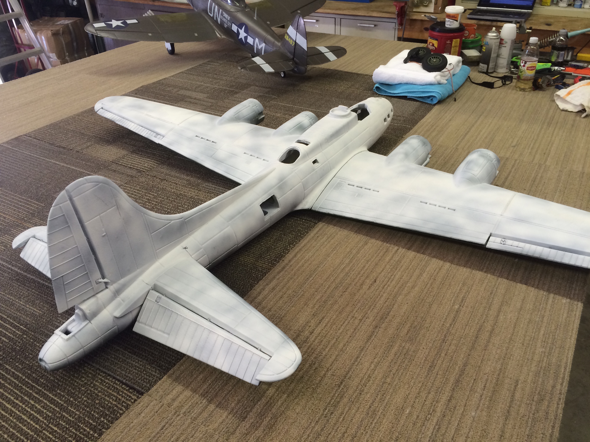

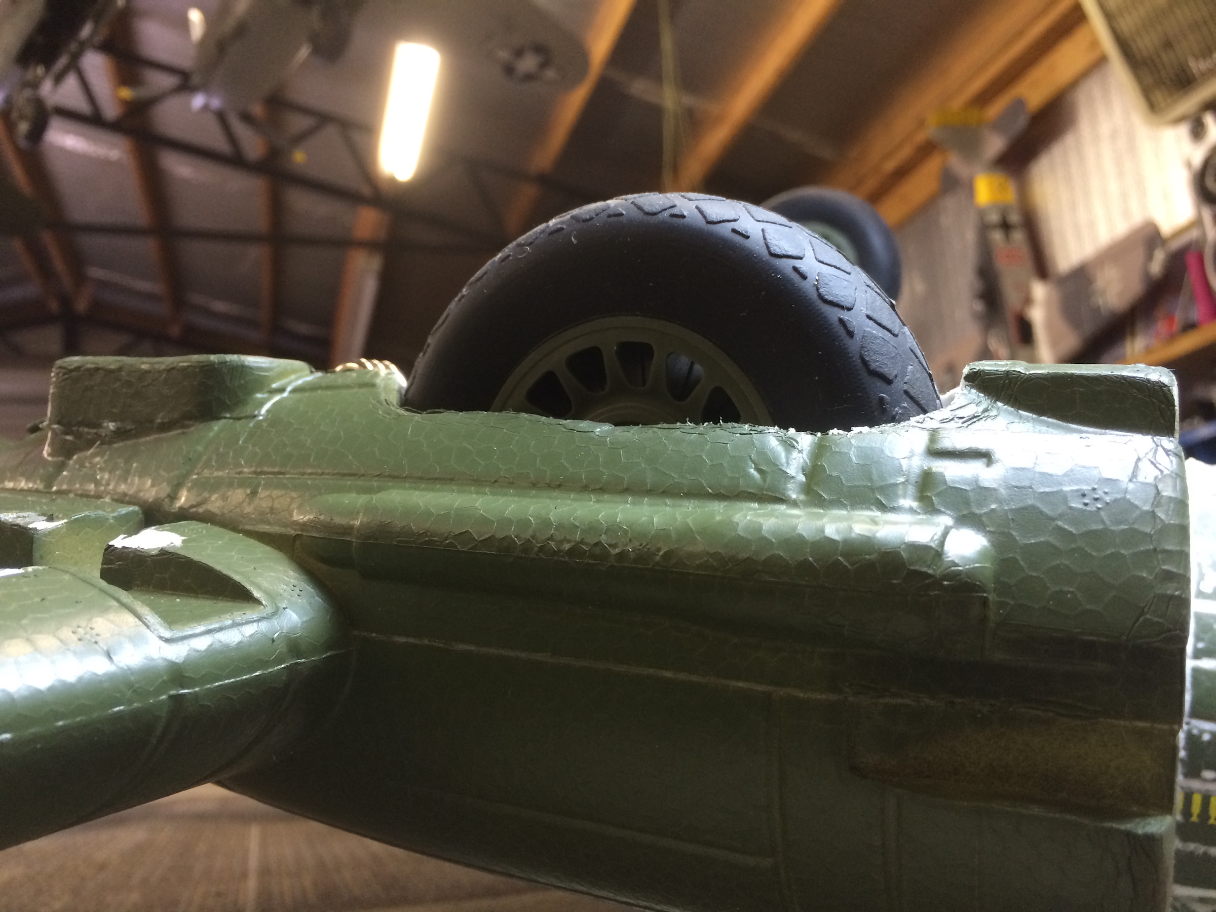

        I used Krylon Foam Primer which really masked the cells, it even has a foam plane on the label.

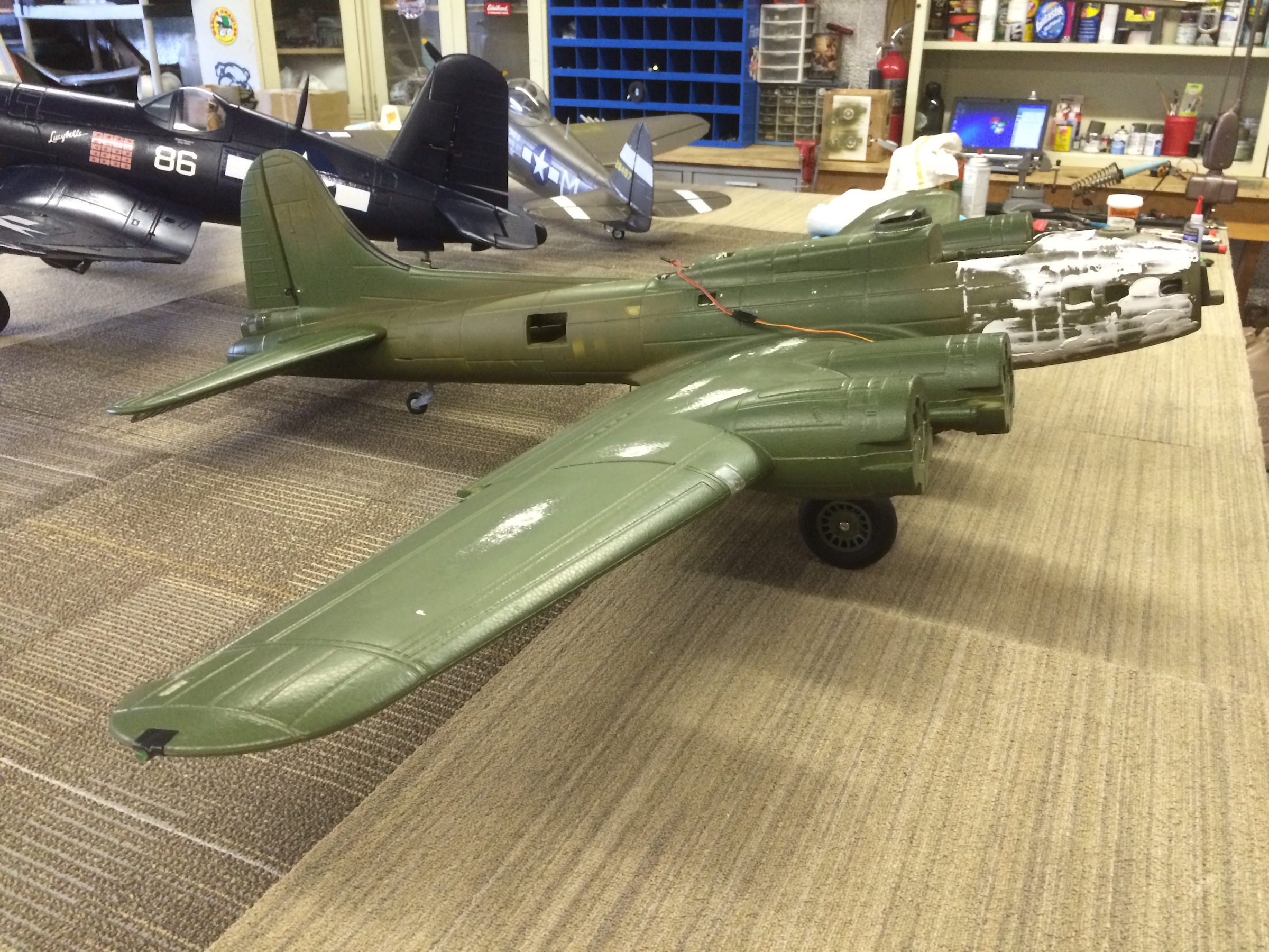

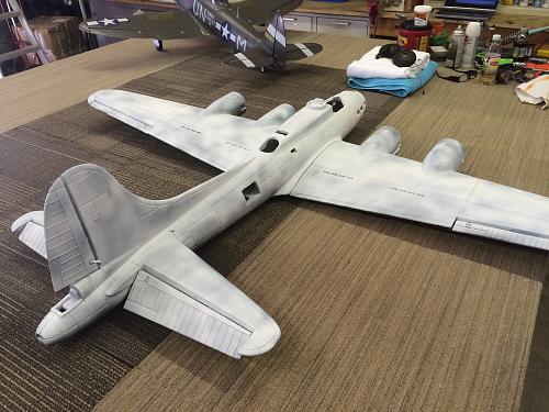

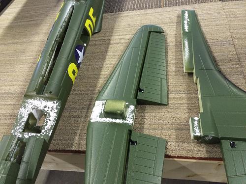

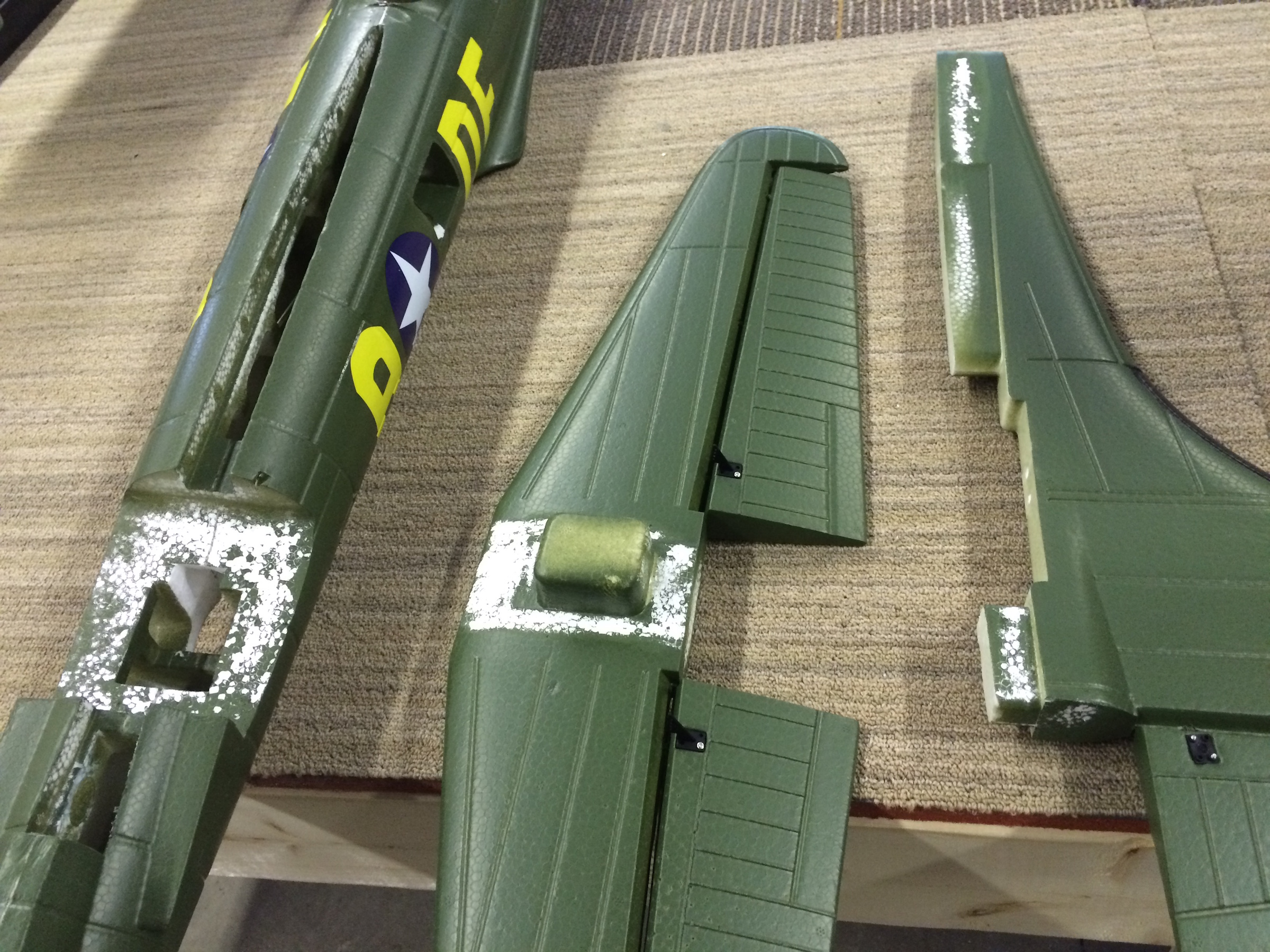

        Started painting everything.

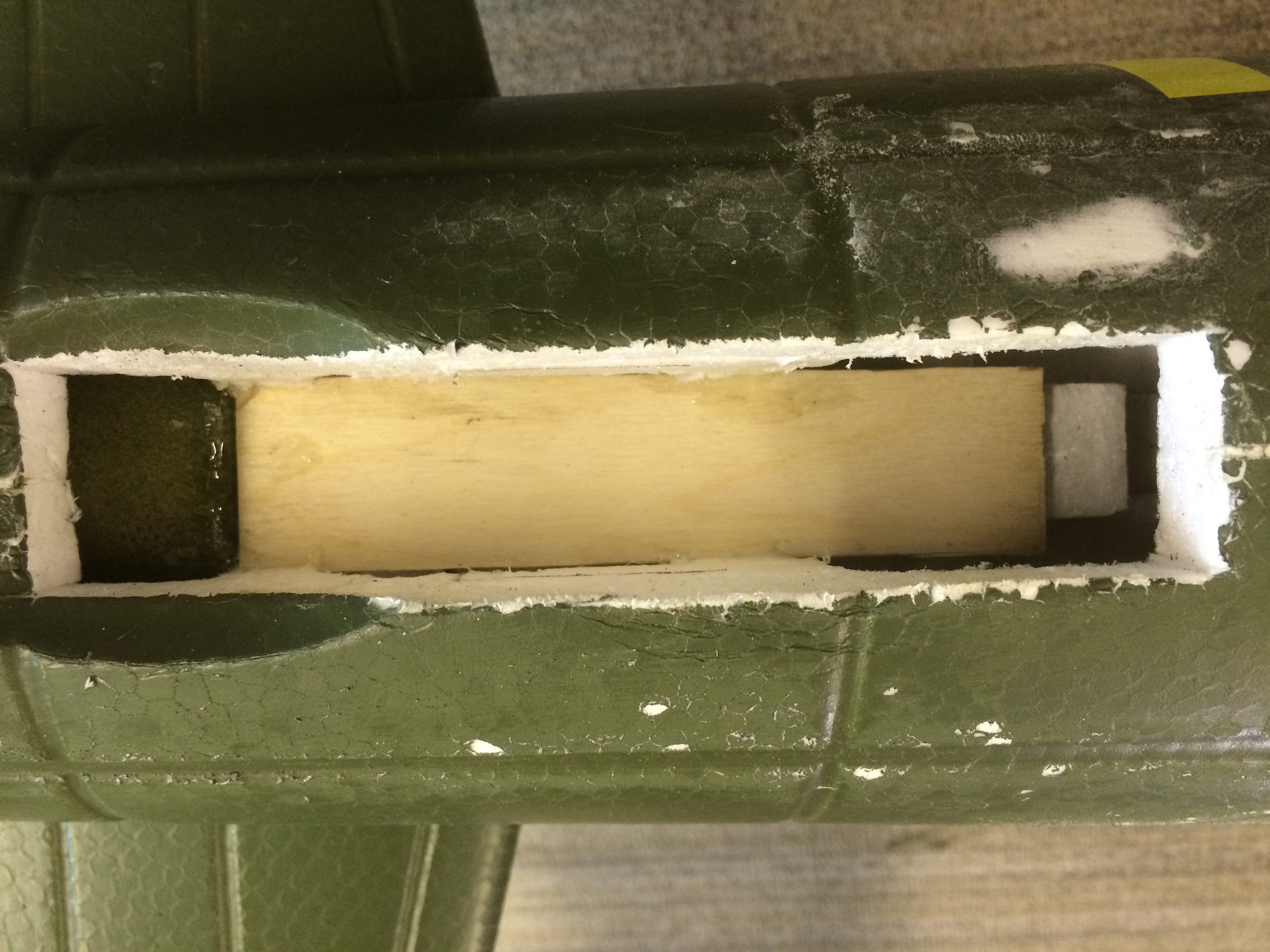

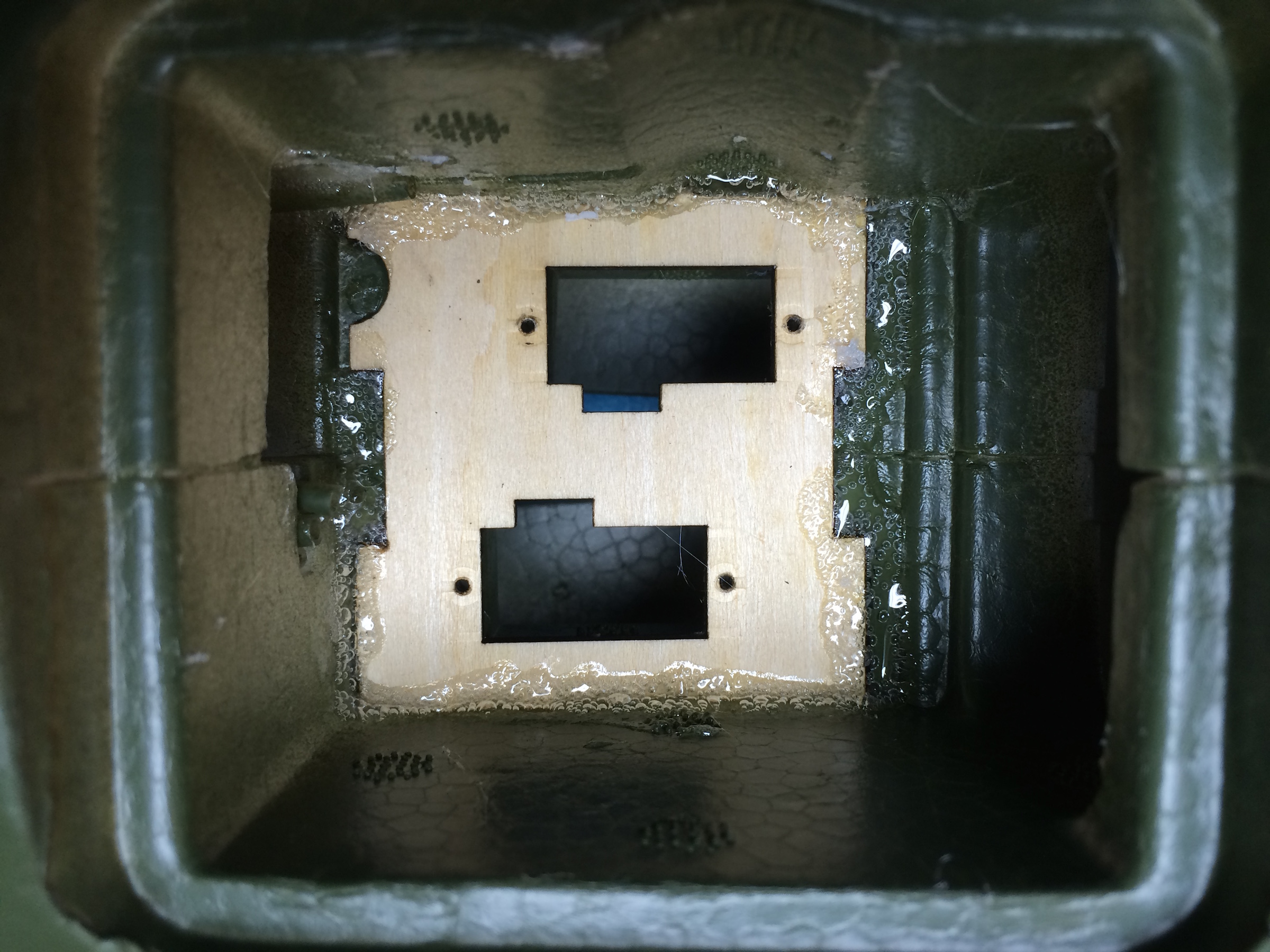

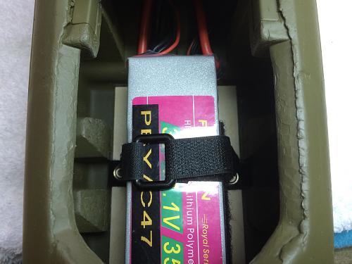

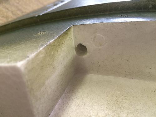

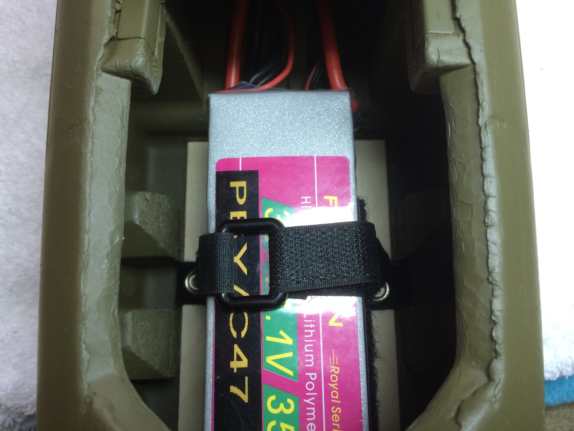

        Enlarged the battery compartment then added plywood for the flooring and a velcro strap.

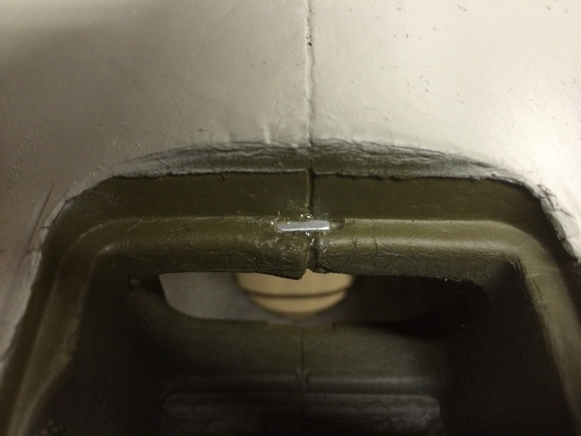

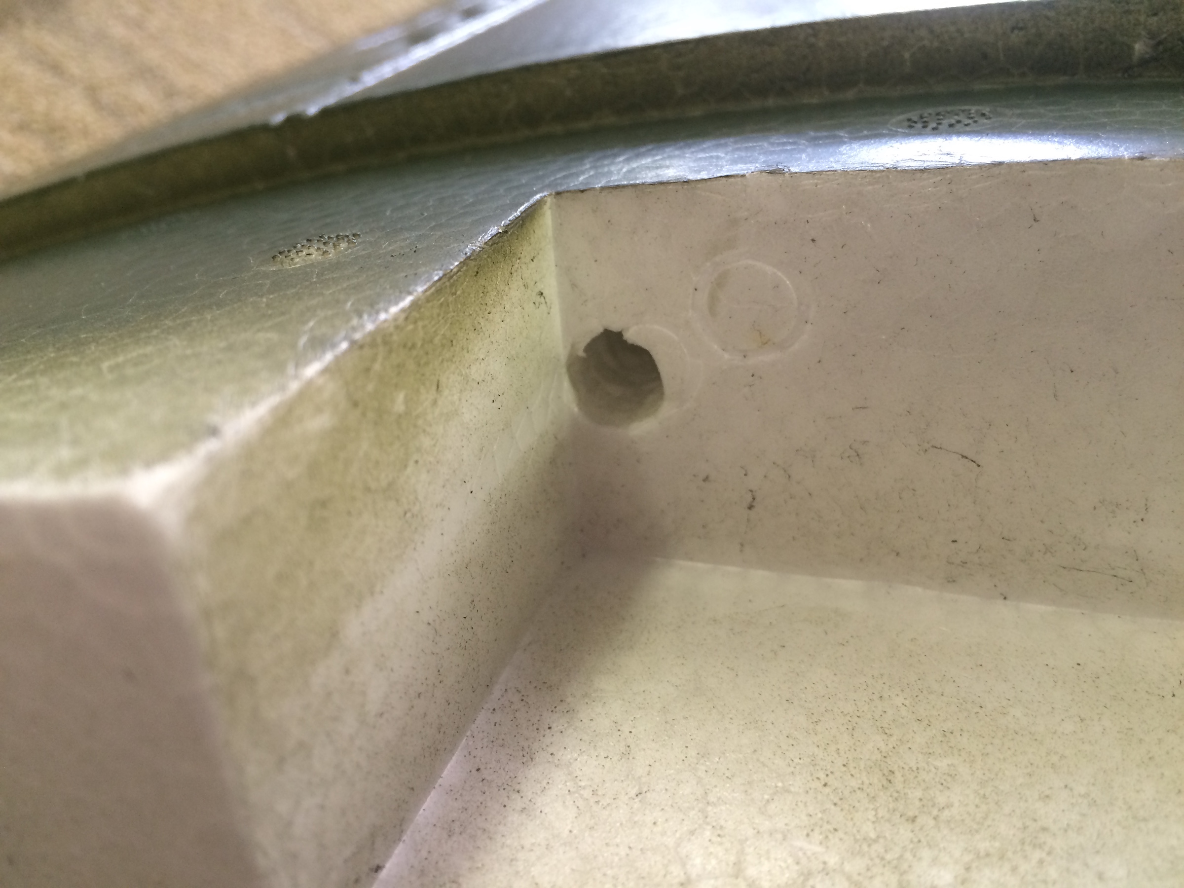

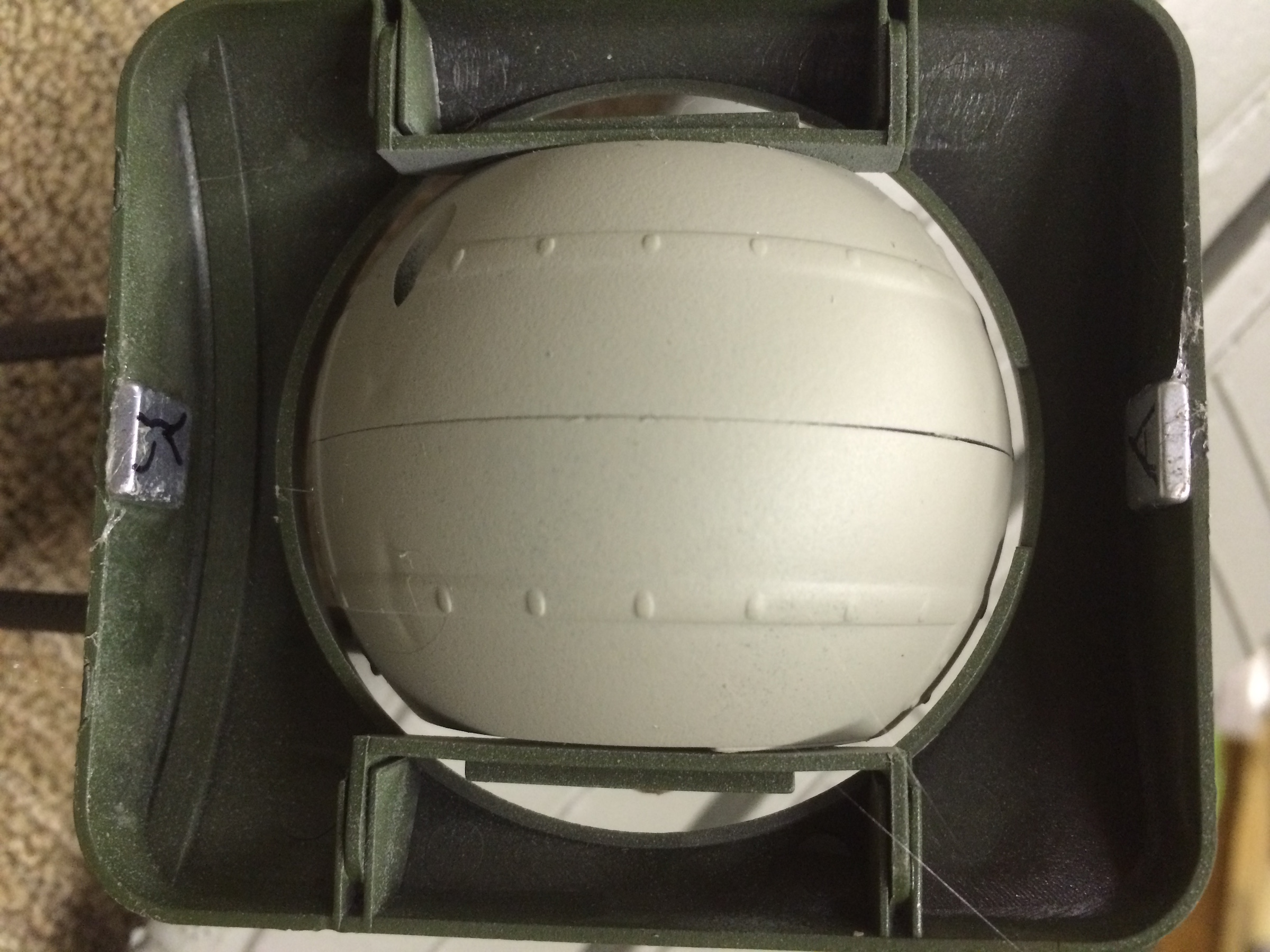

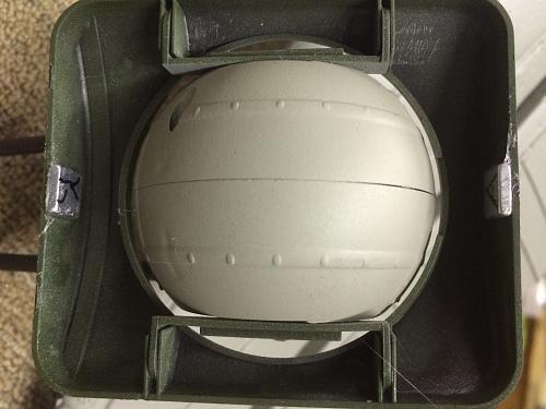

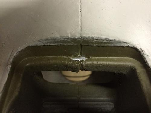

          The rudder and elevator servos are under the ball turret so I added magnets to it instead of glueing it in.

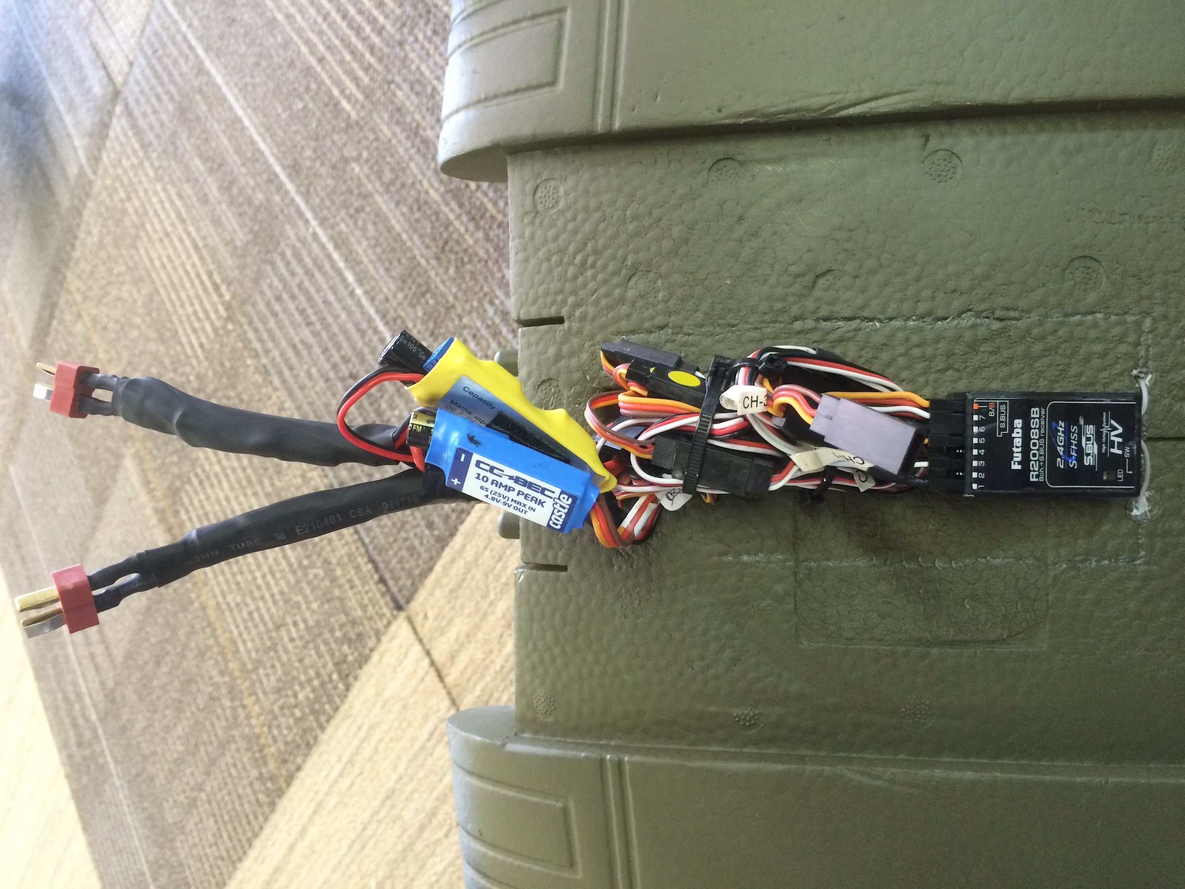

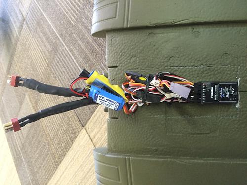

          I decided to use a 10A Castle BEC.

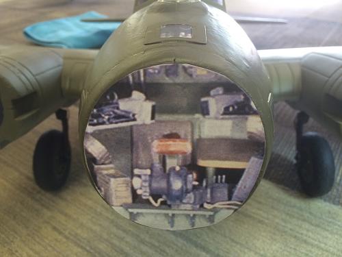

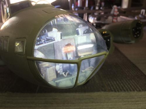

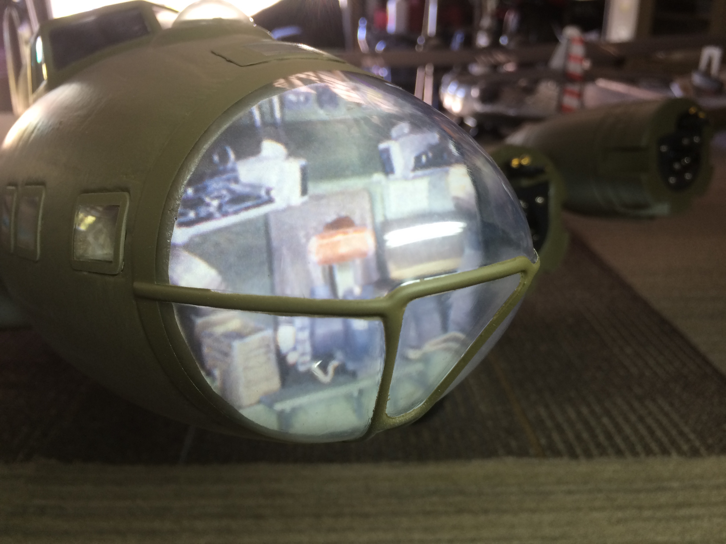

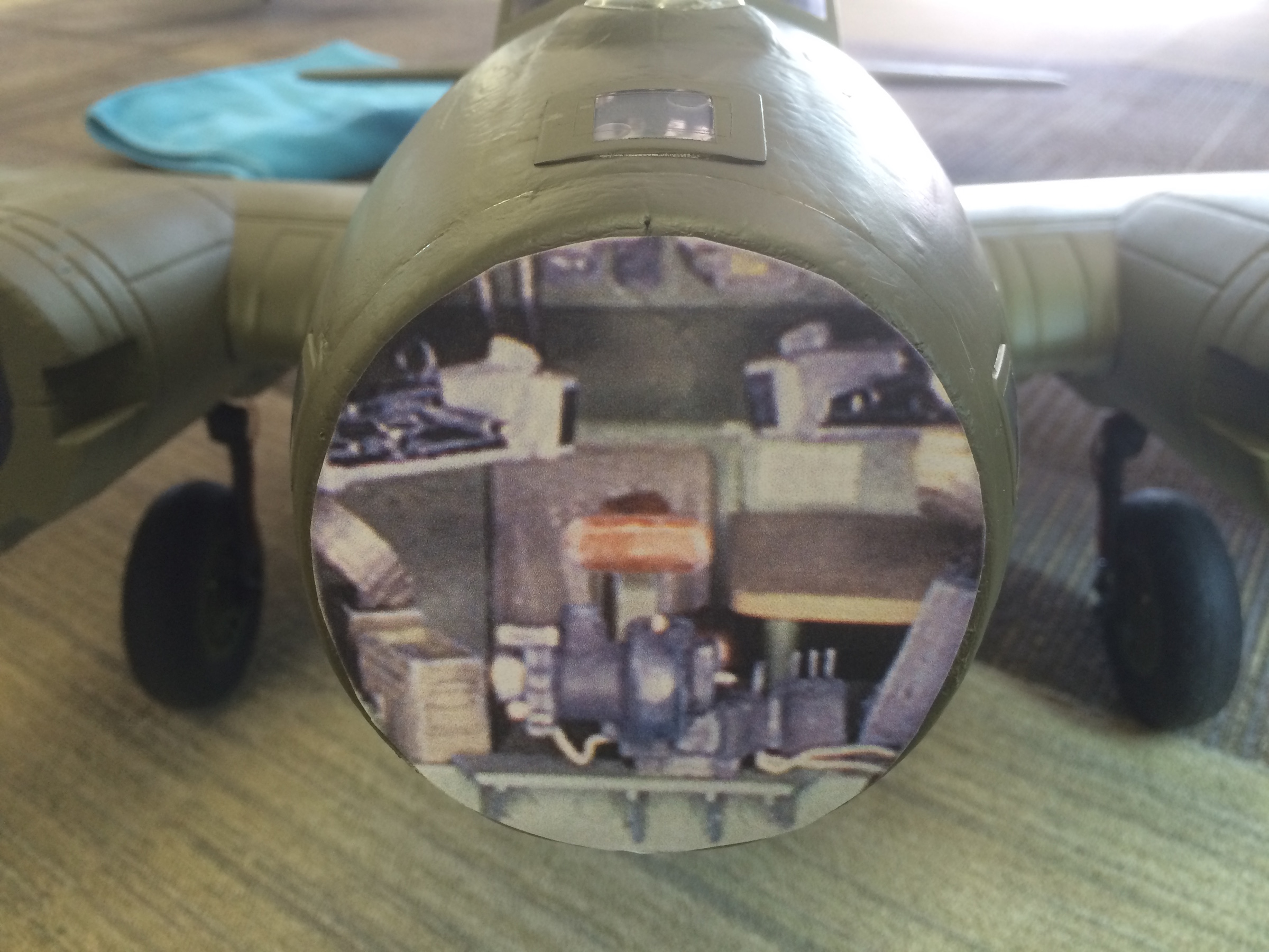

          Instead of cutting out the nose and trying to detail it I found a nose picture of a detailed model to use.

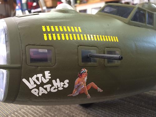

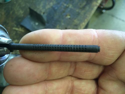

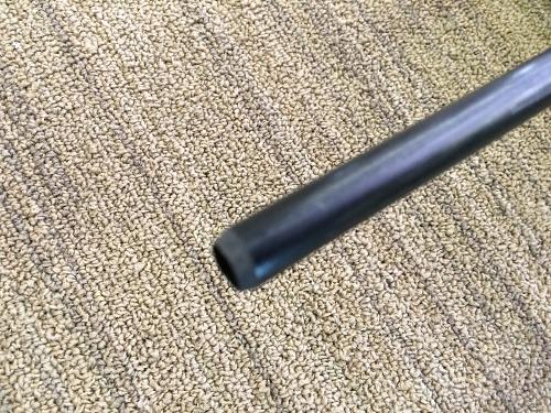

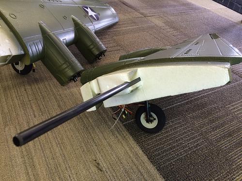

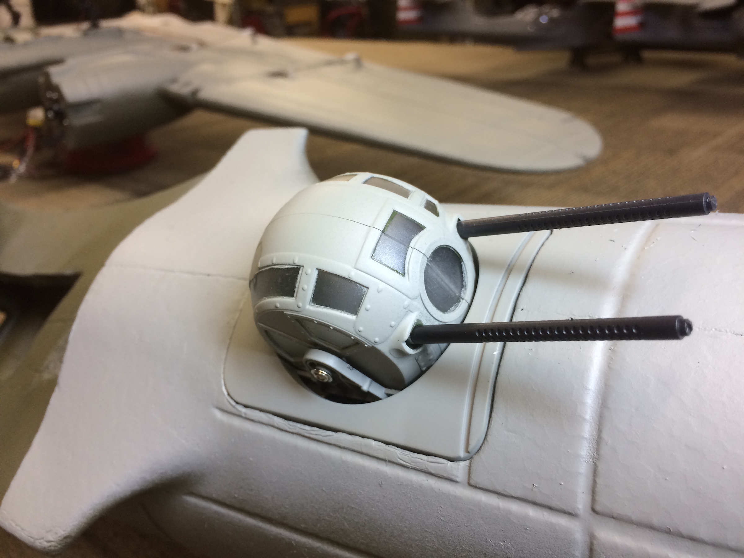

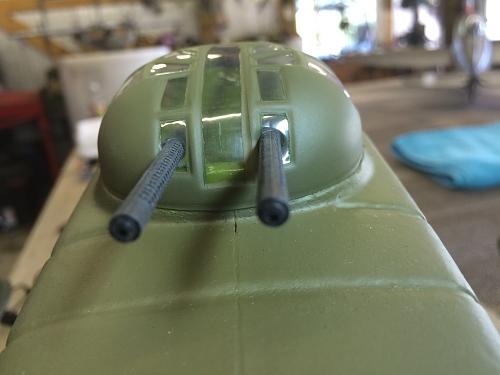

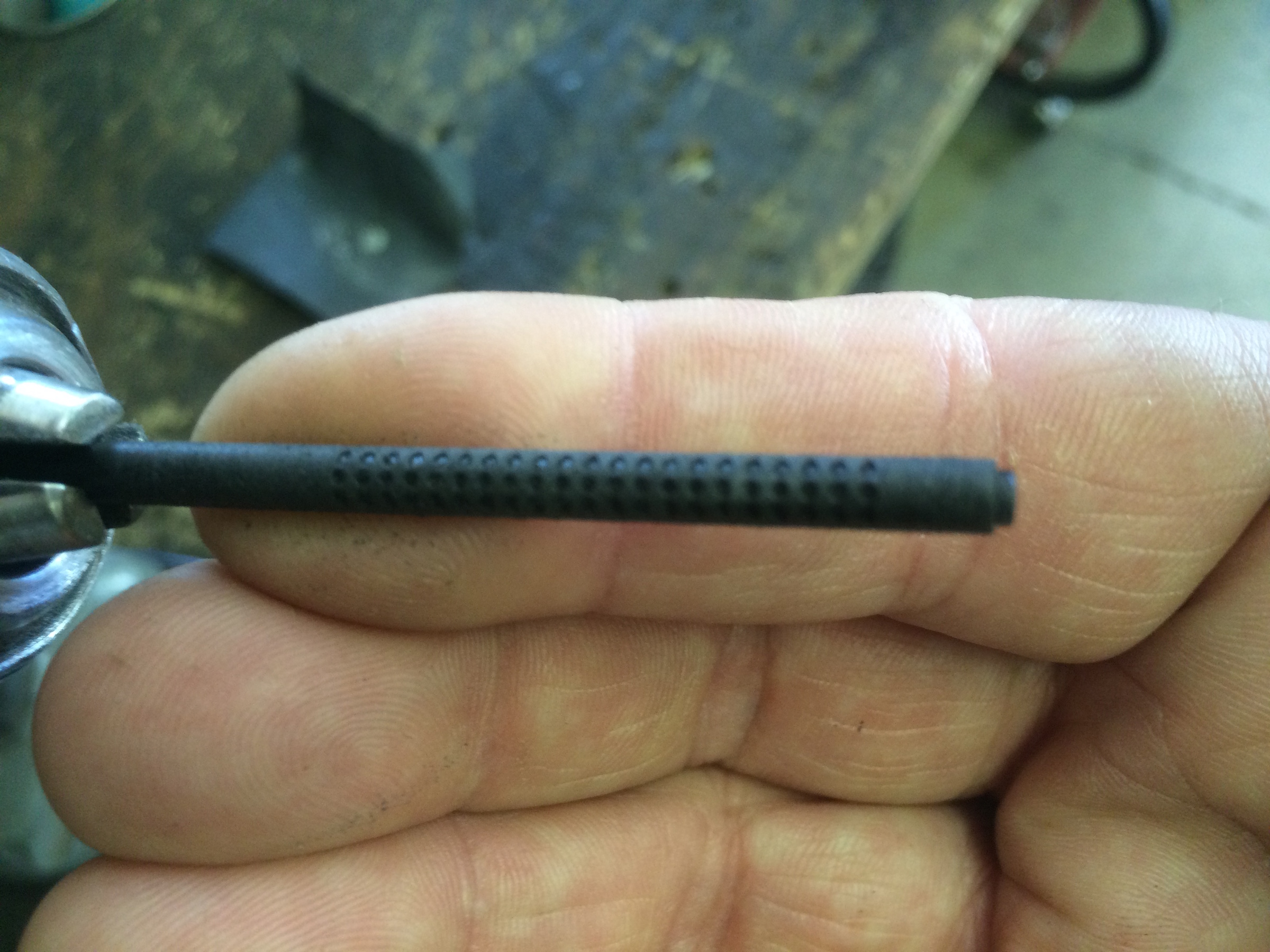

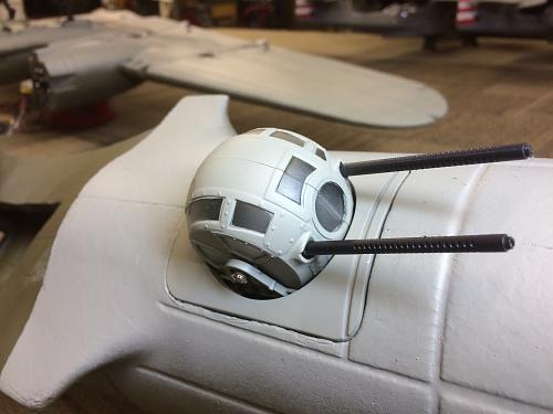

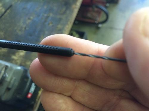

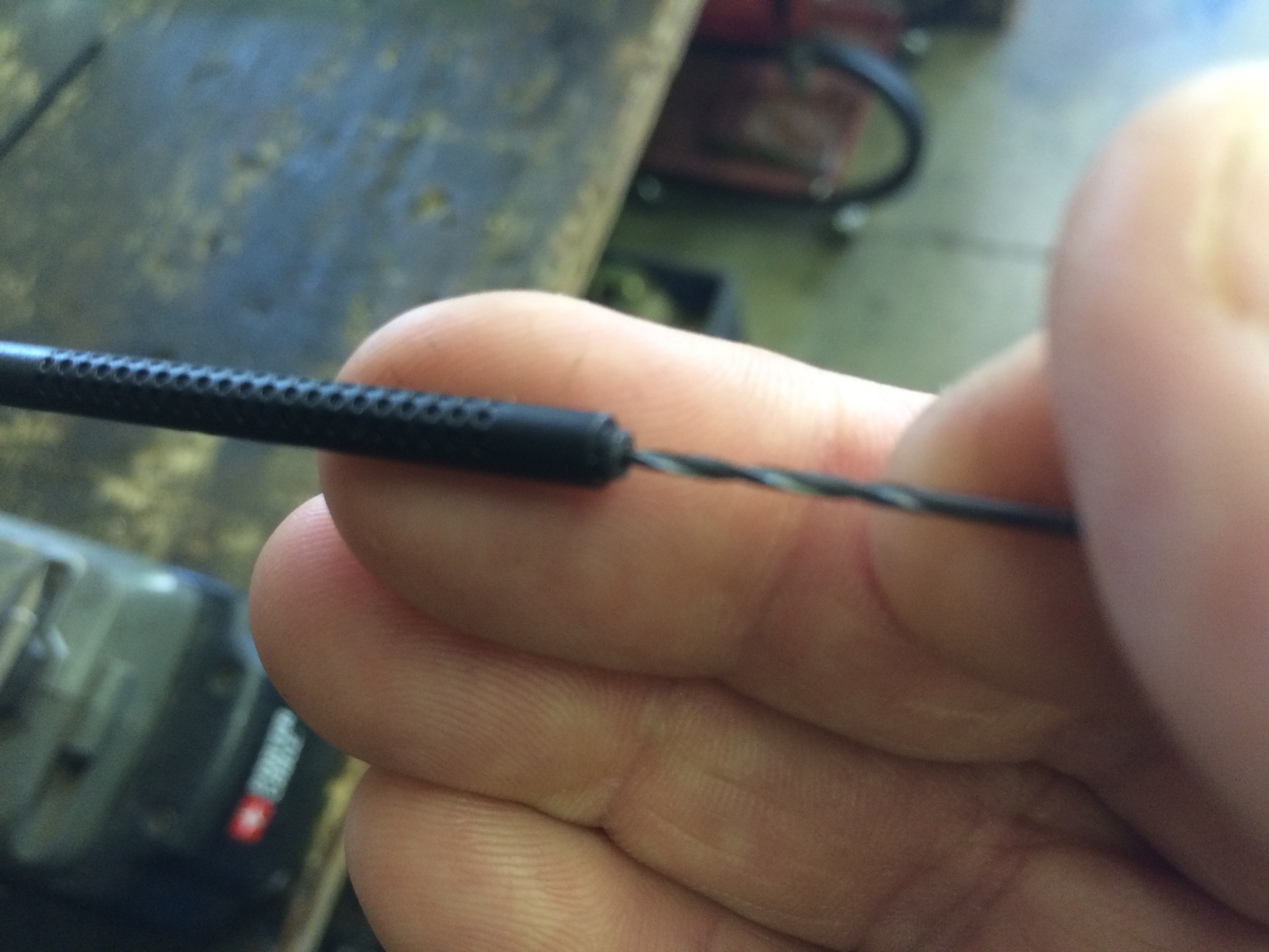

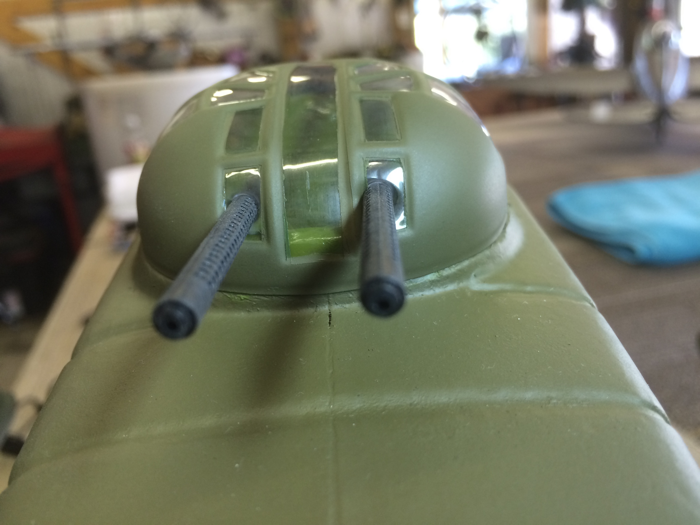

            I like to drill the gun barrels then sand them to make the vent holes stand out.

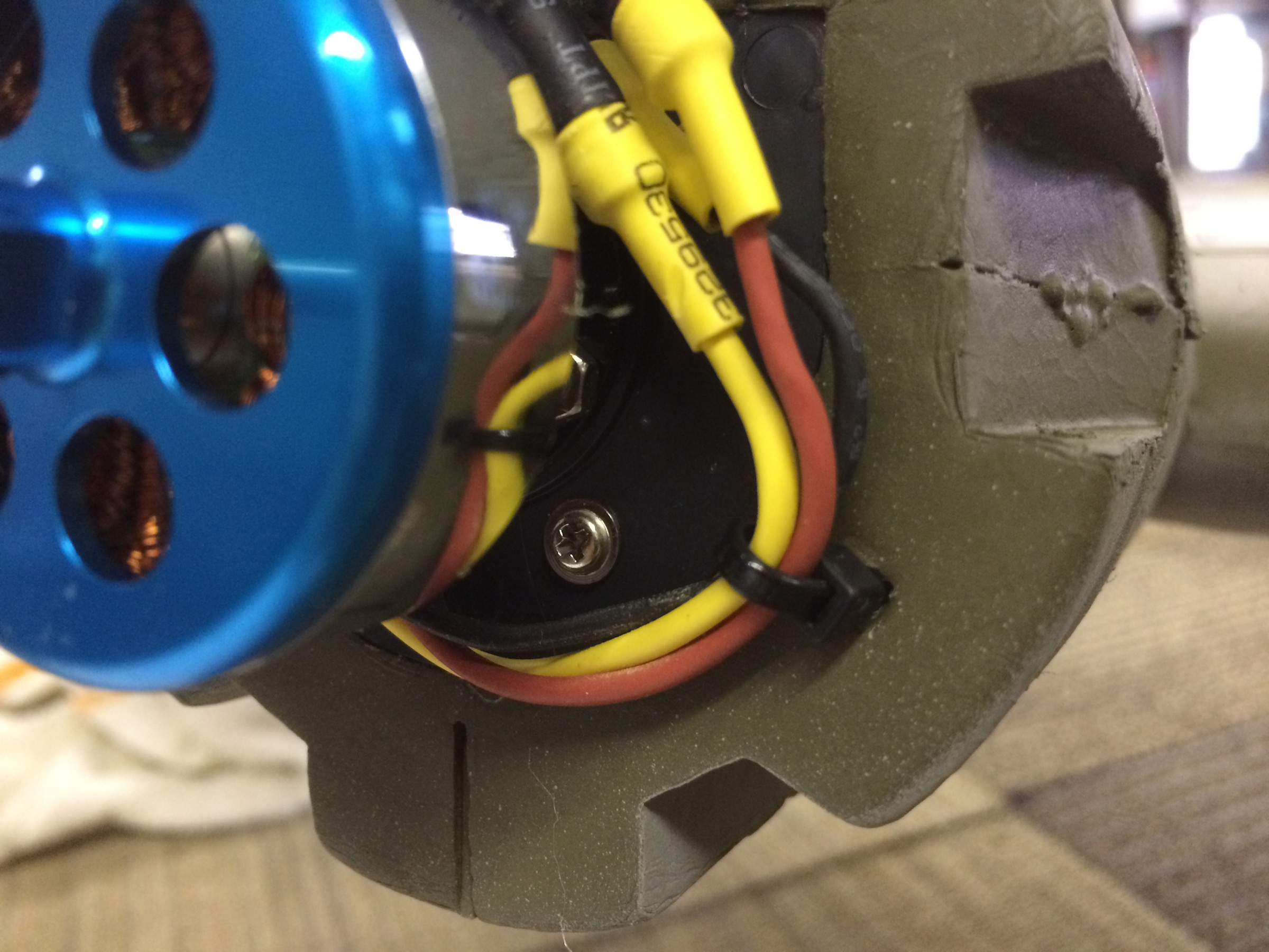

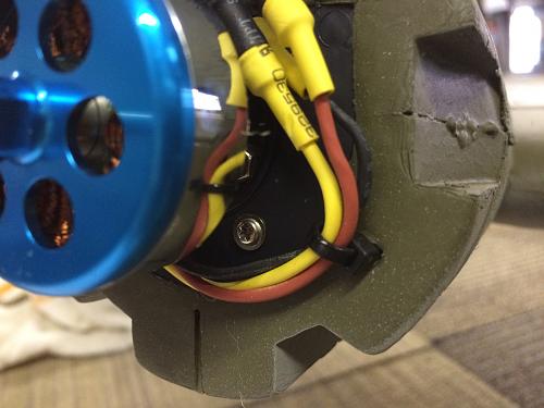

            To hold wires in place I use small wire-ties and leave about an inch sticking through to push into the foam, I usually put a drop of Foam-Tac on it as well.

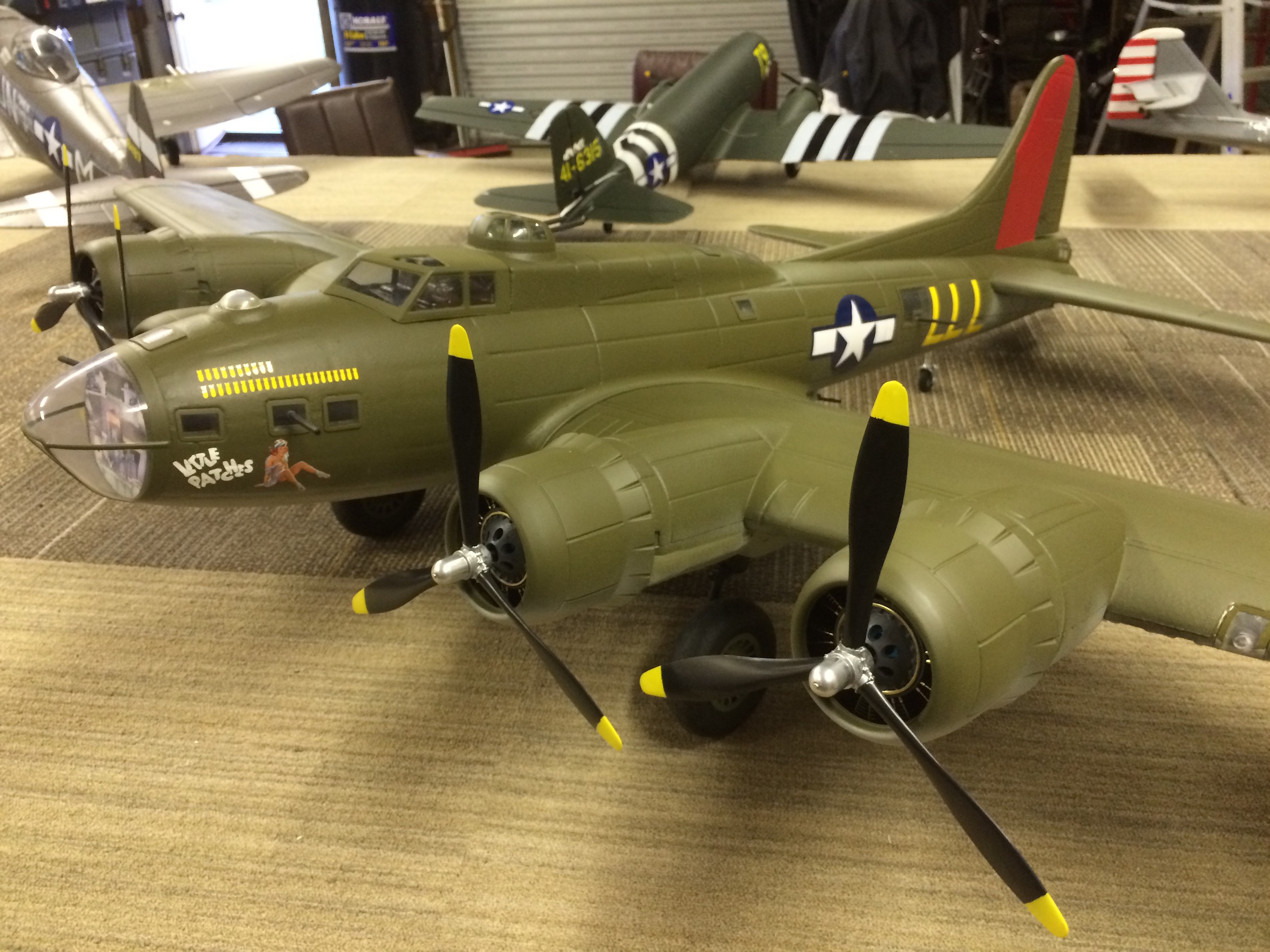

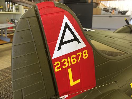

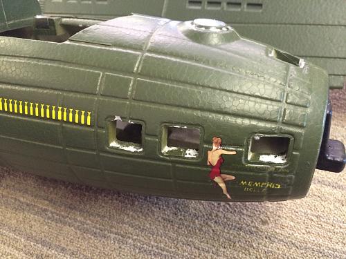

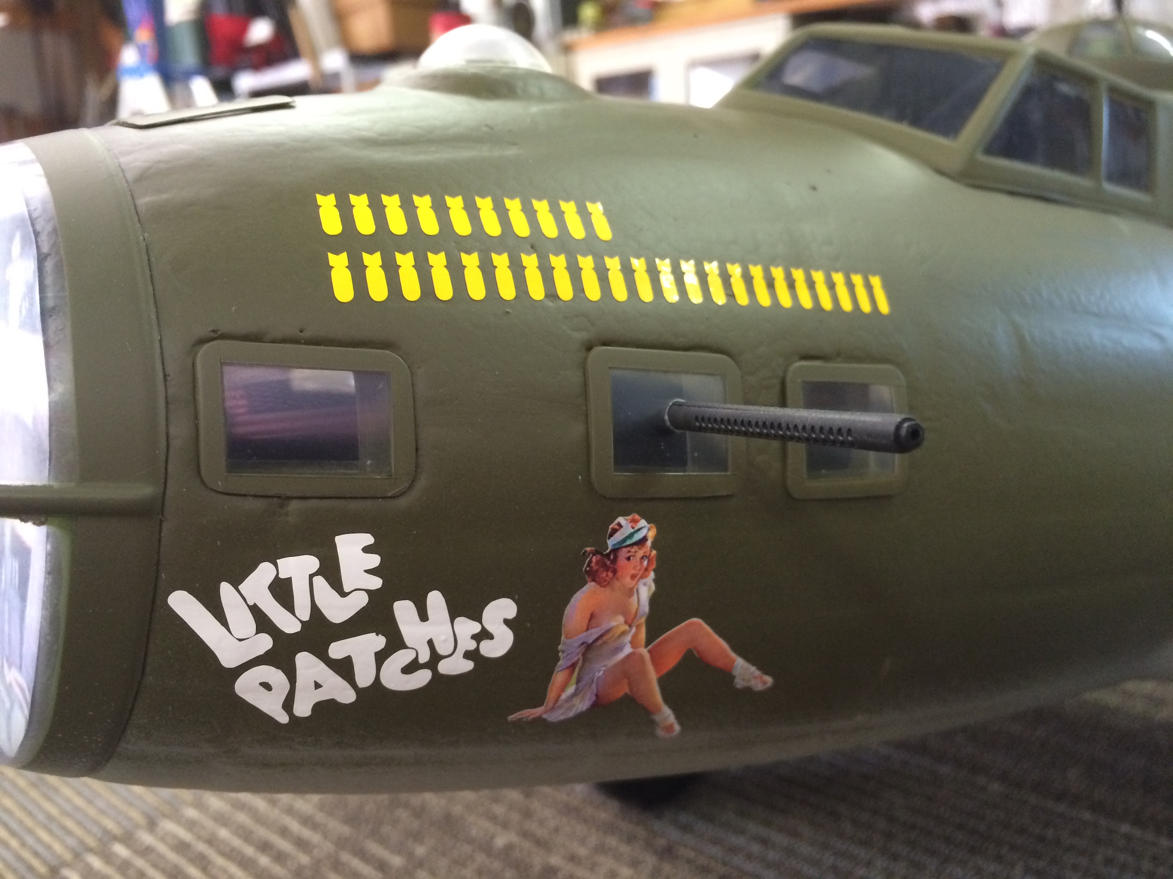

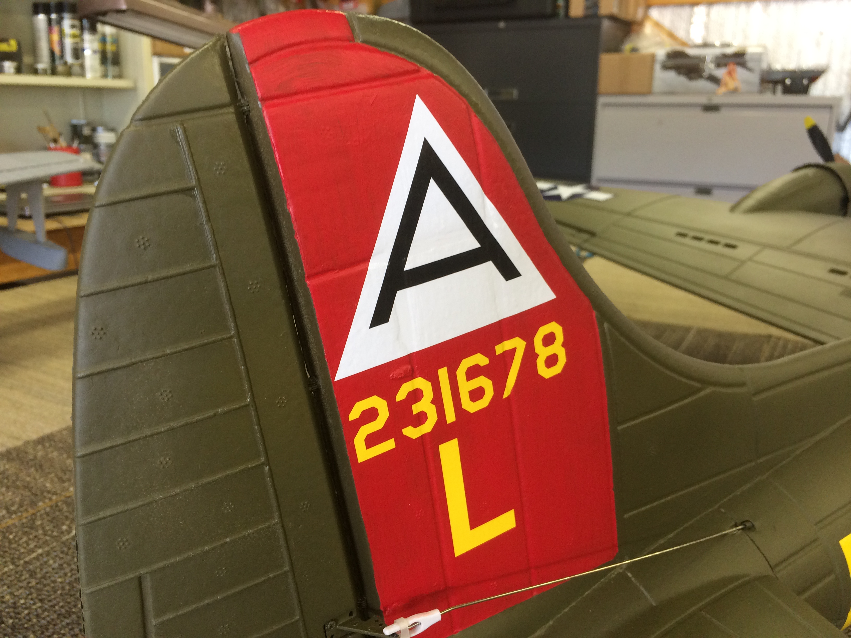

            Started adding graphics from Callie.

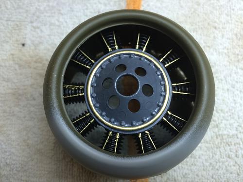

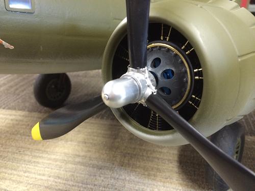

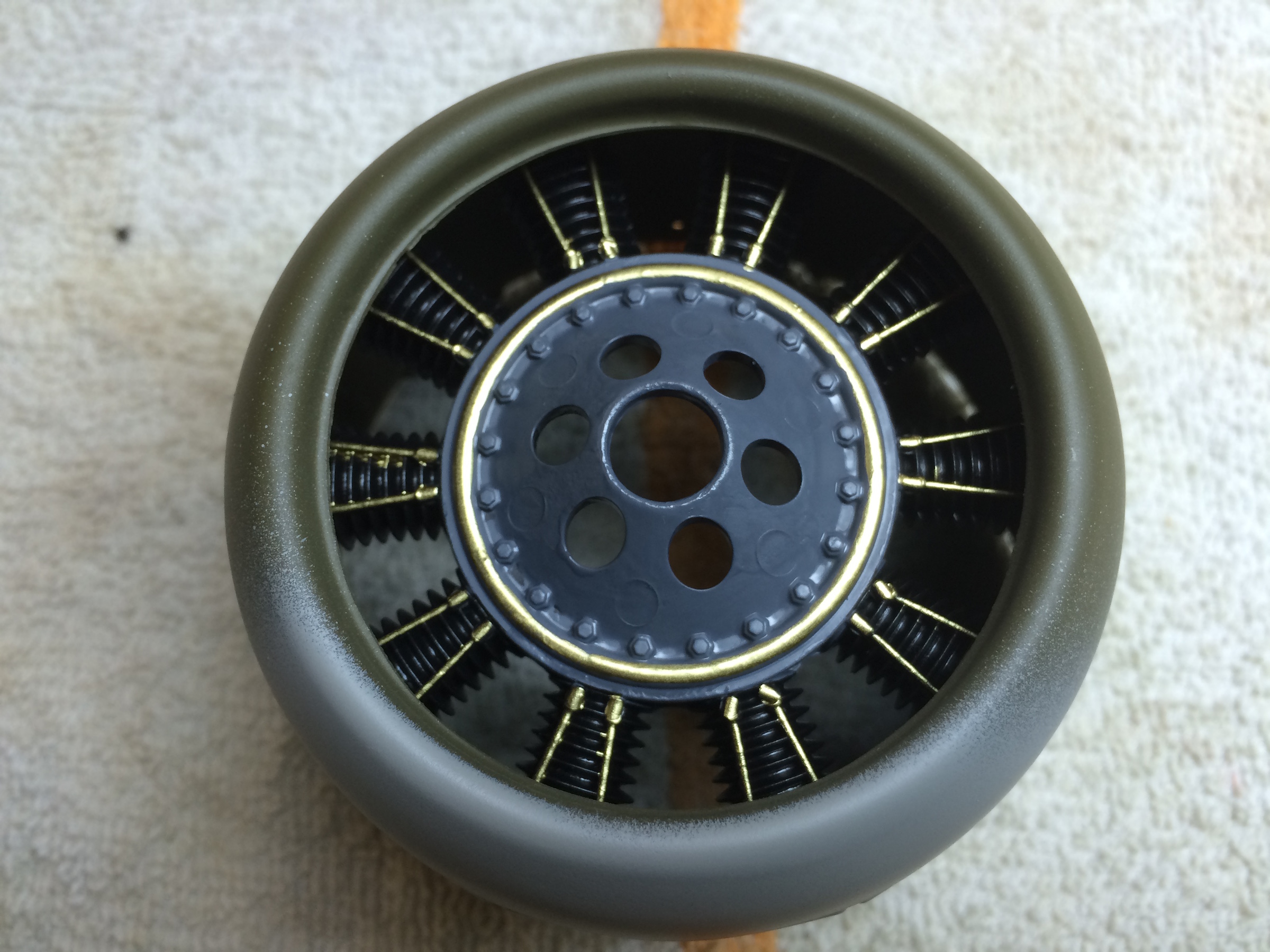

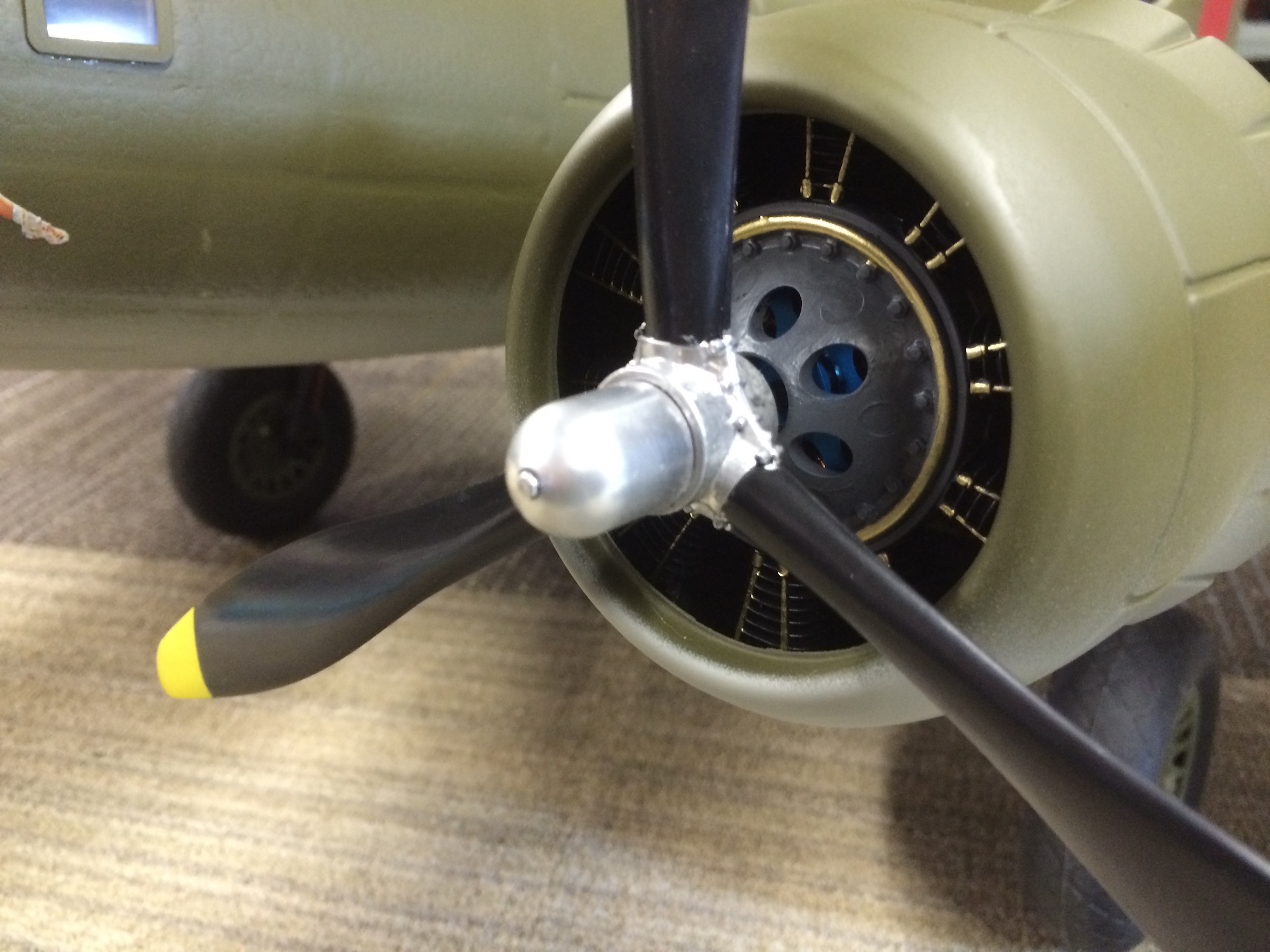

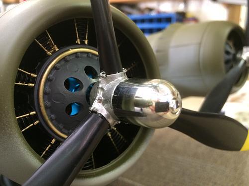

              Detailed the engines and props.

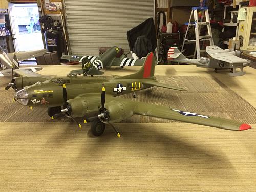

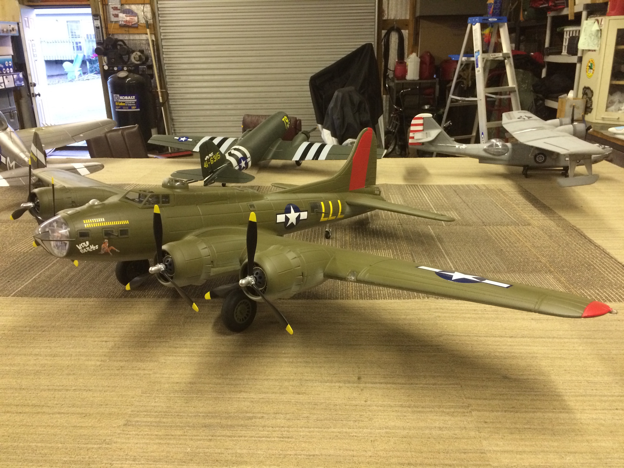

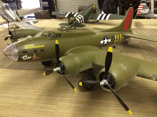

              Almost done, waiting on a few more graphics from Callie.

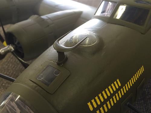

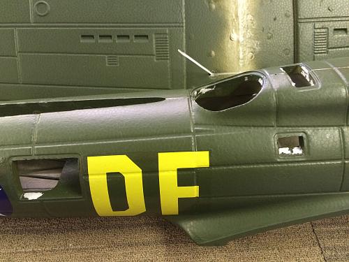

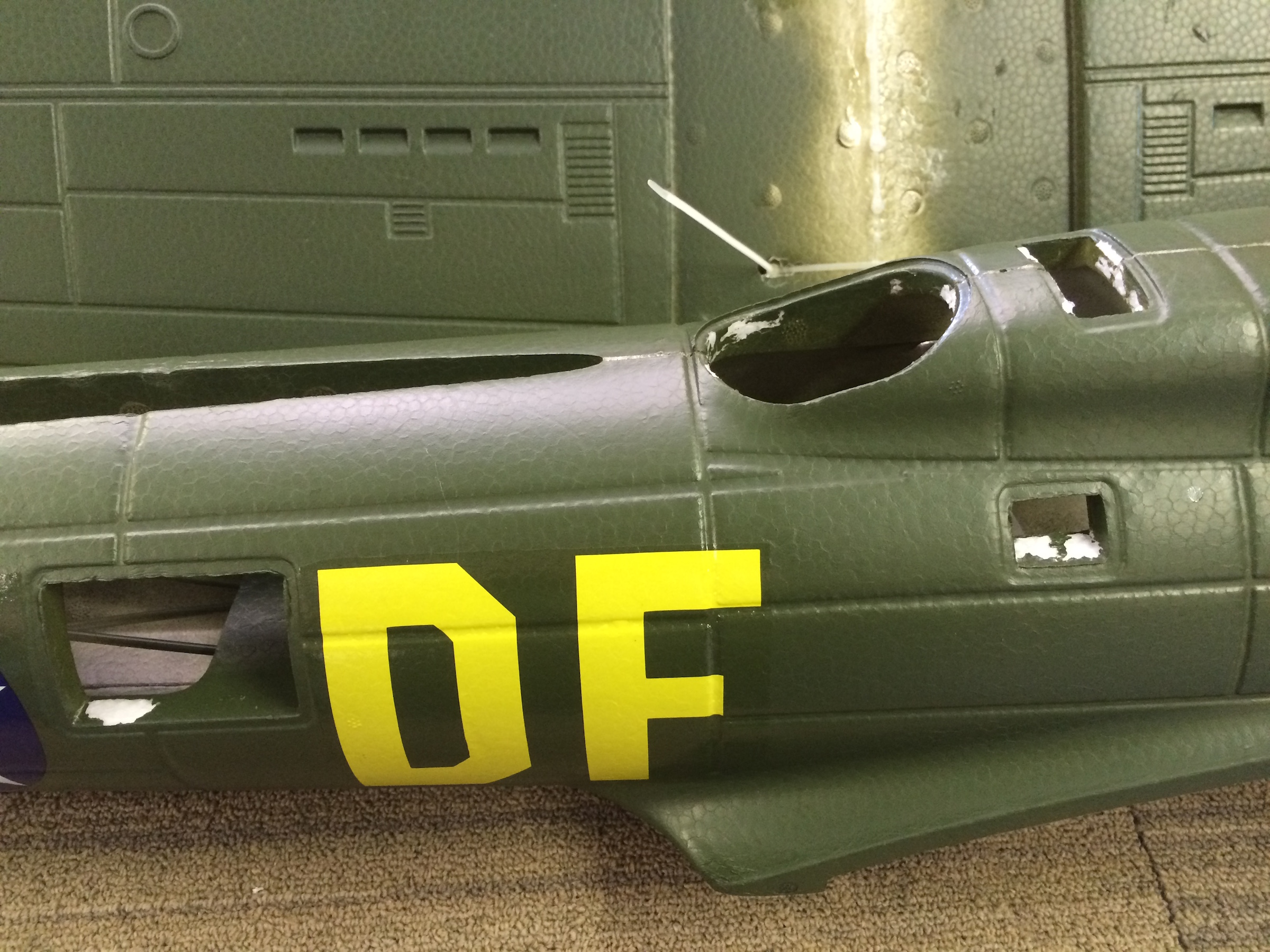

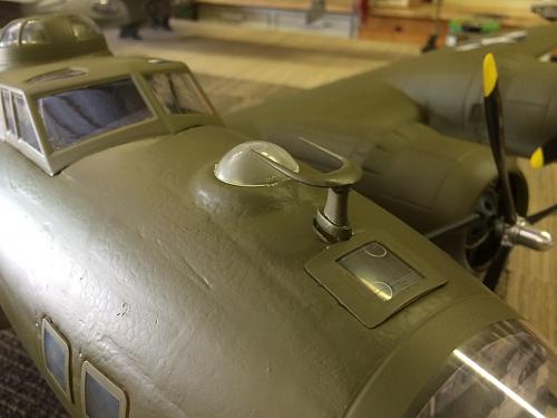

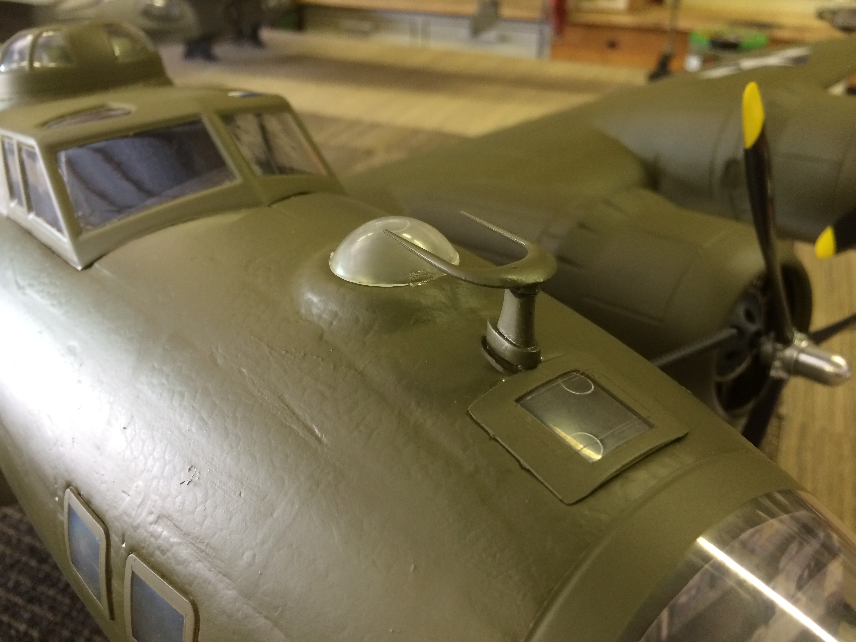

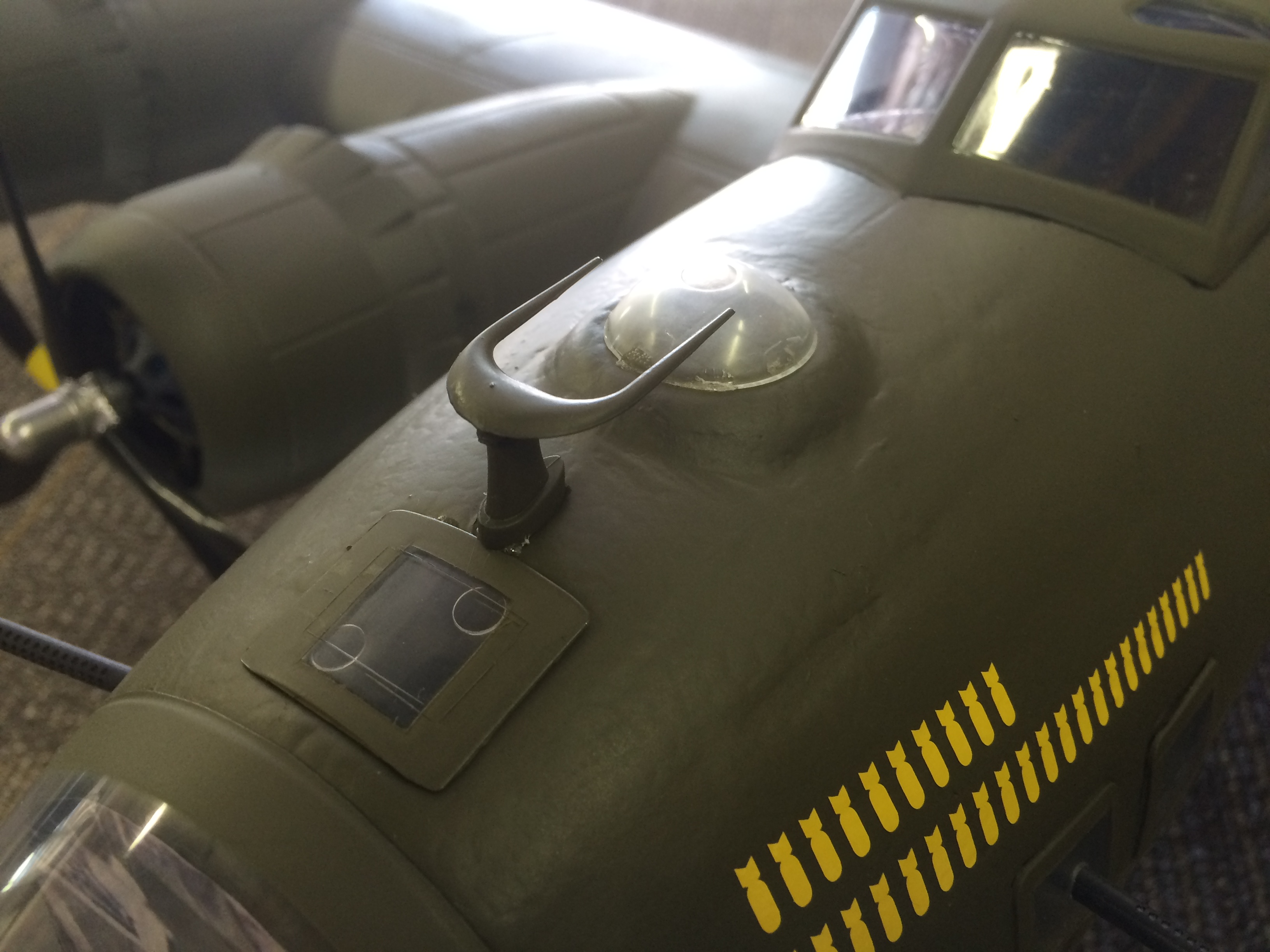

                                        Added an antenna from a Dynam C-47...
                                        ...got some more graphics in from Callie...

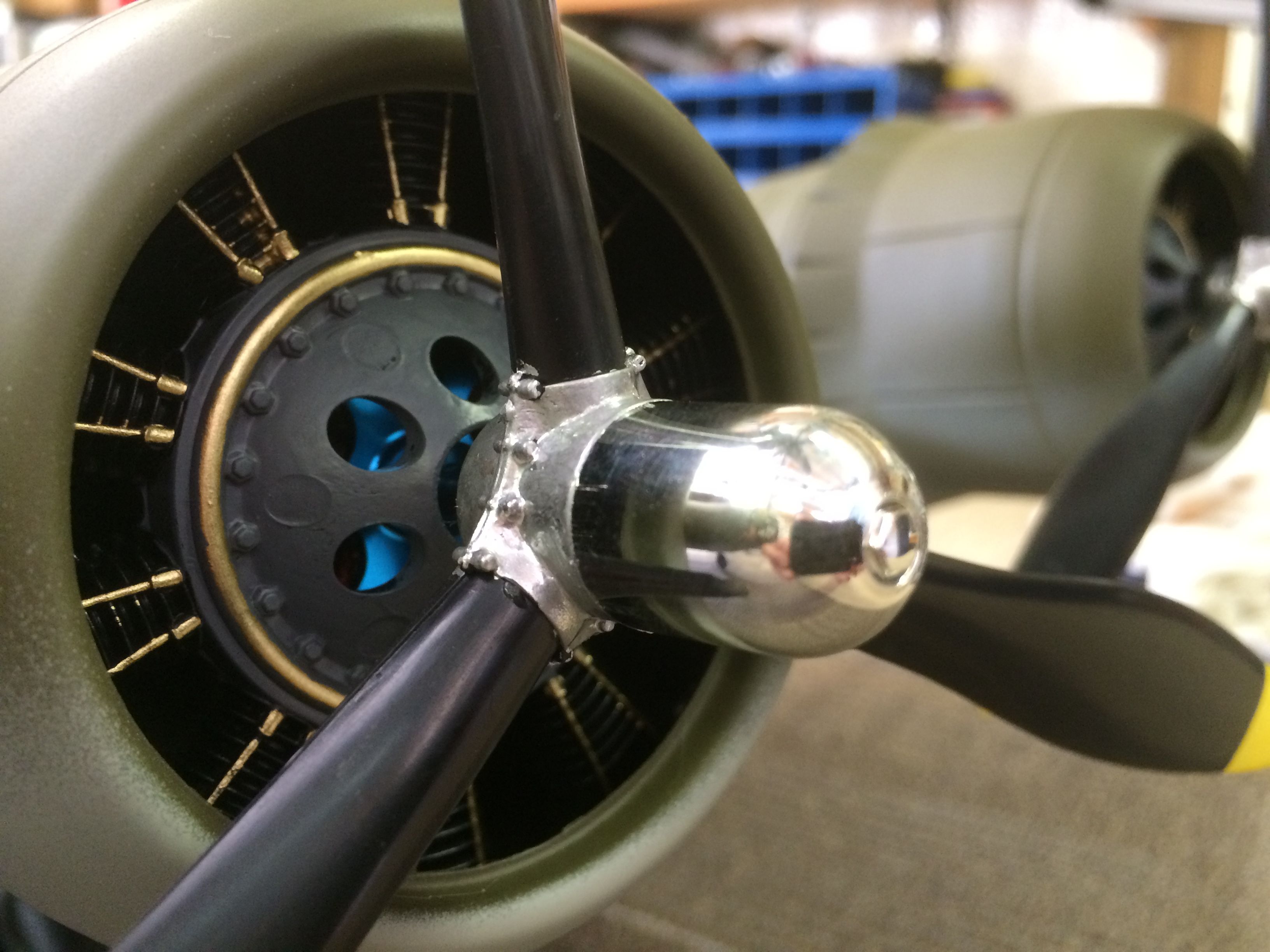

                                        ...and some chrome spinners.
