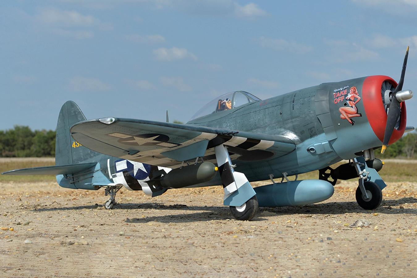

    Overall, this is the best giant scale warbird I have owned. I am an experienced builder, and found the quality, fit and finish of this plane exceptional; equal to that of the best 3D ARFs by Flex and Extreme Flight. I installed a DLE-55 with a Bisson muffler. Perfect power combo. Maiden was flawless. This plane is extremely forgiving, with a very low stall speed and when it does finally stall, it is a very low speed and level stall. I painted the rudder red, added custom graphics to mimic the P-47, Big Chief, made my own more scale 50 caliber machine guns out of 5/16" brass tubing, and added my own detailed dummy R-2800 engine and scale pilot. All else is stock. The only negative was the installation and adjustment of the tail wheel doors. I am used to pneumatic retracts. It should be better explained in the instructions that the retracts work on a resistance-based automatic shutoff. There is no way to adjust the tail wheel door linkages to accommodate the full retract excursion limits. You have to set them based on the geometry of the doors and let the retract controller turn off the retract travel based on the resistance once retracted and the doors are shut. If the builder is not familiar with that concept of giant scale electric retracts, then this is a very tough thing to figure out. As mentioned in other reviews of this plane, the covering will wrinkle if left out in the hot sun for even a short period of time. I recommend a sun shade when not flying.
