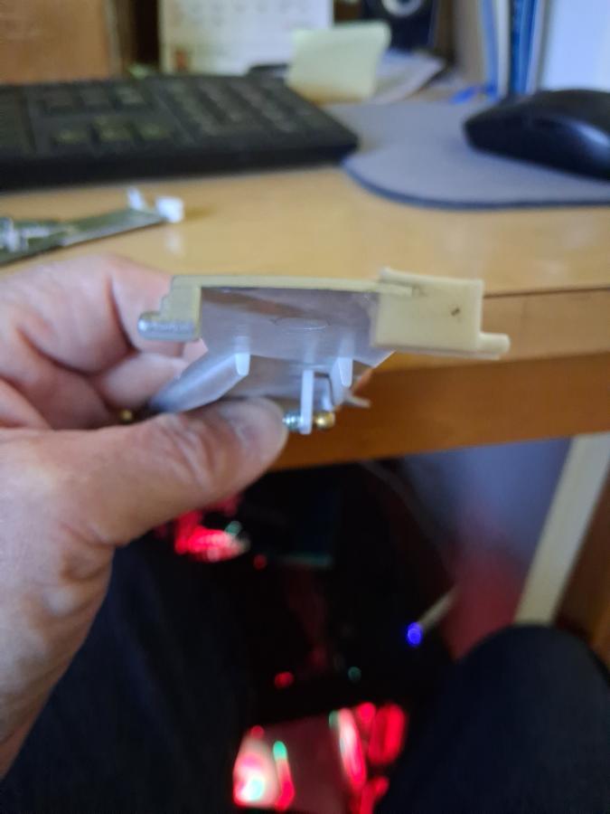

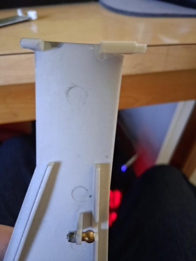

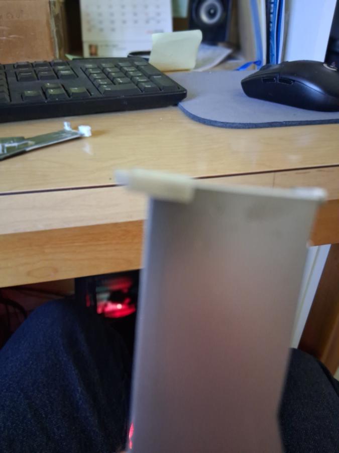

    It just slides over the existing door and glues into place!
ID:	449720 Click image for larger version
ID:	449721 Click image for larger version
    So simple! It took a little sanding and scraping but it works, a little E6000 and when she's dry they should be usable. I enlarged the slot slightly to allow an easier fit, but these worked very well.
