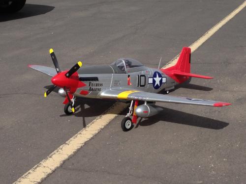

2-15-14 A beautiful day in Albuquerque, NM. 72 degrees and partly cloudy sky's. Steady 5-10 mph breeze right down the runway. Made a few changes to my 1400 T28 and spent most of the day sorting them out. After a few flights it was back to it's normal self and flying on rails. I took the new 1450 V8 Mustang redtail and was trying work up enough nerve to take it up. Just about that time the winds picked up a little more than I like so I didn't fly it. Our club president with 30+ years experience asked if I was going to fly it and I told him it hasn't been in the air yet. He offered to take it up and trim it out for me. So I agreed and we were off to the runway. Taxi was perfect, lift off was perfect and it was flying. Only a few clicks of up elevator and a few of right aileron and it was dialed in.
He was very impressed with the plane and how will I did setting everything up, ( patting myself on the back )lol. He made flying it look so easy. Winds came up a bit and I decided to keep it on the ground until tomorrow. I want my maiden flight on the P51 to be perfict. He also trimmed out my friends new V7 P51 which also hasn't flown, with even less trimming than mine and it was dialed in. So we both will be at the field bright and early in the morning to give it another shot. Just hope the winds hold off for a while as I'm iching to fly it.

Hello everyone. I got 6 flights on the red tail now and couldn't be more happy with her. She's proven the be very popular at the field and in the air. A photographer came to the field the other weekend and took a ton of photos of all the planes and 20 photos of my red tail P51 posted on Flickr.com/slinehan99.
The weather this weekend was crappy and next weekend is supposed to be as well, so not much flying going on. I'll keep everyone posted.Tootall505 (Chris).

Hey. Another picture perfect day in New Mexico. 80 degrees and 5 to 10 mph breeze right down the runway. Got 45 flights on the red tail now and all is well. Had an issue with retracts for a while but got that sorted out. I put the 580kv motor from my crashed T28 ( after receiving my new t28 ) in the Mustang. It does improve on the static numbers on the power meter, ( from 58 to 65 amps and 810 to 920 watts) but I don't really notice much speed difference in the air. My flying buddy put the zip tie mod on his prop with the 540kv motor and says my Mustang is faster than his but I don't see that much difference. Might try a 2 blade prop just to see. I like the 4 blade for the scale appearance.Tootall505 (Chris).
