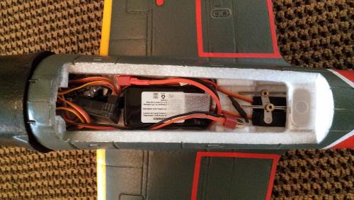

    I just got the mini Zero (v2) and just wanted to check with anyone else who has one to see about cockpit configuration and battery placement.
    1) That space is so small I've literally taken 30 minutes to even find a way to get reciever, ESC and battery in there. If I want to cut out some foam, where to do it, as it seems I might cut into the actual pilots cockpit by doing so.
    2) I'm finding the plane to be quite nose heavy out of the box, but again am reading people talking about adding nose weight. Currently I have the ESC and the receiver stuck up in the nose, and the battery, a 1000mha 2S, basically center of the cockpit right in front of the servos. This seems to be the only way everything will fit in there and when balancing the plane, it seems spot on. I attached a picture. Just kind of scared for the maiden since everyone talks about shoving the battery way far forward.

    I have the Zero, and love flying it, but I made a couple of changes to mine. First, I did end up adding some weight to the nose to get the CG where I wanted it. I very possibly have made it nose heavy because it does not float much at all, and comes in for landings pretty hot. I will probably start removing about .25oz at a time and see how it affects the flight. I also switched to a 2 blade prop, an 8x6 to avoid the expense of replacing that nice scale prop every time it came in on our grass field. On mine, I placed the receiver and ESC where it appears that your battery is located, and I push the battery (1300mAH 2 cell Admiral) as far into the nose as I can get it. All of it fits well, but kind of tight and it can take a bit of fiddling with the battery wires to get the canopy to close tightly.

      I've tried the battery up front and balanced according to the factory prescribed CG (those red dots on the top of the wing) but the thing is literally rock solid nose heavy in that configuration.
      Is yours a V2? I'm just worried that they put a ton of weight in the nose based on feedback.
      What to do? Maiden it with what my CG calculates out as with the battery back or go with what it seems 100% of people say with throwing the battery up towards the nose?

        Yes, mine is the V2. My CG is about 3/4" in front of those red dots, and like I said, I am a bit nose heavy, but the plane flies fine. I have plenty of throw left in the elevator. The only issue with mine is that it does come in hot for landings. Just for a comparison, I just checked mine, and even without the battery in the plane, I am nose heavy based on where you are wanting to balance your plane.

          I re-arranged everything and had to cut out some foam to make everything fit. But you are right that with the battery up front and calculating CG a bit forward of those red dots it does balance perfectly. So I'm going to go with that.
