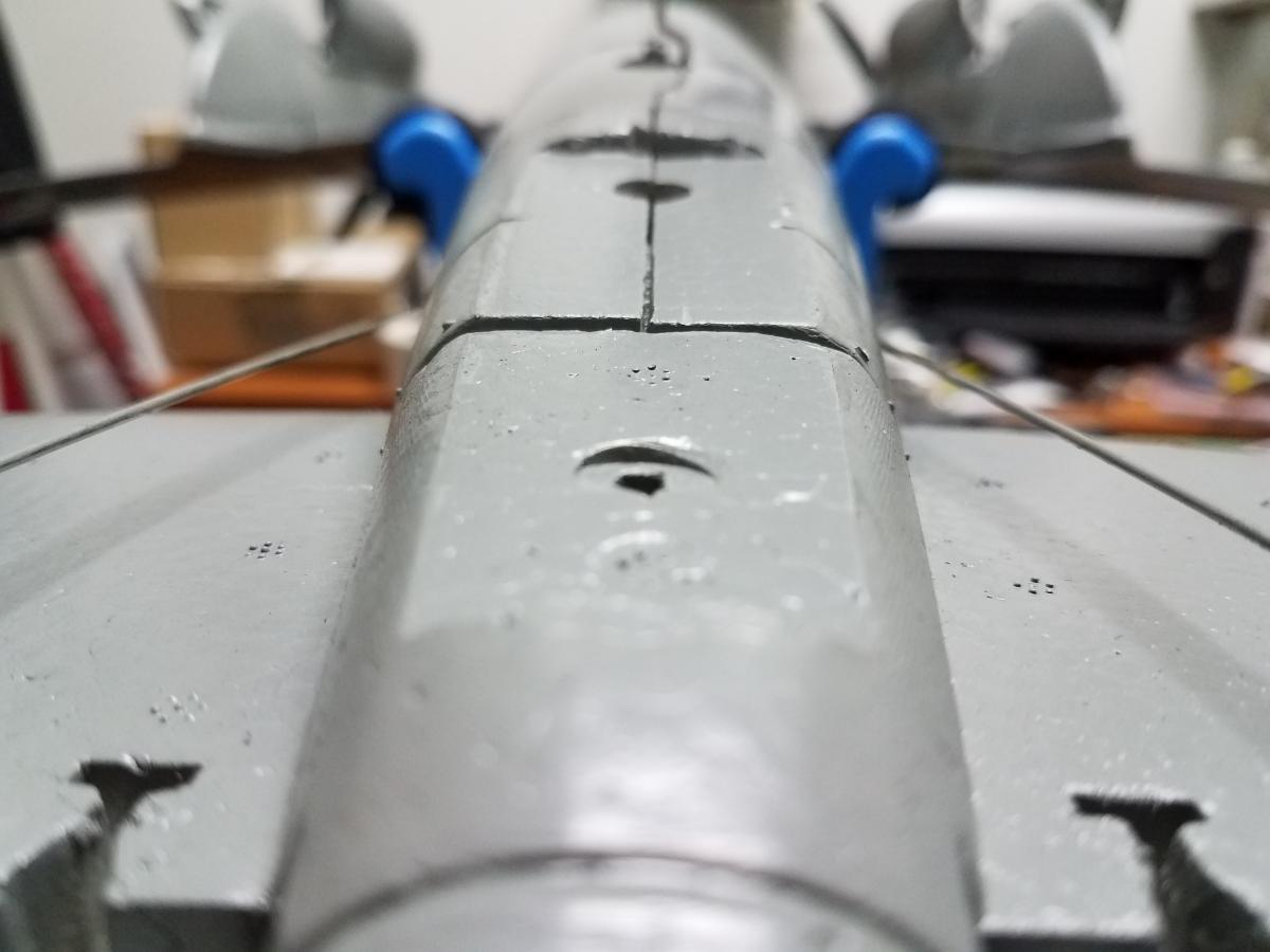

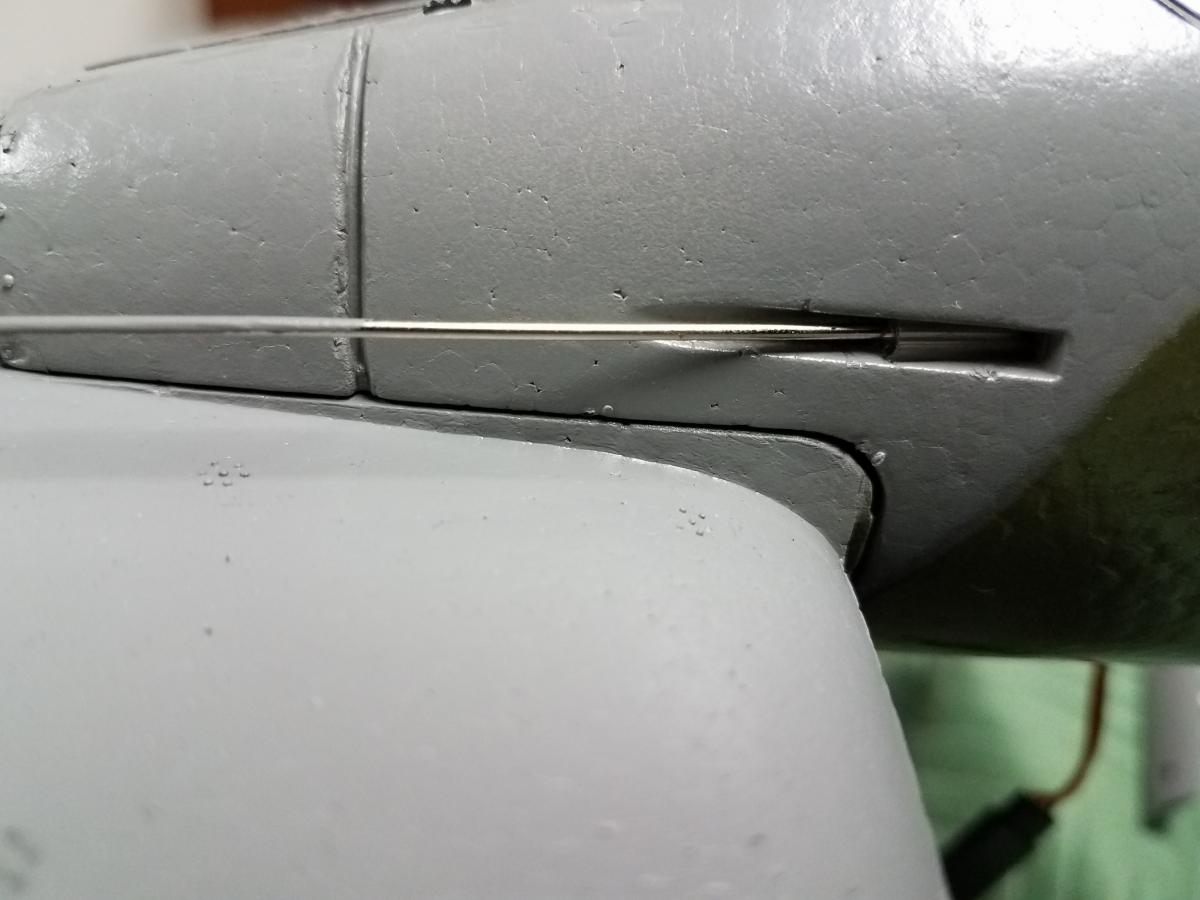

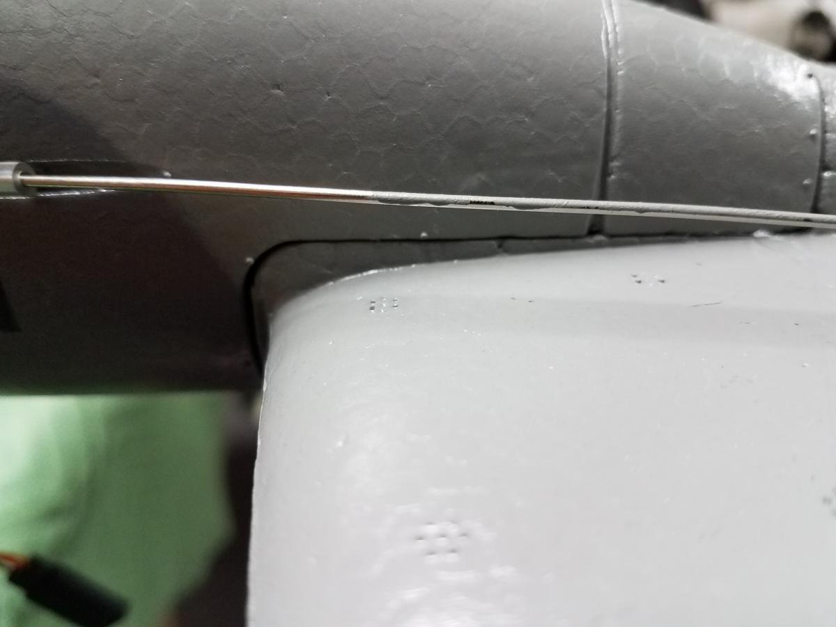

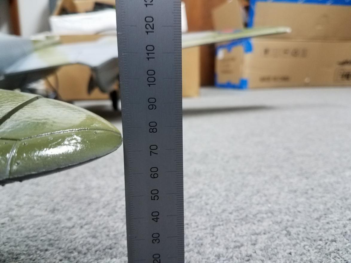

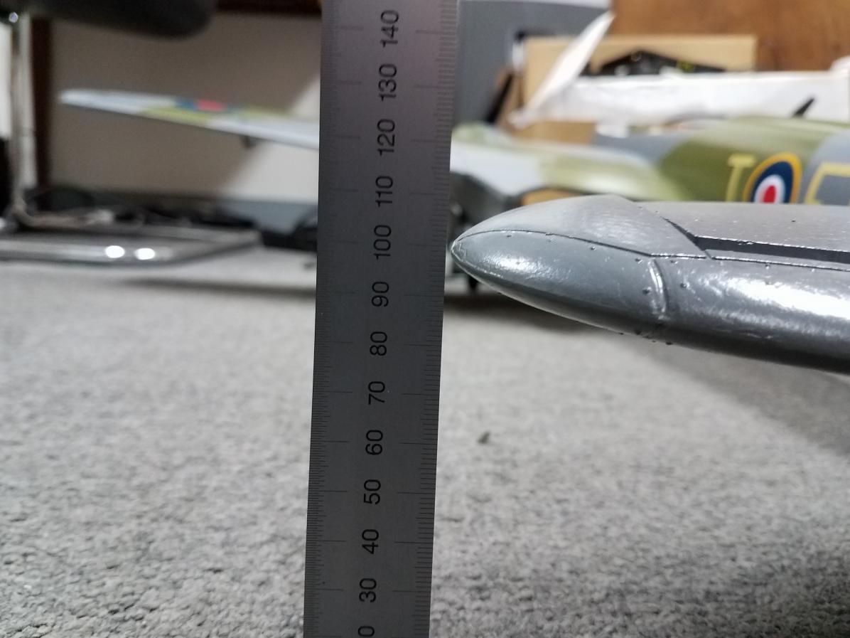

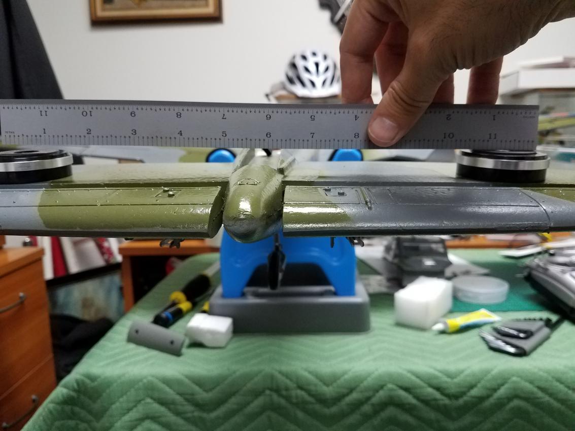

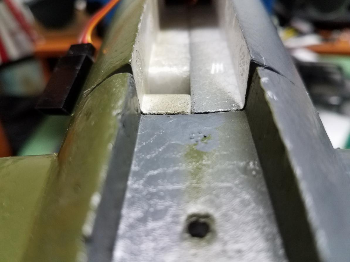

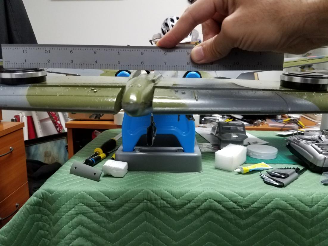

    Got my Mosquito done a couple of weeks ago. Weather and my schedule haven't been syncing. But I did take it out last Wed to do some taxi tests. It was the first time I had it on the ground and not up an a stand.
    I noticed the Horizontal Stab wasn't level. So figured I'd messed up installing it. However on close inspection the mount point is tight and flush on both sides.
    My next thought was the mating surfaces weren't level. That didn't make me happy as I had foam-tac'd the H-stab into place. But before I went trying to pry it apart I figured I try to see if the 2 sides of the H-stab were off....turns out they are.
    So I am not all the experienced with this sort of thing. Will this effect flight in a real way? Or is it something that once she is trim'd I won't notice it? Or should I be getting a new H-stab?

              The H-Stab being off didn't cause a problem, once she was trimmed out flew just fine. Right and Left turns and rolls are not noticeably different.
