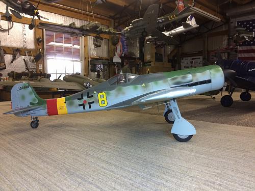

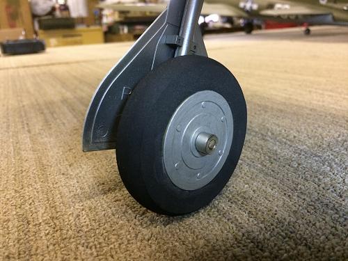

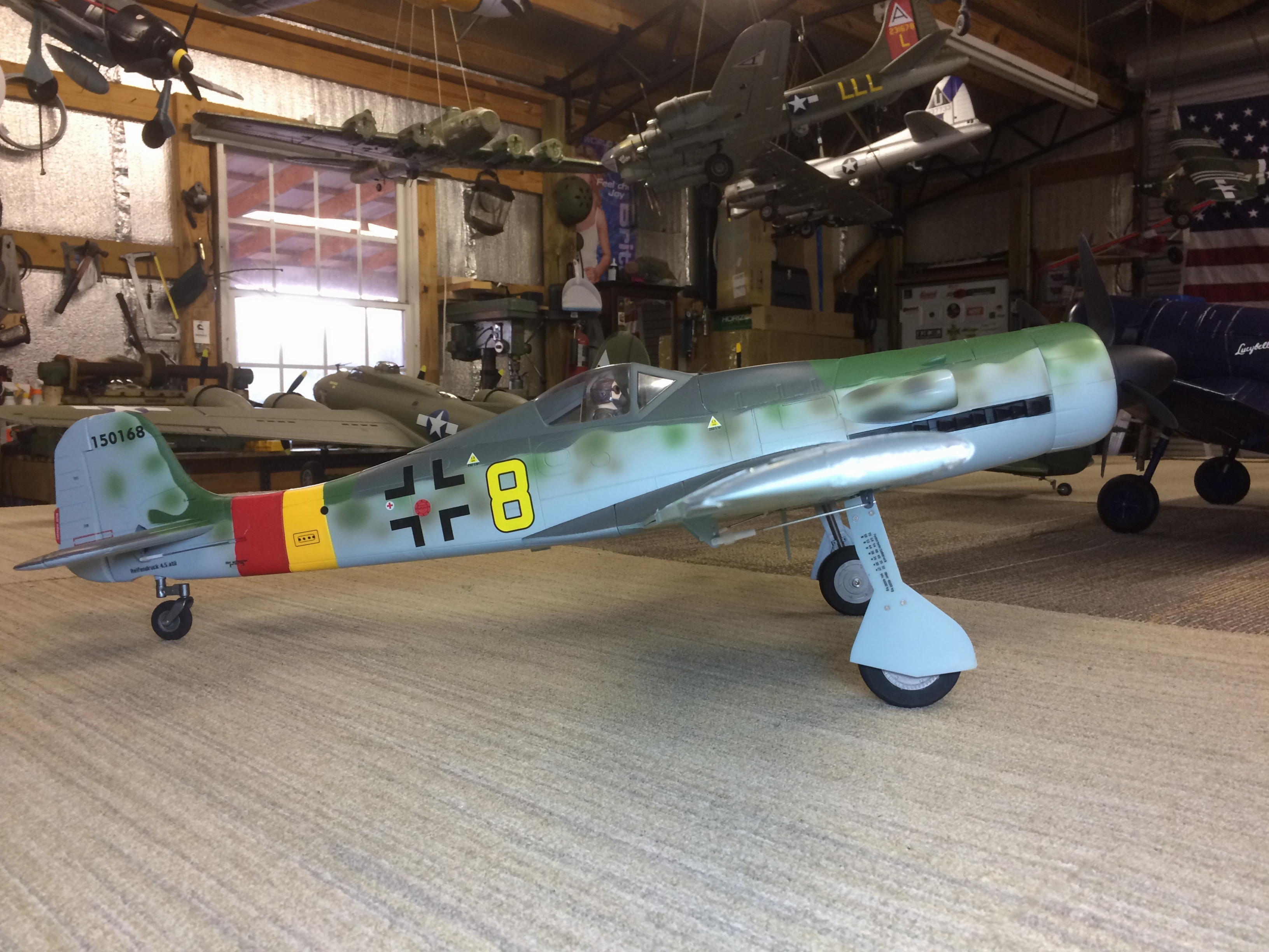

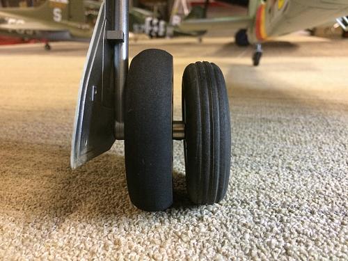

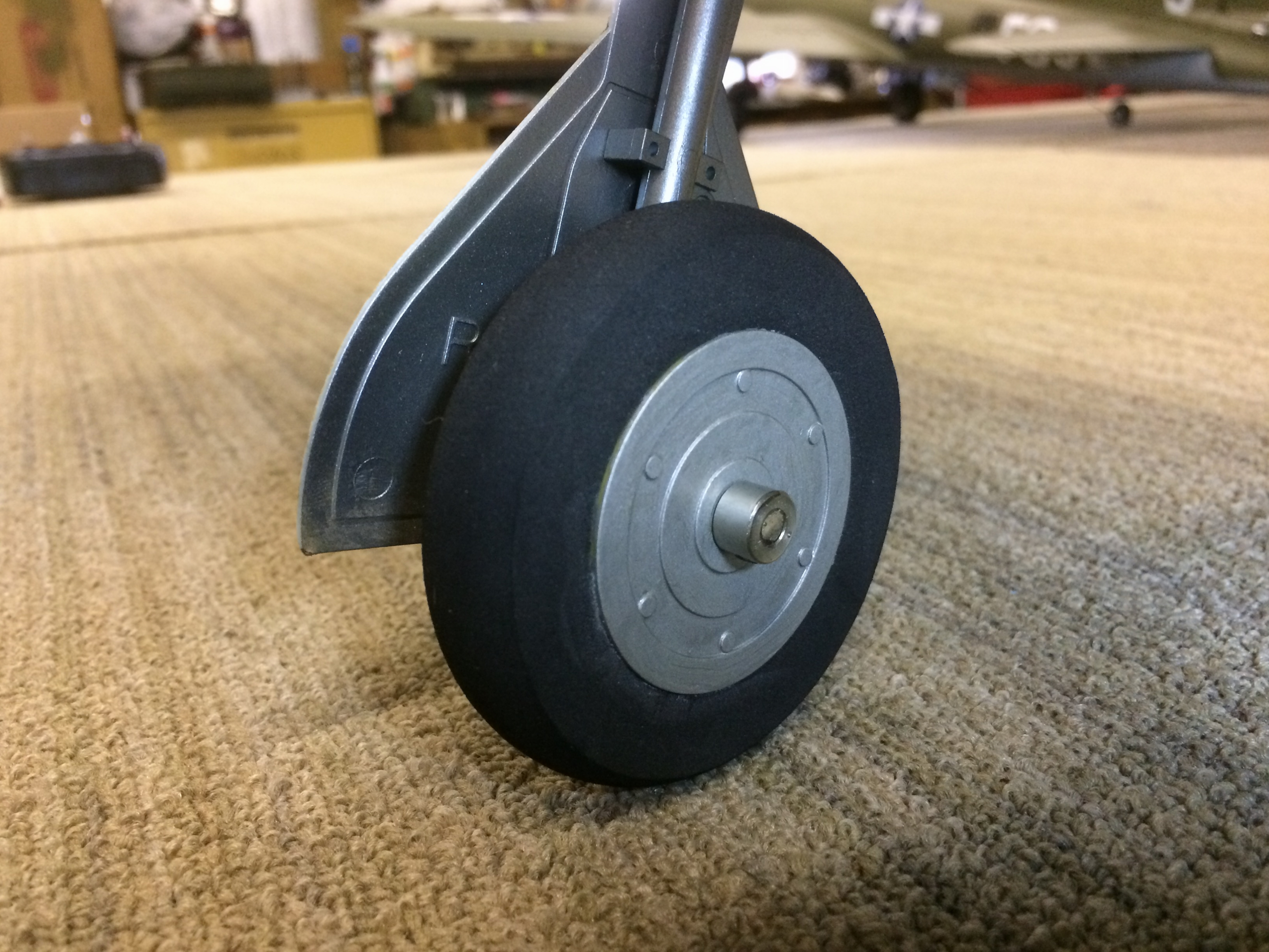

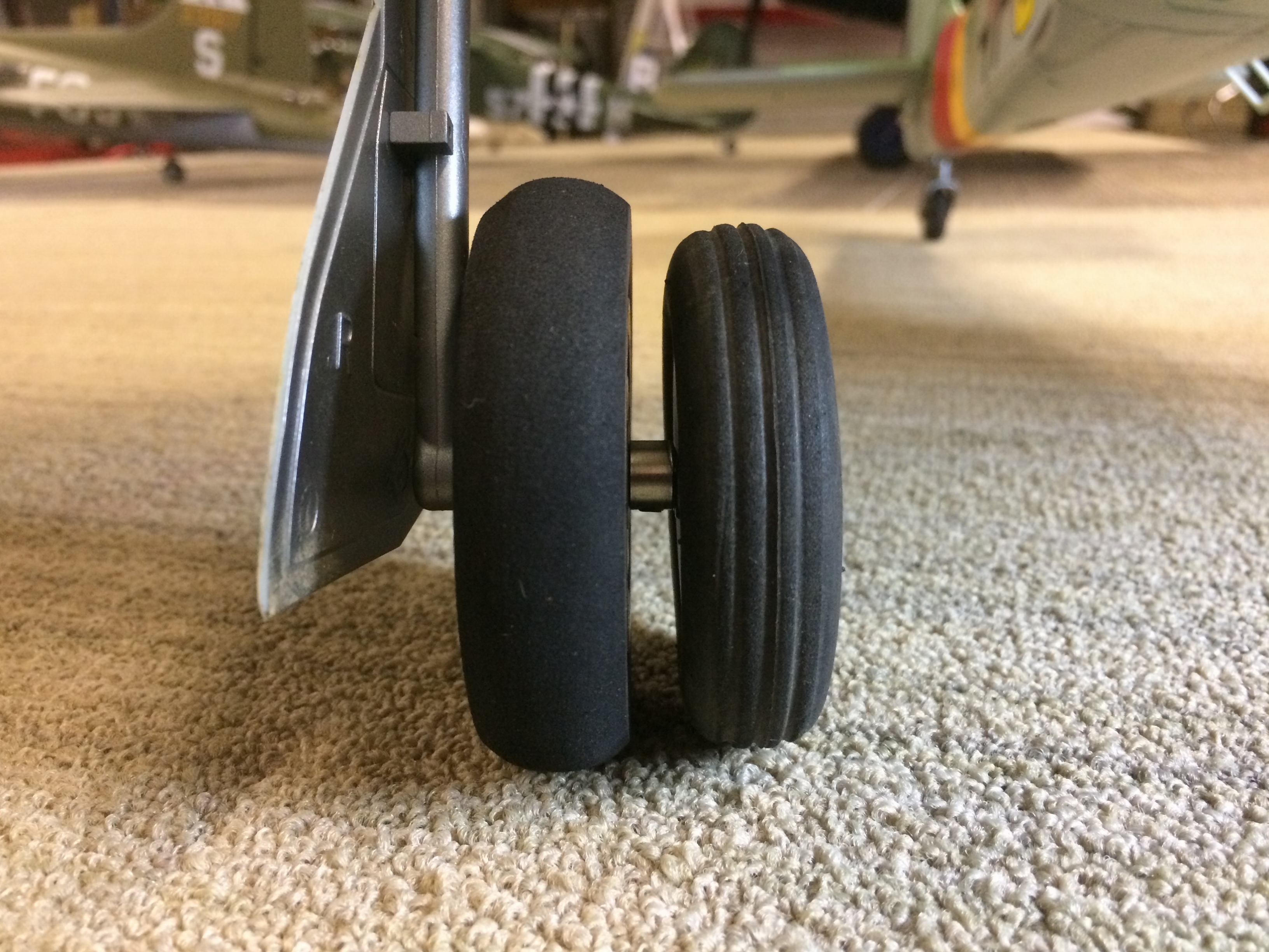

    I love this plane but fly it mostly on a grass runway where I'm about 50/50 on landing without nosing over so I started looking at tires that would fit without trimming the wheel wells.
    I found that the Dynam Corsair/Hellcat wheels fit perfectly and are 72mm (Stock TA-152 are 65mm), this has improved the ground handing immensely.
