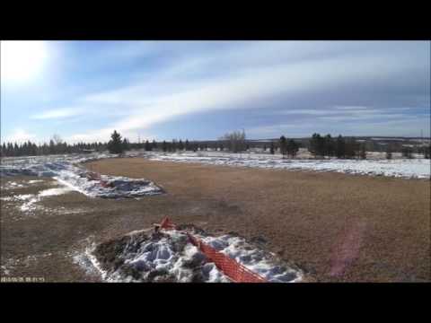

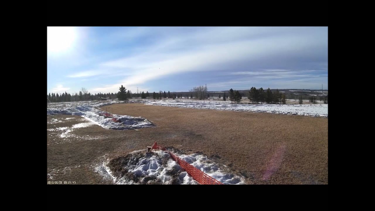

      https://youtu.be/fTYRBNXRNFI. Here's a video of how it takes off now. Here's a takeoff before the fuse was replaced. https://youtu.be/Vl60e3sidZg

          Hmm. It's not exactly clear to me of the difference, when viewed from the inside of the cockpit like that. Based off the timestamps, the takeoff time is very similar... about 4.5 seconds for each? But again, without an external view of the aircraft taking off from the same location, it's difficult to find a smoking fun. Perhaps the thrust line photos will help. Also, did anything else change on the model? Less glue in an area from a repair or reinforcement, different battery or location of FPV gear, taller grass that day, etc?
          A god benchmark would be a takeoff from a paved surface. That would remove grass resistance from the equation entirely.
            Copy that, grass was pretty much the same, battery is same one, 2650 20c 3s, and the fpv gear was just popped from one plane to the other as it's glued to the left front seat.

              FPV for this purpose, is a poor indicator of the difference between the 2 take offs. You need a 2nd person view, ie, a video of the plane against the background as it takes off. 20 mph for this plane, even on 3s, 20C, is pretty slow. I don't know how long a run you have to do this, but 3s power should get this thing off the ground or water in an adequate fashion. Could you have, perhaps, installed the prop backwards? This has been the main cause for a couple of my fellow fliers having underpowered planes. Turn that prop around and BAM, it suddenly has punch. Writing on prop should always face the front. The fact that the motor is in a pod on top of the plane's back, makes it push the nose into the ground/water until it gets up enough airspeed.
