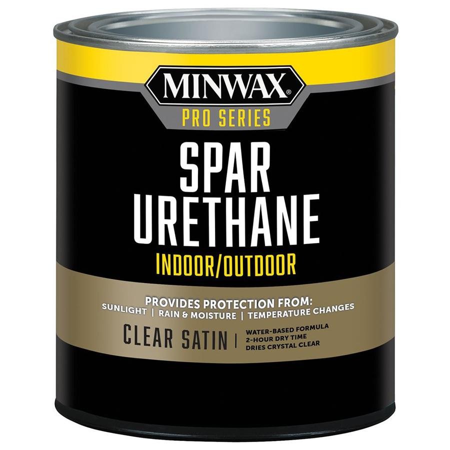

                  Hey Phoenix, I'm thinking that your are running into some spots on your plane that may have some mold release or something else oil based on your plane, possibly from the plastic bags the parts come in. Try putting Minwax on the spots, then wiping it up with a micro fiber rag at let it dry, it takes a matter of minutes in room temp. What happens is the water based Minwax 'balls' up the oil based mold release or whatever it is , the you just wipe the stuff off within the Minwax. Hopefully that will help. Then go get yourself some out door Spar Urethane, water based with a UV protectant. A dark bird like this one is going to need all the protection it can get!!
                  Grossman56Click image for larger version
                  GM Where can I find this at? I couldn't find this at Lowes. I did find and have used the Minwax spar. I haven't looked at Home Depot.

                    #29
                    My Lowe's, Home Depot and Menards did not have it so I ordered it on Amazon.
                      • 7352
                      #30
                      If you can, pick up this for the best gloss finish..
ID:	188377 The can will say clear gloss, but will look just like this, I believe it was Lowes where I bought it, got to pick up some more, great finish, remember brush for glossiest finish, spray gun for duller to dullest finish (when using clear matte Minwax, found on Amazon)
