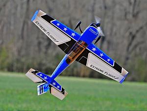

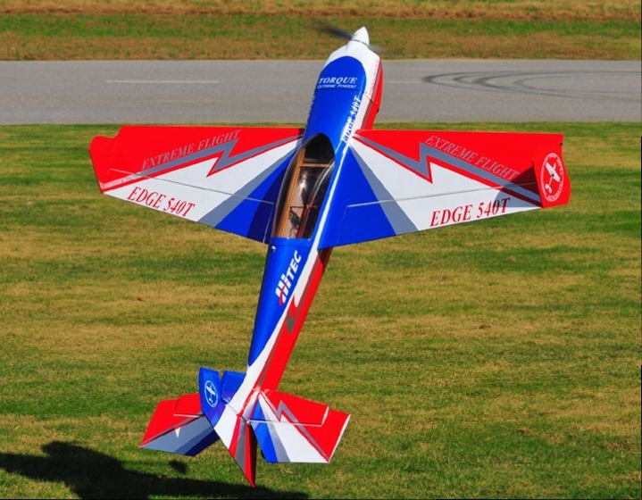

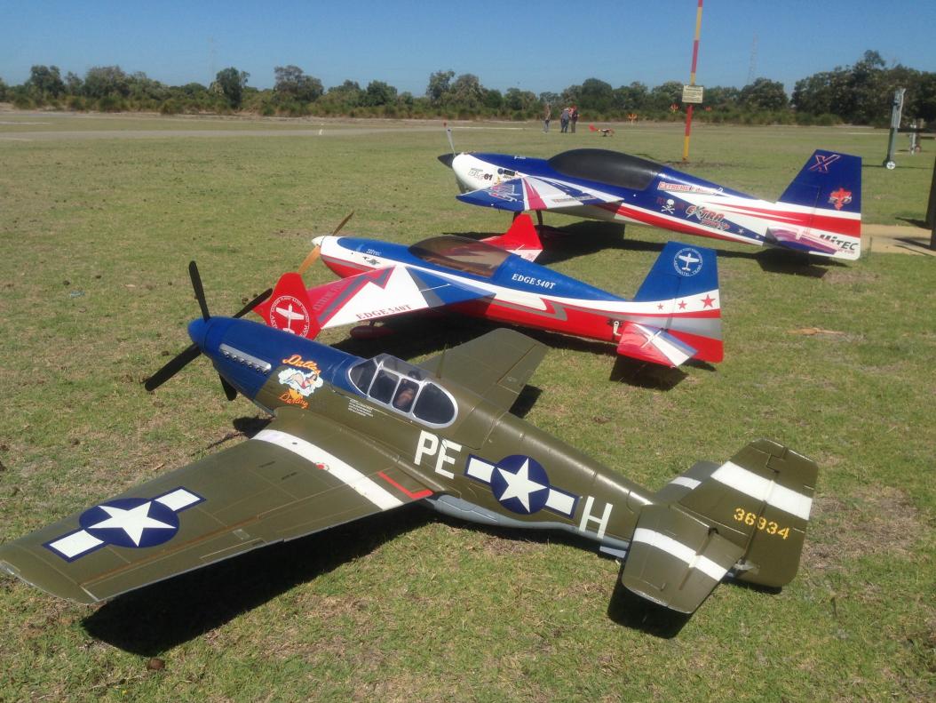

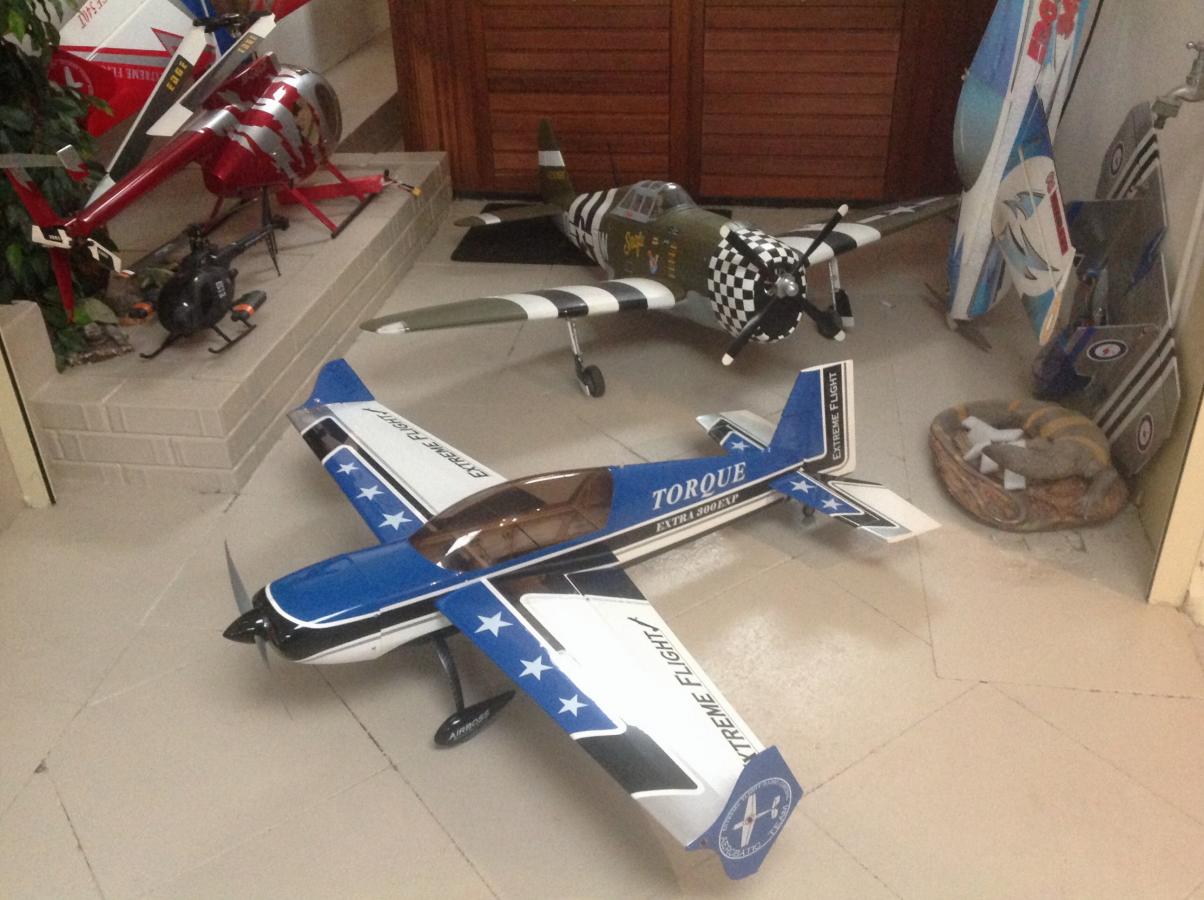

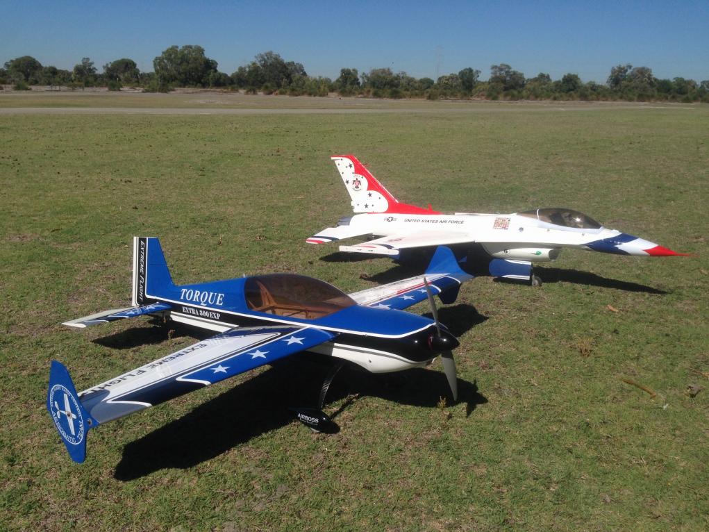

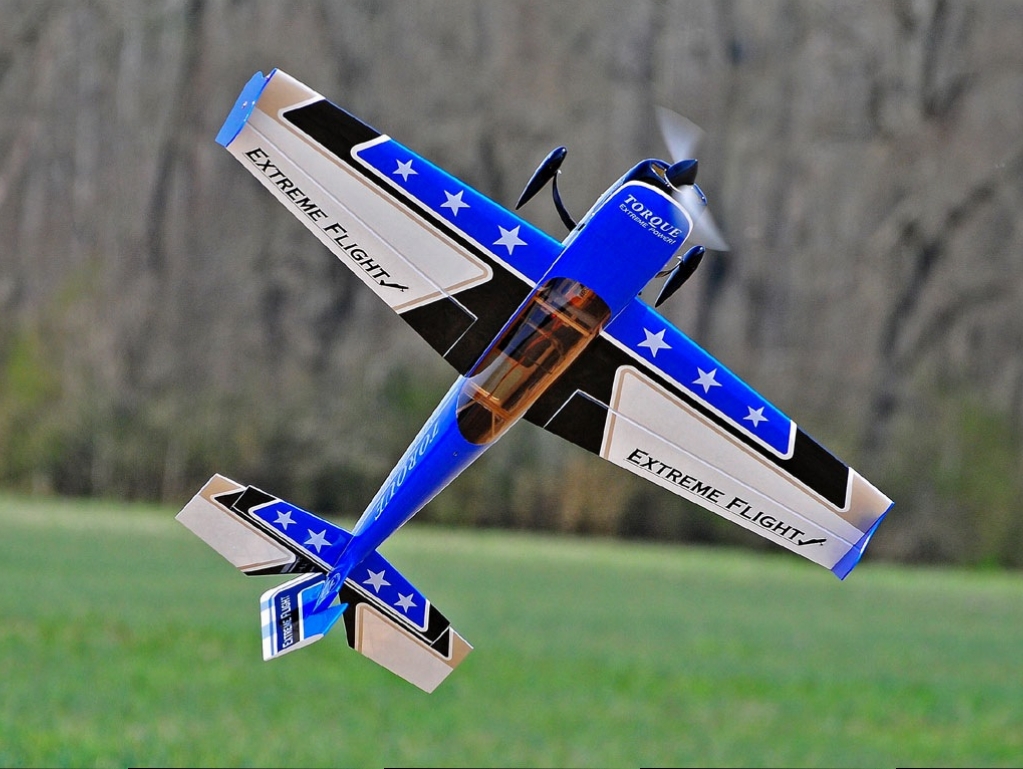

                  This is the 48 EF extra, I LOVE this plane. Comes in red too. The demonstrator 48 edge is also pretty awesome. I have a fair few EF planes, in 48,60, 72,74 sizes, as I said, pick any, you can't pick a bad one for 3D.

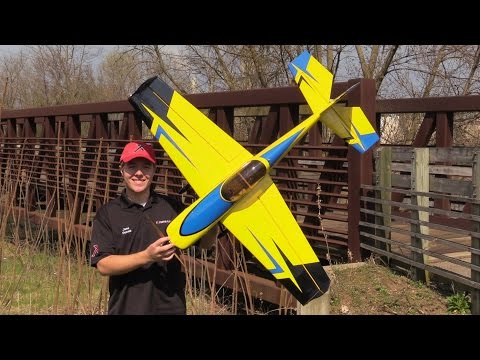

                    And finally, here's the brand new 52.slick which might suit you too when you're ready for a balsa - just released flown by someone much, much better than me. World champ and team ef pilot Jase dussia. Enjoy. ;)

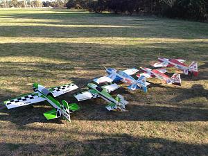

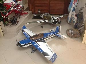

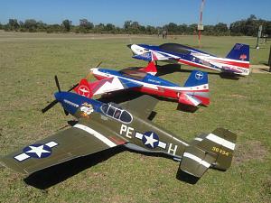

                              No worries, more than welcome. Here's a pic of my mates and mine lined up for a early morning foamy 3D session. ;)
                              (I love 3D flying and I'm a maaa instructor so always happy to help if you need any tips, setup, how to do tricks etc). I'm not even close to someone like Jases skill level, but I have fun trying all the same.
