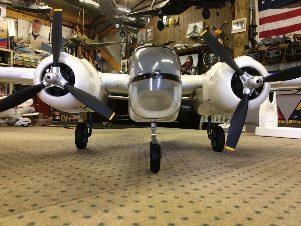

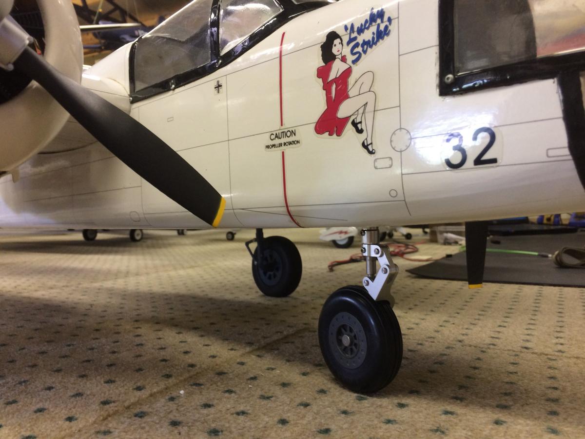

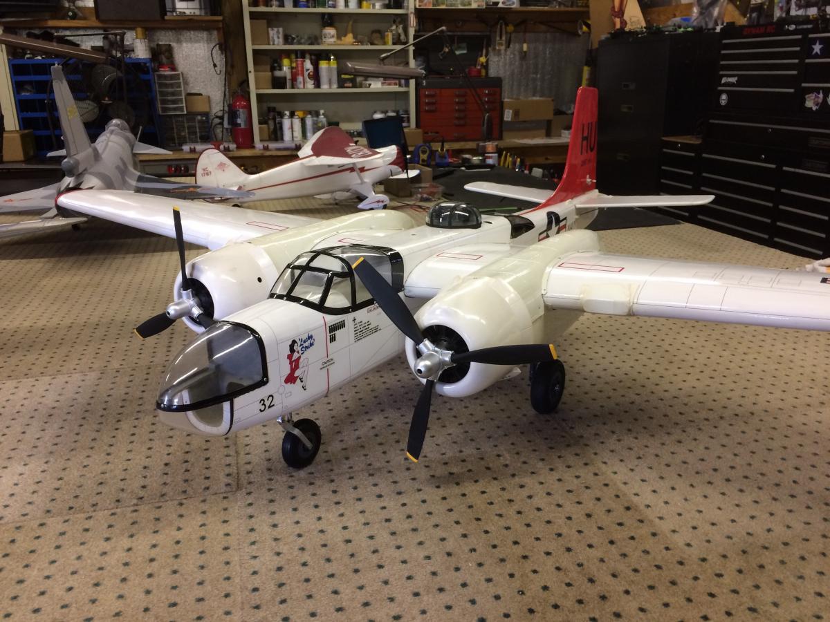

    She's on her feet now...

          Yes, I still need to make the ESC wiring and mount a steering servo, I think the COG is going to be real close.

                        I used motors from the LX B-25, the props and adapters are from the Flightline F7F Tigercat. I used two 65A ESCs and a single 4S 5500mAh battery.
