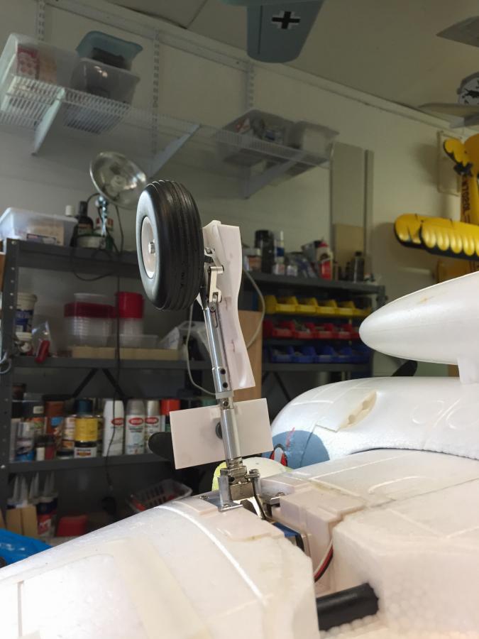

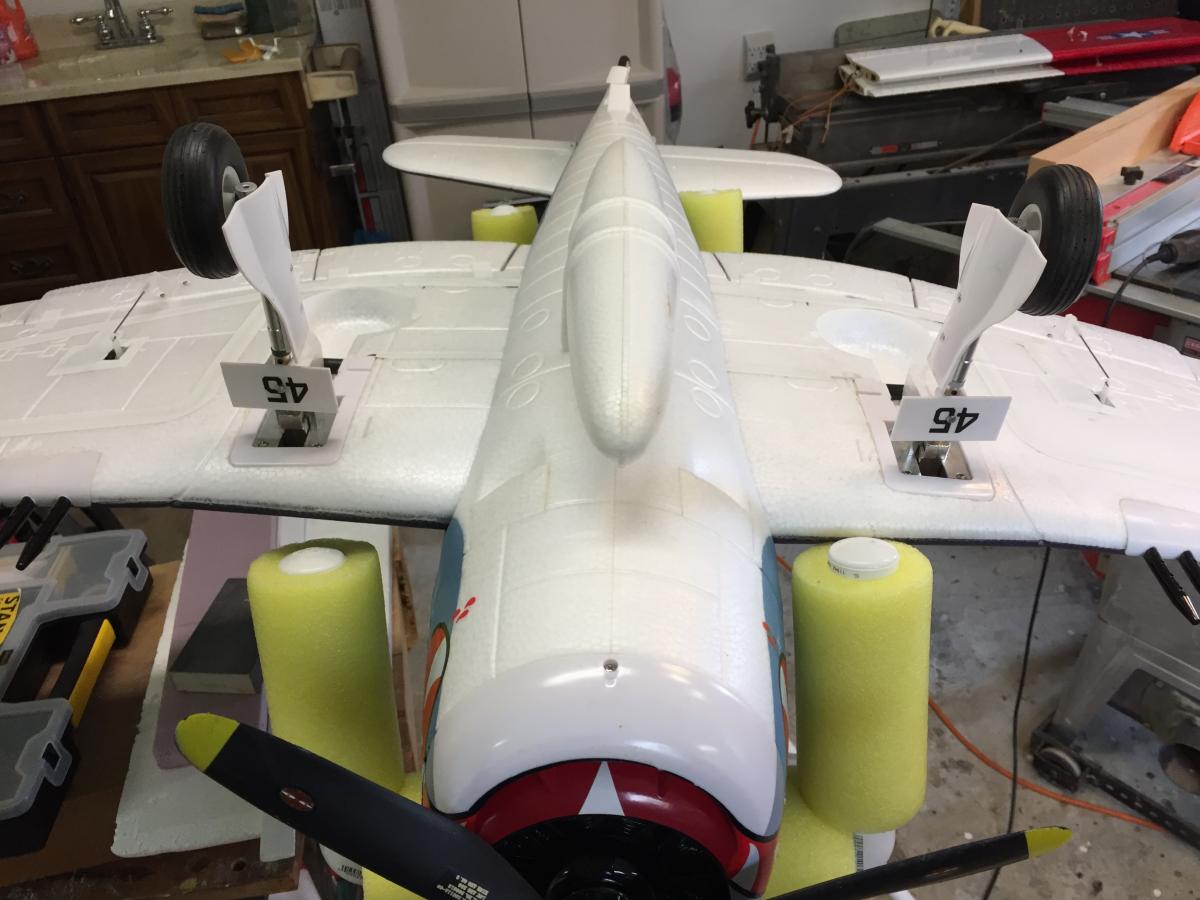

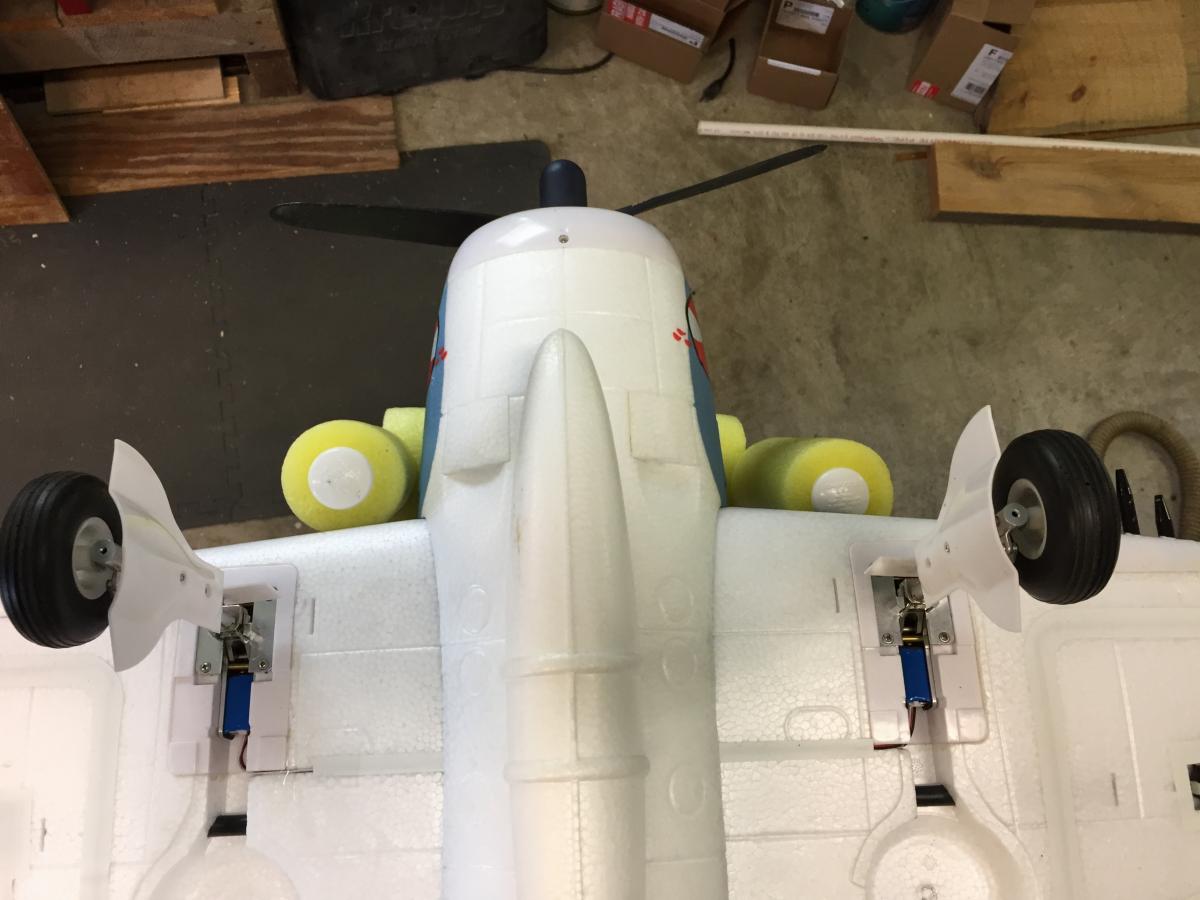

    So here is what the mod looks like completed. :Cool:
    Click image for larger version  Name:	IMG_0601.JPG Views:	1 Size:	55.6 KB ID:	74182
    Click image for larger version  Name:	IMG_0602.JPG Views:	1 Size:	88.0 KB ID:	74183Click image for larger version  Name:	IMG_0603.JPG Views:	1 Size:	102.4 KB ID:	74184
