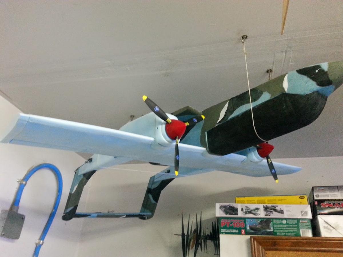

      I grow weary of waiting sometimes, and take matters into my own hands...LOL...this is my second 100% scratch built Bronco. The first one had a 48" wing, and was built in 2008. I flew it for about three years before a mechanical malfunction (wink wink, nod nod) did her in.

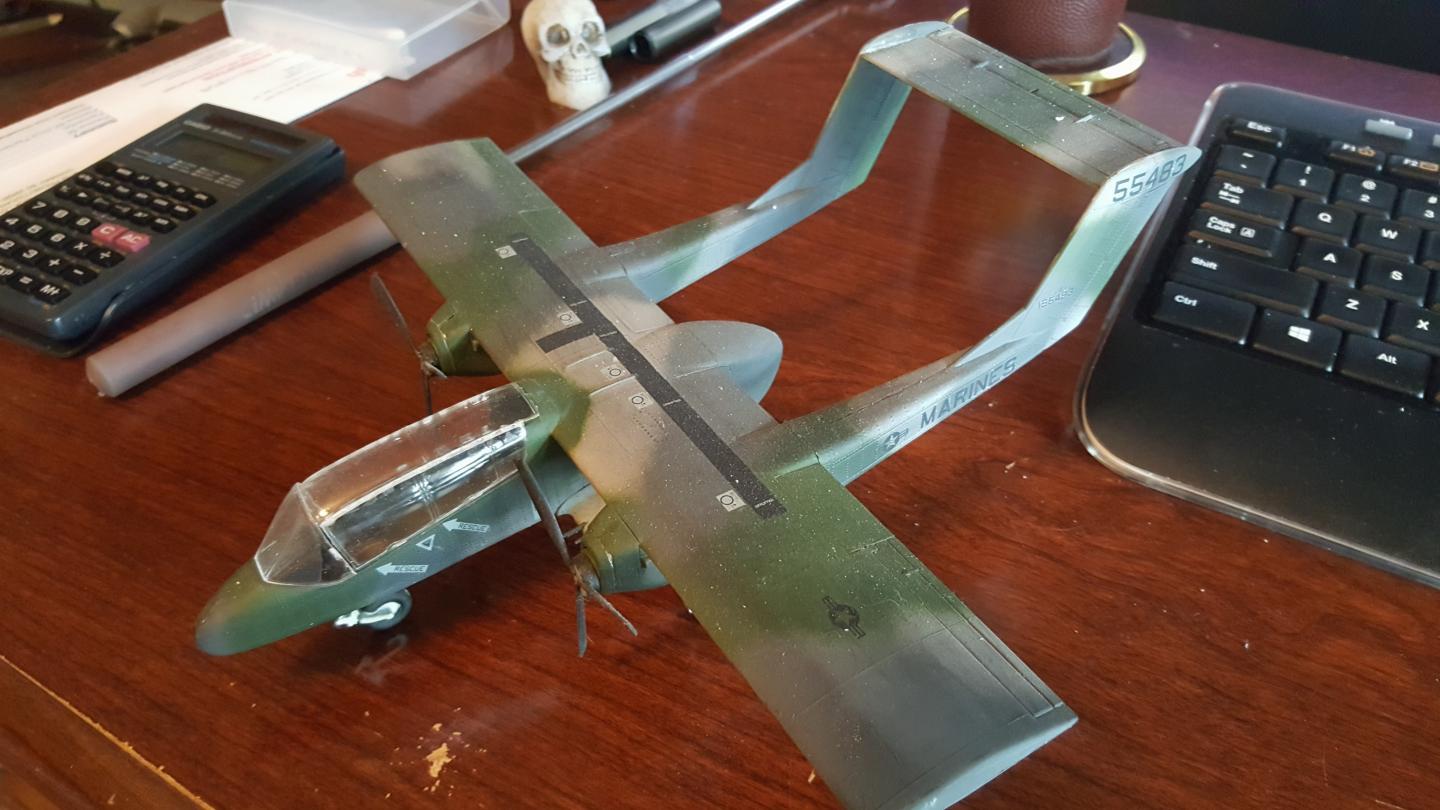

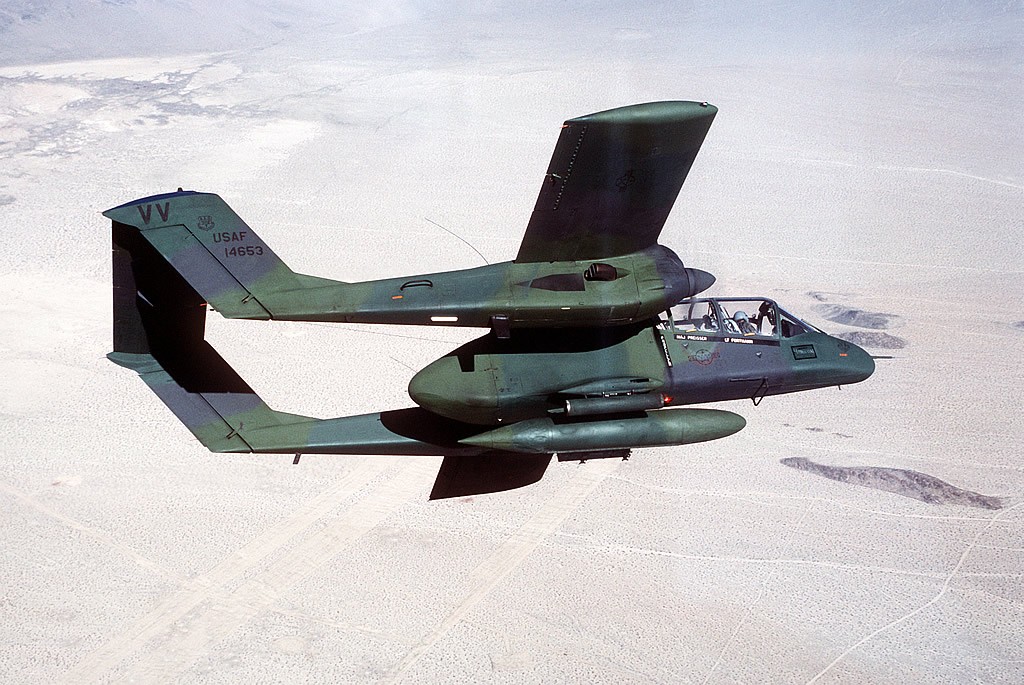

                                        Here is my (unfinished) plastic model...
