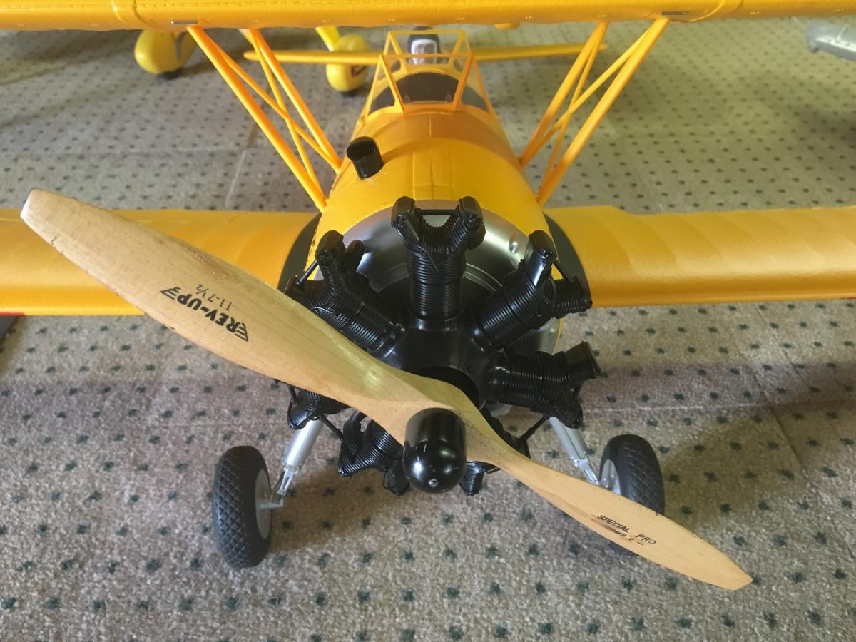

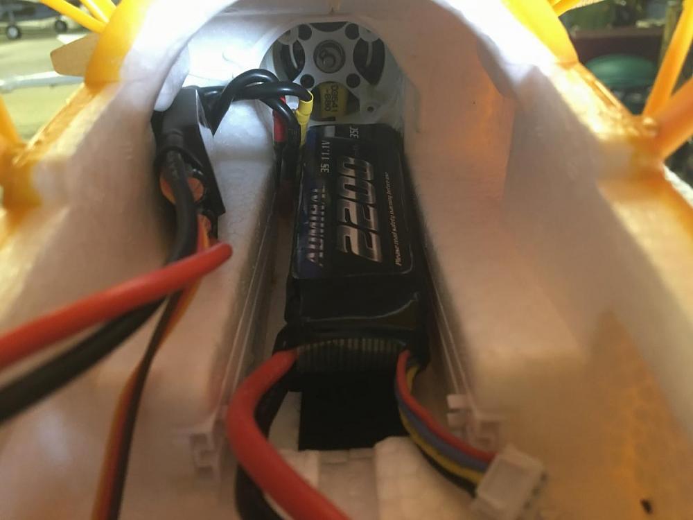

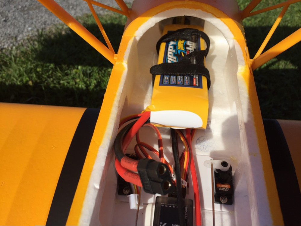

            I have a wood prop and heavier prop nut on mine and I hate those battery trays so I take them out.

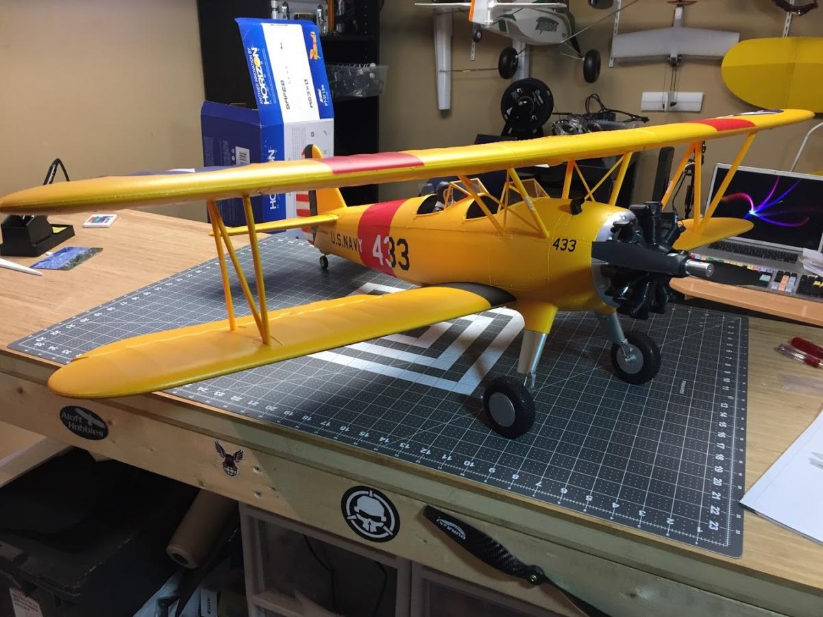

                                  I got my plane about a month ago and just built it up. I was surprised you guys said it needed so much weight as takingnthe fuselage assembly out of the box is was very nose heavy.
                                  well after some digging and checking out the engine cowl to add weight I found my jugs were not hollow, they’re now filled. I put my fake radial on the kitchen scale. It is 250 grams or 9 oz. yes nine ounces.
                                  It seems they came out with an amended product. Can’t wait to fly it.

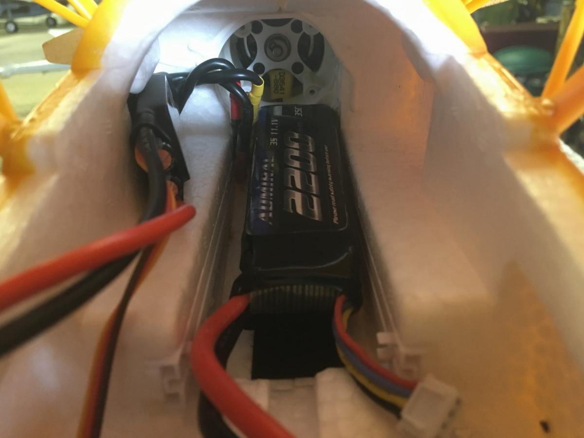

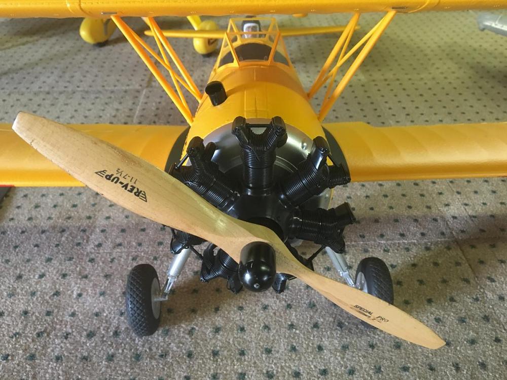

                                        [QUOTE=TiredIronGRB;n100011]I have a wood prop and heavier prop nut on mine and I hate those battery trays so I take them out.
                                        ONE BEAUTIFUL PLANE I'LL SAY. Nice job modeling.
