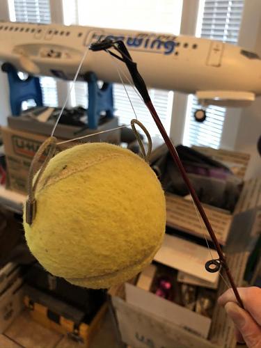

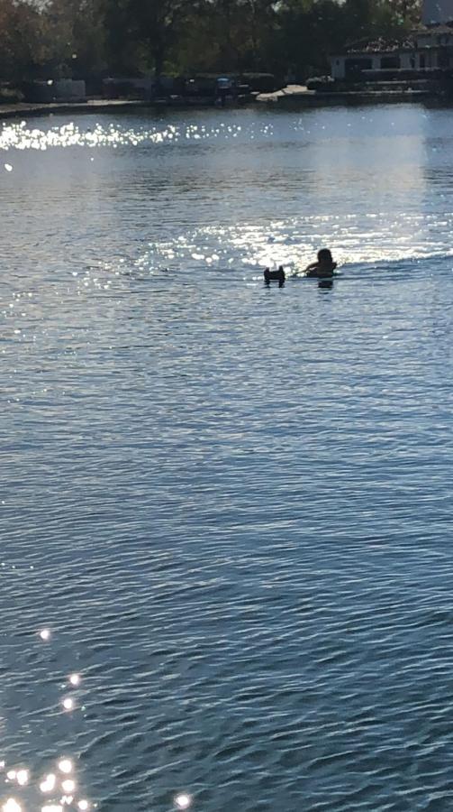

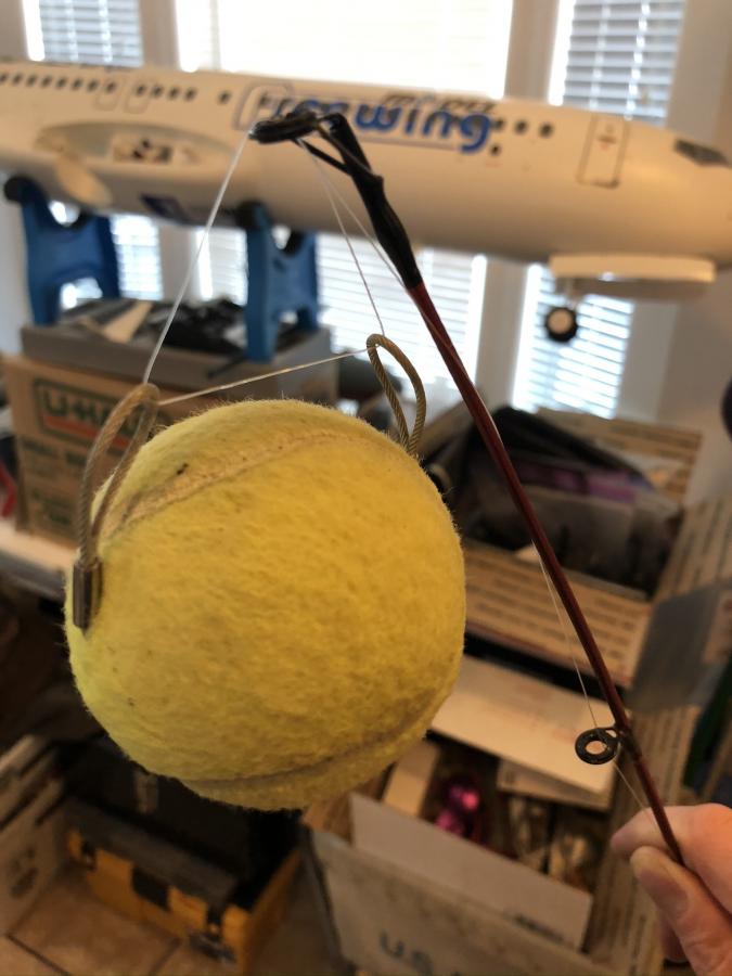

    If you RC boat long enough then you've no doubt come across this challenge. How do I get my toy-boat back if it dies in the water? I've been RC boating for a lot of years and I've found one of the simplest tool's to be the the most effective for RC boat retrieval: a $15 Zebco rod/reel with a tennis ball. Saturated with water it has just the right amount of weight to be able to sling it great distances. The idea is to cast it over the boat then hold the line low while slowly reeling to snag the antenna or rudder (if it's flipped upside down) at which point you can reel it in. With the recent rain in Lake Elsinore, CA the lake was 3-4ft higher than usual. The wind was blowing me into an unfavorable area for recovery. I was forced to walk/wade out into an area previously not underwater and make a few targeted casts to get it back. Air temp was about 60 with water temp about the same. I nearly ran to the house to throw on a wet suit, grab the body board, and go for a swim. Deeming that unsafe given the conditions and with the wind pushing it at least to a semi-safe area I chose to be patient and seek alternative means. Do what you must to get your toy boat back but NO toy boat is worth your life.

    Never boat without your retrieval device!

      Comes in pretty handy at float flys too!
        I was fully expecting to see a gator pounce on ya there at Swamp Elsinore

            Retrieval fishing pole! I tried the tennis ball and found it was cumbersome and distance wasn't great. I went home and said there's a better way. I found 4 half ounce sinkers and used mono line thru all 4 sinkers a few time for strength. Next laid them in a row and ta is it ped with duct tape a few times. This made them straight as possible. Reason I laid straight is I could cast further and more accurate. Now it worked great as the in line set of sinkers seemed easier to cast. Reason for posting is i could cast over head easier than with the tennis ball. I endured no damage as I cast further. BTW, I made few of these in case the line snapped and could tie a new one in minutes. Hope this helps just one person, it will make my day!

              The area I was swamping around in used to be above water. The bottom was pretty sandy overall. I hope to never have to go in there again though.

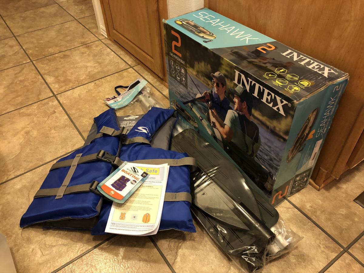

                Great idea! Here's my latest investment into RC boat retrieval. Meet the SS Recovery! Or the SS Pandemic I haven't settled on her name just yet. I figure with this on the shore with the boogie board in it, fishing pole, life jacket, and paddles ready to go I can boat with more piece of mind. I will also be rowing out with a seaplane in tow to fly out there on calm morning. $80 of fun!

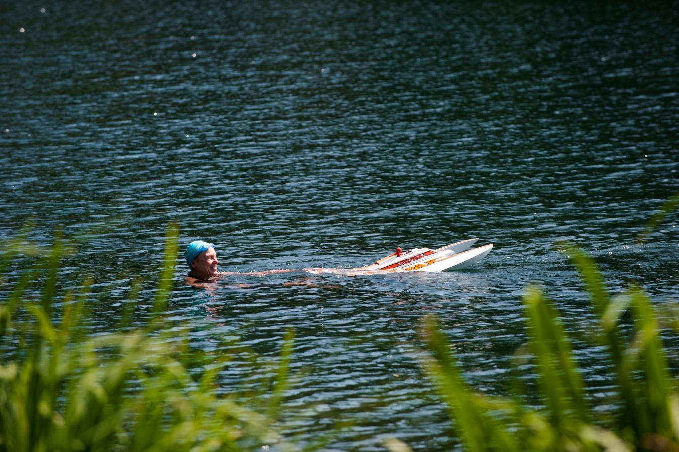

                  Or if you're lucky enough to talk a swimmer into retrieving your boat for you. (Terrible technique but beggars can't be choosers)

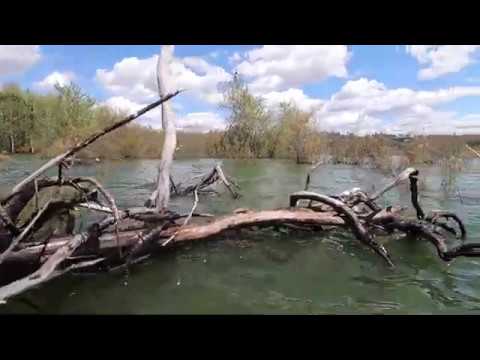

                    That's pretty awesome! However you have to get it back to shore I say. Here's a long clip (skip around) of my most recent boat recovery saga. I found it a few days later after swimming the swamp searching for it. Wet suit and a boogie board helped a lot. I had shoes on too so I could trudge the swamp area. I got a workout in that's for sure.
                      Yikes, work out indeed!

                          I will go to great extents, including swimming, to get my boat back but no toy boat is worth your life. I've swam for my boat a few times now and it's dangerous no matter what. If you're not a seasoned swimmer (I am not) you tire quickly. If you can have a spotter on shore ready to go in too that would be ideal assuming he can swim. Dragging back a swamped 12lb boat covered with pointy things on the back and wants to drown you is not easy either. Know when to make the safe move and approach the recovery a different way. On my last recovery I nearly swam for it before it got out further. The wind direction, strength, the current, and water temp kept me on shore. By the time I ran up to get the boogie board and got back to the shore it was long blown out of a safe swimming distance. Every year a few model boaters die trying to retrieve their boat. This story from Lake Havasu from last year is quite sad:
