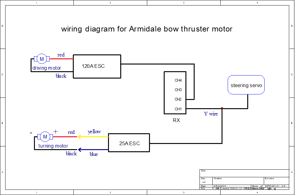

          Does it include the bow thruster ? I see the location on the pictures but nothing mentioned on the description. What about lights and interior of the command cabin?

            hi, I have the Armidale but there are no instructions on how to set the radio system up and what the two wires are from the front and I imagine they work with Buster. How does the bow thruster work. There is no instruction manual for any of this. Can you please tell me how to set this boat up? I love the boat it’s beautiful, but being new to hypos systems and electrics I don’t know very much, but I’m learning with you guys help

              I I don’t understand. I don’t understand. I write a question a few times about the Armidale and especially the bow thruster and how it works, but nobody seems to have the answers when Hobbyaquawk is supposed to answer questions for the motion RC models. Can you explain why there are no Answers to the question on How do I use the bow, thruster.. Please help me with this as there are no instructions at all on the balusters about the wires to be connected or even had to use it it would be nice. Thank you

Name:	wiring diagram for Armidale bow thruster motor_0219_24.png
