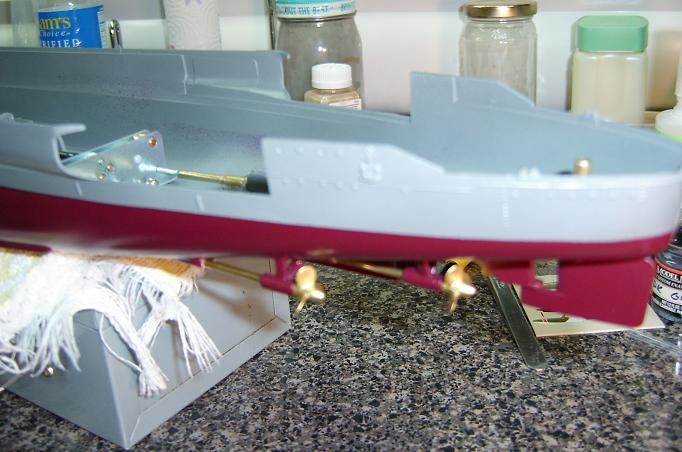

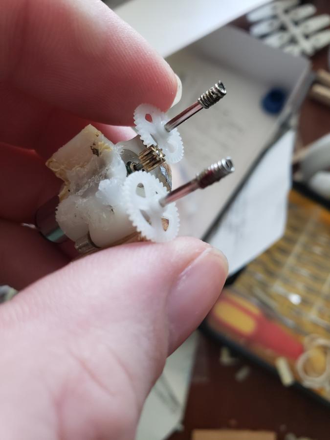

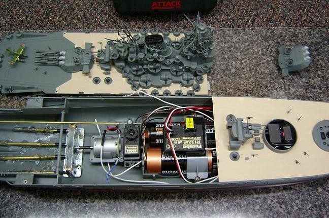

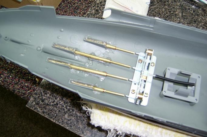

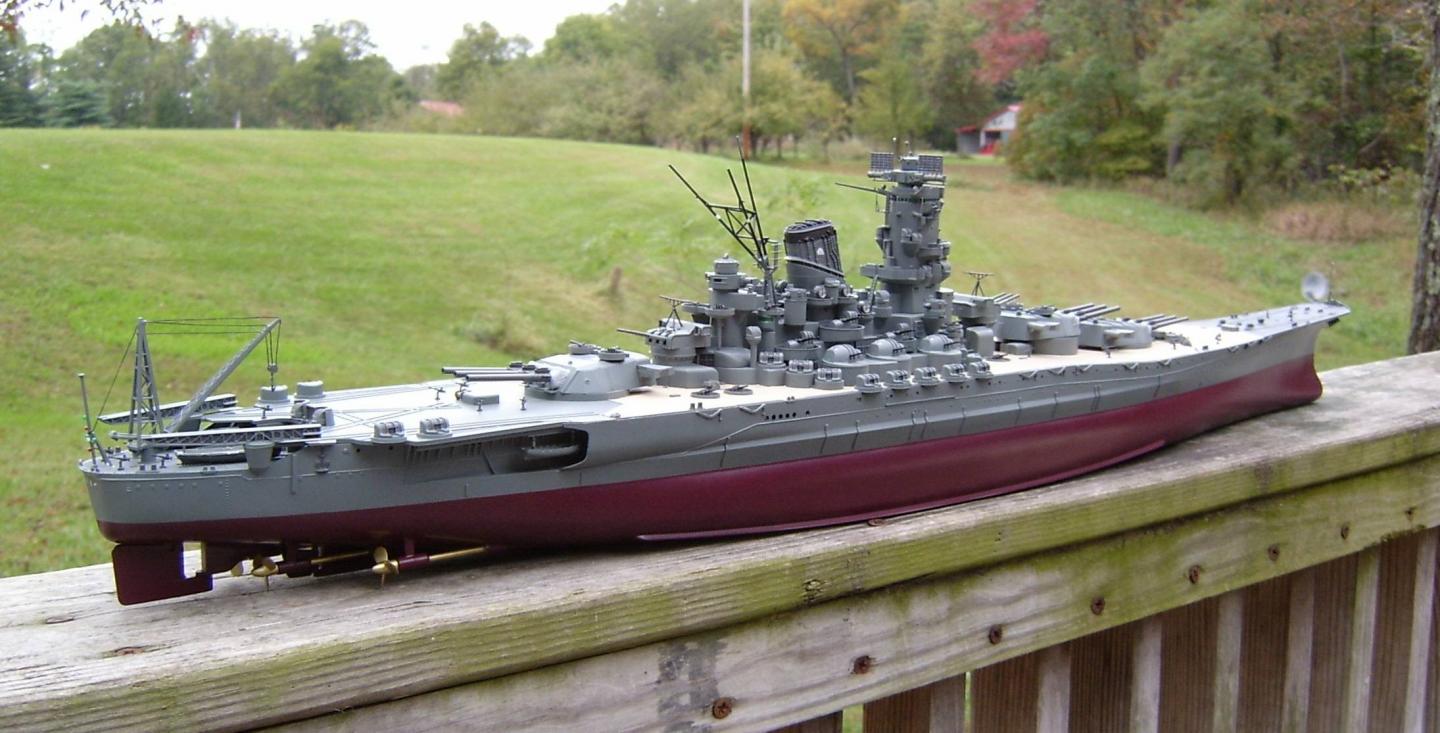

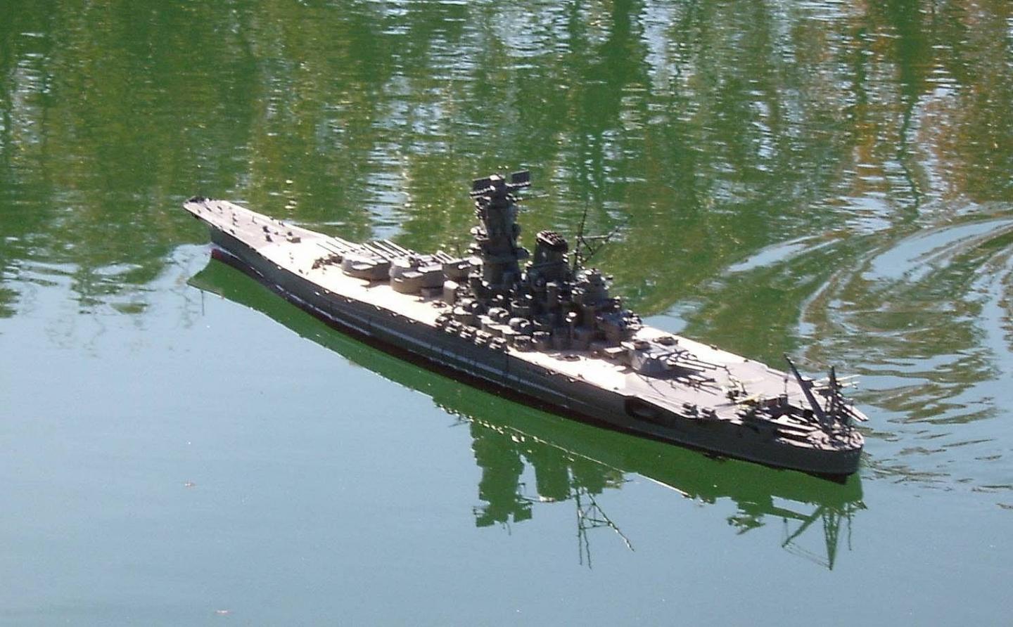

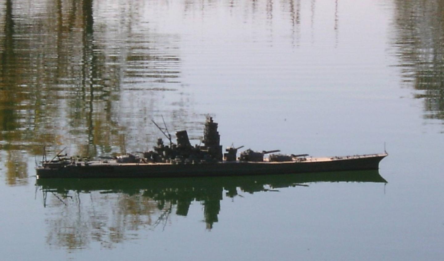

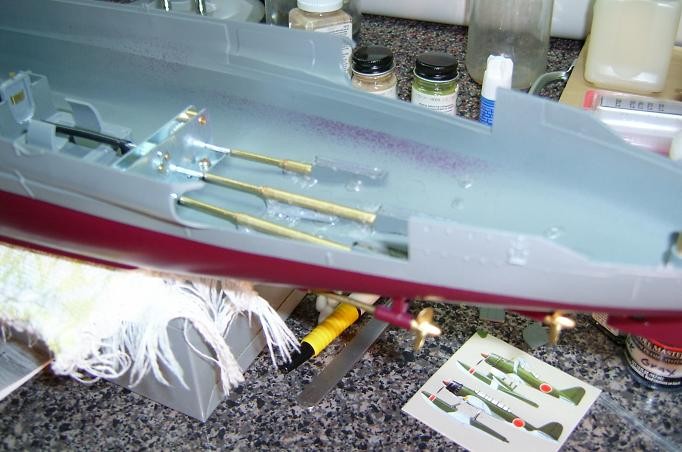

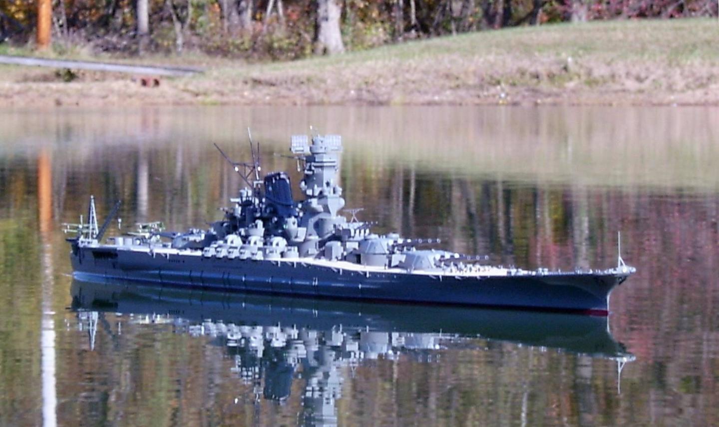

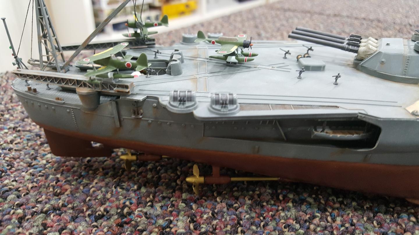

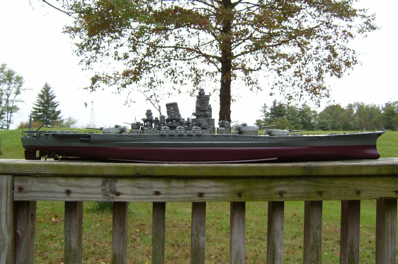

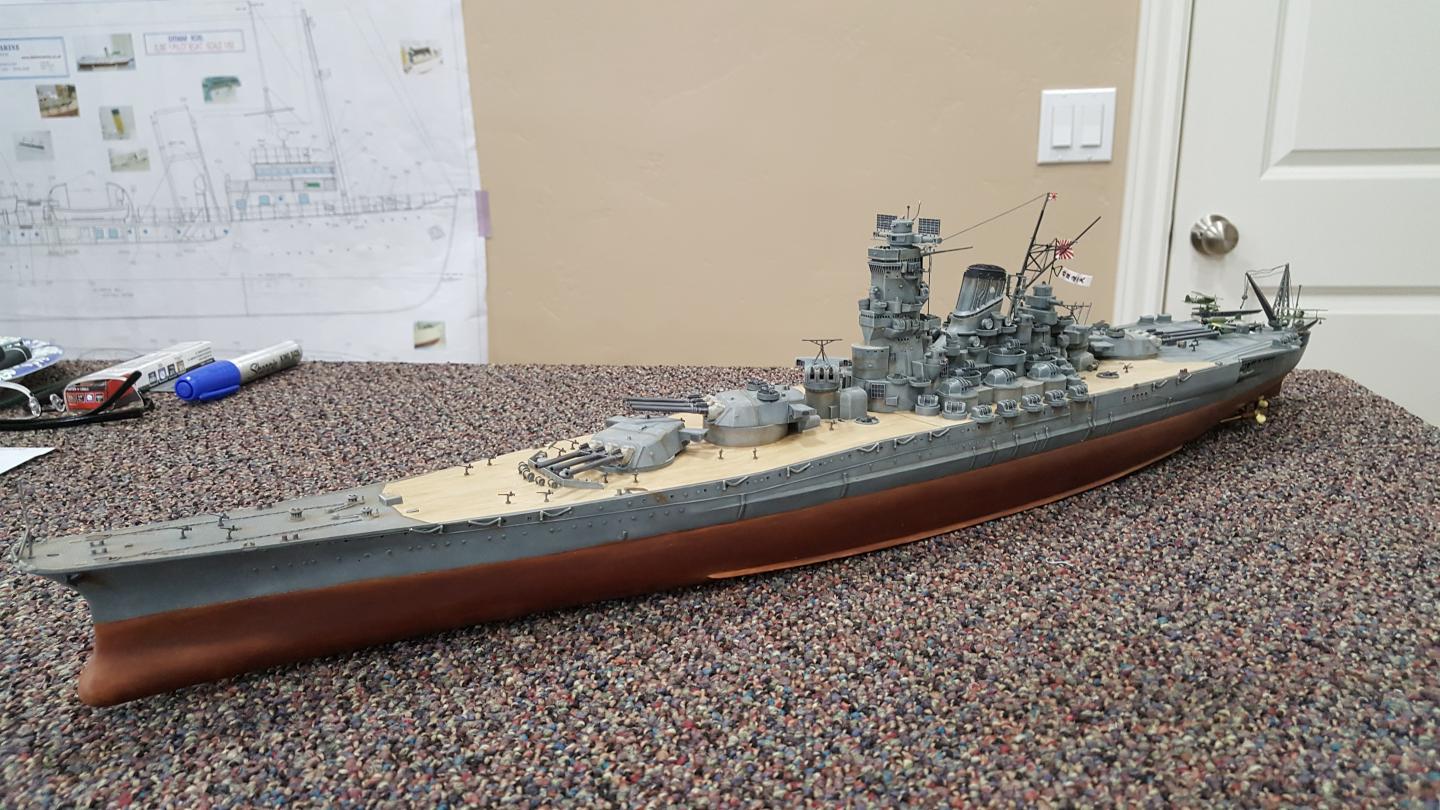

    Going to share a fun small scale RC Battleship build I did with the Tamiya kit in 1/350. I did make my own brass prop shafts out of brass tubing, very simple and I used the stock gearbox provided by Tamiya. They just hook up using rubber tubing and the plastic props I just glued on.

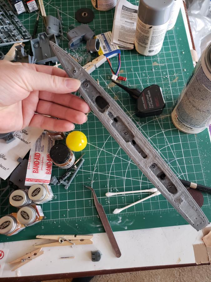

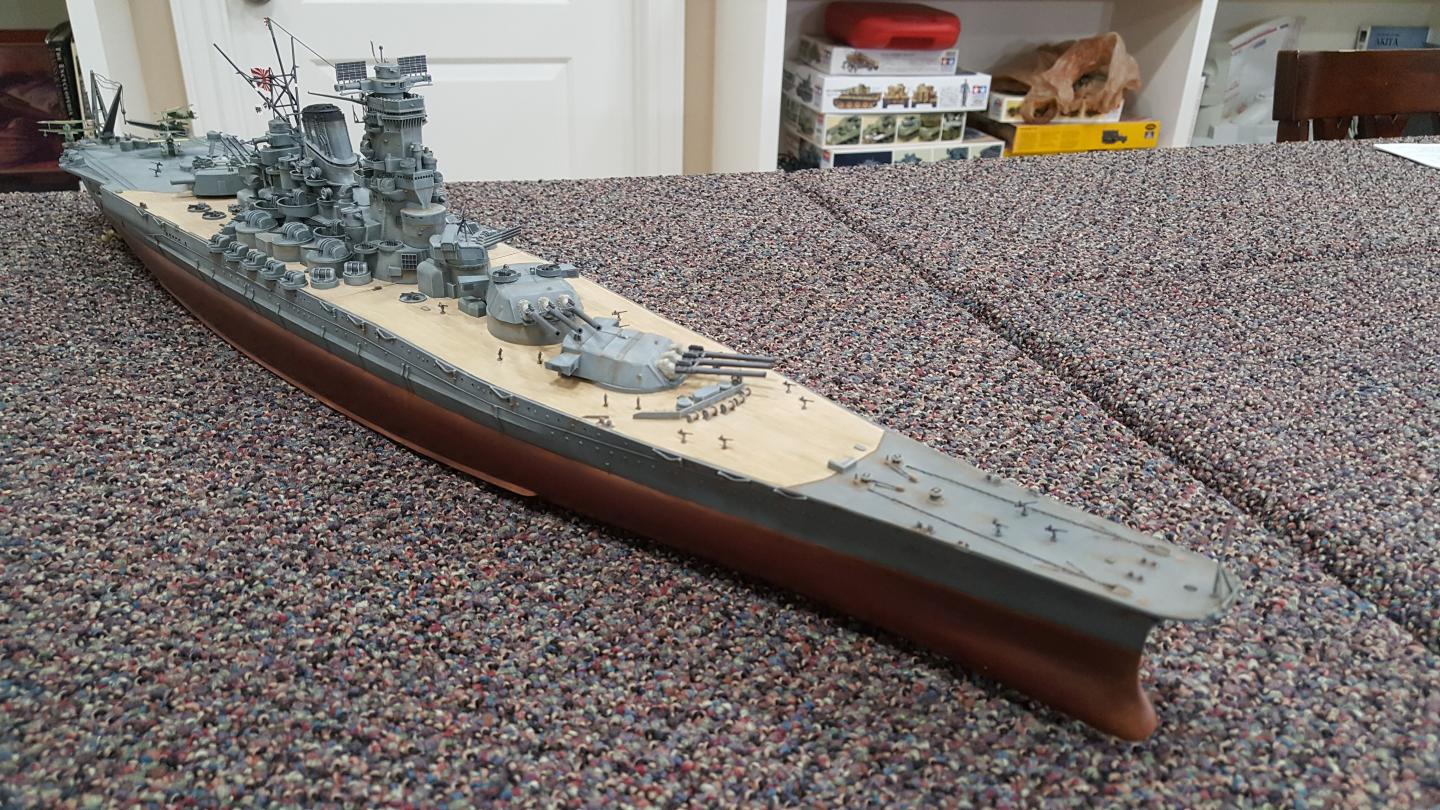

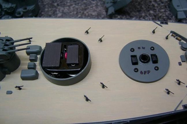

    As you can see the hull has a provision for 4 D size batteries to be used to power the single motor. I stuck a 4 AA battery pack under the second main turret to power the receiver. Two on/off switches were placed under the first turret and a rubber O ring glued to the hull to hold it on and also make it easily removable to access them.

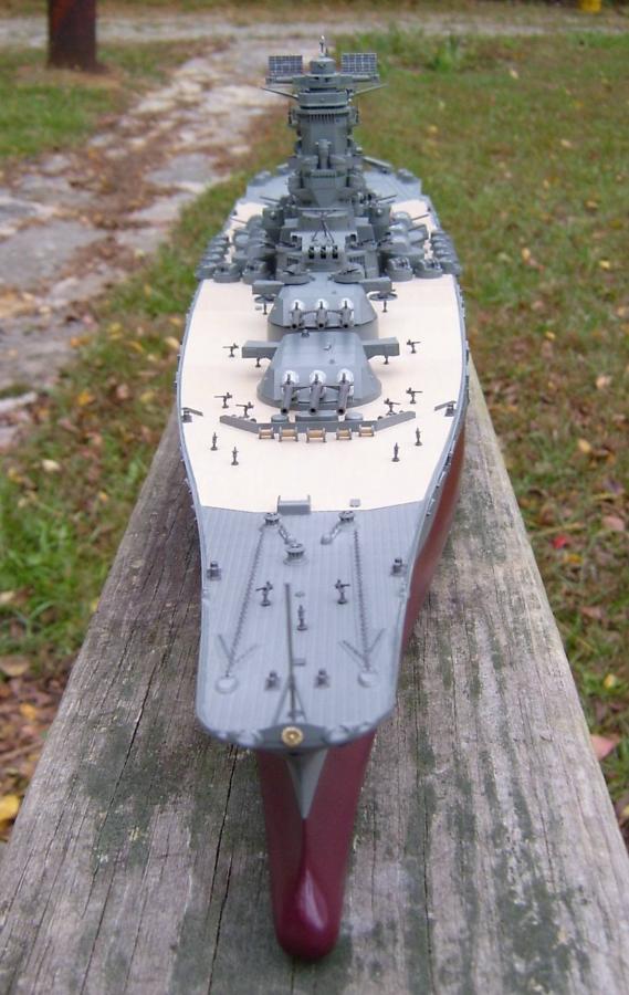

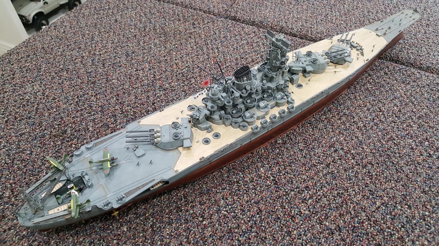

      Here are just some basic pictures of it during construction and painting.

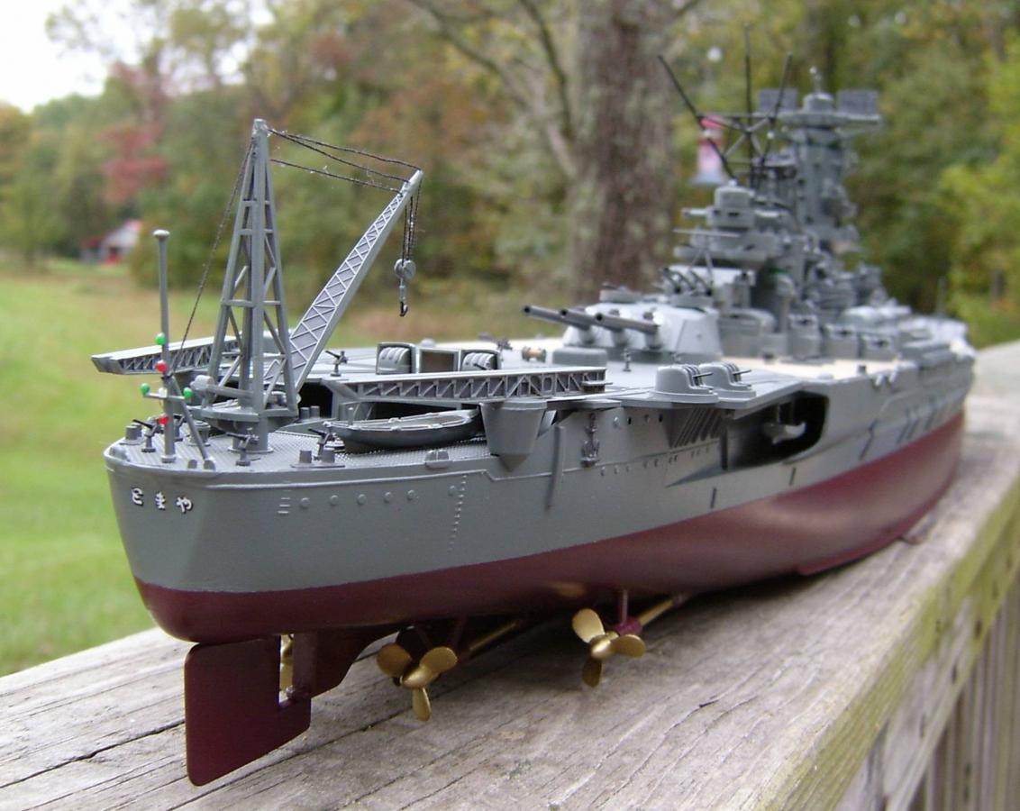

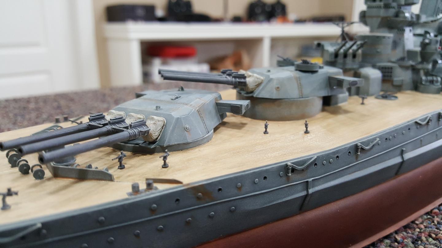

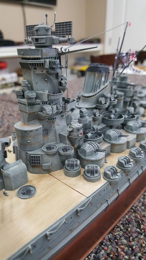

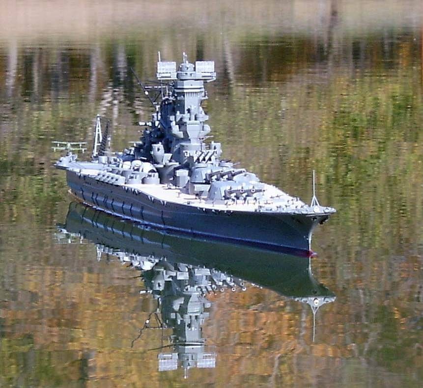

        For weathering I used artist oil colors and dry brushed a very very light coat of Titanium White over almost the whole ship. This gave a nice faded look to it and then some light rusting effects. less is sometimes better when you do weathering and you can always come back and add more later if you want.
        • Tooeleflyboy
          CS Agent
          • 508

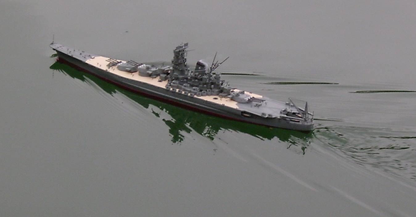

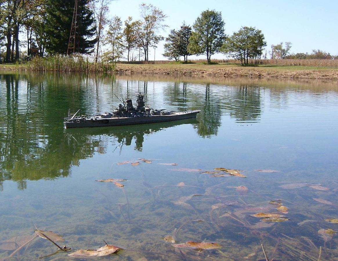

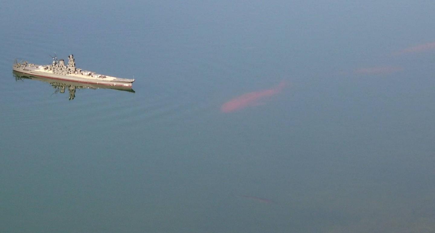

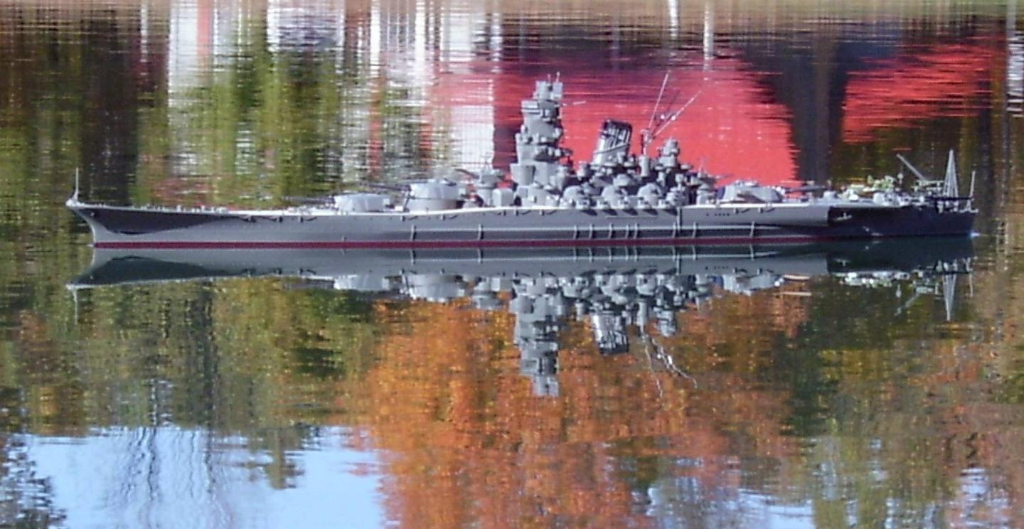

          This is a great running model for a small pond on a calm day. The gearbox is a bit noisy but the Koi Fish love it and will follow around like enemy subs !

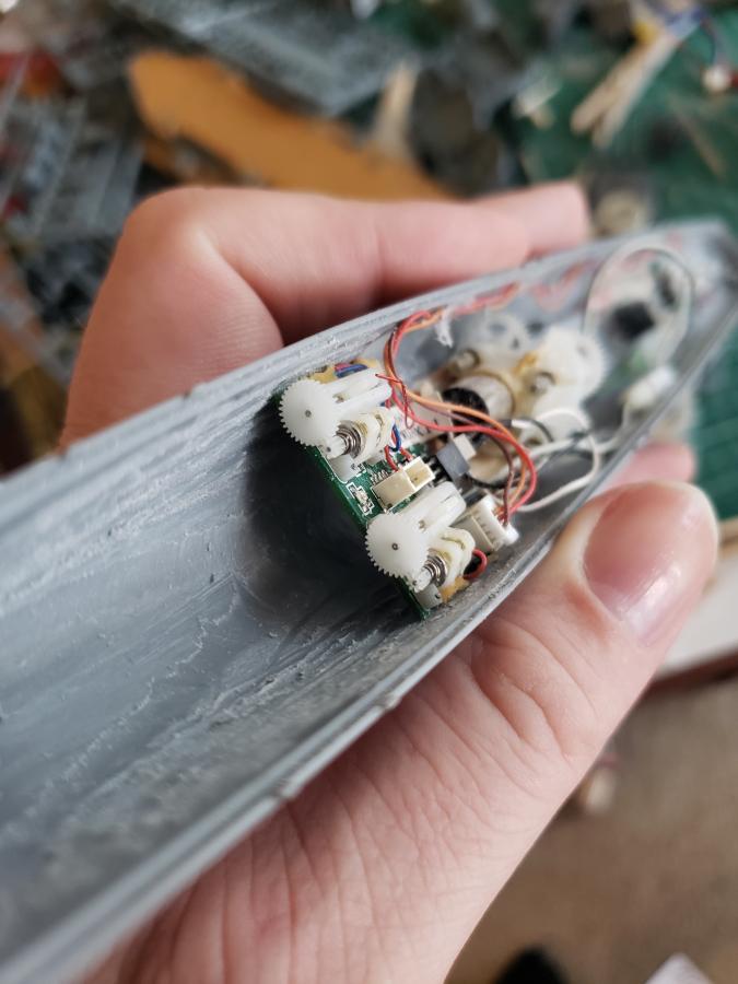

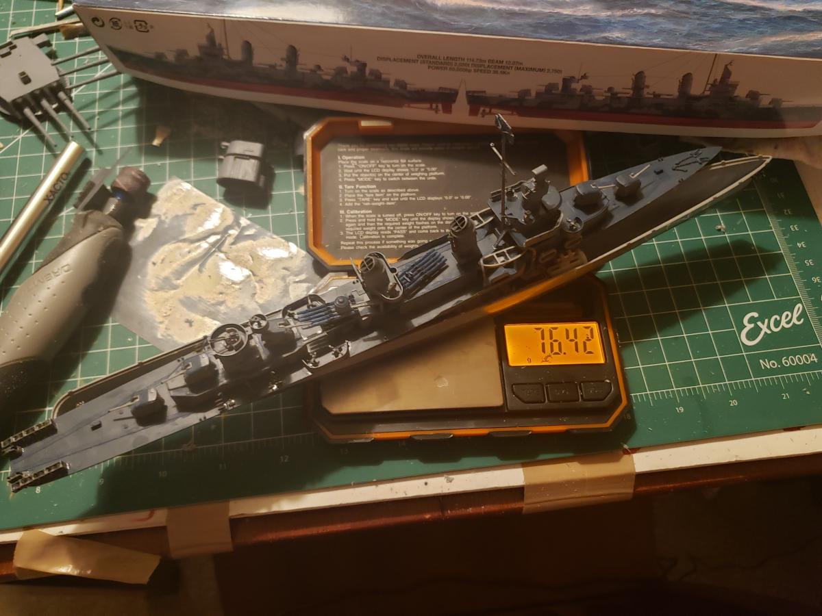

                  It's not as hard as you would think. Worst part for me was stern tubes (shaft seals) when I tried my first RC conversion. My case was fairly easy for the electronics they came pretty much whole from another project. If you check Youtube there are a lot of how to videos and often local hobby stores employees have pretty good advice. Big challenge is building the modle and all the fiddly bits...Click image for larger version

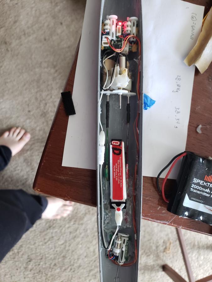

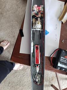

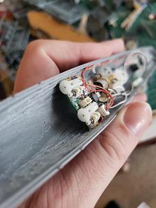

                  And Tooeleflyboy the electronics were out of a Parkzone Micro but from one of your pics I bet she looks familiar. Had to do a LOT of grinding to the deck under the superstructure.
                      That is an amazing miniature build! Does it try and capsize easily or is it stable?
                      • twodawgs
                        • Jul 2020
                        • 98

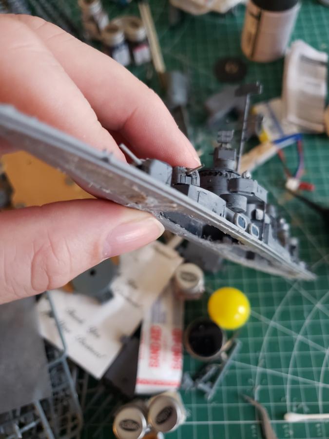

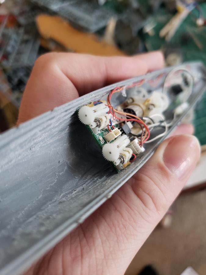

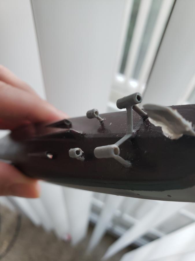

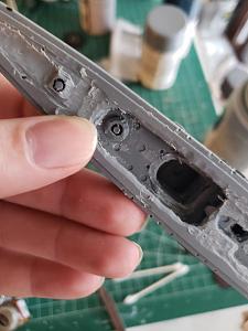

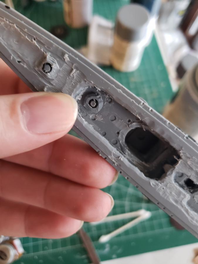

                        Between the motor and battery being fairly heavy they drop the center of gravity pretty low. I can roll her on her side far enough the aft two sections just barely touch the water and she'll right herself. But there is no real sealing and the main deck's plate had to be SERIOUSLY ground out and just sits inside the hull. Under all three sections, and then thinned as much as i dared. The superstructures and smoke stacks were thinned as well.
                        Downsides are I didn't get the STB shaft quite lined up and it sticks (have to tear too much apart to be worth fixing) so she just sort of LUNGES off the blocks.
                        The rudder really is too small for this application like I had NO control of which way she goes.
                        And yeah its and Micro RC plane ESC/Receiver so no revers. Its got one control for all intents and purposes. forward, Forward, or FORWARD OMFG NONONONONNOONNONONONONONO DONT TIP RUDDER PLZ WORK FOR LOVE OF....... She sits above my TV most of the time and the few times i put her in water I filled her with rice after to make sure everything dried back out.
                        I'll send a pic of the bottom of the plate from my phone so you can get an idea of how heavy handed i was with the Dremel. The hull got a bit of Dremel love too but nowhere near as much.

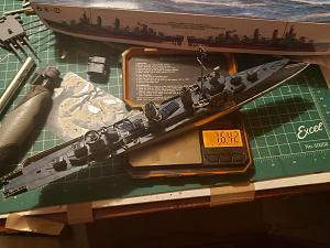

                          Click image for larger version  Name:	20201001_175635.jpg Views:	0 Size:	57.3 KB ID:	278201Click image for larger version  Name:	20201001_175547.jpg Views:	0 Size:	60.1 KB ID:	278198Click image for larger version  Name:	20201001_175522.jpg Views:	0 Size:	55.4 KB ID:	278199 Click image for larger version
                          The guns still turn and the control board just sits in. But she floats just below the normal waterline and upright. The battery does most of the side to side balast and is secured by heavy duty velcro

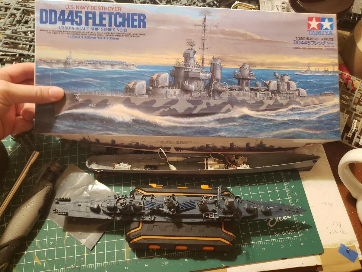

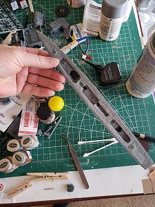

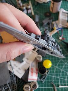

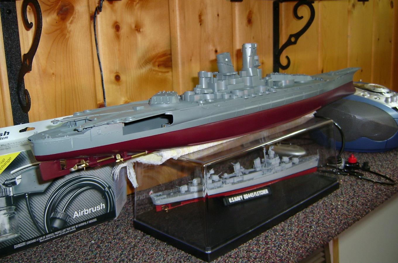

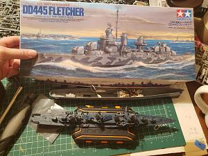

                            OMG! fantastic work. Yes all the Fletchers were sea pigs when it came to turning. That is why later models "very few" had dual rudders and then all Gearing class had them. Here is a pic of a 1/48 scale DD I am building with a slip over rudder for when in the pond.

                              I've considered something similar but with the sticky shaft and only able to go forward issue it didn't seem worth it. At this point I've chalked the build into the win category and use her as lessons learned for future work. I've started a really old Chinese 1/350 Missouri (some parts say 1996 on em) and am slowly working through building and converting her. Though the progress slowed massively as I'm butchering a new paint job onto the 1/72nd fletcher she will have the historical style measure 31 but the colors will be a touch light (didn't like the set that i could find and the set I liked were slightly light) and I'm not taking her down to bare fiberglass to repaint. Here is a test patch I did on the interior under sunlight. she looks good inside and even outside it isn't too noticeable other than the super dark grey I used rather than black I'm already reconsidering that. In the end though the paint just has too please me after all I'm the one who will be seeing her every day I'm home.
                              Your Nickolas (I think I read that right) hull look pretty awesome already and I like the slip rudder idea. From what videos I've seen I may not need it on the 1/72 but I may make one for her just to learn about the process/problems/solutions/advantages and disadvantages.

                              • hourlardnsaver
                                • Jun 2021
                                Looks amazing! I’m working on my own RC conversion of this kit. I was wondering what you used to cut the holes for the battery pack and the switches
                                • Tooeleflyboy
                                  CS Agent
                                  • 508
                                  #17
                                  Usually my Dremel tool for that stuff.
