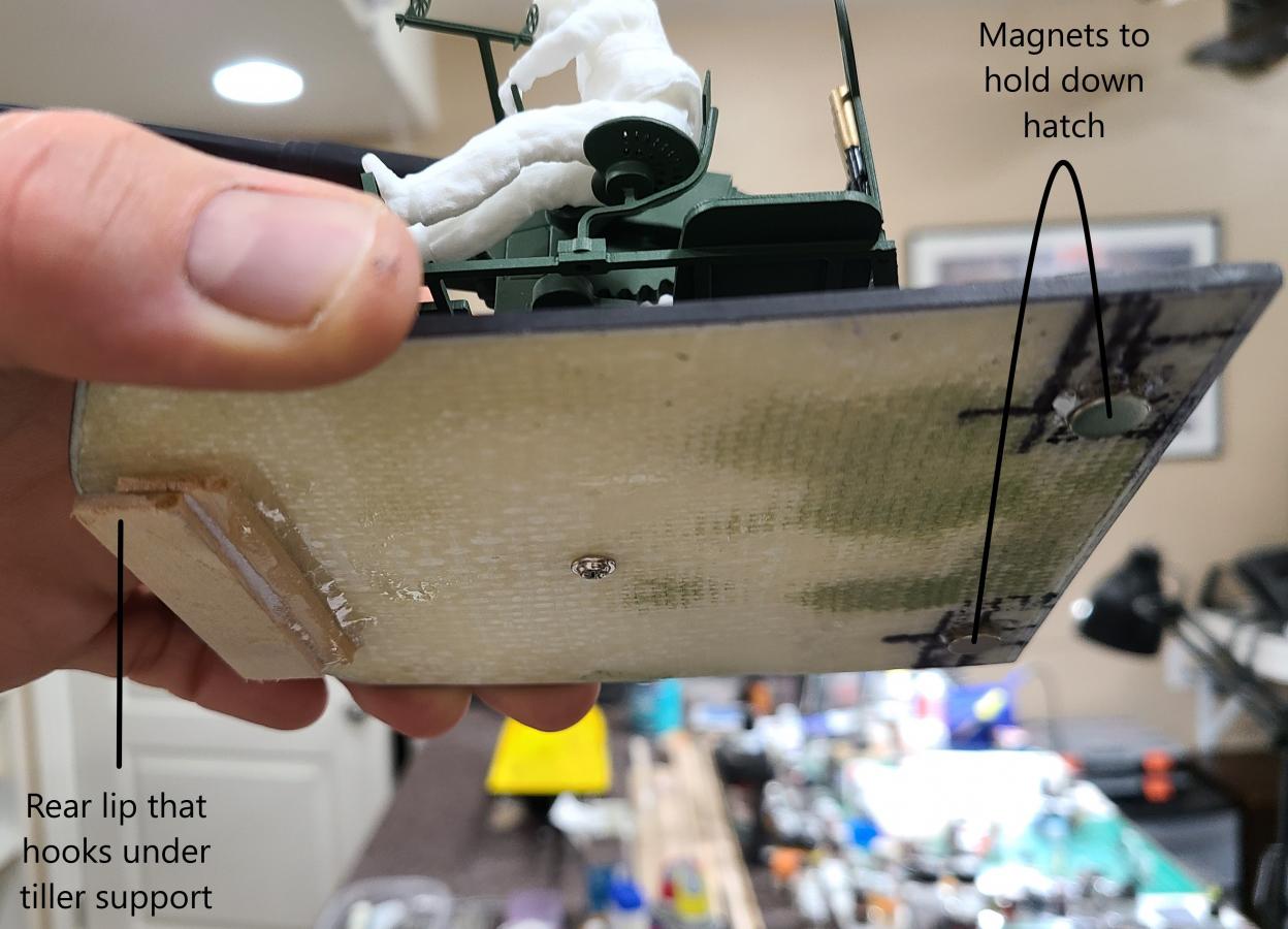

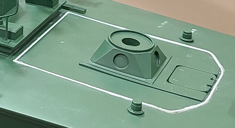

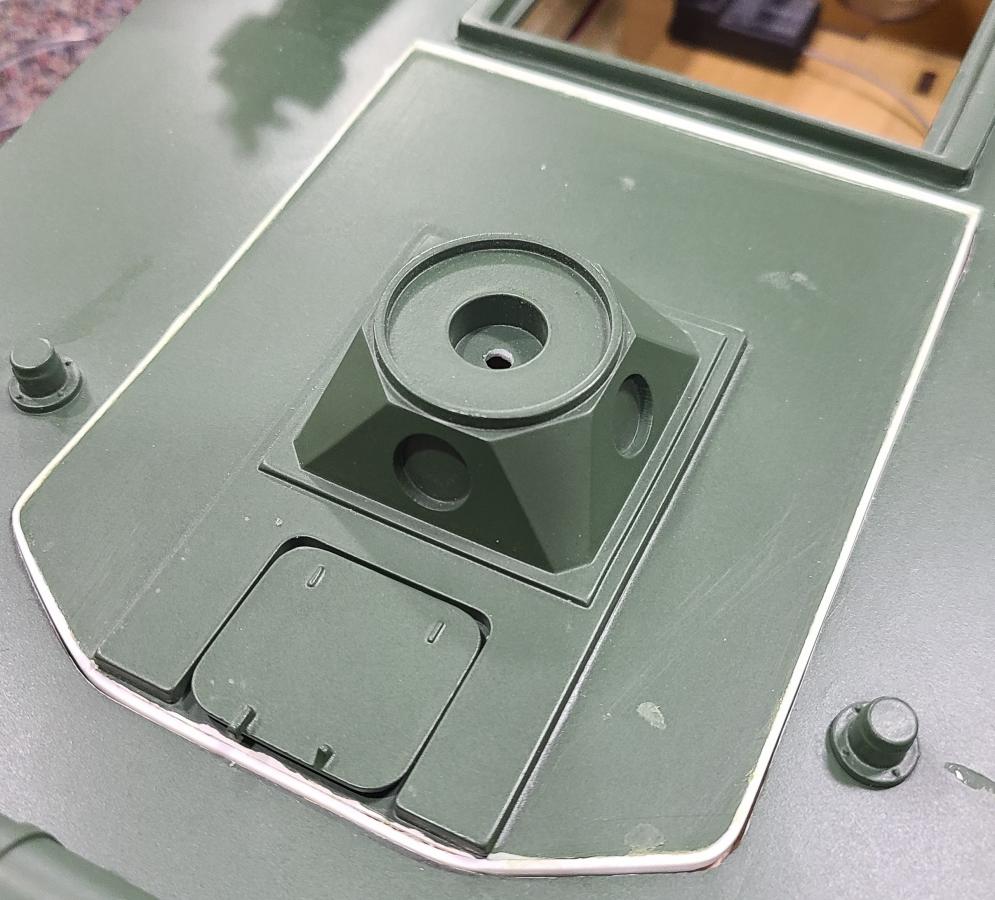

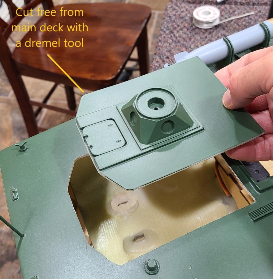

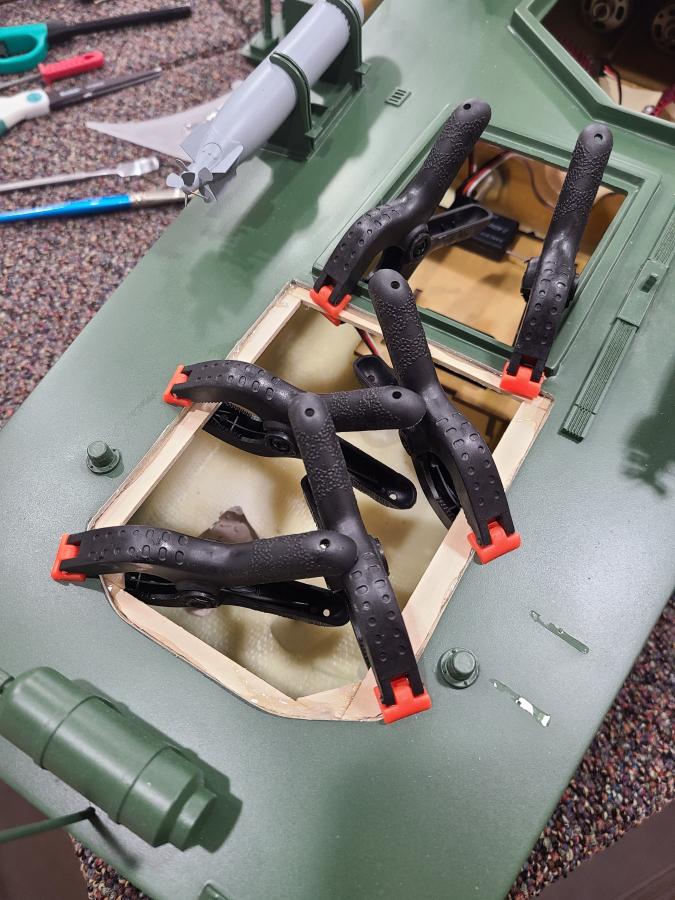

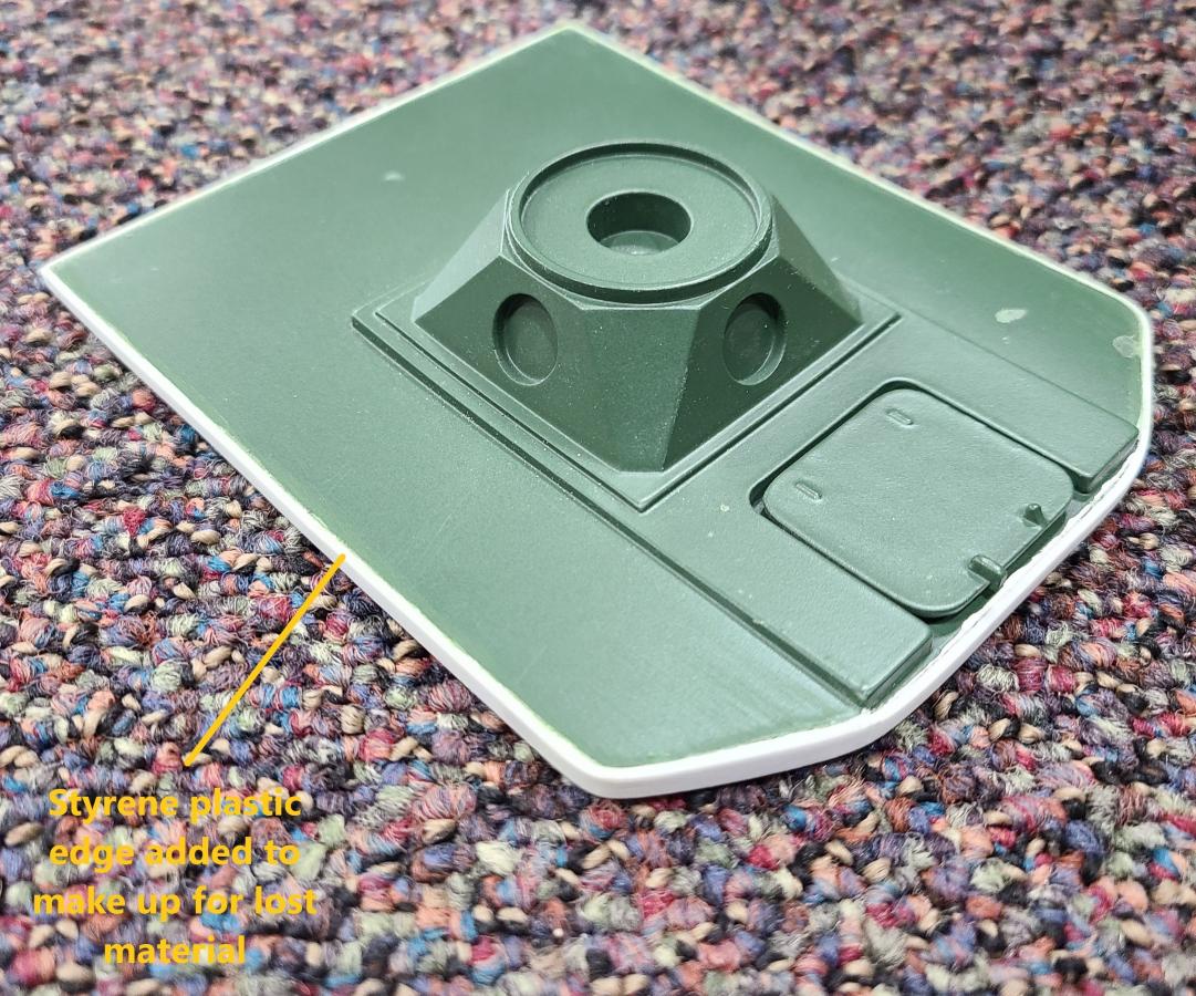

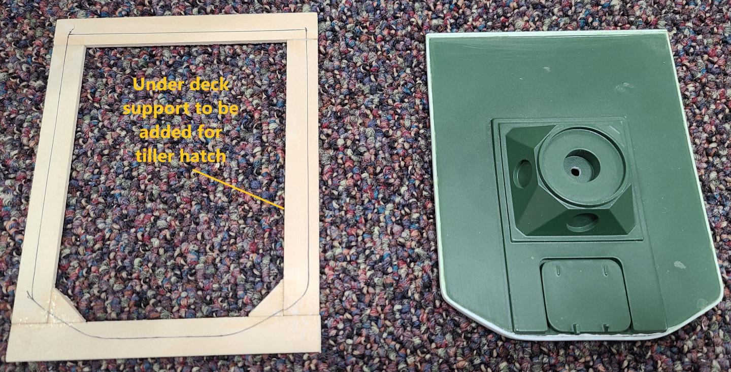

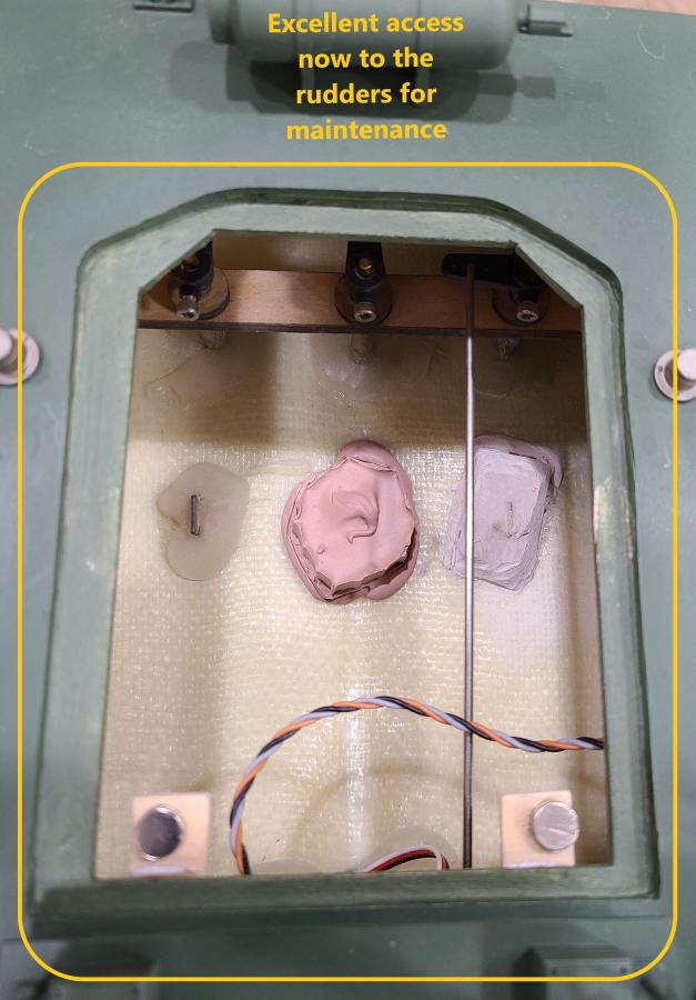

I wanted to get access to the stern so I could drop out the rudders and remove the prop shafts easier from the rear of the boat, rather than pulling them out from the inside of the hull. I cut around the rear gun deck with a Dremel cutoff wheel and removed it. To make up for the loss of the material removed in order to do this I created a new edge with styrene plastic. Then I filed down the opening in the hull until the new piece matched up and fit well. Under the rear deck opening I made a small wood frame epoxied to the underside of the deck to support the hatch/rear gun assembly. The hatch is held in place by a lip that inserts under the wood frame in the hull and is secured at the other end with 4 magnets. This really should already be done by the factory for the owner/operator to be able to get back here for many different reasons.

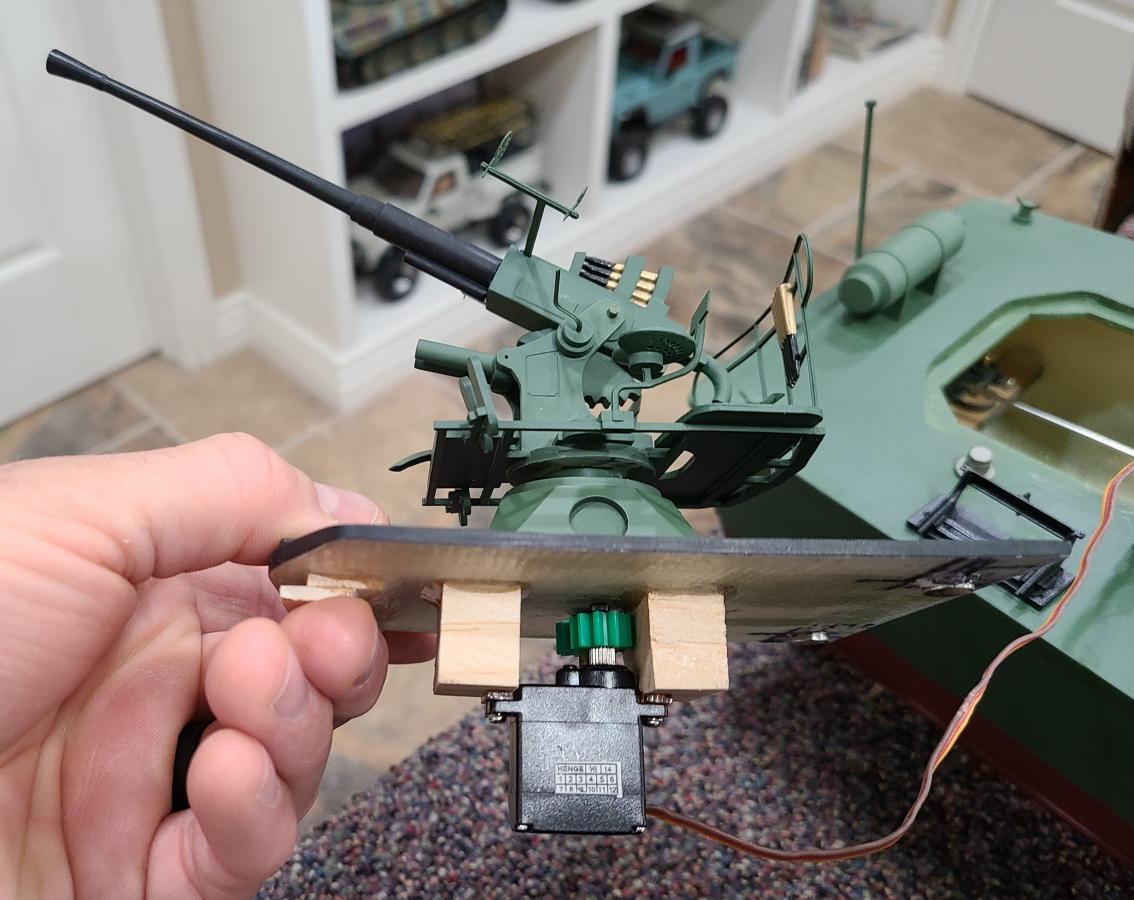

This also gave me the opportunity to automate the gun for rotation.
I had to start by adding a 2.4K resistor to one lead of the potentiometer inside the servo to get a 180 deg sweep. Then I installed a small gear on top of the servo and a matching gear on the spindle shaft I made for the gun. Of course some blocks glued to the underside of the hatch to screw the servo too. They are held in place by epoxy.
