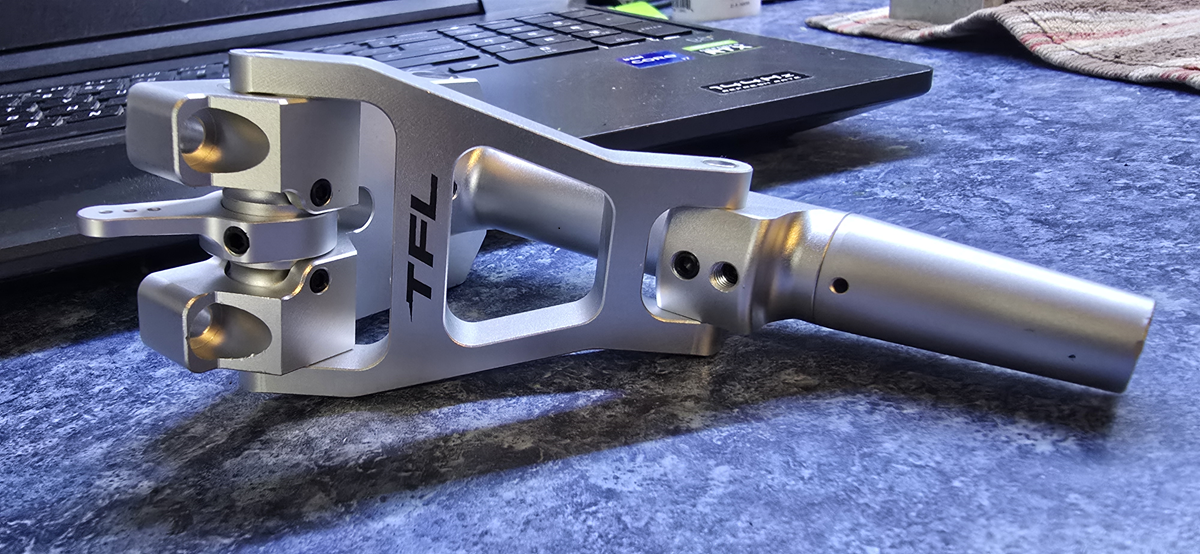

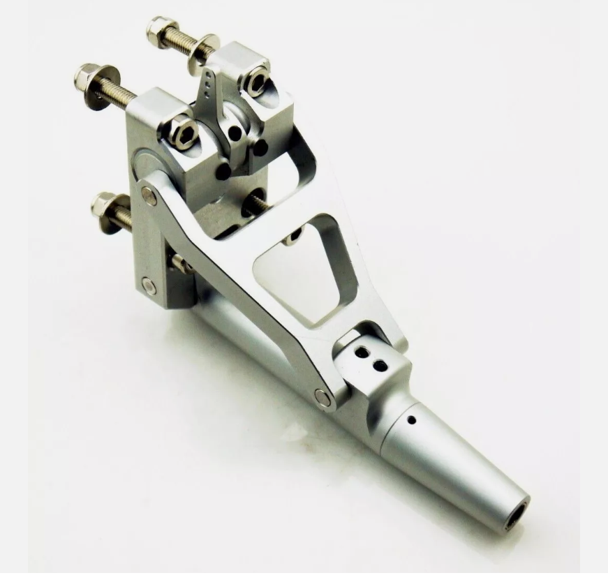

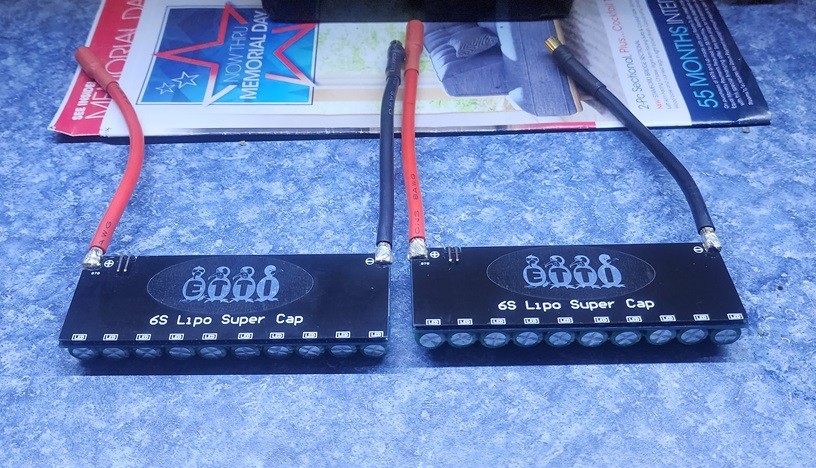

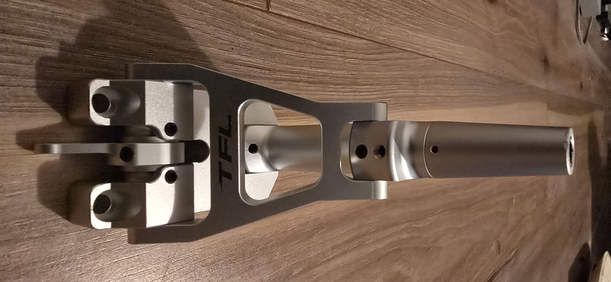

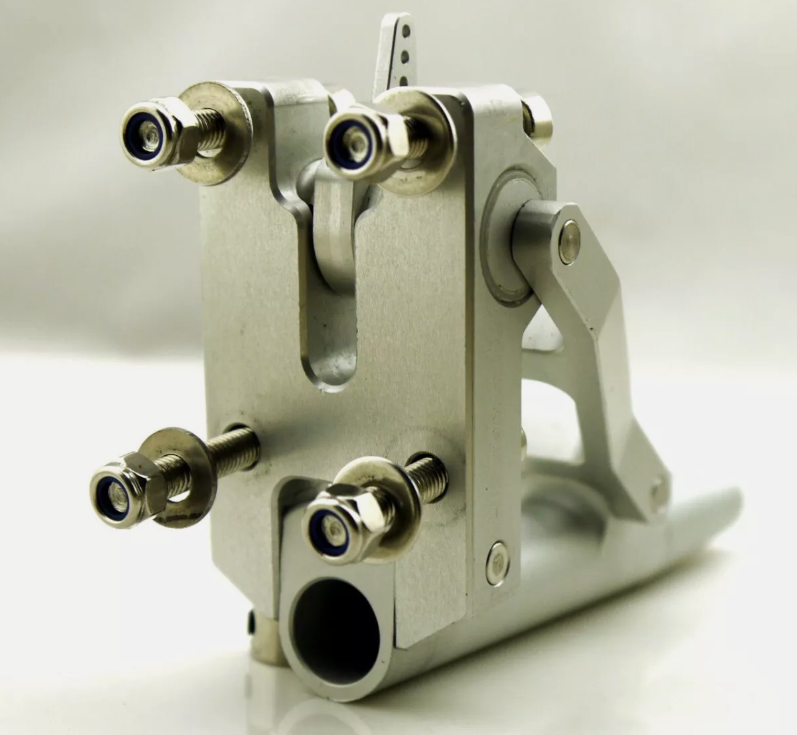

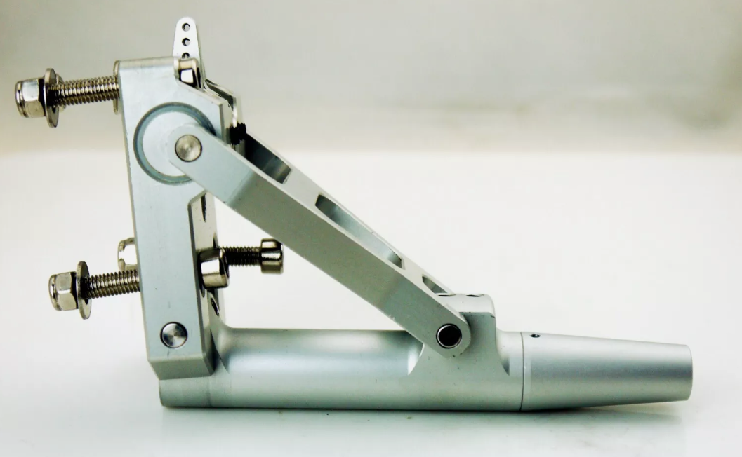

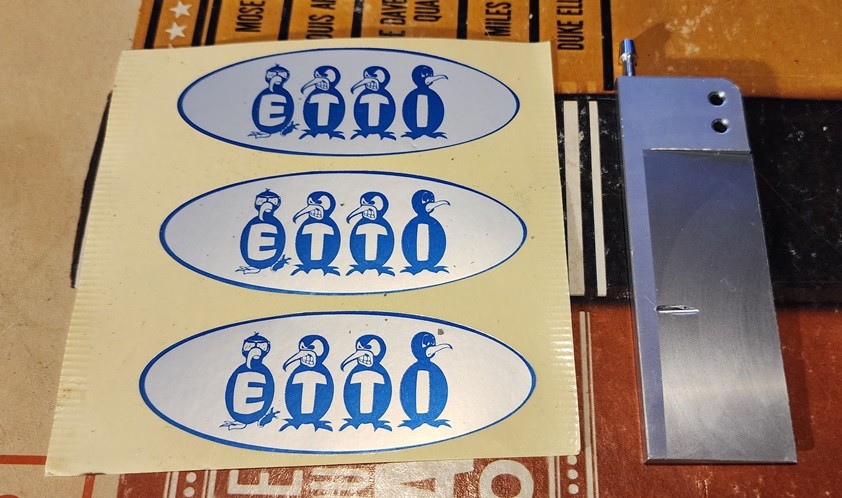

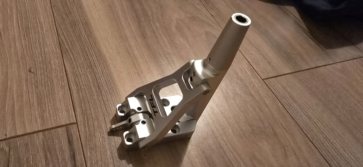

I'm equally guilty but as American we always talk all this ying yang about Chinese quality and sometimes the quality is low but in the case of Dee in Hong Kong it is not. I don't know what material Dee uses but ETTI hardware has always been some of the best hardware you can get. I wish they made hardware for the really big boats and riggers because the quality is second to none. You never need to break a single edge. It appears apparent in their tool paths because every iota of the items AWAYS have perfect and uniform broken edges. The material is also different grade of Aluminum than you generally see . It is lighter , stronger , and seems to machine to a better finish. I'll have to ask Dee what he using but it is of a very high quality. It was much better than that of the Sweeds at BB. That's the truth directly from what I have in my hands here. I needed to clean up the BB hardware quite a bit.

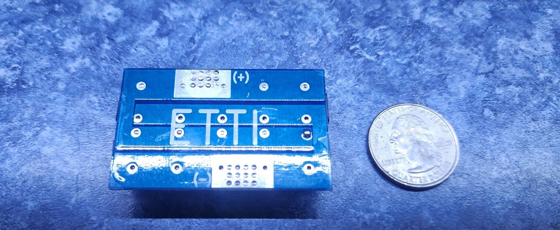

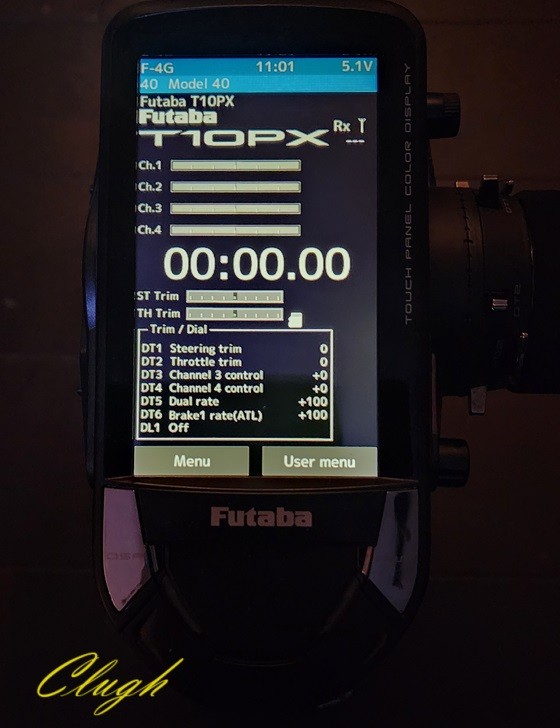

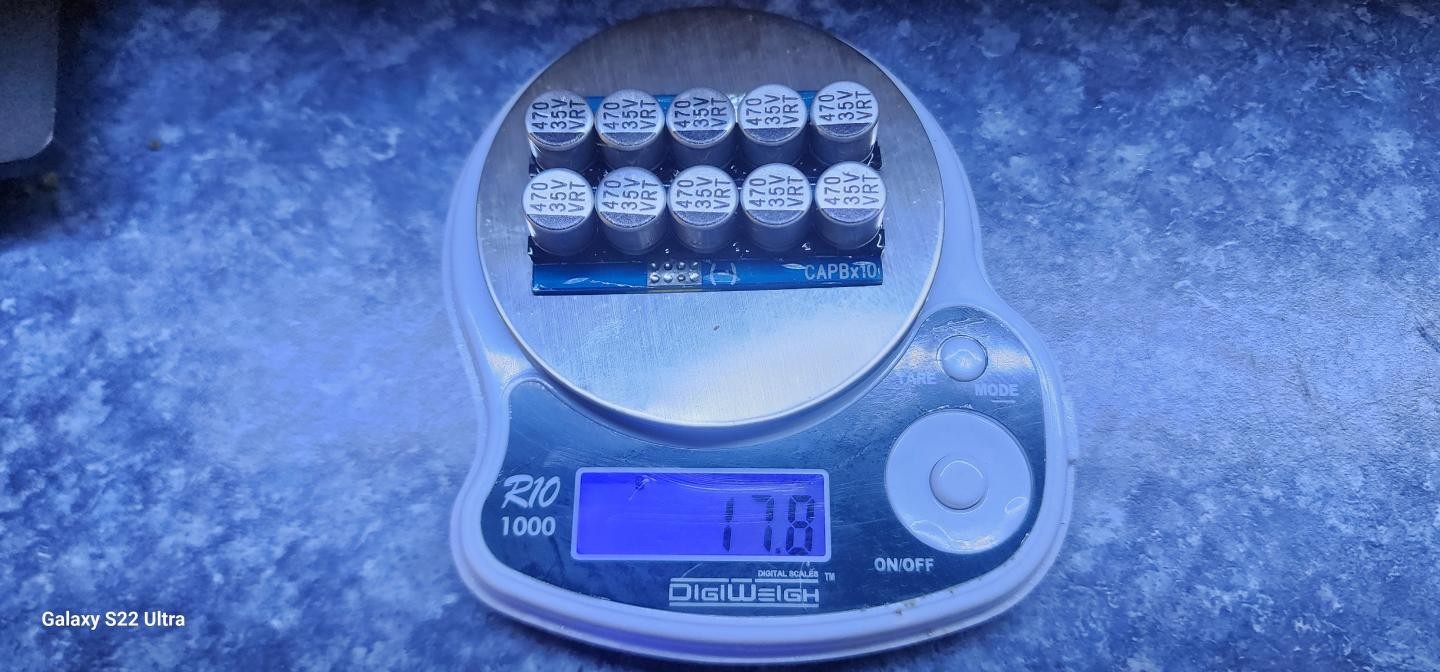

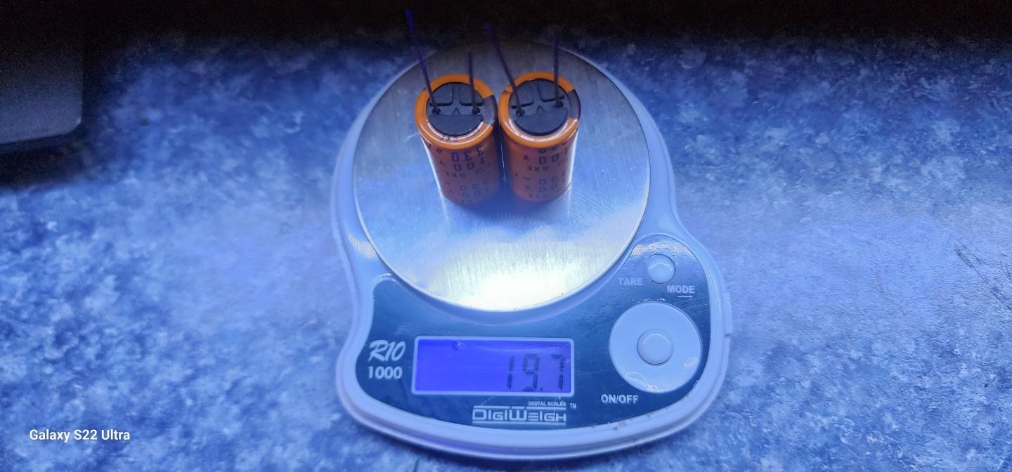

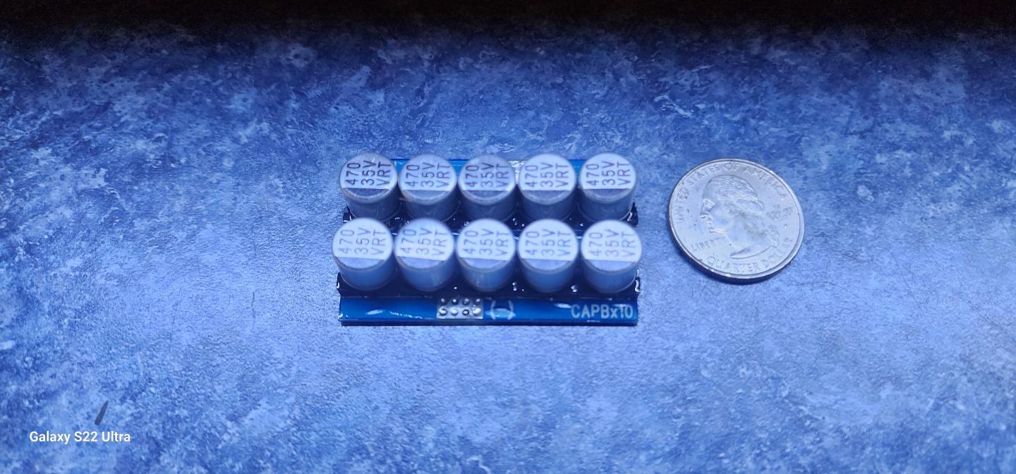

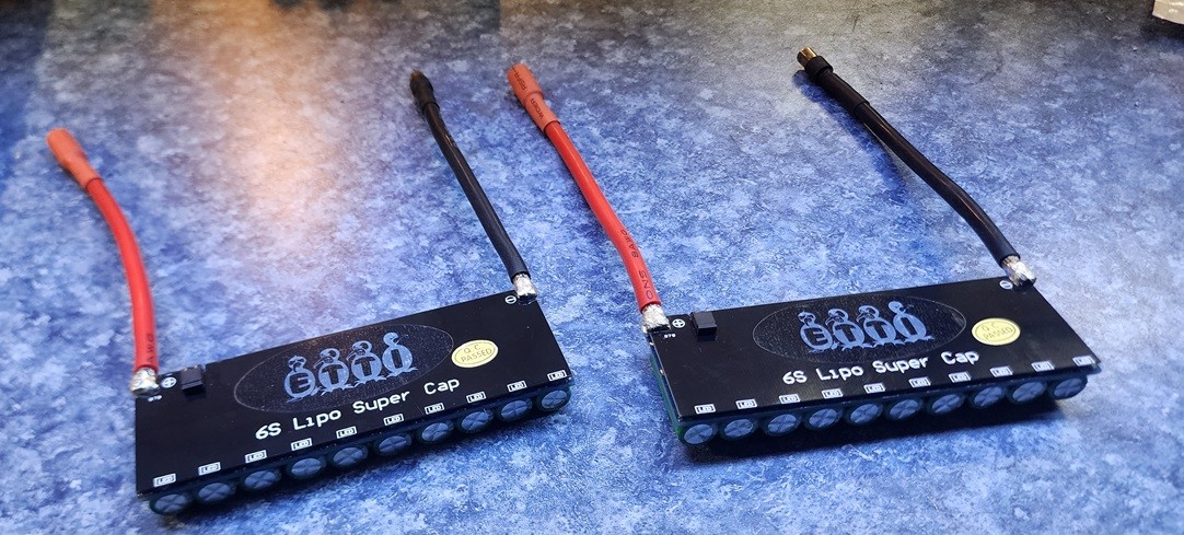

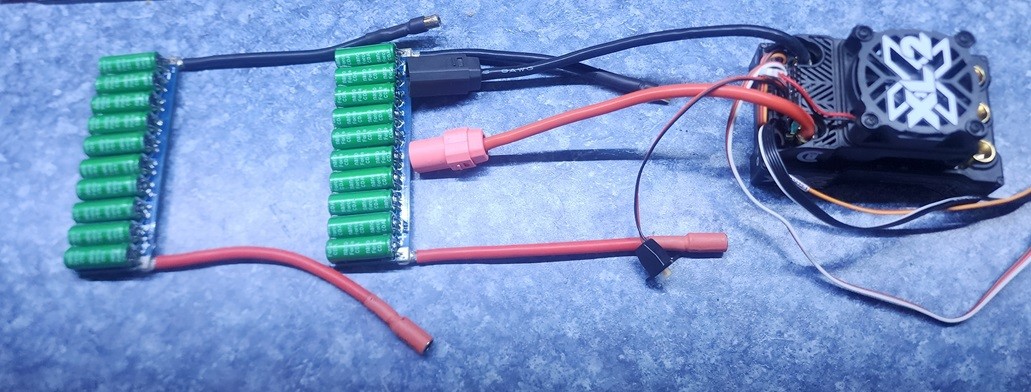

Here are photos on the scale that show the difference in weight from standard electrolytics versus hybrid caps. The 2 100 volt barrels like you see typical only give you 660uf while the hybrid bank gives you 4700 uf. The 10 px was damaged and had a cracked LCD . Its back now and ready to go. Were getting close..... but I still have to fully configure XLX2 & 2028 telemetry and then the Futaba onboard gyro.
