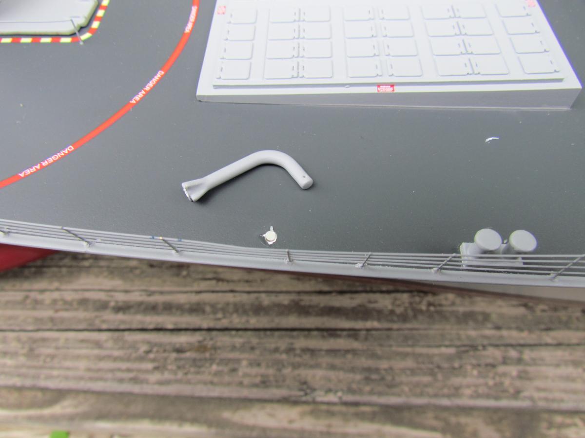

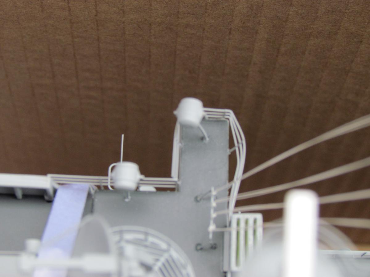

    So I'll start with damage achieved.
    One broken off king post
    Click image for larger version  Name:	IMG_2808.jpg Views:	4 Size:	76.8 KB ID:	429026

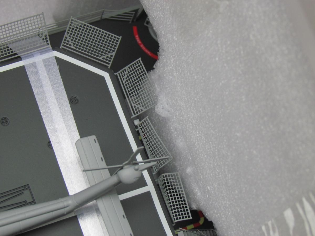

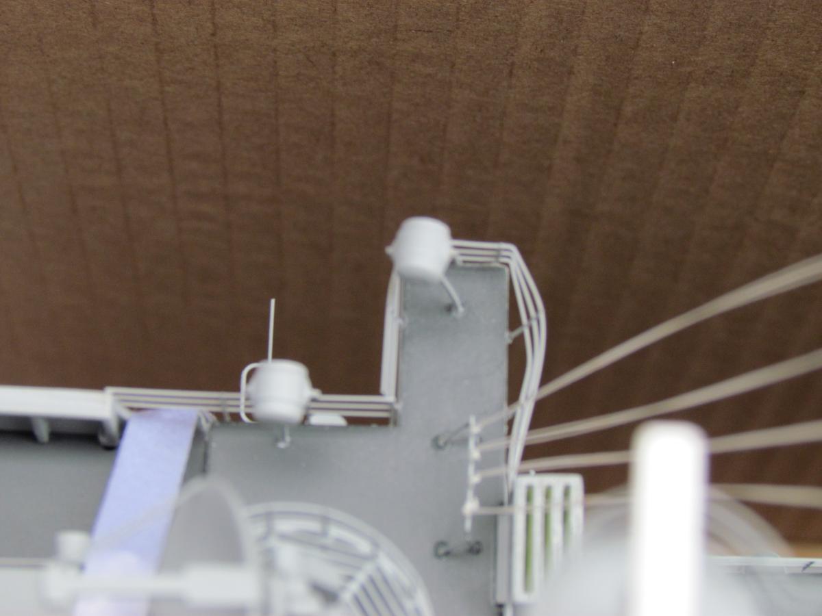

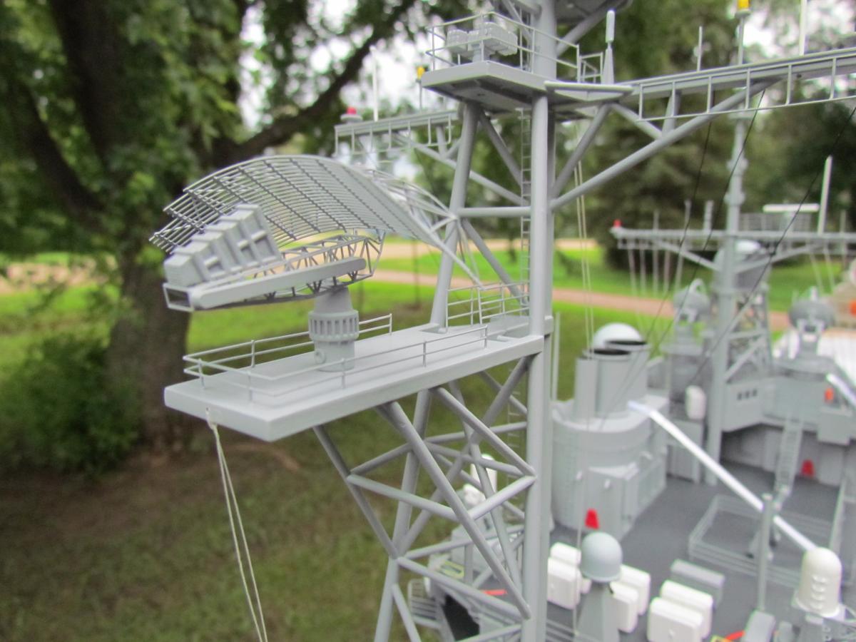

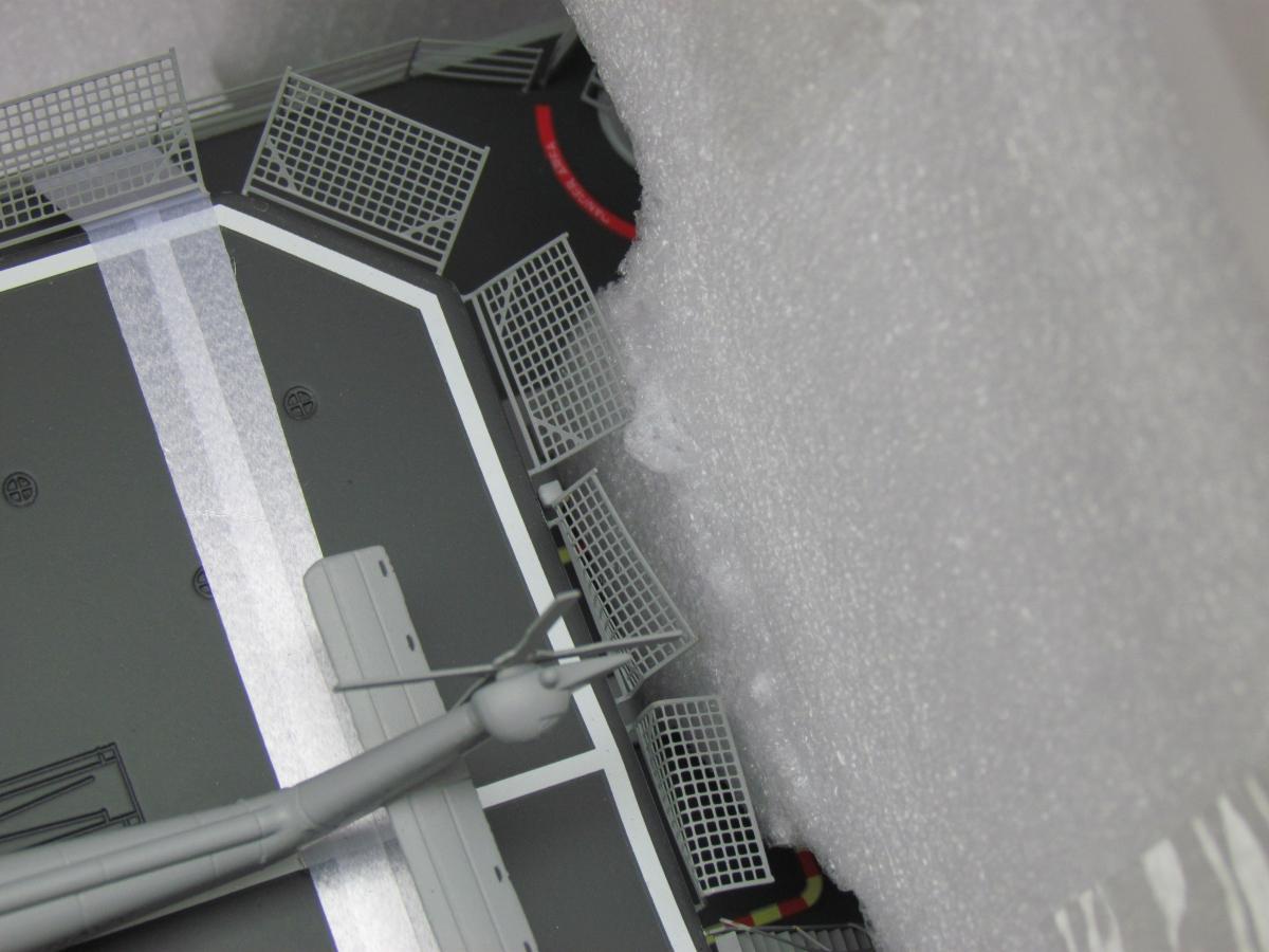

    One bent railClick image for larger version  Name:	IMG_2781.jpg Views:	4 Size:	73.6 KB ID:	429029 one bent radar assembly and two bent safety nets Click image for larger version  Name:	IMG_2779.jpg Views:	4 Size:	97.1 KB ID:	429030
    non pictured scuffed paint under the superstructure...
    Yeah Bancroft packing for the win .

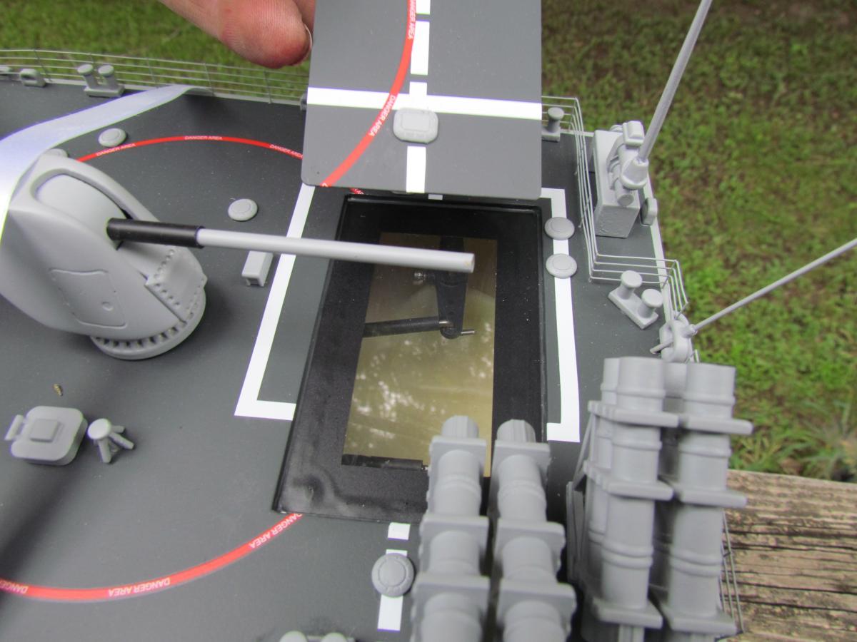

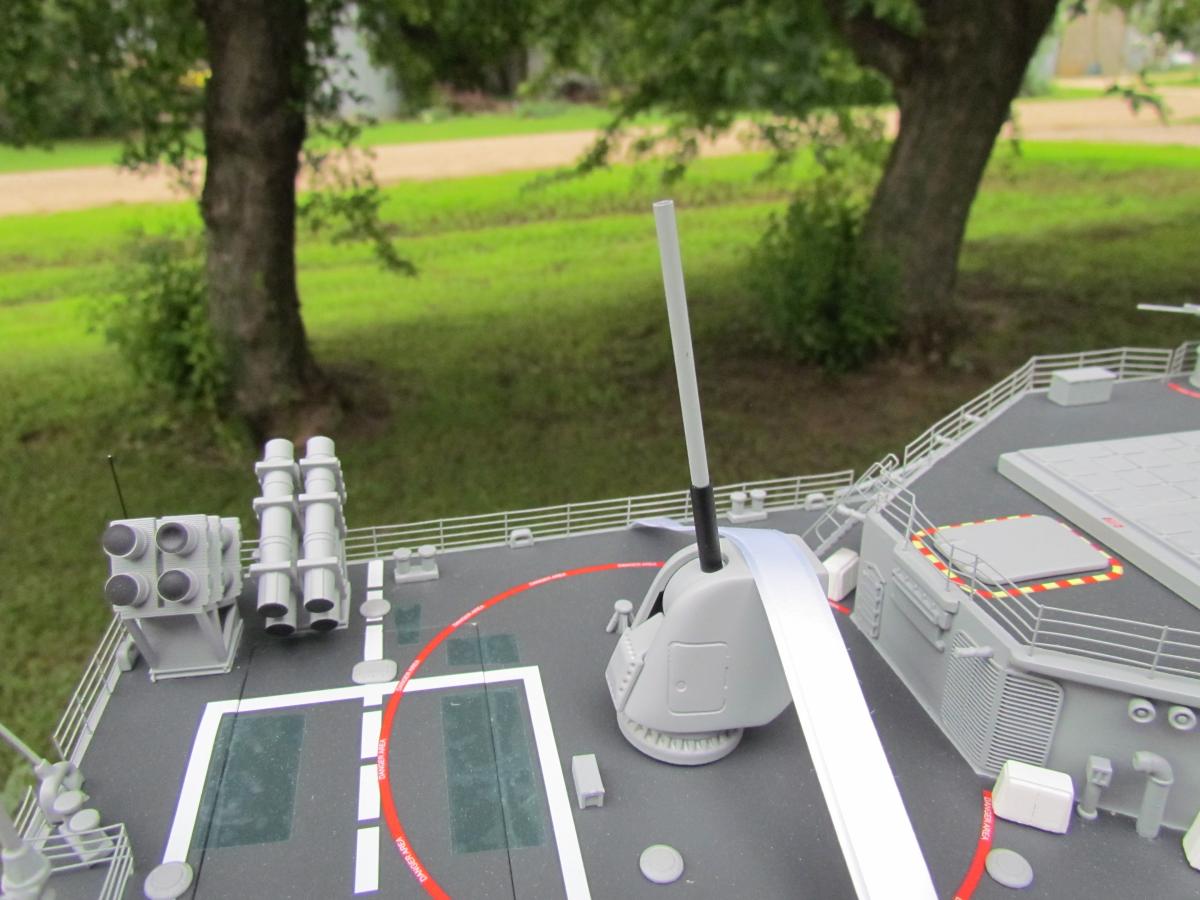

    Couple of win (in my opinion) items.
    Click image for larger version  Name:	IMG_2783.jpg Views:	4 Size:	208.0 KB ID:	429034
    The gun barrels DO elevate. (not sure why they didn't for the release vid by Motion)
    Click image for larger version  Name:	IMG_2786.jpg Views:	4 Size:	111.9 KB ID:	429031
    Click image for larger version  Name:	IMG_2785.jpg Views:	4 Size:	108.7 KB ID:	429035

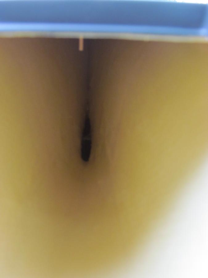

    the covering over rudder hatch
    Click image for larger version  Name:	IMG_2798.jpg Views:	4 Size:	101.3 KB ID:	429033

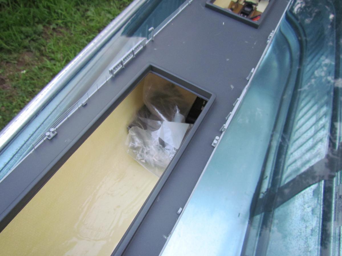

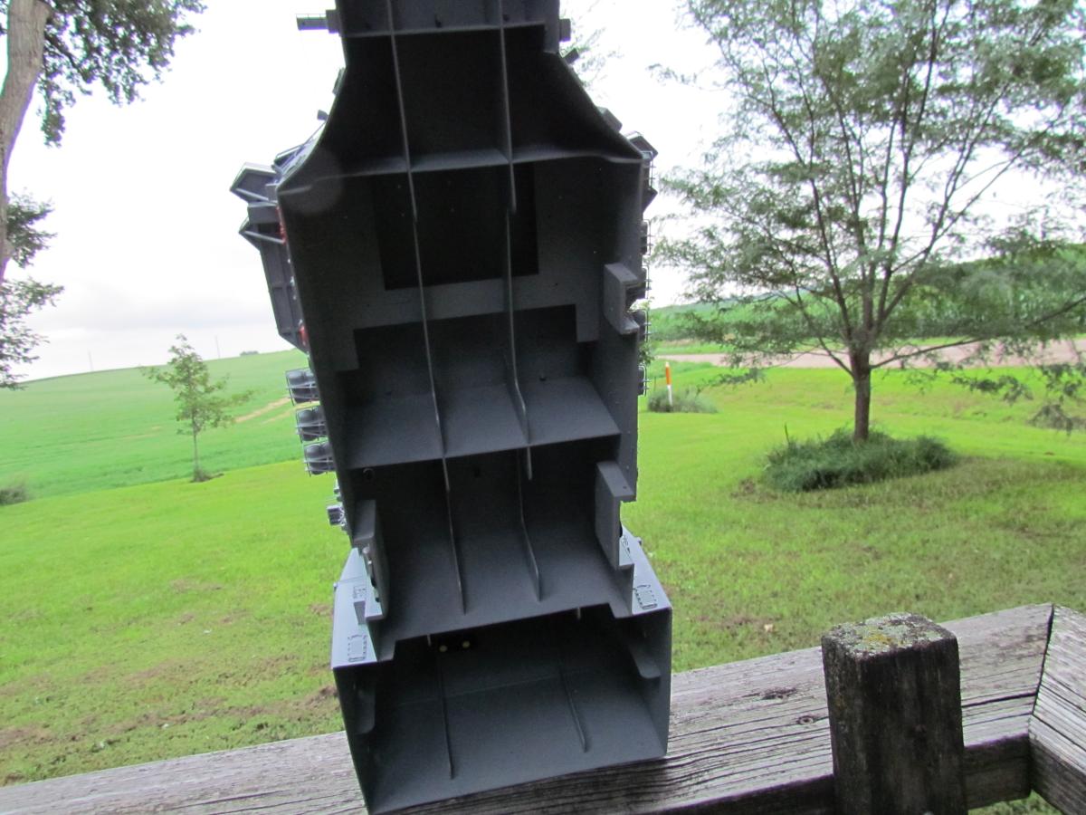

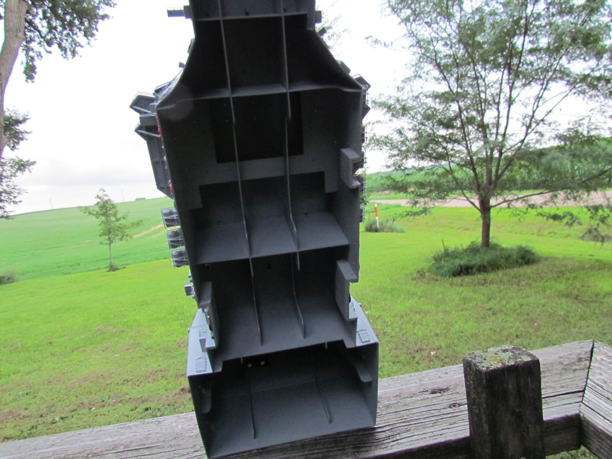

    and the nice and Large interior openings
    Click image for larger version  Name:	IMG_2802.jpg Views:	4 Size:	88.1 KB ID:	429032

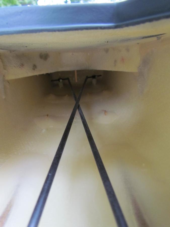

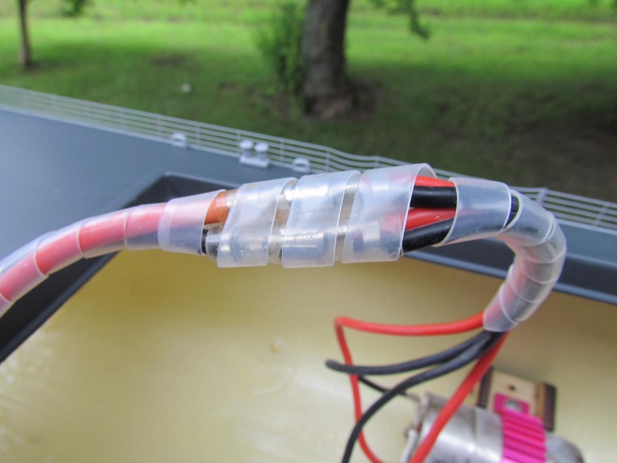

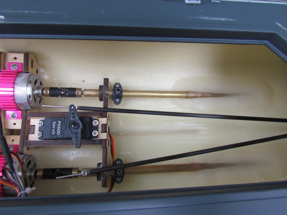

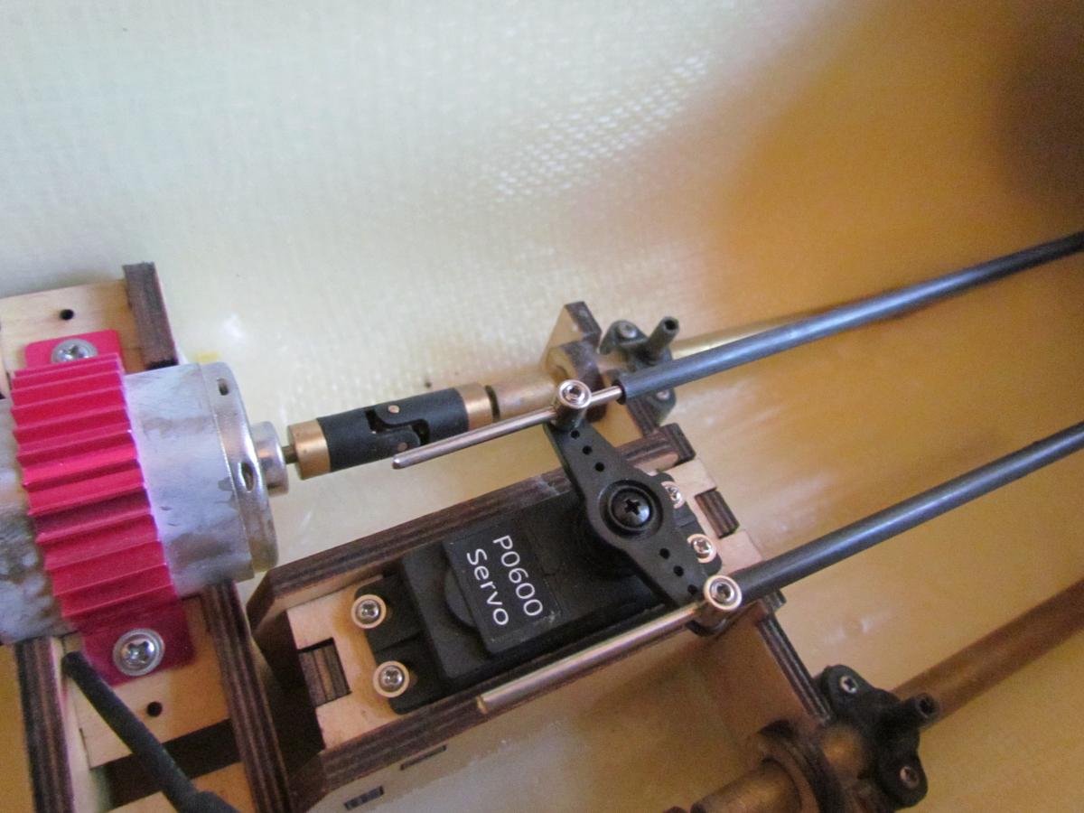

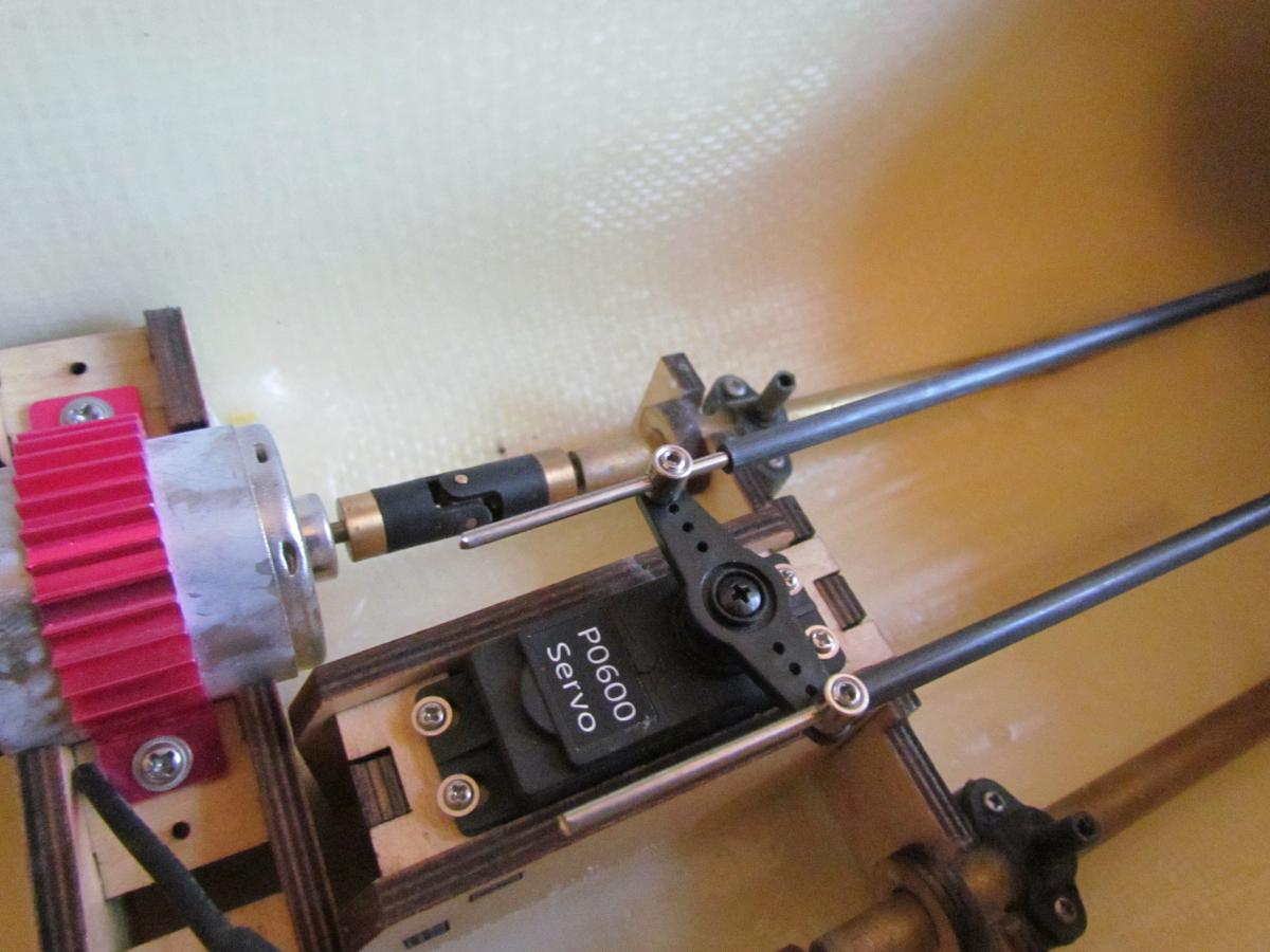

    so first ding from me shows in the pic above. The rudders were not connected to the servo. the to metal fittings just slip into the holes on the servo horn but were not secured to said horn (unless there's two tiny nuts lost somewhere in the massive interior of the ship. Seriously its ginormous in there.)
    Fwd
    Click image for larger version  Name:	IMG_2805.jpg Views:	4 Size:	23.5 KB ID:	429038
    Aft
    Click image for larger version  Name:	IMG_2803.jpg Views:	4 Size:	35.5 KB ID:	429037

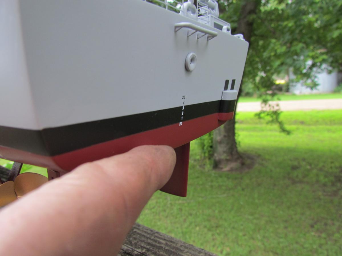

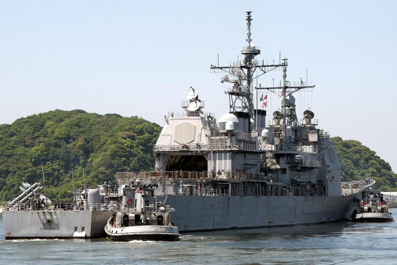

    Next ding is from me on the Hull form there's supposed to be a "Stern Flap" to increase fuel efficiency thats not there. (example is not a Tyco one but is close enough)
    Click image for larger version  Name:	OIP-1151631950.jpg Views:	4 Size:	29.9 KB ID:	429040Click image for larger version  Name:	IMG_2814.jpg Views:	4 Size:	67.9 KB ID:	429039

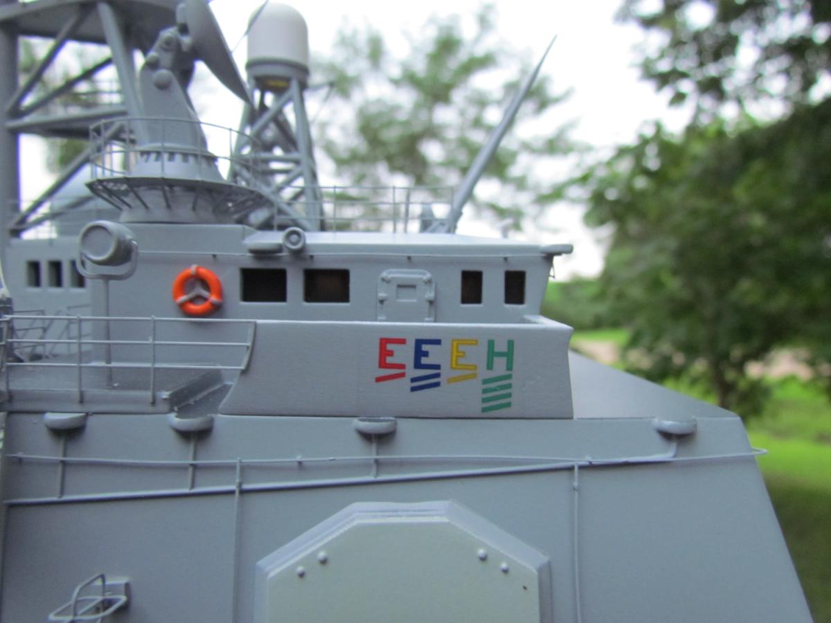

    Then a strange Paint fail.
    Click image for larger version  Name:	IMG_2788.jpg Views:	4 Size:	99.7 KB ID:	429041

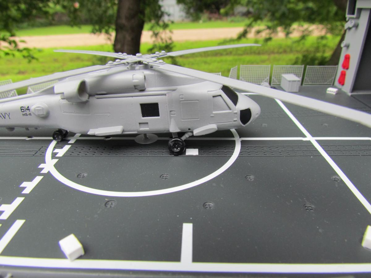

    One window on the SH-60 didn't get painted. Easy fix. Will do it when I paint the Propellers Black which they really should be but oh well. Heck she may get yanked off and get the full on Sundowners paint job if I can work myself up to it.

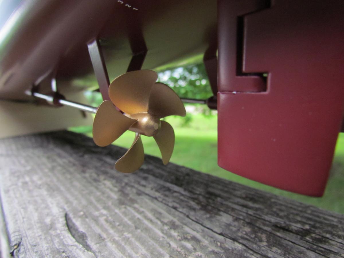

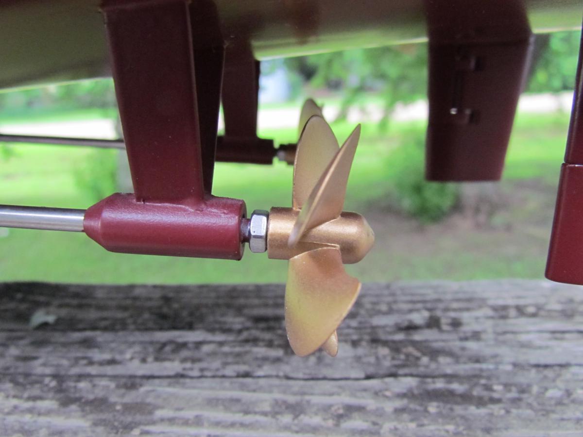

    Another easy fix. The counter rotating props go the wrong way... Yup I am griping about something that'll be under the water. I also worked in the Engineering Department on one of these and was responsible for making those propellers turn. Its silly but important to the ENG MP GSMC(ret) OCD in me. Easy enough swap the props and swap the plugs to the ESC. Another positive while I'm on it. They got the struts right. Seriously I like that. A LOT. And for what they are the props are fairly close to right for the real thing The Rudders on the other hand.. I'm guessing they needed a bit of stiffening so are close enough.
ID:	429045 Click image for larger version
ID:	429046 Click image for larger version
ID:	429047 Click image for larger version

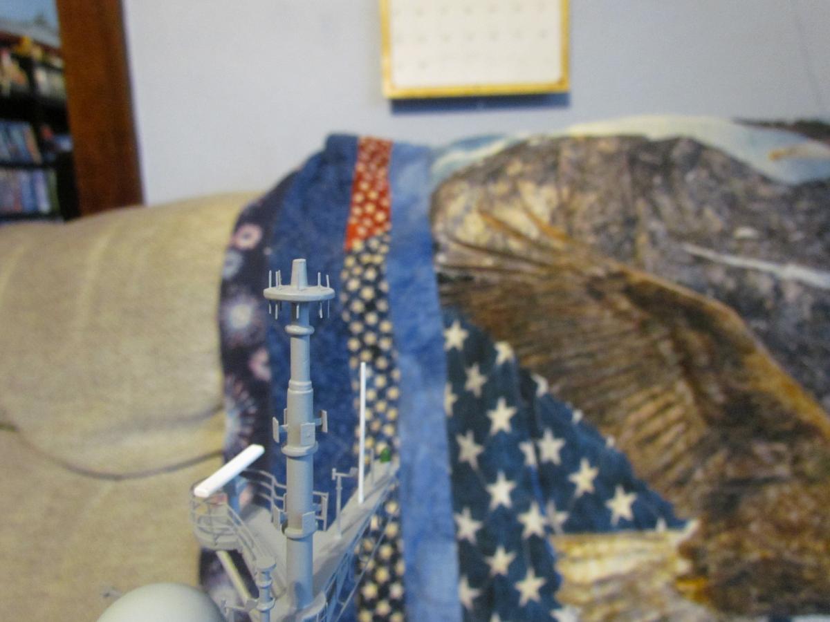

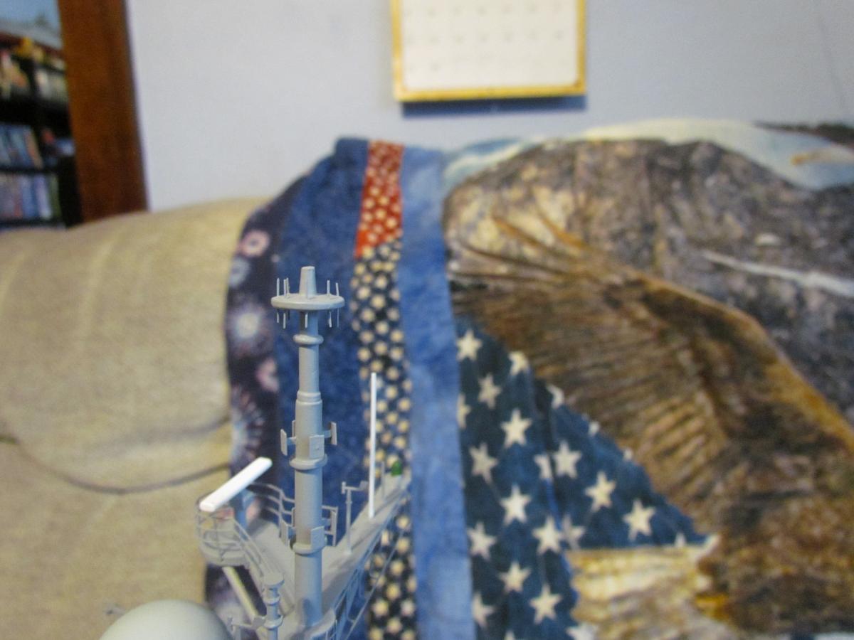

    For those who served on one or hardcore modellers there is lots to fix.
    The good news is there is room to do so without basically having to rebuild from the keel up.

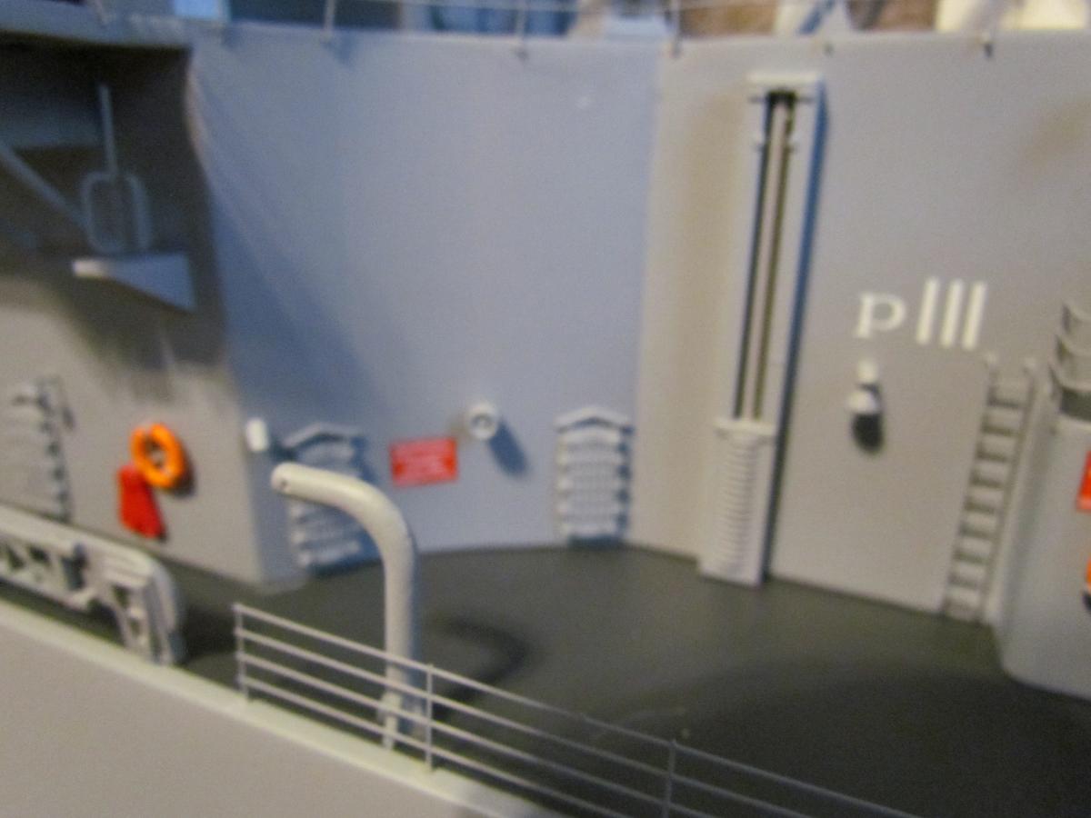

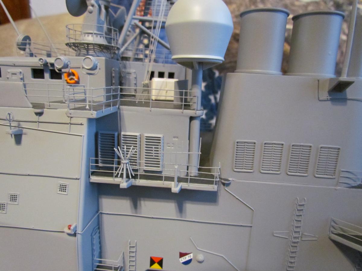

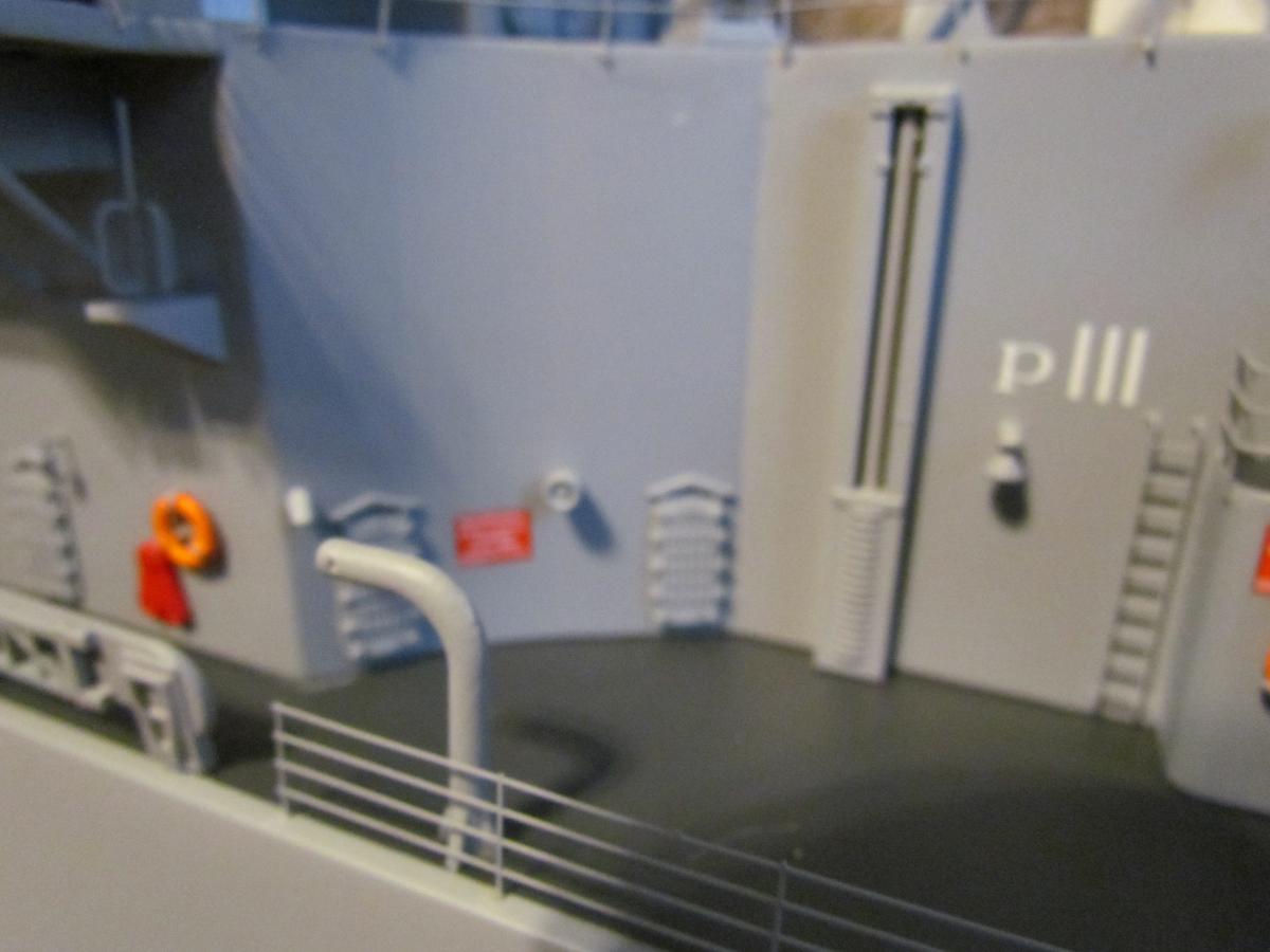

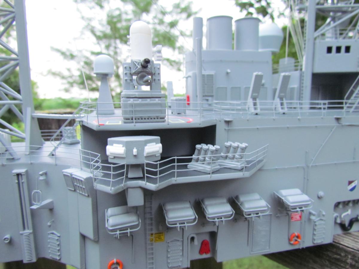

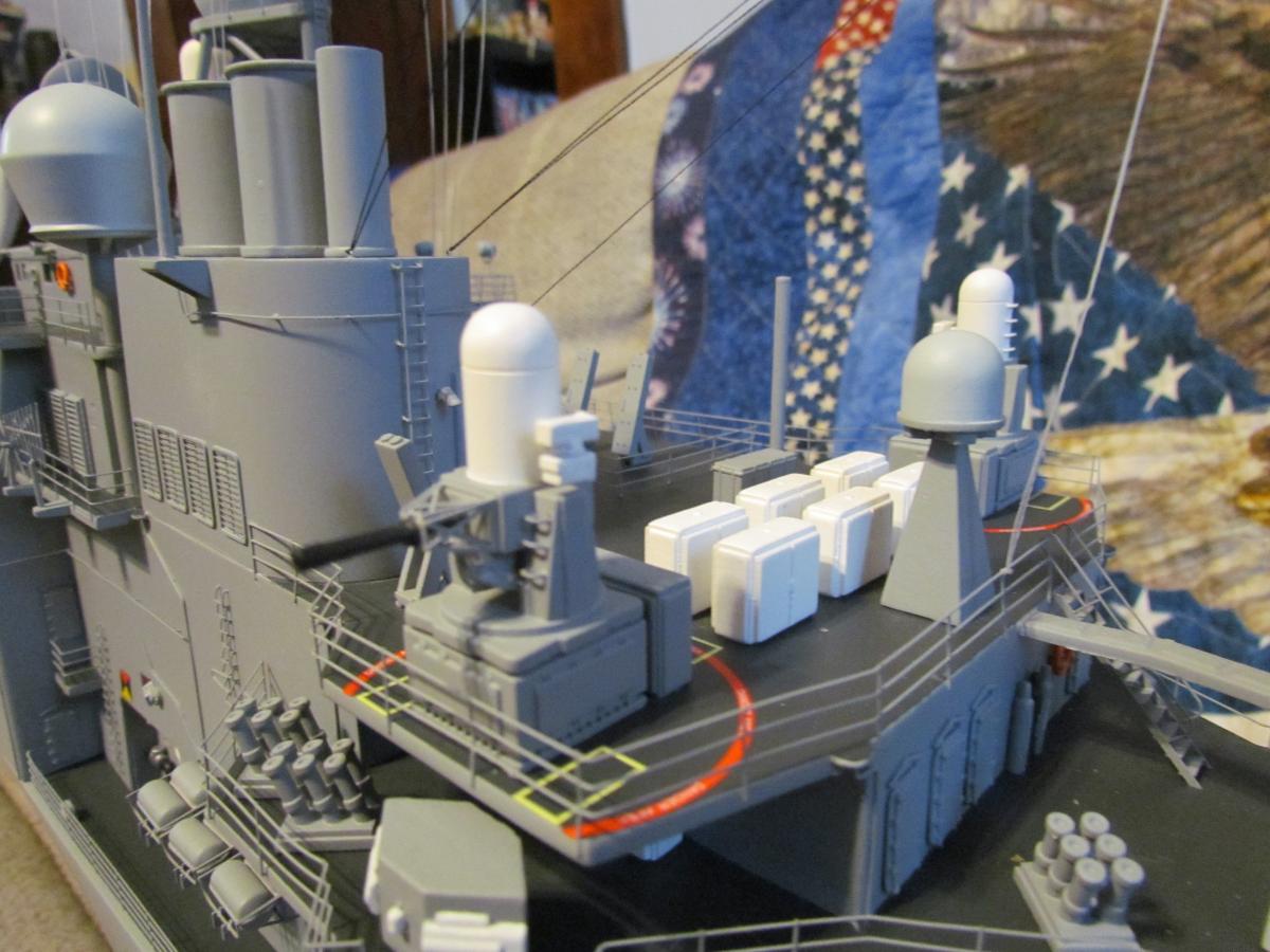

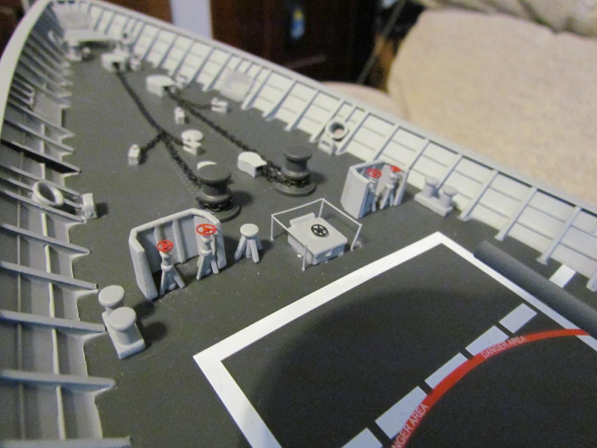

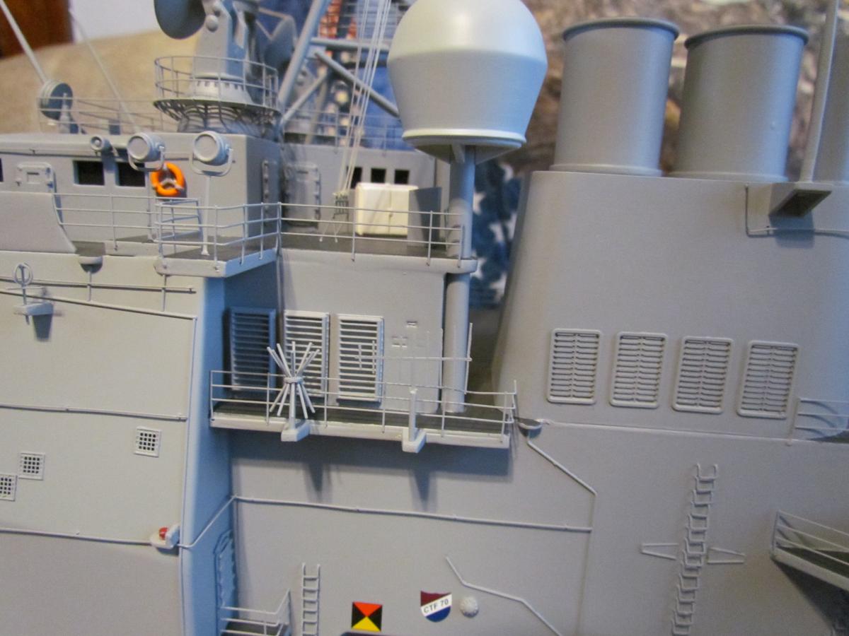

    So positives. The Details HOLY COWPENS THE Details
    (if you depict her make sure you get some Long Horns to put under her bridge and paint em on the stern then put pics in this thread of it I want to see it)

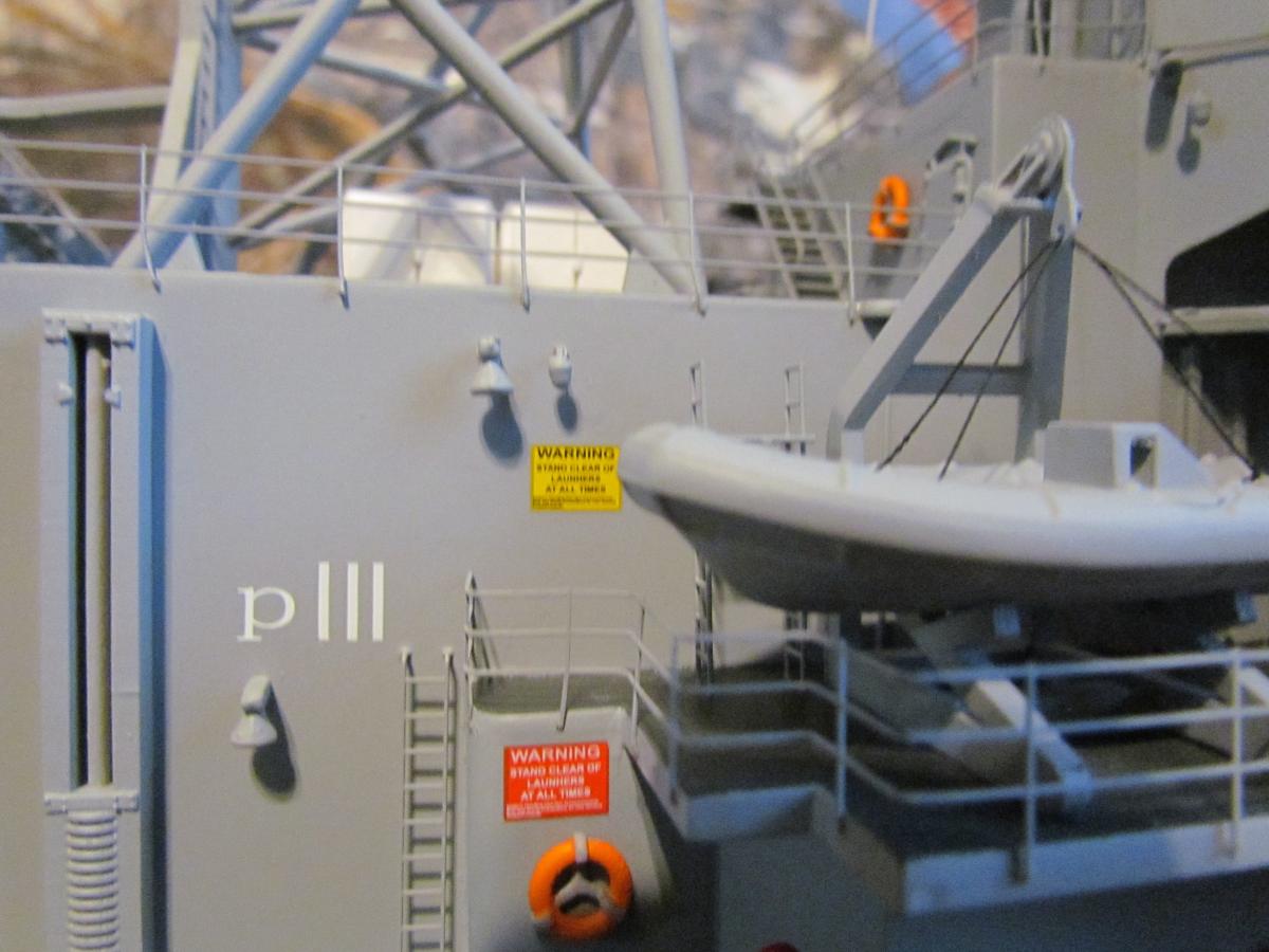

    Details are everywhere on this ship from placards you can read (with a magnifying glass for those of us with less than stellar vision but still readable) Hatches with texture, anchor chain brake hand-wheels up on the focsle tiny antennas on the masts the CWIS. Small details abound.

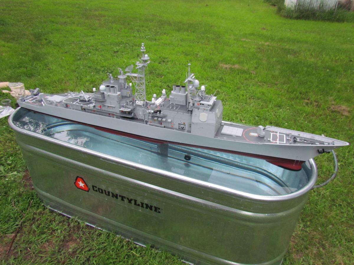

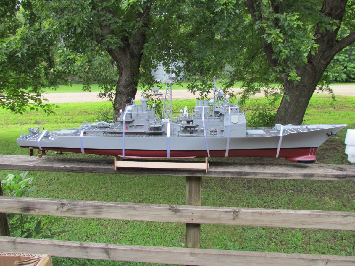

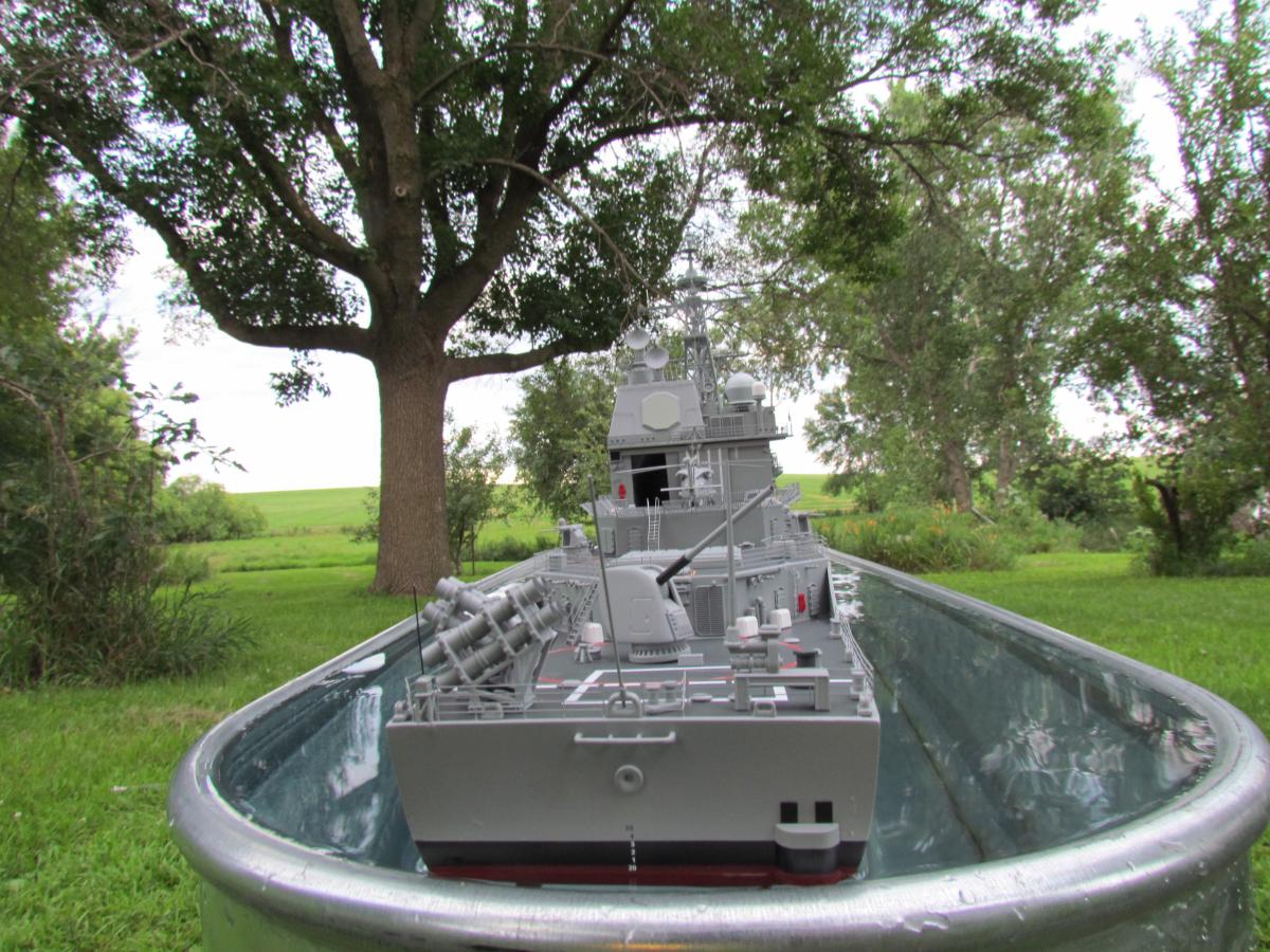

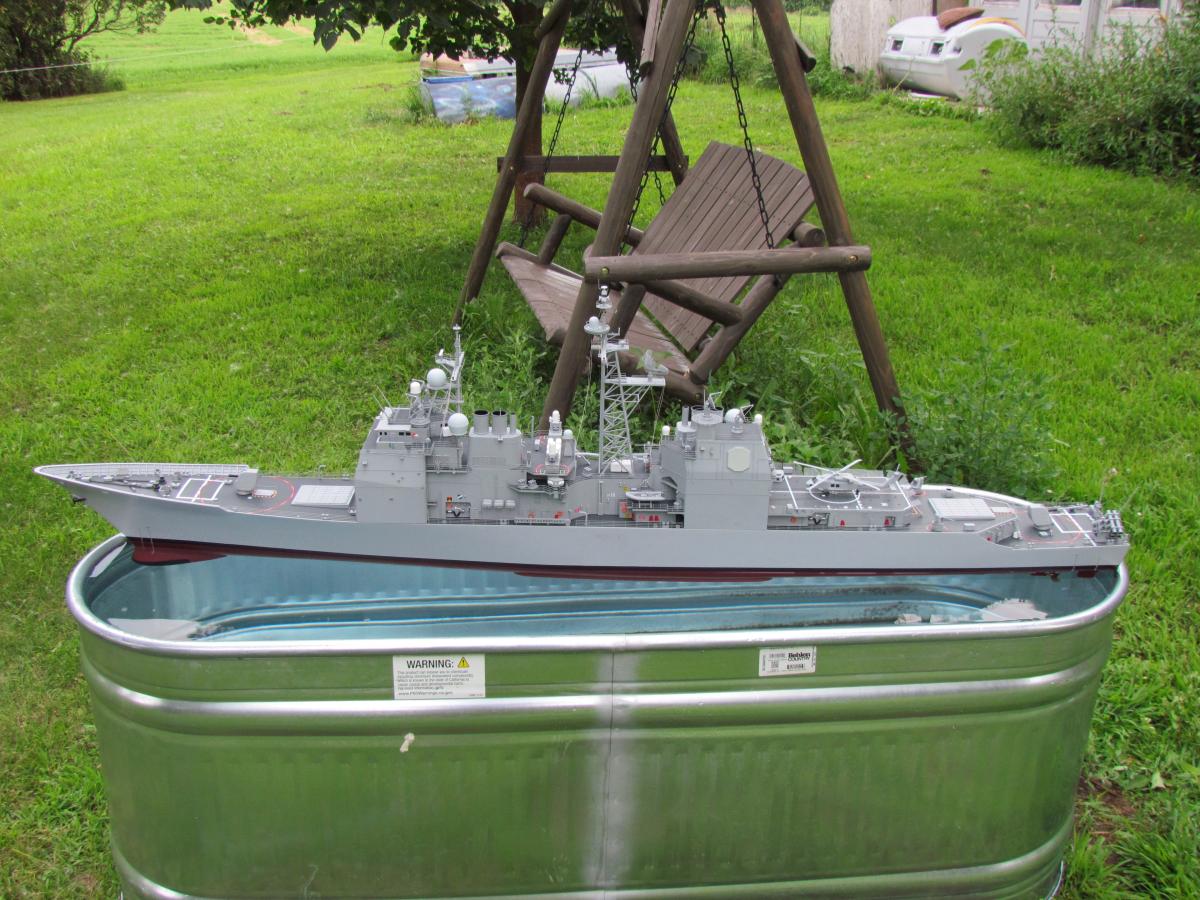

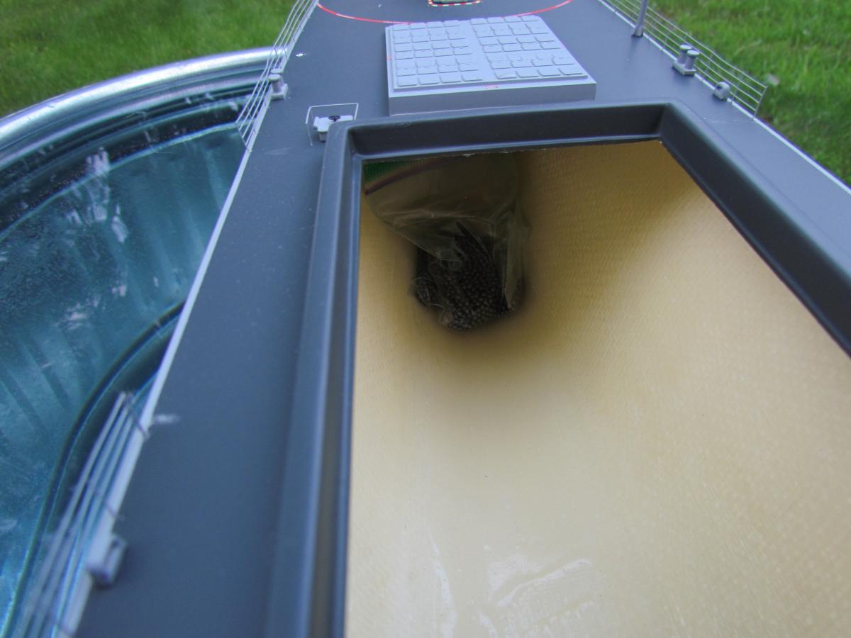

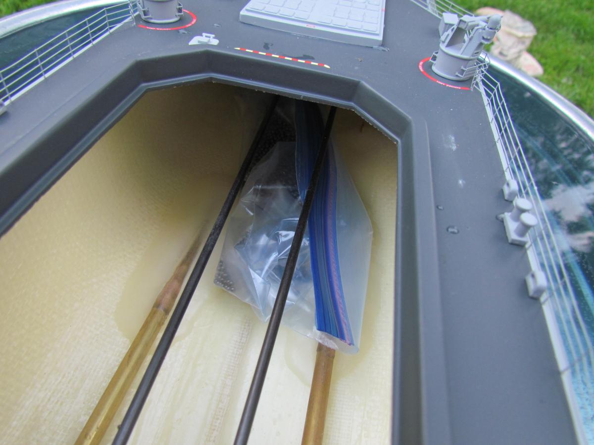

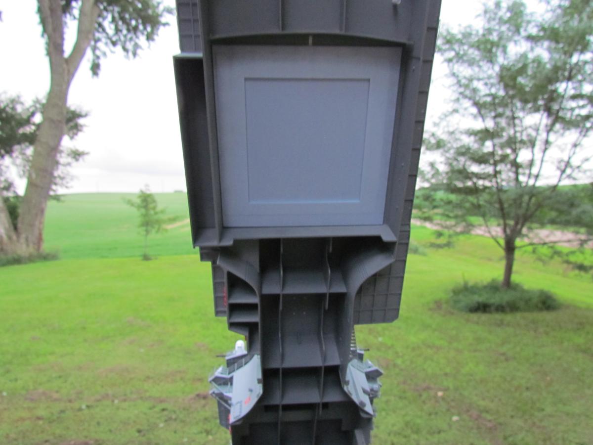

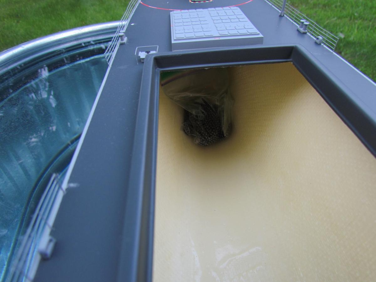

            Alright got MY ballasting. I do not have a scale of the appropriate size that works (left batteries in it way too long) at the moment but can show roughly what I put in. I used led BBs (birdshot) in zip-locs. Later I will cast em in wax inside the hull to get sort of formed bricks that I can remove, replace, and easily adjust with a hot spoon and a little effort. That is MY solution to the ballasting problem you may find your own as mine is far from perfect but I like it anyway. Also the tank I used was shall we say barely big enough filled it to the brim and had only a few inches of room either way.
            Do NOT put her in the water with the superstructure on if you do not have ballast in place she WILL capsize (thats normal for most Bancroft ships but this one especially).
ID:	429182(ballast shifted here but illistrates the point)
            This RC much like her real life counterpart is somewhat top-heavy. They were based off of the Spruance class (shout out to those of you who Pushed The Cush On DD-985 as I did as part of her last crew) then the Navy came up with the new (at the time) SPY radar system and added a couple of decks to the platform without much change to the hull outside some minor up-sizing. To lighten the load the entire superstructure is made of Aluminum as was on the Sprucance class too and they suffered some of the same issues for it. Such as cracking and corrosion issues and this weight saving measure only did so much to alleviate the top-weight problem. And for those who've been on them a distinctive lean when pier-side. It's not visible in most pics but if you stand onboard or see one in real life it is noticeable.
            TLDR She's a top heavy girl who needs more in her bottom. My scale failed due to user failures and if someone has good numbers please post em.
            She doesn't need a lot of ballast. I was kind of surprised how little she needed. I think she actually took less than my Fletcher but that thing needs re-ballasting as I've re-fit her again as I had an oopsi moving her through the house and have her down for some Yard time.

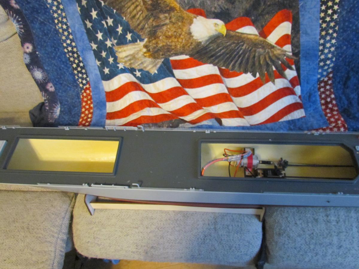

            I estimate 6 or 7lbs (yeah don't take my word for it I'm probably wrong) small bag 1-2 lbs placed forward between the VLS and Mount 5-1(gun)
            another midships under the divider between the openings with the majority of the weight
            and the final bit another 1-2 lbs under the aft VLS.
            I'd not try placing the rear ballast back by the rudder posts as that clear sticker is there to keep water out and these ships are known for putting water across their fantails. Was outside once when I shouldn't have been and ended up calf deep in water back there once and heard a few tales from Aft lookouts that got more than a little wet.
            getting the weight centered is gonna be finicky

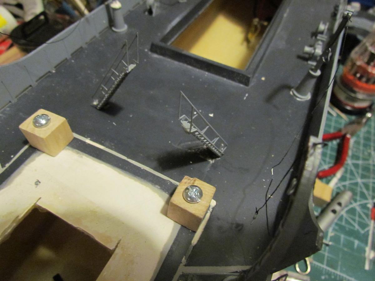

            A new point I noticed and would like to suggest to any who actually made it this far. The Ladder from the flight deck to the missile deck needs some attention.
            no matter how careful you are it's gonna get knocked off eventually. The solution I have is one I used on my Fletcher. Put a magnet underneath the deck and another under the flight deck roughly where the ladder belongs. The ladder will end up as something of a loose part but, the magnet should hold it surprisingly well. two pics from my Fletcher want more go look up that thread

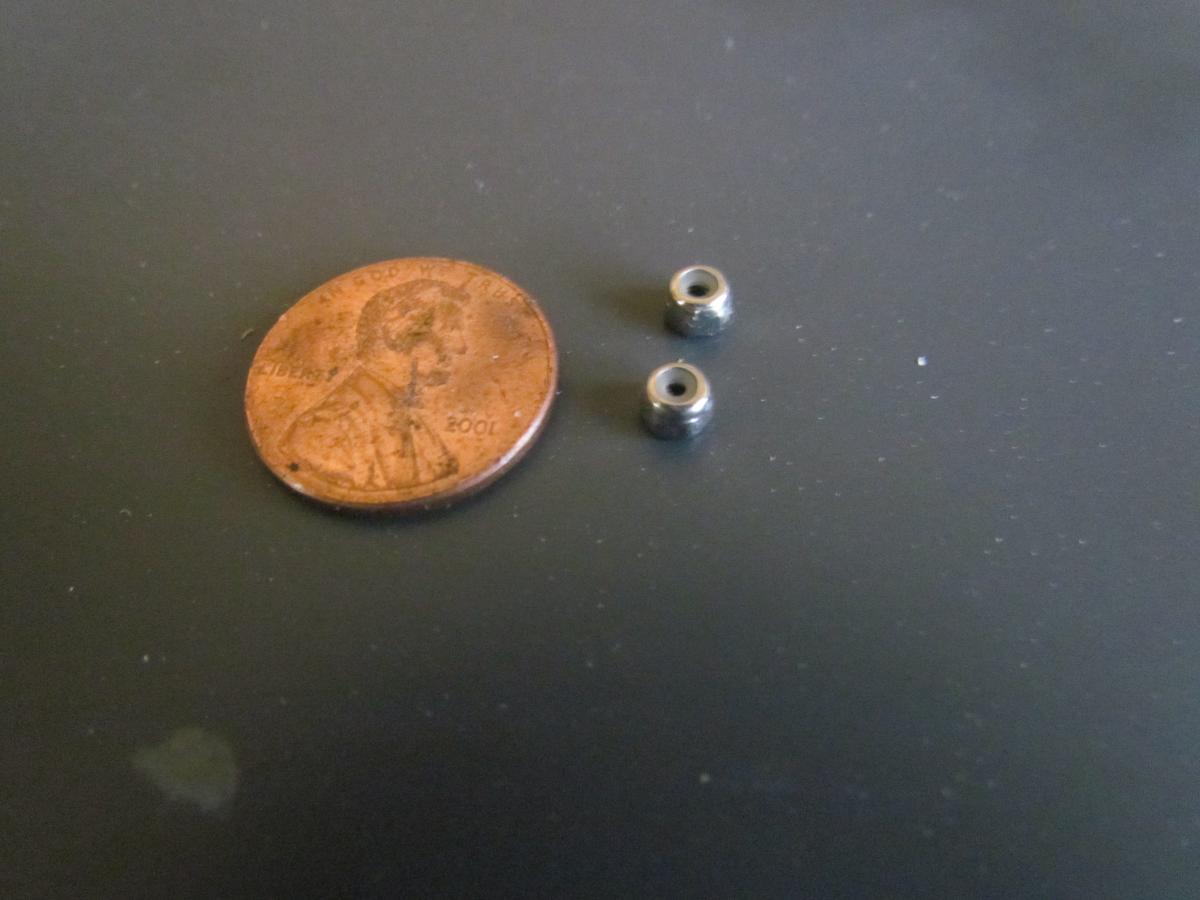

            Also my Sonar dome in the hull had a rattle... Guess what I found
ID:	429176 Click image for larger version
            the nuts for the rudder control arms. And dang are they small.
