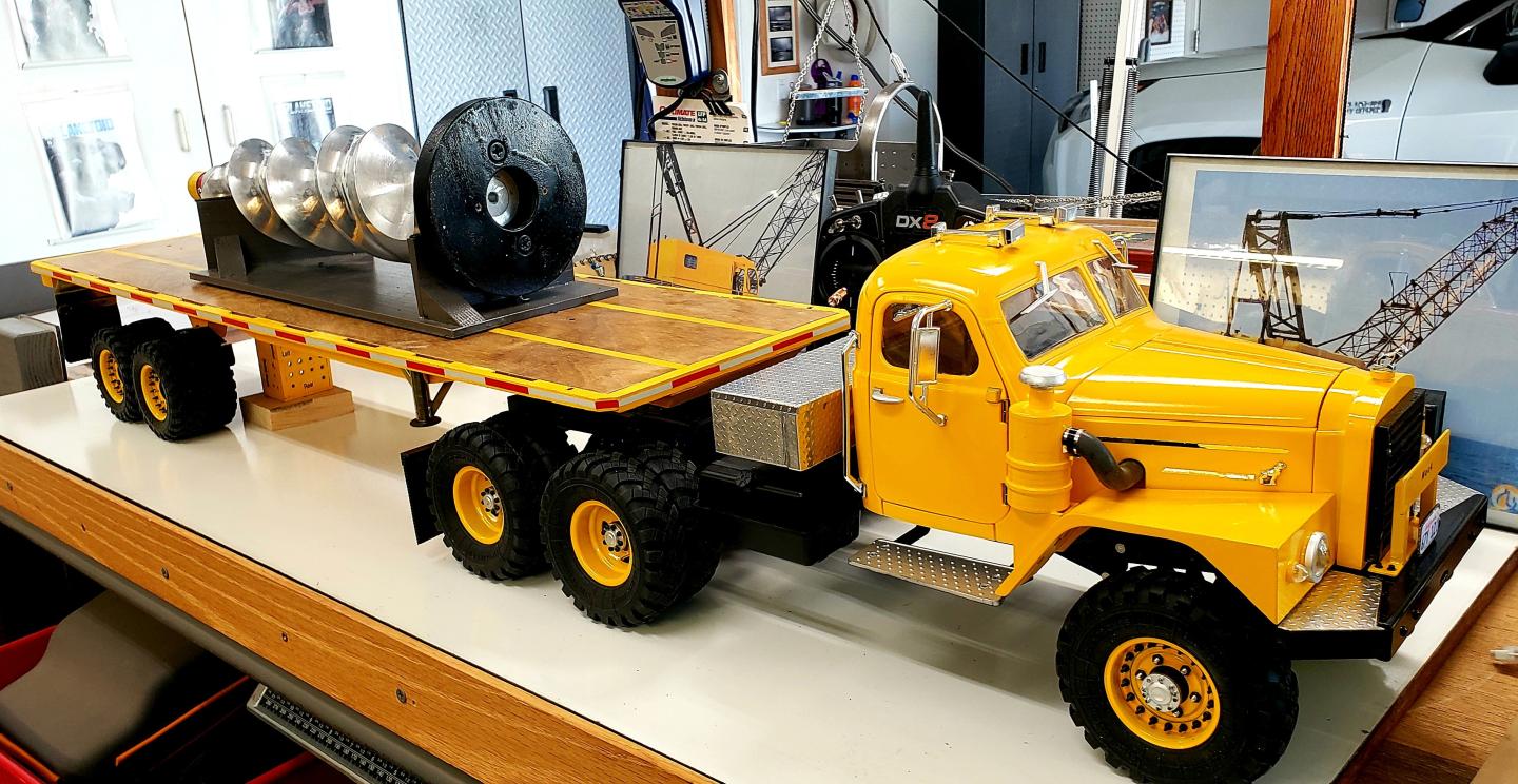

    Frizzen,
    It would be so helpful to those of us who have an active interest in RC Cobstruction Equipment, if somewhere was a posted list of contact info on the various active RC Construction Equipment groups throughout the US. I live in Central CA and cannot find any such active group within a reasonable driving distance from my home. Below is pictured a 1:12 scale RC model I recently completed of a 1960s vintage HD B81 Mack truck w/flatbed trailer that I recently completed to go along with my same scale P&H crawler crane (https://www.youtube.com/playlist?lis...oZ-4VALnrYgQKw).
    Anyway, enjoy this magical hobby wherever you may live🎈

      Great looking truck Cranemodel, also sweet crane in the avatar!

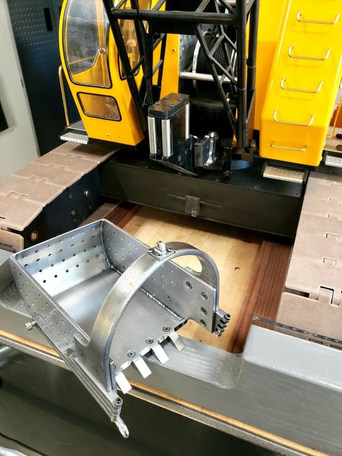

        I really like your restored/upgraded truck crane! What do you use for a dragline bucket? Attached is a photo of the 1/12 scale dragline bucket I designed/fabricated.for my crawler crane model.

          Sharp looking scoop!

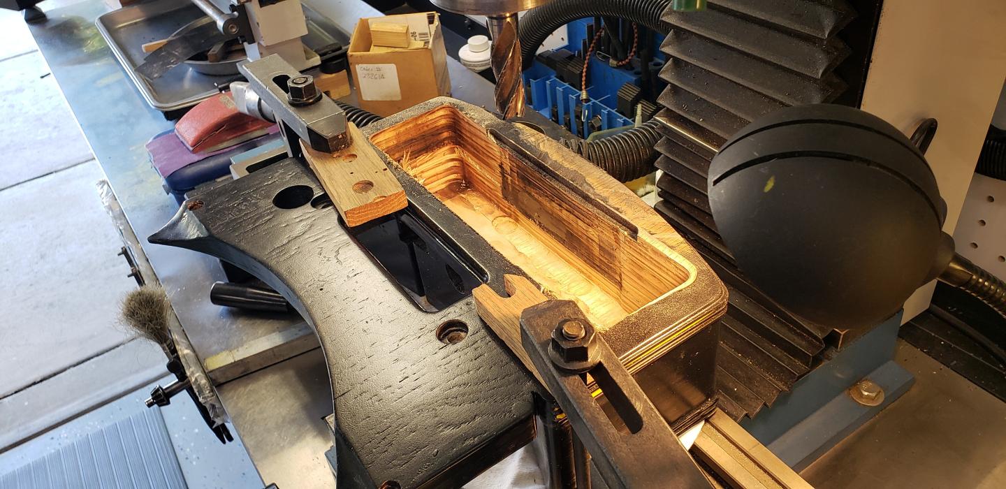

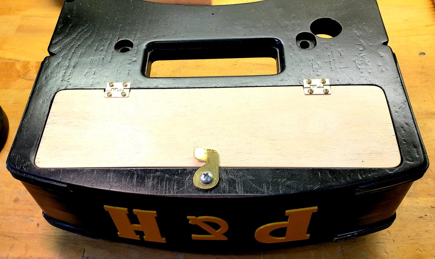

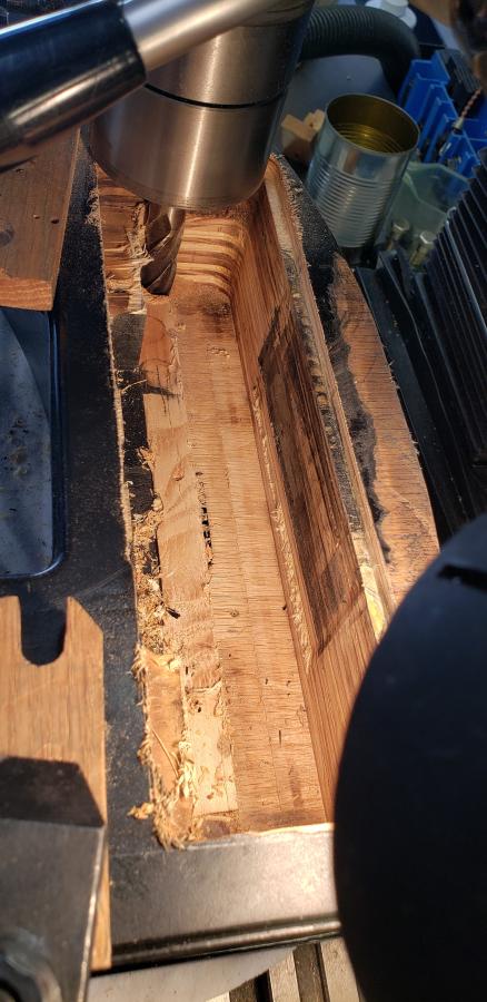

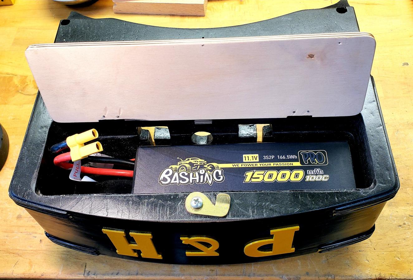

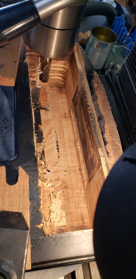

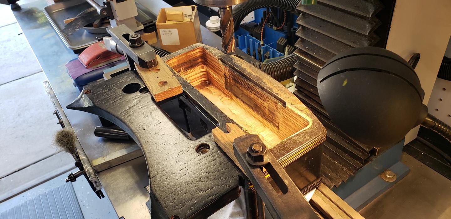

                My latest project is to replace the failed 22 Ahr LiFePo4 battery in my model crane with a 3s 15000mah LiPo Gens Ace battery. Access to the LiFePo4 battery requires the (time consuming) disassembly of the cab, so I am currently milling out a large compartment in the bottom of the model's (wood) counterweight to house the new LiPo battery in a more easy to access/switch out location. While I still need to machine cooling vents in the cover and paint it and then update the wiring, the attached photos show where I am now.

                  Those upgrades look great. It's always tough trying to balance scale vs ease of access with anything. Looks like the counterweight hatch is a great way to adapt and overcome the problem. I know I've got several that i still need tools to put charged batteries in.
                  Other times you reject 'building a ship in a bottle'
                  I don't care, i'm taking off the whole lid
