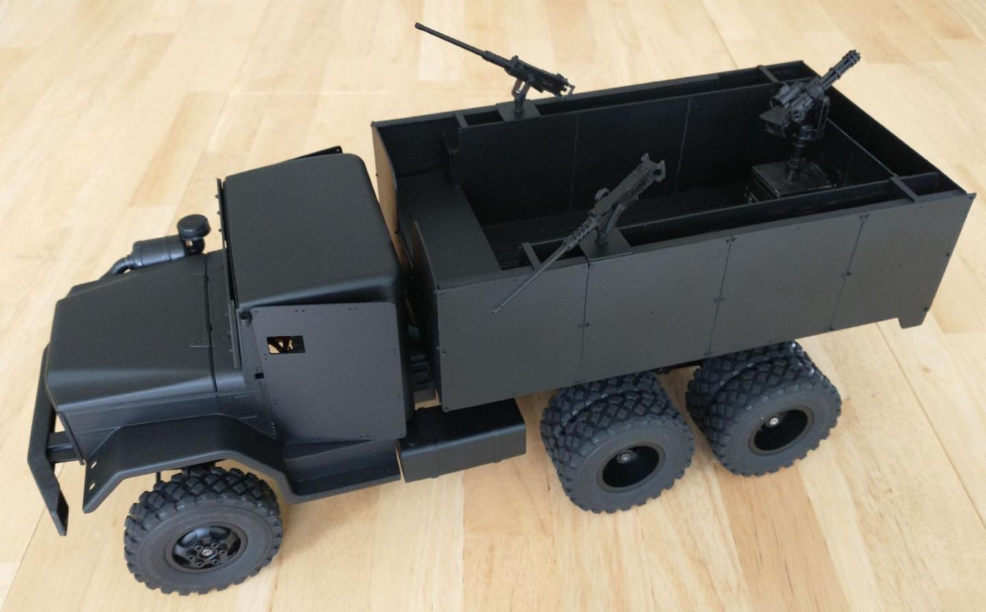

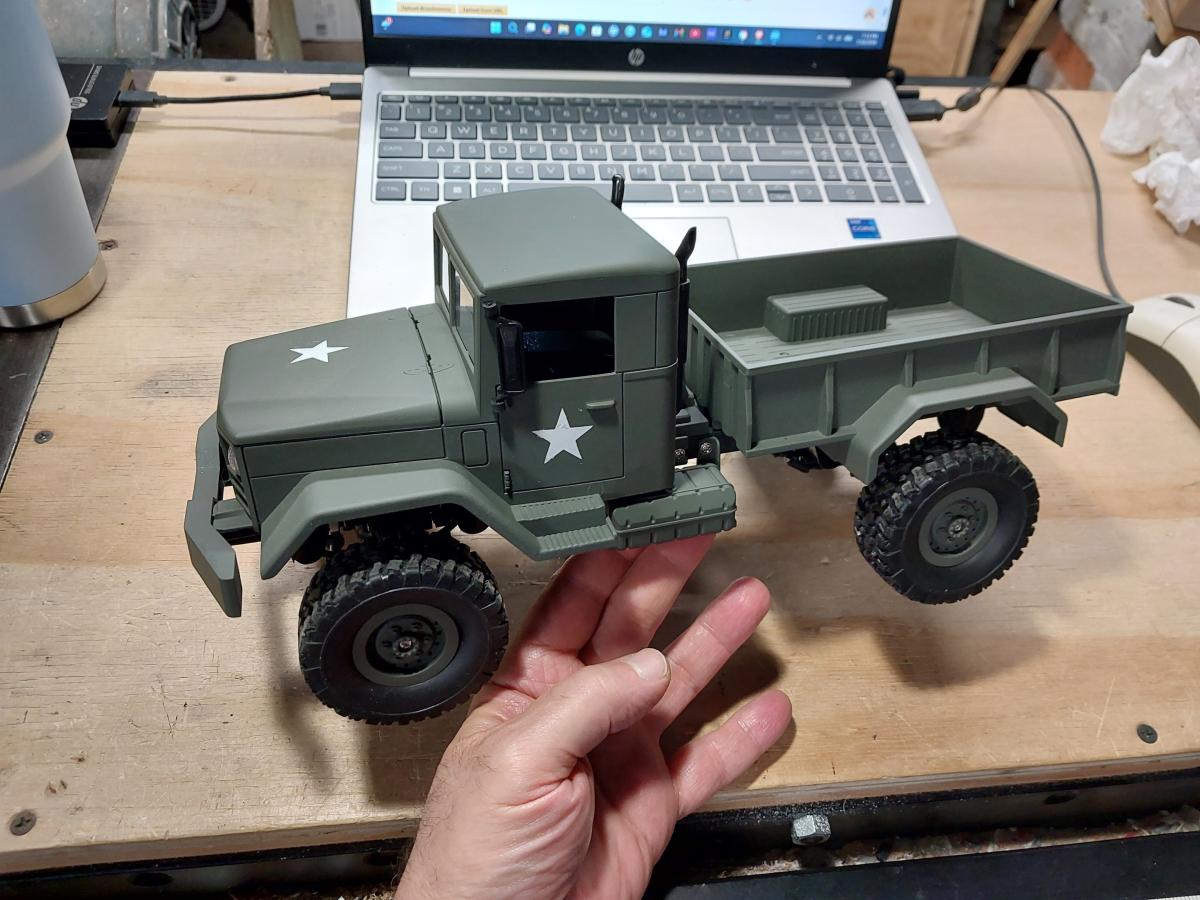

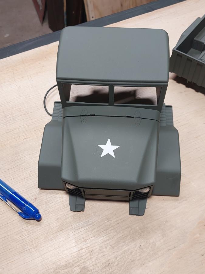

    The WPL 6x6 RC truck has been around for quite a while and I thought I would share my project idea to change one into a M 54 gun truck from the Viet Nam war. The truck it self has a reasonable scaled cab, but everything behind that is marginal at best. The first pic to show where I am so far. I hope to add details of what I have done and where I sourced the parts so others can follow if desired.

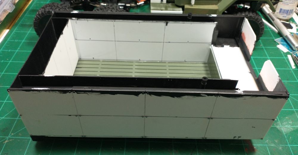

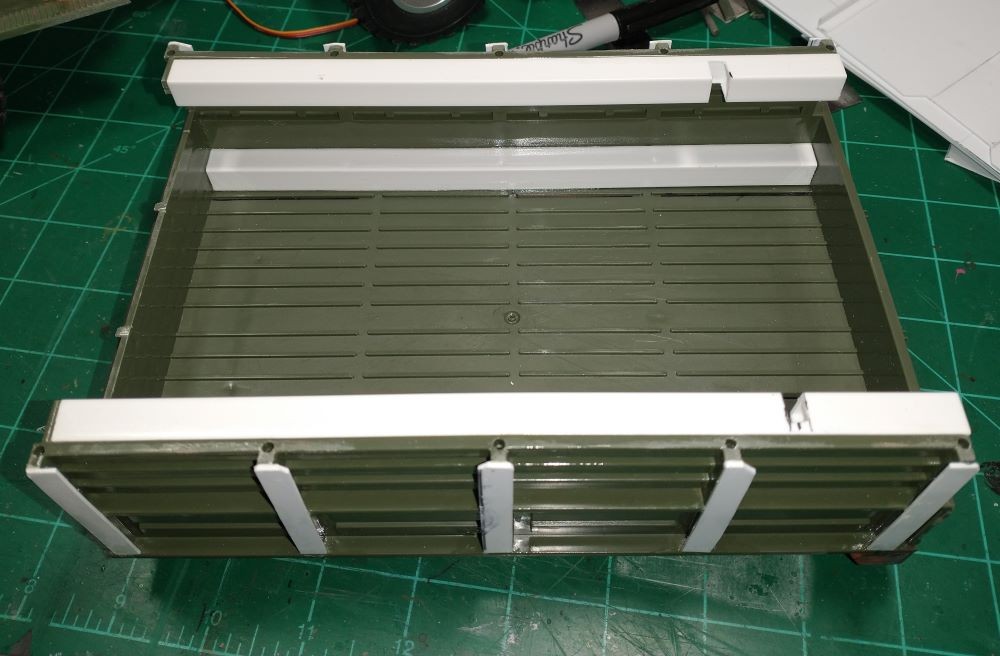

      For the cargo body I removed the spare tire assembly so I could extend the body and built over the existing part to make it an easier project. The side and interior panels are plastic sheeting, shimmed and cut to fit. The notches are where the Mg mounts will be. I will use full size pedestal mounts I had from a prior project . They are from Battleground models. I left them full size to give the mount a little more strength.
      Click image for larger version  Name:	A1.jpg Views:	0 Size:	115.4 KB ID:	430771

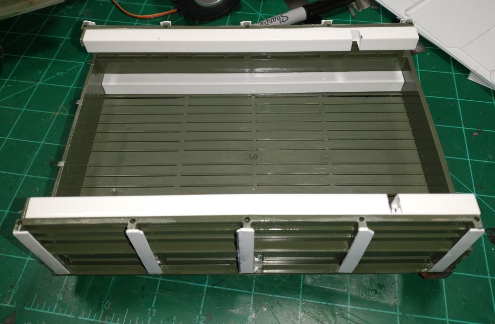

      • #4
        The body panels are evergreen plastic with panel lines scribed and mounting holes drilled along the edges. I added bolt detail where needed to simulate mounting points. The stepped up spot on the right where the old spare tire assembly sat was added as a battery box to allow bigger batteries to be used.

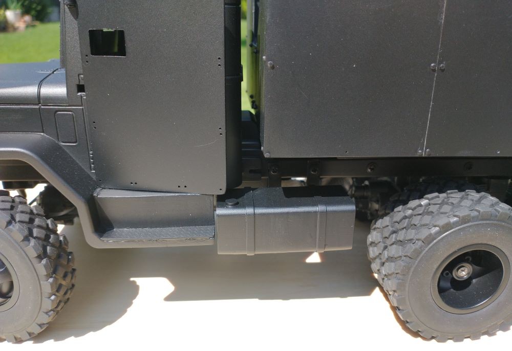

          I replaced the original fuel tank and moved it to the right location with one I found at Battleground models. They have one made for SAS long range tanks on a jeep that look much better. Also a little bolt detail and side armor mounting shown.

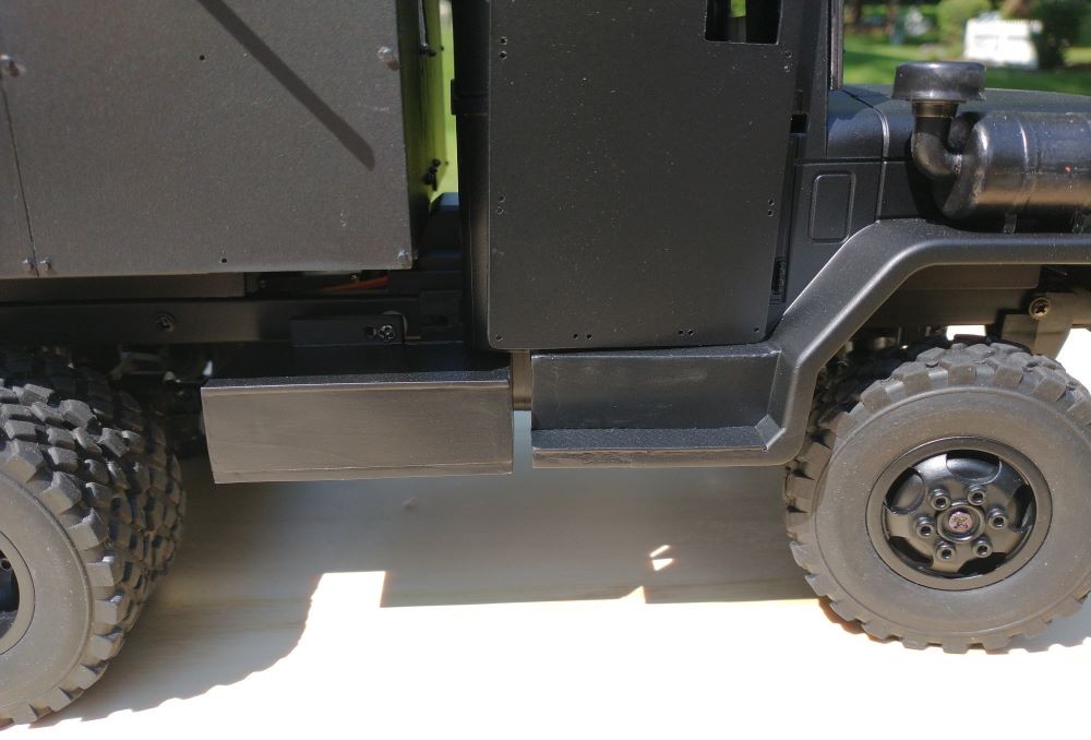

          For the passenger side I used a modified part from the spare parts box for the tool box. This shows the extended side step with some diamond plate added for detail to fit the full cab width.

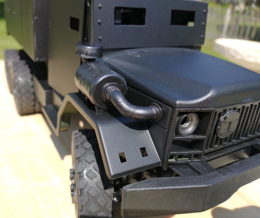

          The air cleaner is from ebay. It's a metal kit that has side mirrors and an exhaust stack. I changed the fittings and added different intake tubing from Plastruct.
ID:	431046 Click image for larger version

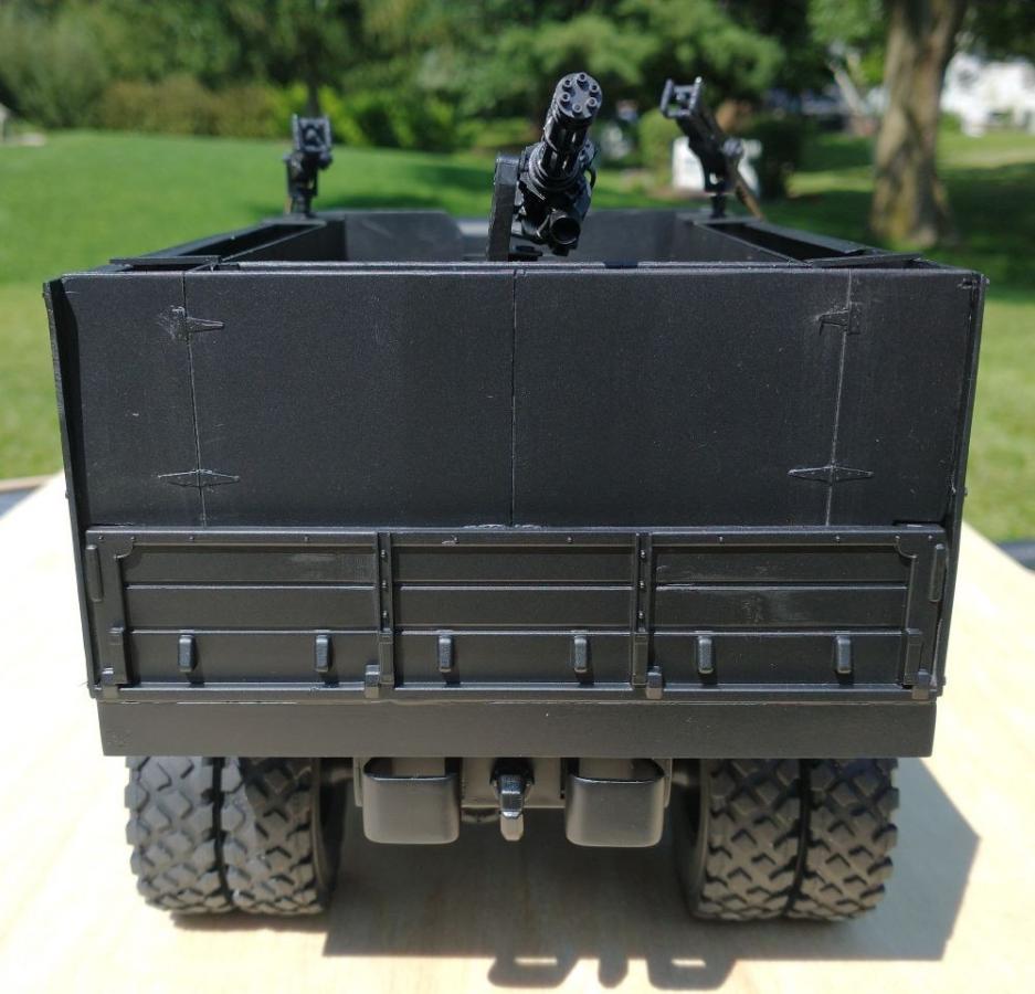

          The rear bumpers and tow hitch are from the WPL B36 truck. It's a direct fit.

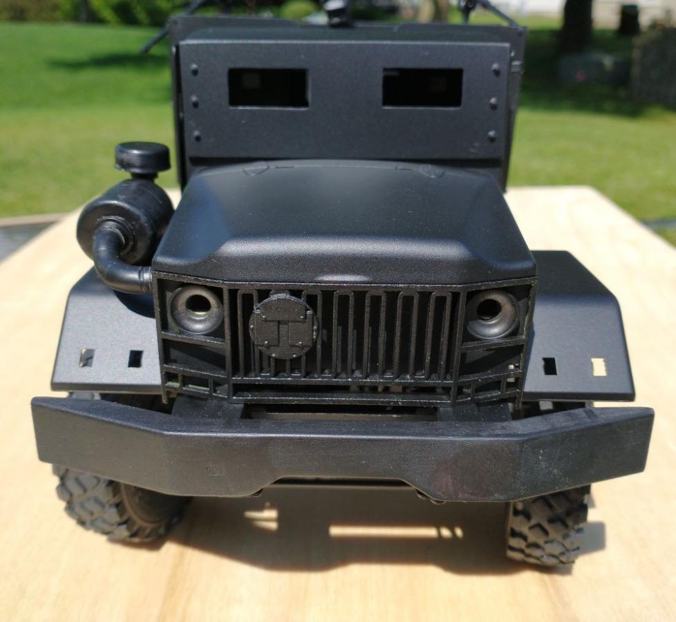

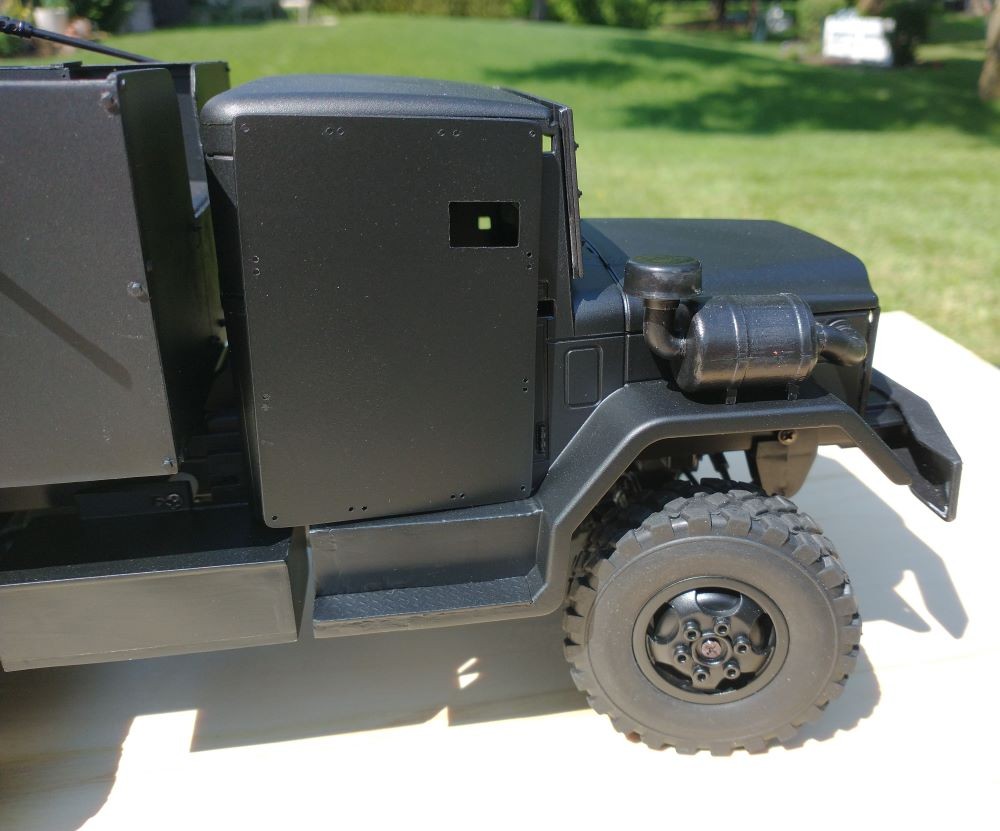

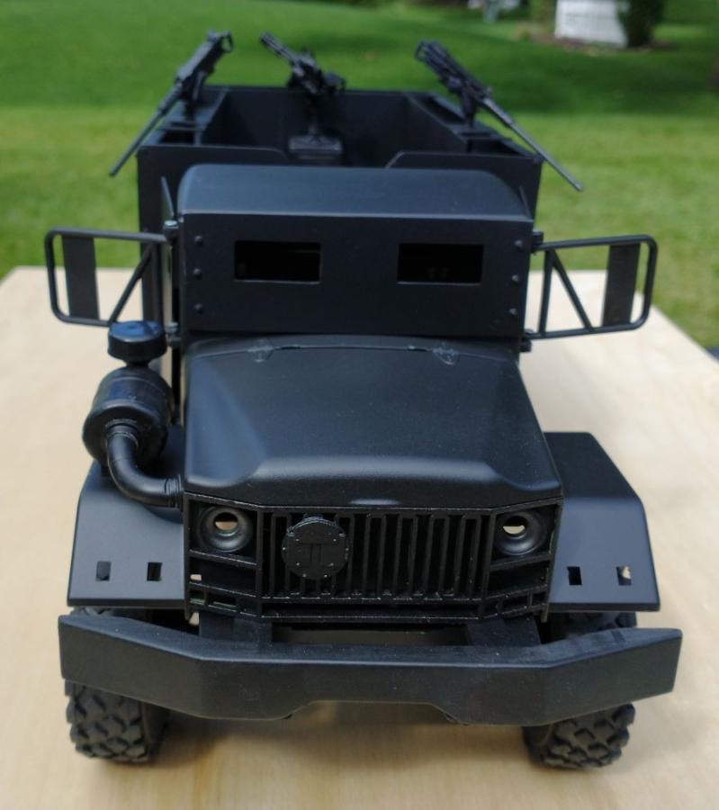

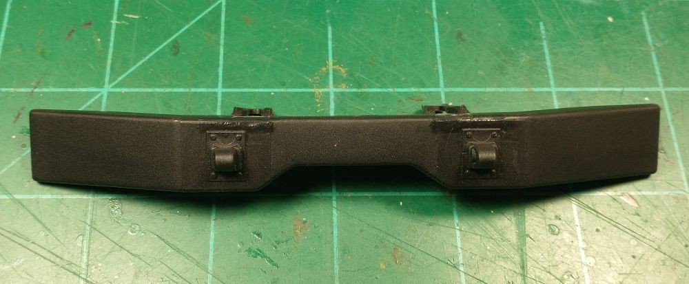

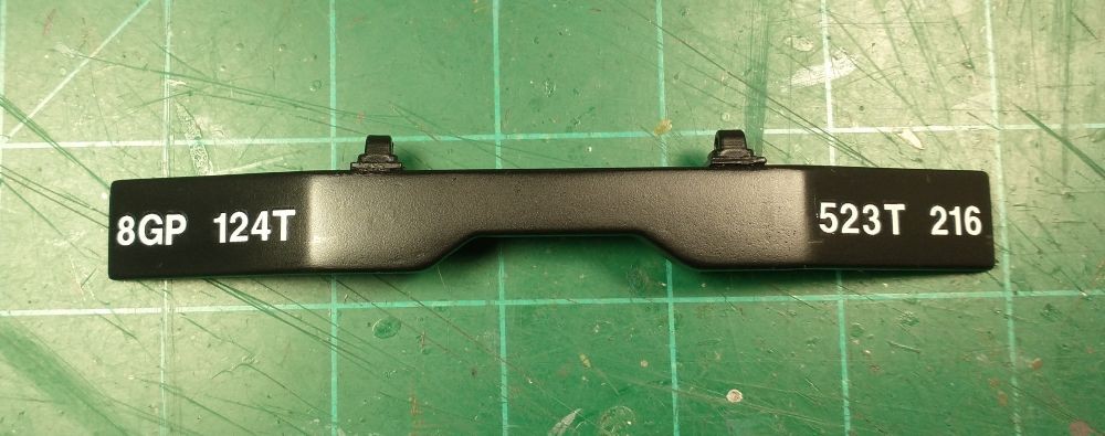

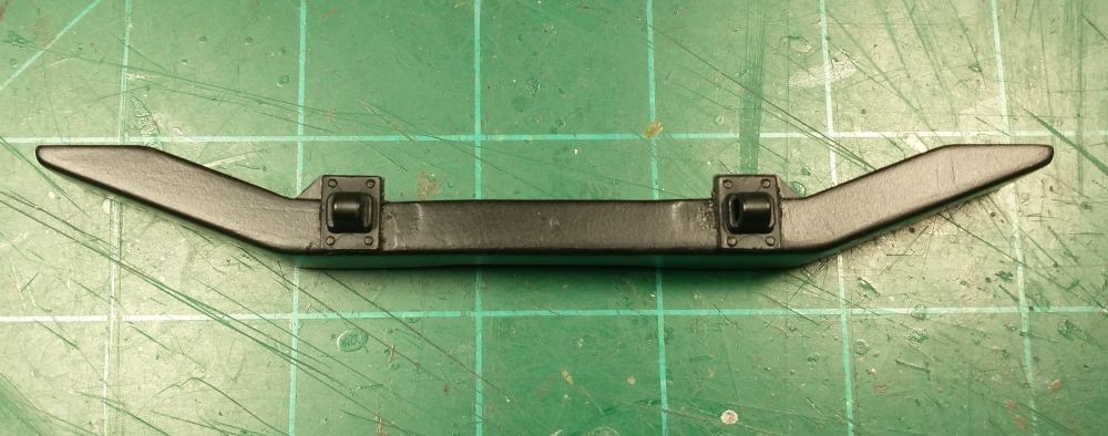

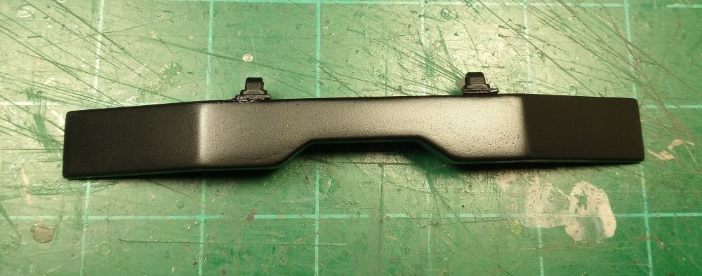

            Front windshield armor with bolt detail, and a replacement grille I was able to find on Shape ways before they went out of business. I flipped the front bumper and will be moving the tow hooks to a more correct location. The loss of Shape ways was a big hit. They had a lot of detail parts that would have been very usefull with this project.
            Click image for larger version  Name:	A6.jpg Views:	0 Size:	82.9 KB ID:	431223

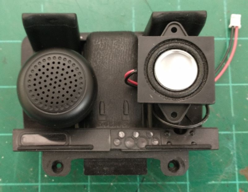

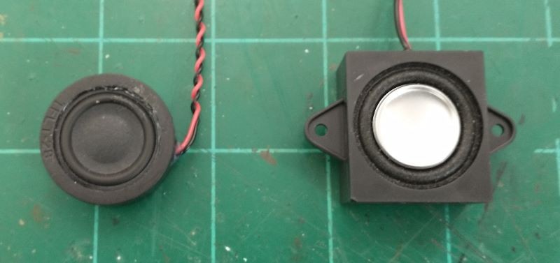

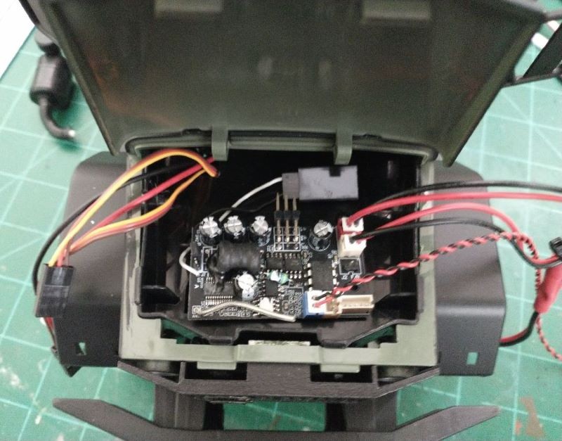

              Now for some electronics. I have the upgraded control board with the diesel sound and I moved it to the battery box to allow easier access and less exposure to moisture and dirt. I replaced the stock speaker with one I found on Amazon and testing shows much better operation. I have also been testing a bluetooth speaker for added sound effects. The battery was moved to the box I built on the front of the bed. So far the sound is better than stock.
              Stock and replacement.
              Speakers will be mounted in the cab. Still working on a good mounting solution.

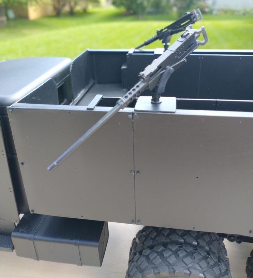

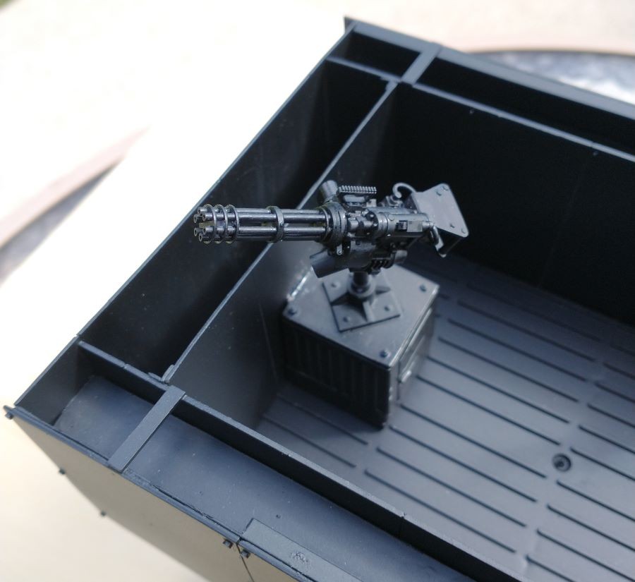

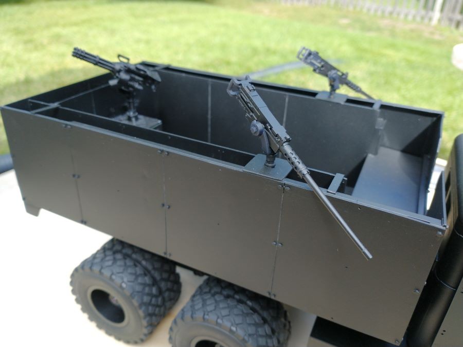

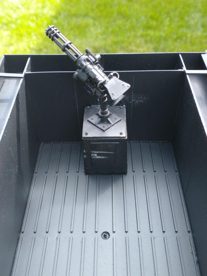

                  In the back I mounted a M134 mini gun found on e bay. Temp mounted for now on the box from the old spare tire bracket assembly. I've got a lot of accessories collected to fill up the rest of the bed.
                  The M2 50 cal mounts. And a view of the side bolt detail.

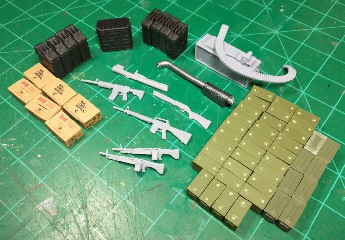

                    Worked on some accessories.

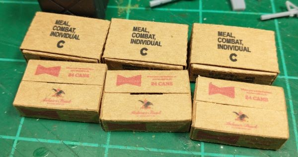

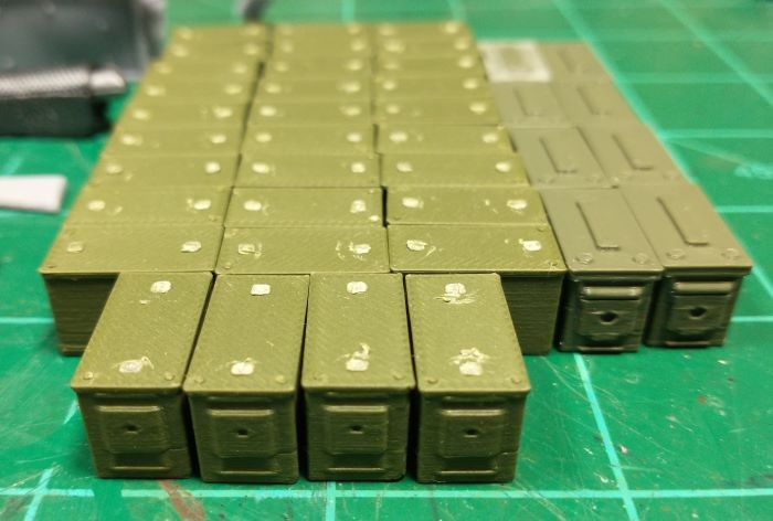

                    Ammo cans from ebay. Just enough detail and cost effective to fill the bed. Need a little sanding and some new made lowered handles.

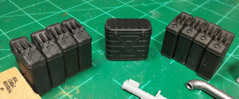

                    Fuel cans, Water cans, and a mermite can.
                    C Rations and........................

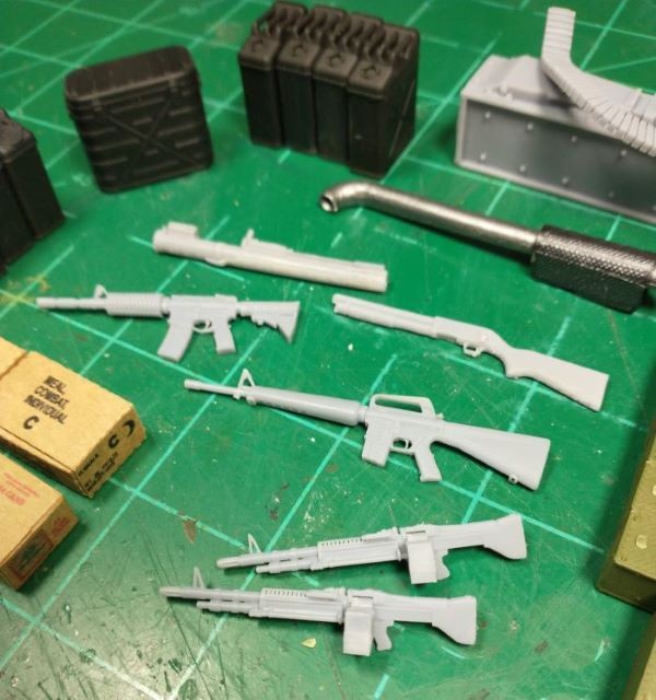

                    Small arms.

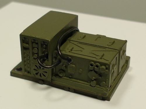

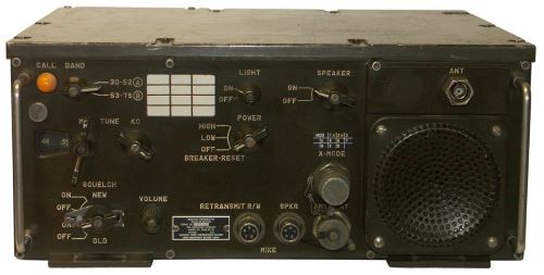

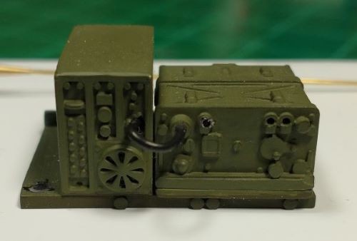

                    • #11

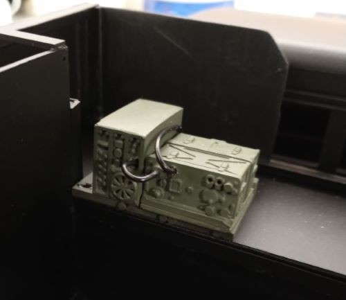

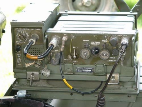

                      Adding a radio is the next step. From what I found online, most Gun Trucks used a version of the AN / VRC 12 series radios. Not a lot of choices in this scale but I found Battleground models has a few types of WW 2 era radios that can be made to stand in using the 2 foot rule of modeling with a little work. I decided to use a version of the PRC 77 vehicle mount radio as it is a little more visually interesting than a single small square piece of plastic. And I am familiar with this as it was in the track I drove many years ago. I used a set for a WW 2 tank radio and a man pack radio to make the pieces needed.
                      AN /VRC 12 series radio
                      PRC 77 Vehicle mount.
Name:	PRC 77 Vehicle mount.jpg
                      My Version
