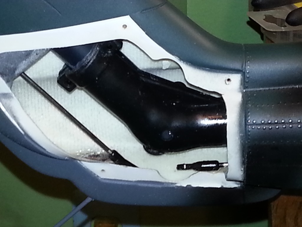

So, this weekend I brought the Huey out to Helis Over Apache Pass along with my 500 Apache and Little Bird. I mostly tend to bring my choppers to warbird events, so this was my first ever heli-only event. Got everything finished on the Huey at the last minute the day before, including the tailboom paint and rocket pods. Flew a few flights on each bird with no issues, until flight #2 on the Huey.. In the middle of a flyby at about 20 ft, I saw the tail rotor come completely to a stop! The bird started a slow spin, and I brought it down to about 2 ft before I hit throttle cut for a hovering auto. It hit hard, but the damage is fixable. One of the H-stabs dug in and fractured the fiberglass on the tail. The skids broke apart as well, but it appears that only the plastic Ts failed. Windows popped out, and the cockpit interior broke up in a few spots as well. Blades are also totaled, and a servo horn broke. Luckily, the head and mainshaft are undamaged.
After removing the mechanics, it was pretty easy to locate the failure point. A bearing failed in the angle gearbox, and overheated. This melted straight through the gear, and sheared it off completely. Just a reminder to double check your bearings and lubrication! Will likely be changing them out for aftermarket bearings next time around:

That would be cool to see your work on the blades. Still can't understand just what happened to your tail case gear. You would think a bearing would feel choppy if you turned the shaft if it was bad. Bad luck. I know my AH-1 tail case that came inAlign's kit was very bad. The stock gear came apart after only 35 seconds in a hover. Took me around 11 months to make tail parts to replace the junk Align used in their kits.
Completely agree on the align gearbox. Every one I’ve ever seen has stripped out either on the ground or in the first hover. For my failure, I think the blame lies with me for not conducting a thorough inspection. I was eager to get it done and in the air, and rushed through it a bit to quickly. Should have been fairly easy to catch before the problem developed.
