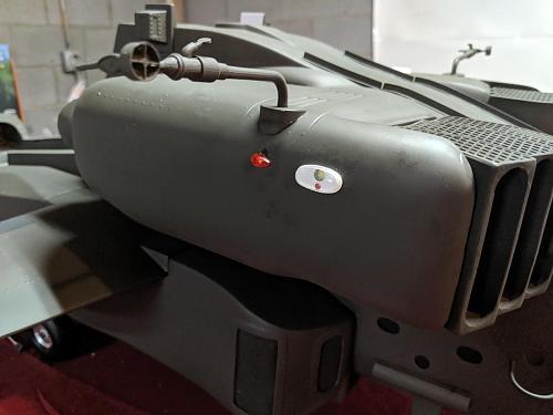

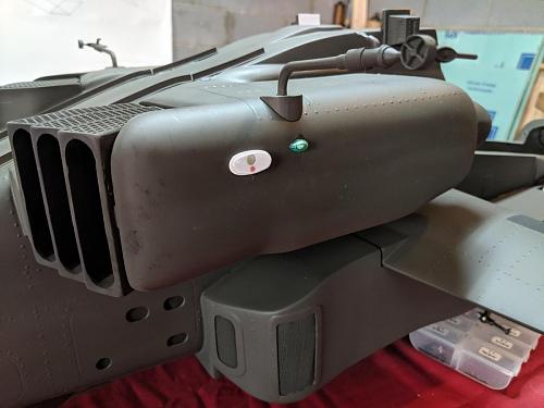

        The camera setup was all custom from stuff laying around the shop. Here are my side light covers that I took and ground down till I just had the shape you see left over from the one pare on the right in the photo.

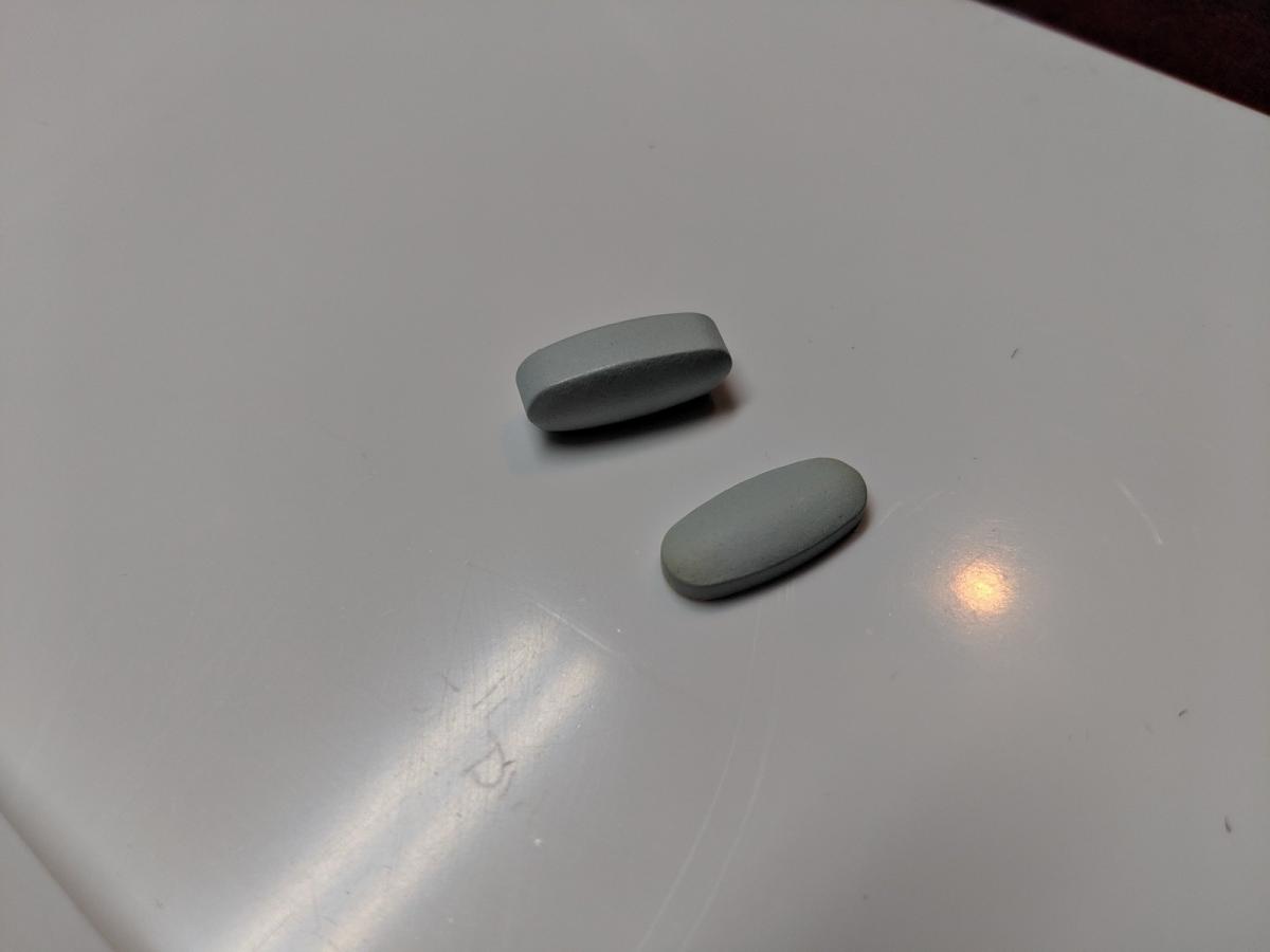

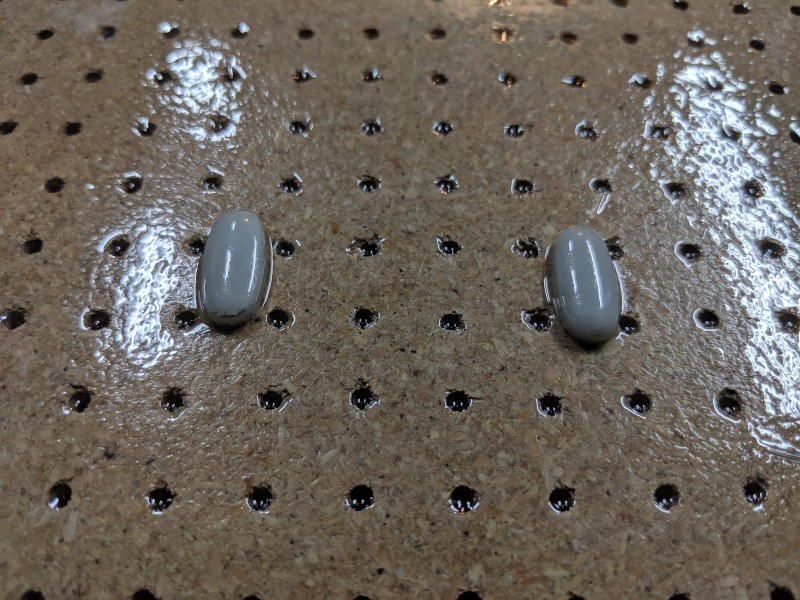

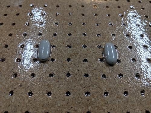

          Way to see the potential in something. I took two large vitamin pills and sanded them down to make the pucks to vacuum form over. Worked really good.

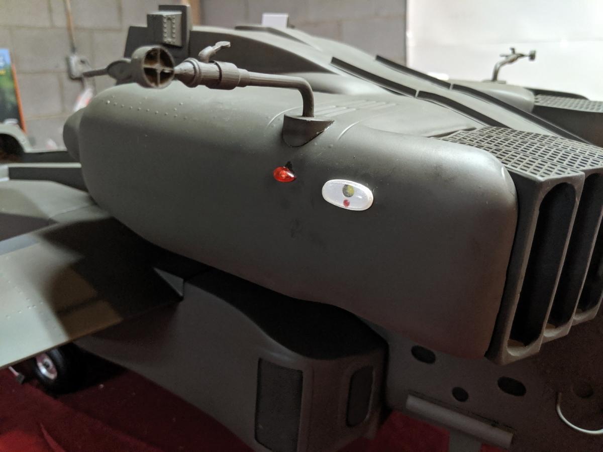

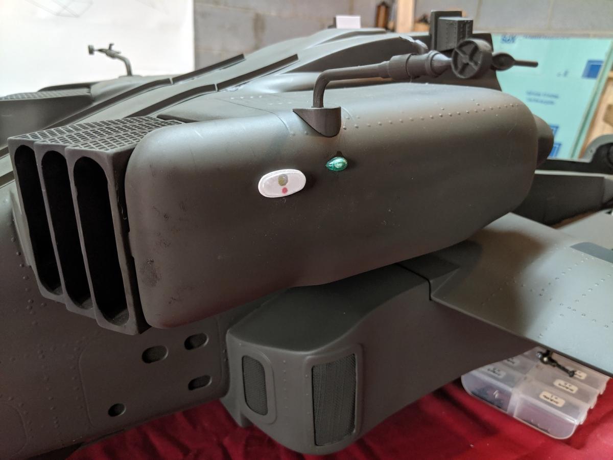

            And here is the result.
            Click image for larger version  Name:	IMG_20190818_162153.jpg Views:	8 Size:	81.2 KB ID:	210832
            Click image for larger version  Name:	IMG_20190817_215209.jpg Views:	6 Size:	78.5 KB ID:	210833
