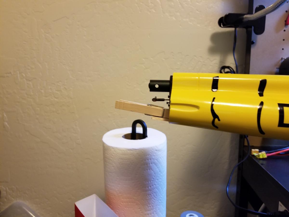

      First cut done. Plan is to cut again on the aft side of the yellow tape, then attach the rear piece at that point. It would be easier to just cut further back and attach the end piece but I want to keep the option of being able to remove it to service the tail rotor if needed.

        Second cut done. Now is sanding and fitting. Will build braces out of the cut section that I'm not using once I'm sure the measurements are good. Will have to fill in the gaps and paint but I think it will turn out ok. It will look a little strange but ultimately this is just an experiment.
        If it turns out to be tail heavy ( pretty sure it will) I might think about getting a cocpit for it. Not sure how much that would cost but if it flies nice and doesn't look too goofy I will probably go that route.

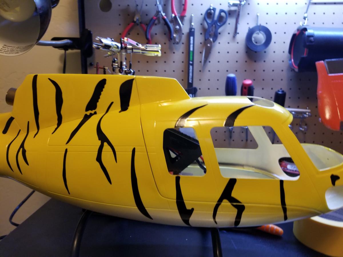

          Preliminary mount. I dont want to glue things down until I get the skids so I know how it sits. I can go up further if needed but I want to keep the vertical cg as low as possible. I doubt I will have blade clearance as it sits though. Will take some experimenting so I will just foam tac the 3/4 shim and use a couple plastic shims to screw the frame to the balsa blocks.

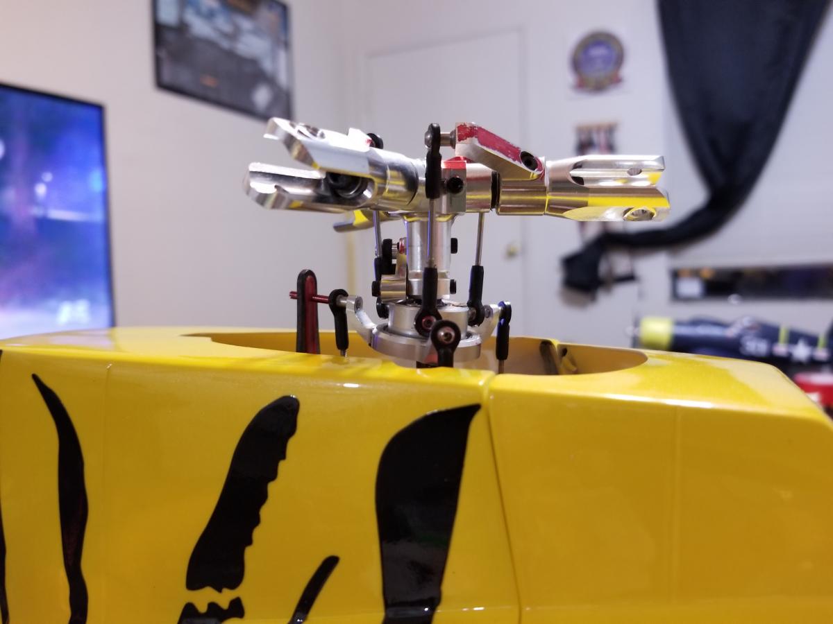

              Thanks! It was tough to cut into such a nice looking fuselage but necessary for my needs as I'm sure you know. I did another test-fit and can get another 1 to 1 1/2 clearance up top which is a good thing. I will start building a deck soon and looking into skid options. I have another project and work taking up most of my time so I probably won't get much done on this project for another week or so.

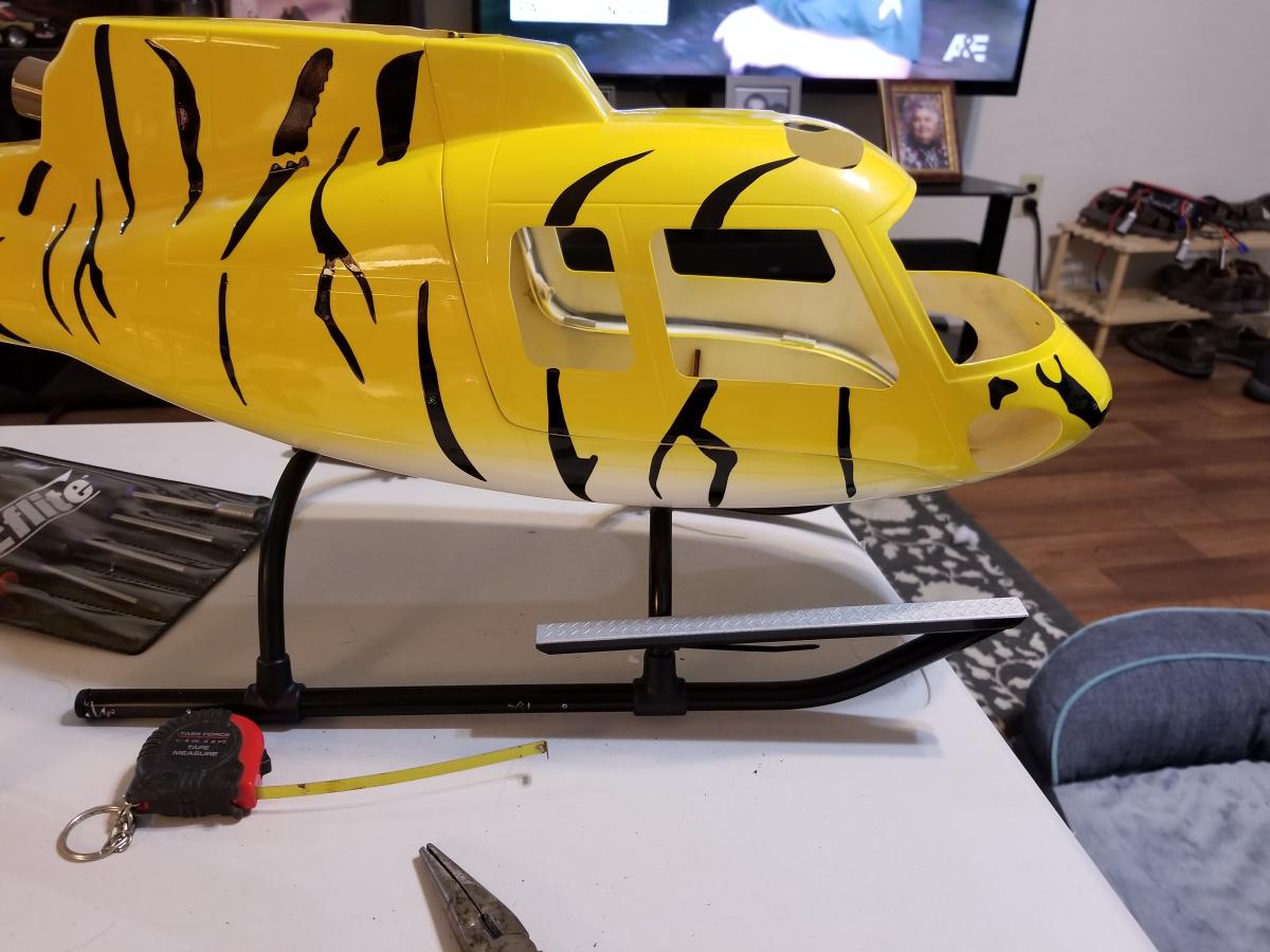

                            That is slick!!! Great scheme. I got the gear temporarily installed. Will need to shorted the struts a bit but since the set is for a 600 I was expecting that. I should get more time on it tomorrow to start mounting the mechanics. I'm still concerned that it will look pretty goofy with a shortened tail but oh well. If it flies, I'm happy. I will just say it was an early experiment by Eurocopter for those with small hangers.
                            I am wondering what gain adjustments I will need to compensate for the extra weight? Are there any other things I should be looking for before spooling up for the first time considering the added weight? I am already thinking about blade clearance but think I will be ok as long as I stay away from negative pitch.

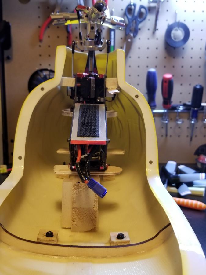

                              A little more progress. Found a set of gear for a 600 that fit ok after some trimming and shimming. I'm satisfied with the test fit enough that I will start working on the mount and upper supports. I'm trying to find some hard rubber pieces to place between the bottom of the mechanics and the airframe to help isolate vibrations. Then it's time to tackle the tail. That will be the biggest challenge as I had to trim about 2 1/2 inches to fit the fuselage to the 360 tail support. I thought about just using filler to smooth the transition but now I'm looking at shaping balsa for more strength but I could be bass awkward in my thought process. Like I said before, it's an experiment and a learning experience for sure.
