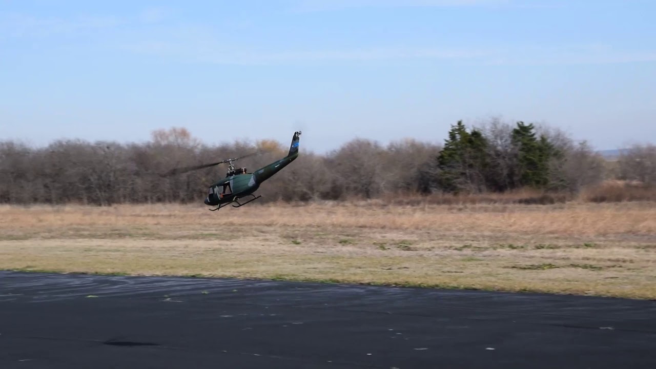

    Finally got the UH-1N in the air this evening with the doors, cowlings, and full cockpit installed. I love how it looks and flys! Will be adding the crew in the back next, as well as attaching the crew doors, and adding the stab bar on the rotor head.
    Wow, looks awesome and glad you got it going, what was the main issue with it anyway or did you find out it was a mounting issue causing the vibes??
    Glad you got that 800 size Medic 222 heli over on RCG, that was a great deal.

    No problem! Always enjoy seeing more scale helis! You have quite the impressive fleet. I just put the 2nd flight on the Huey after the rebuild. After I got used to how it feels, it flew quite nicely. Next flight will have the cowling and doors back on!
