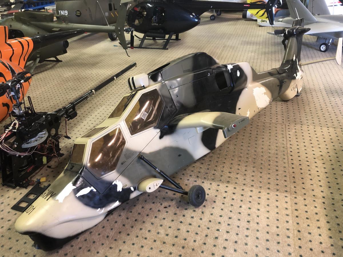

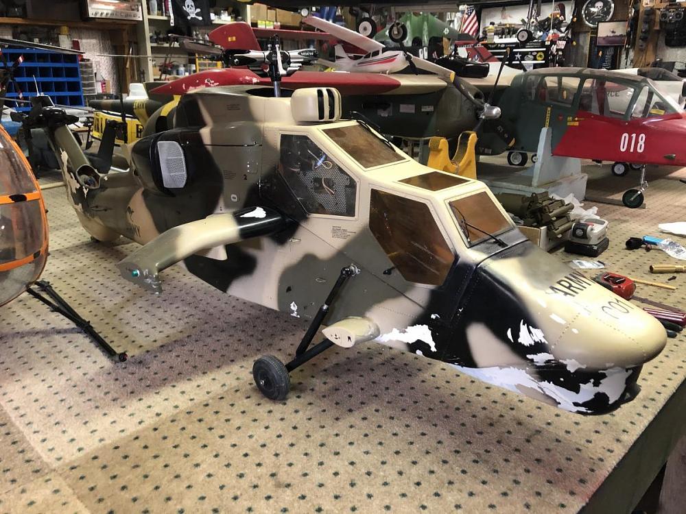

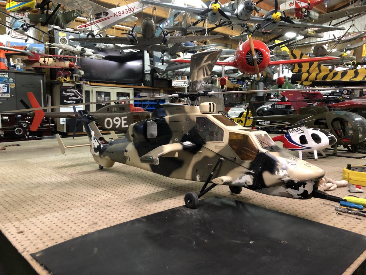

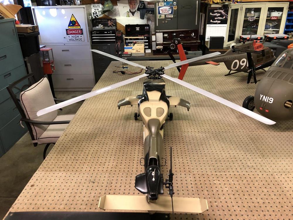

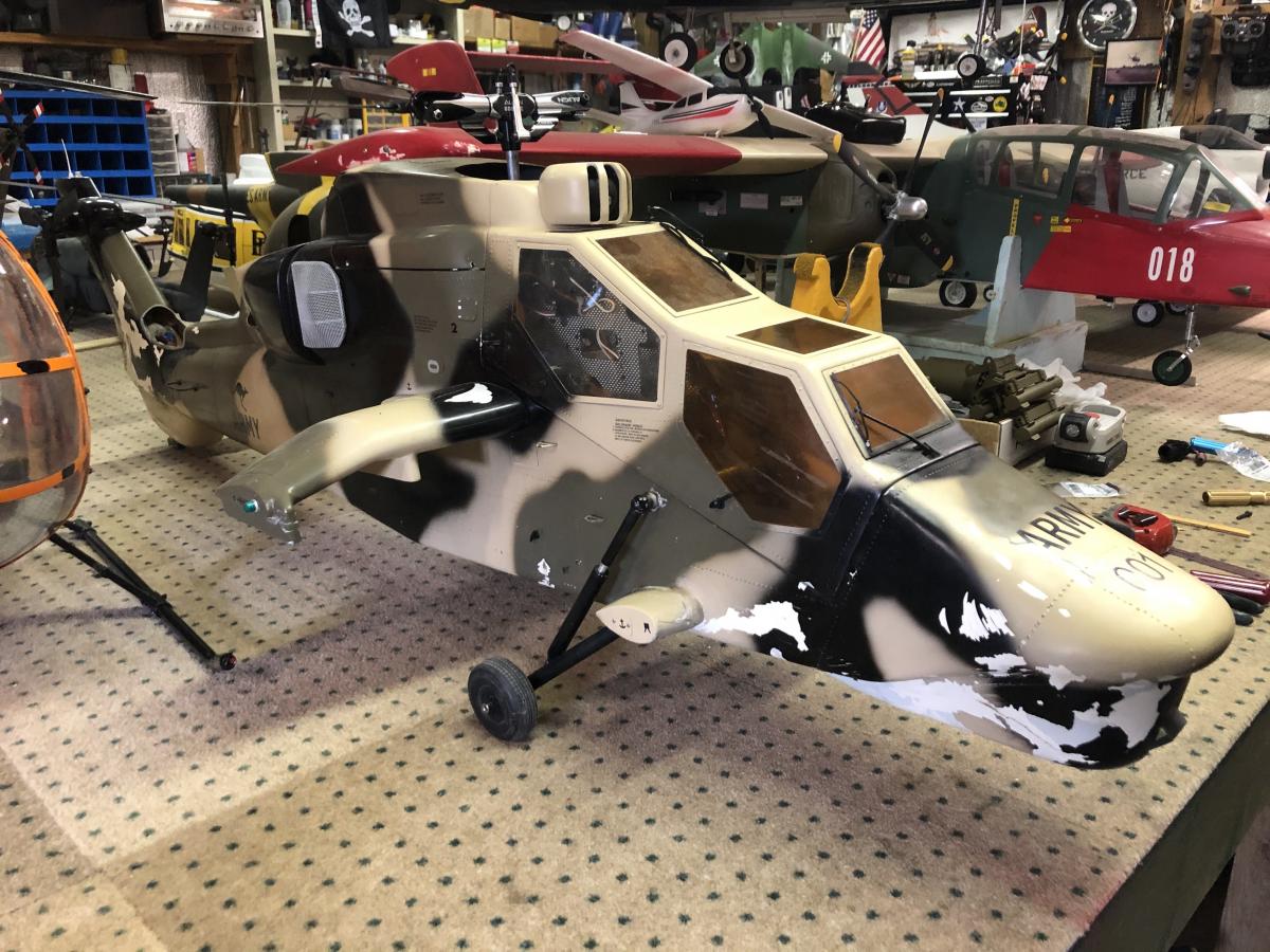

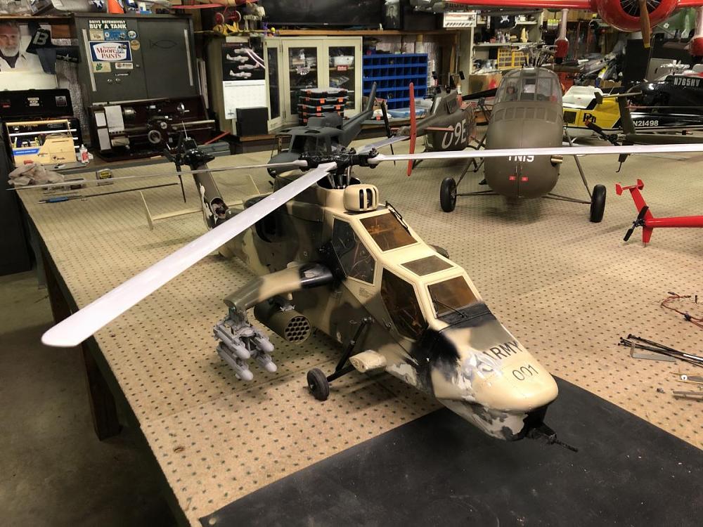

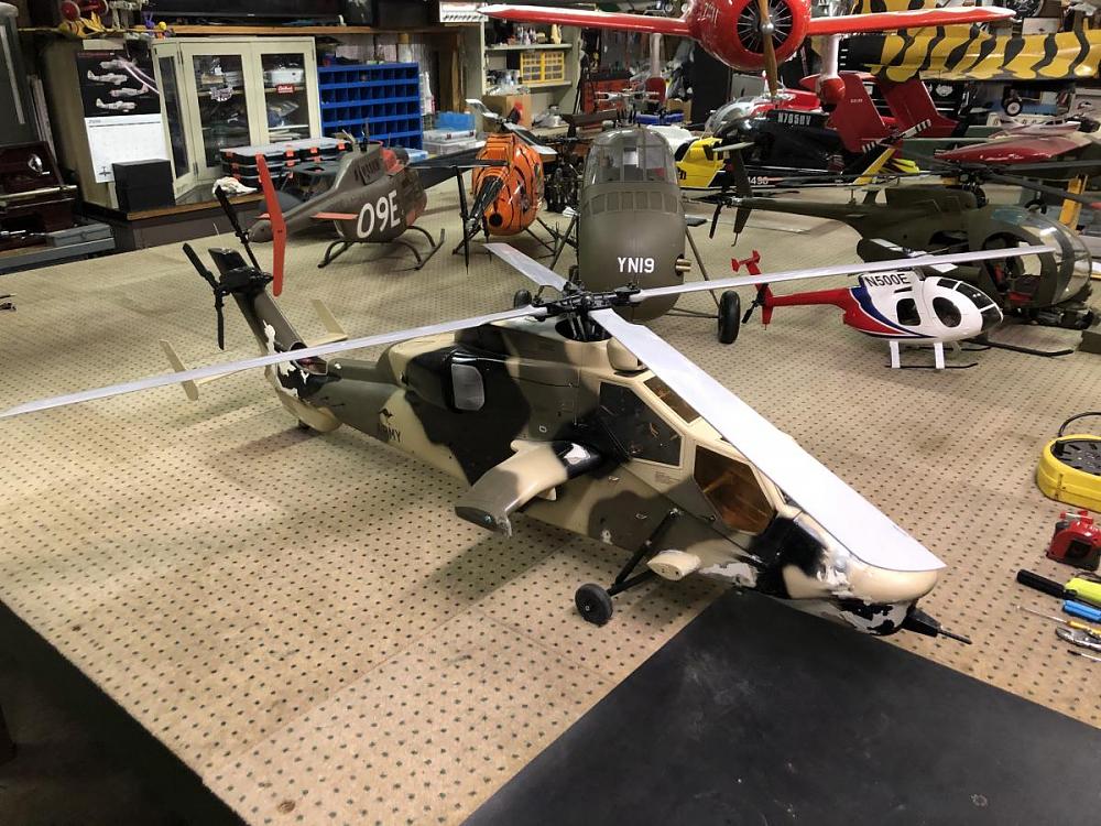

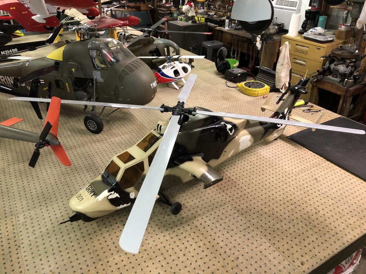

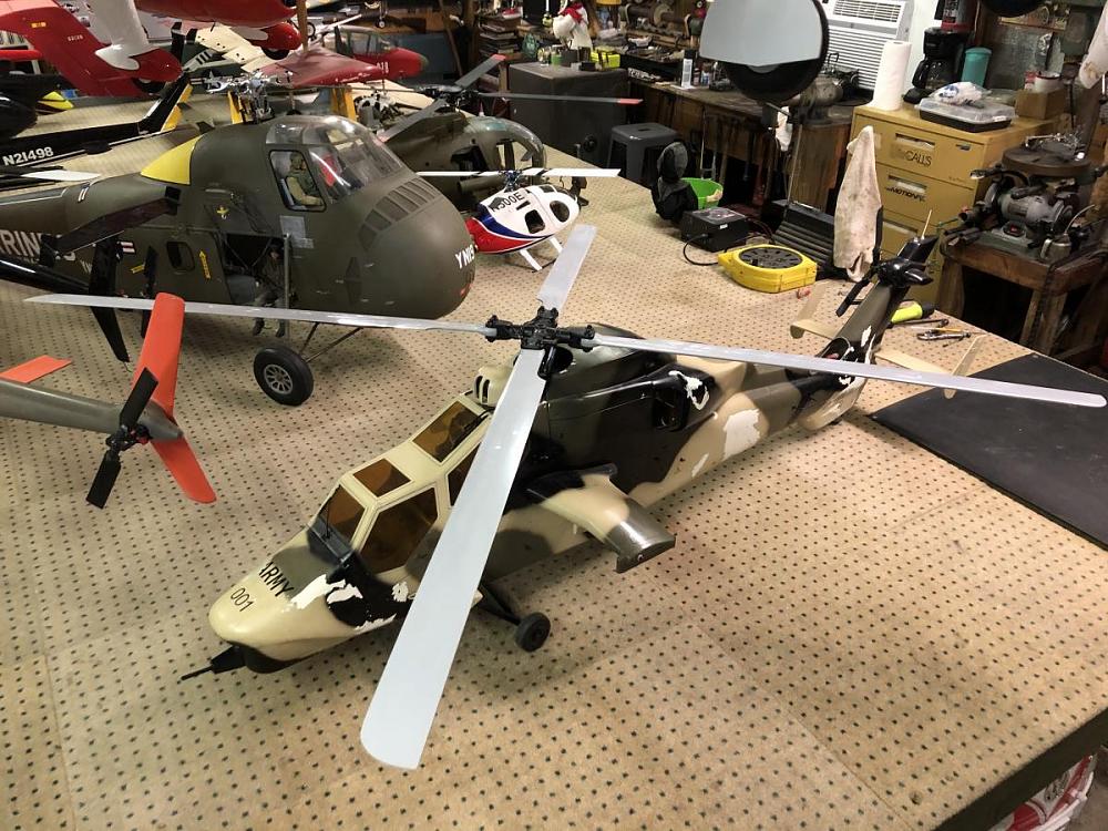

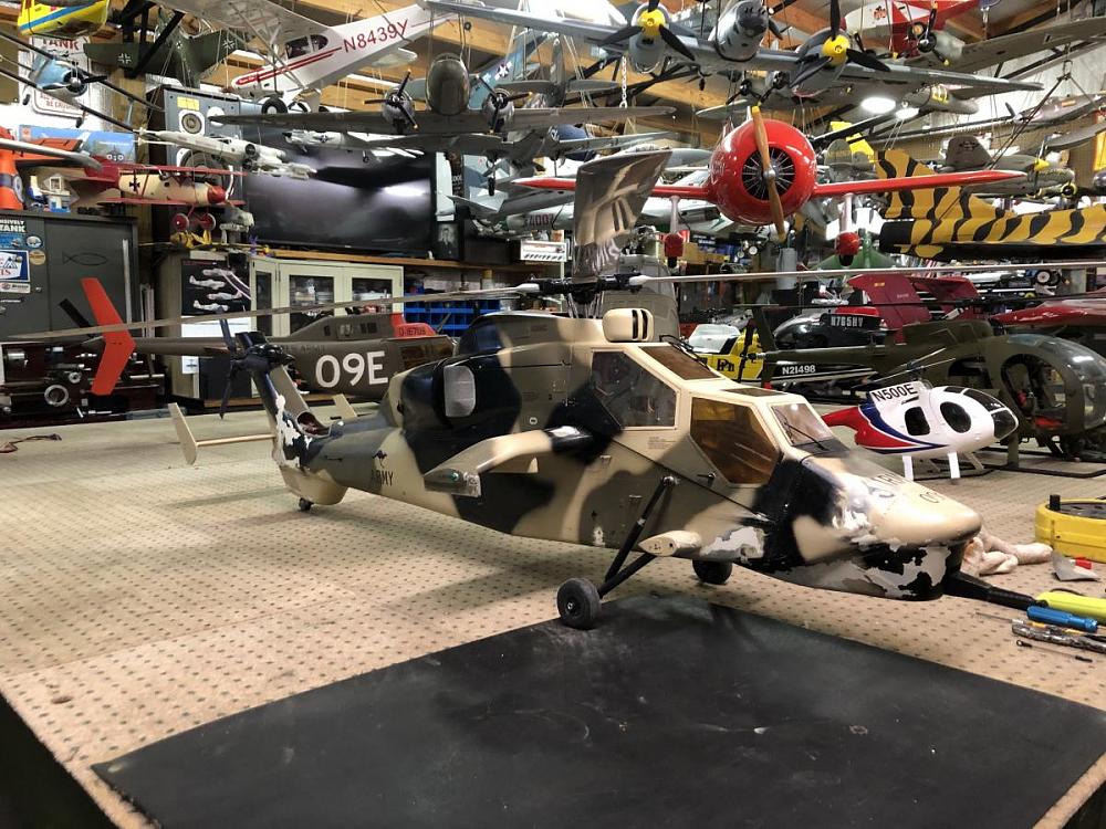

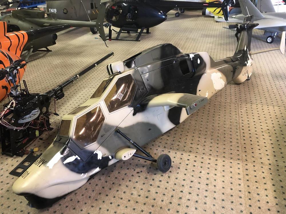

    I picked up this crashed Vario Tiger at the Dalton Scale Helicopter event and decided to convert it to electric. I had a T-Rex 600N that was nitro powered so I first had to convert it, this will truly be a "TiredIron" helicopter

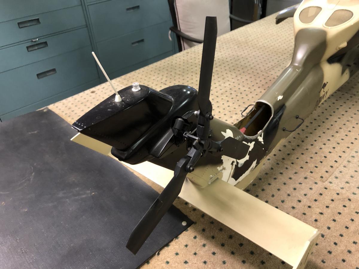

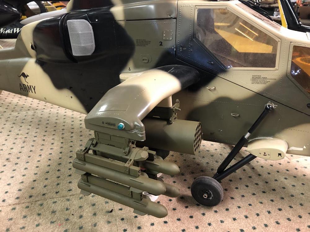

    The landing gear on the right side as well as the tail wheel were a mess.

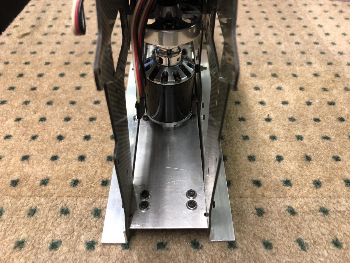

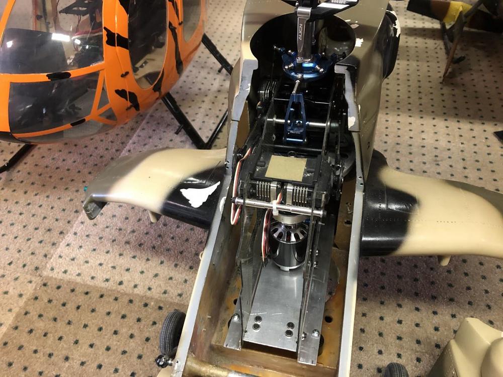

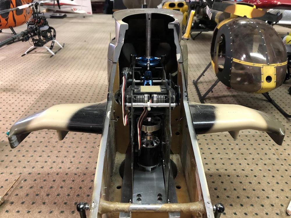

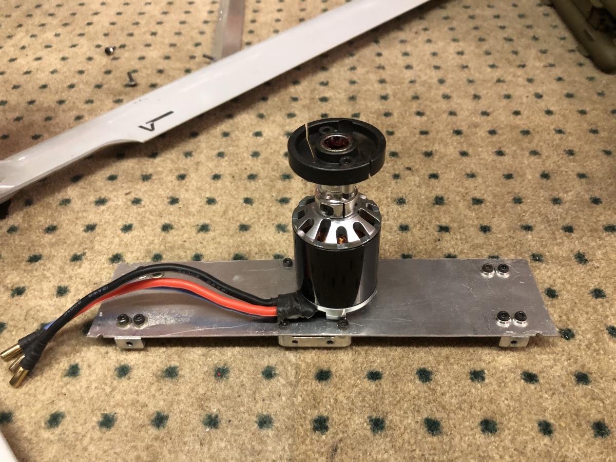

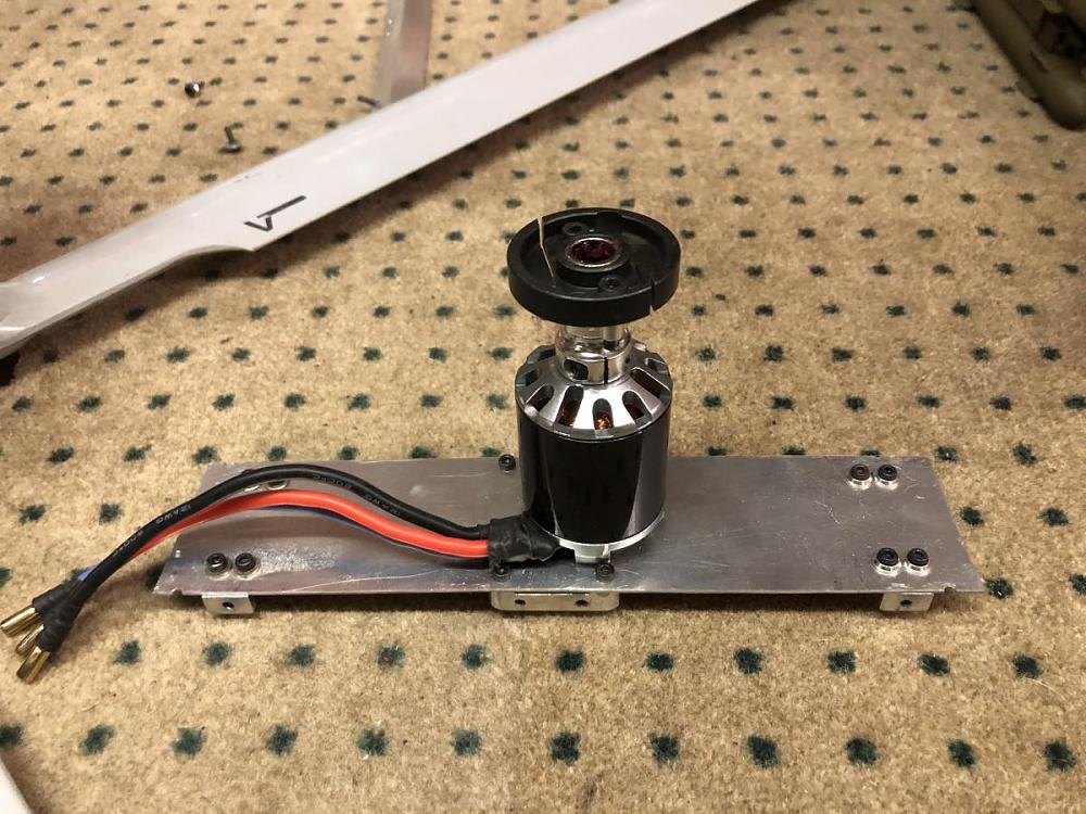

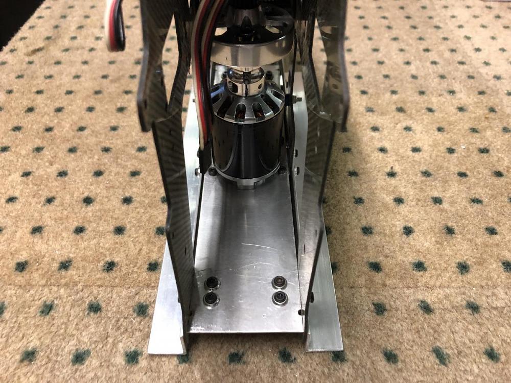

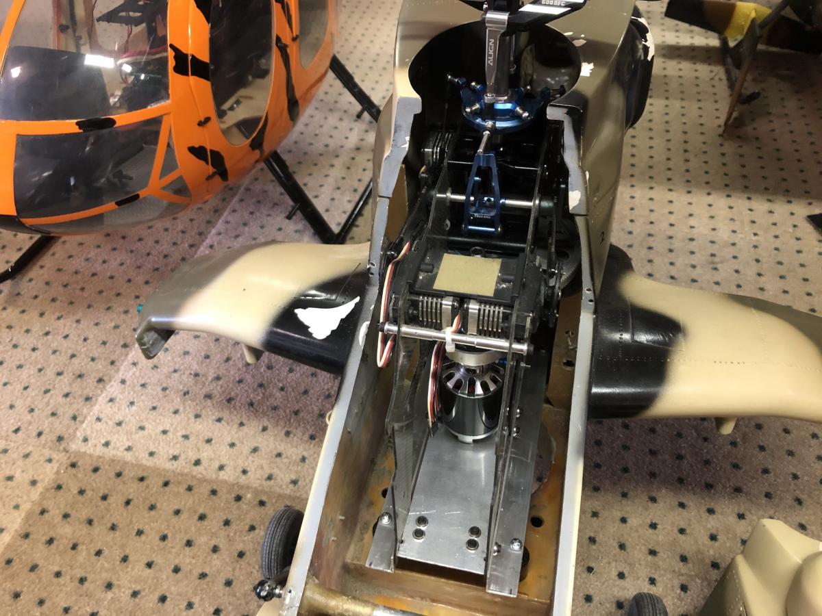

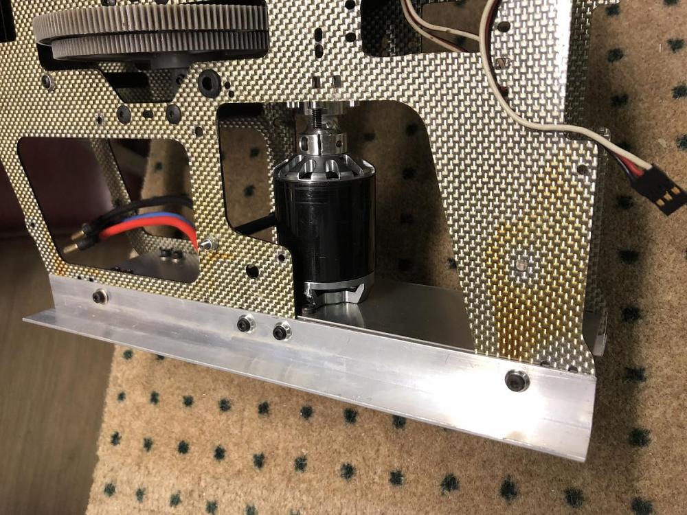

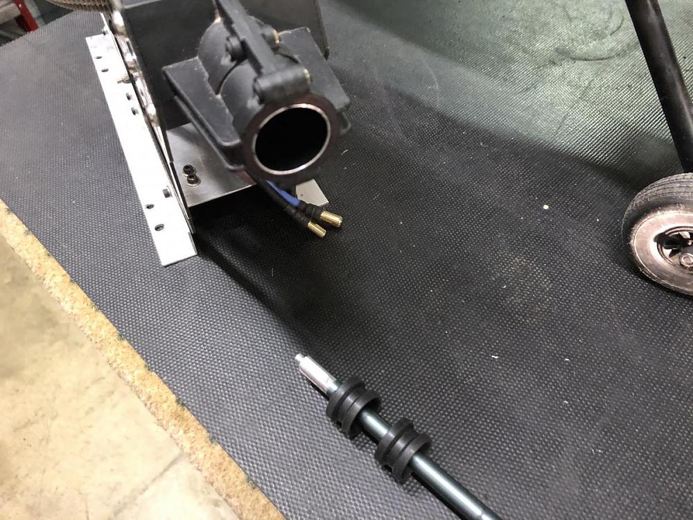

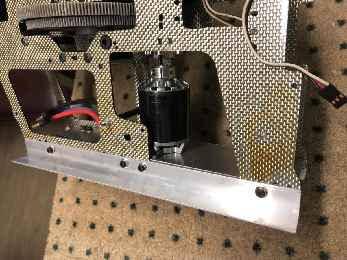

    I used a 1200KV motor from a HSD 6S 105mm F-16

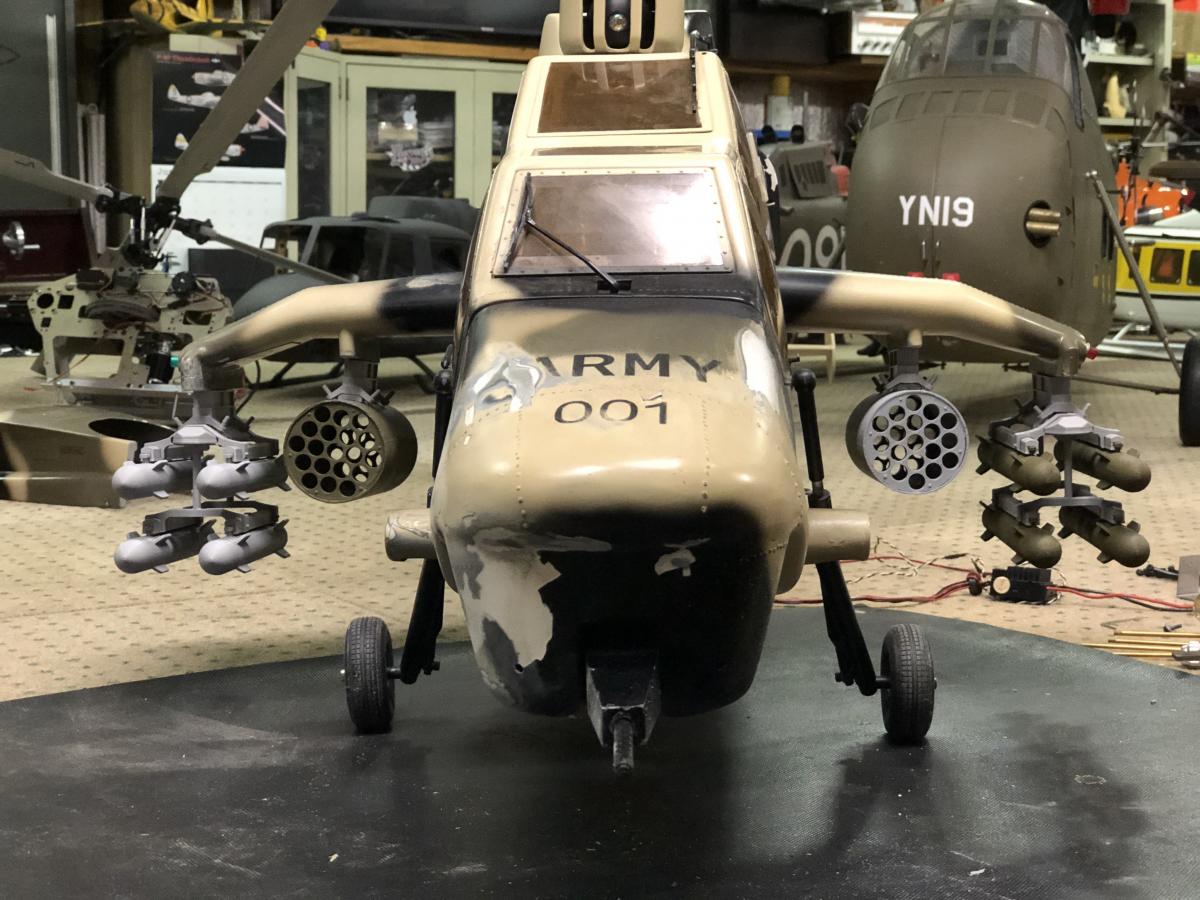

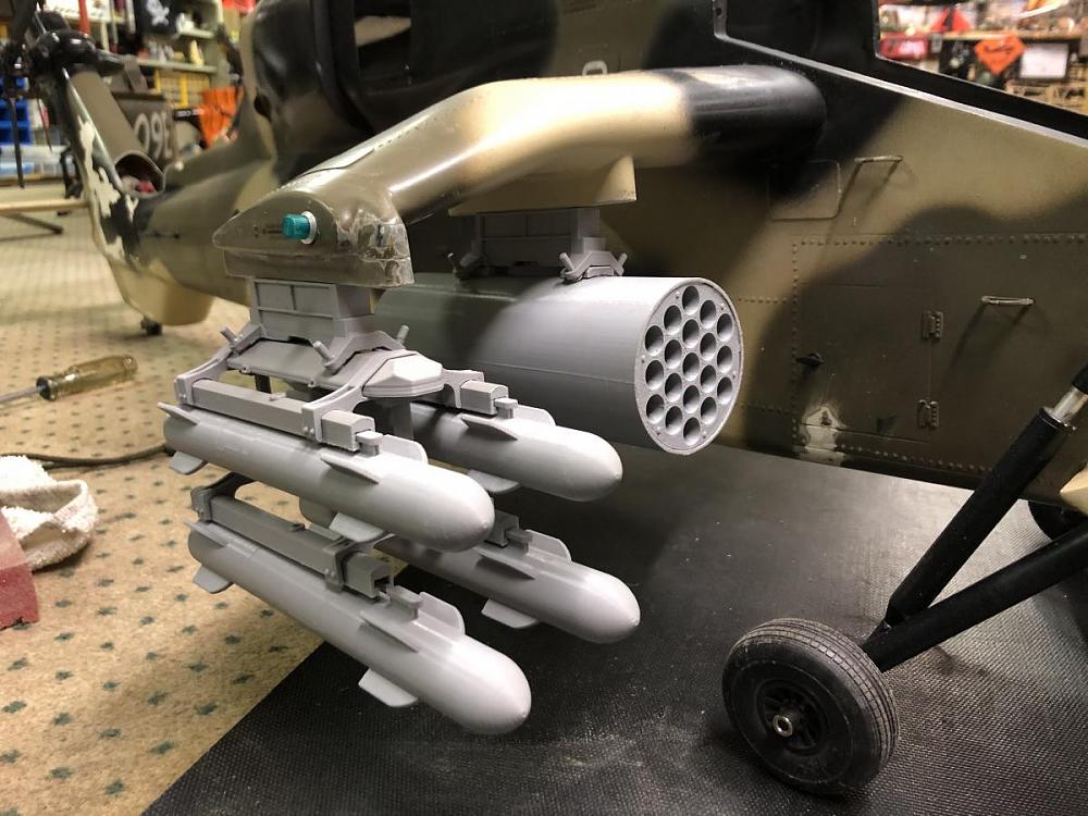

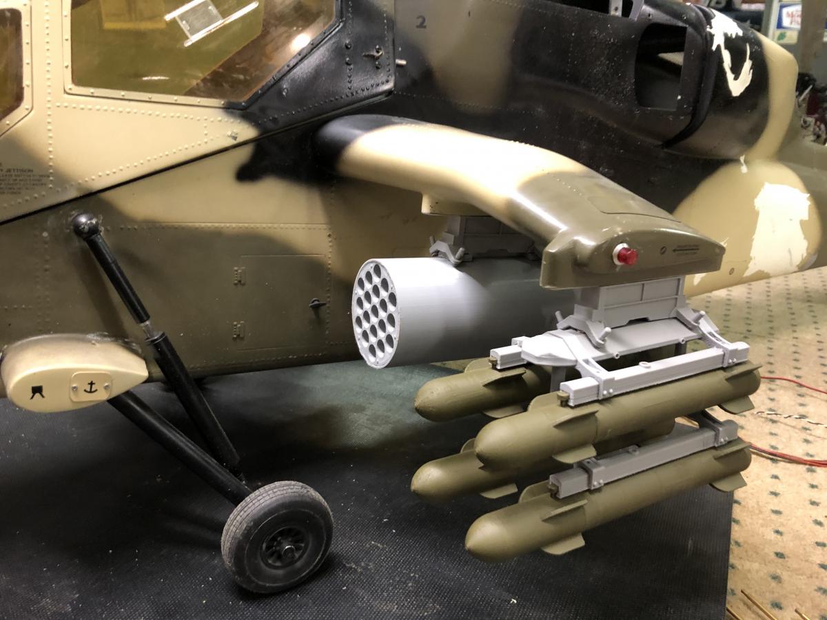

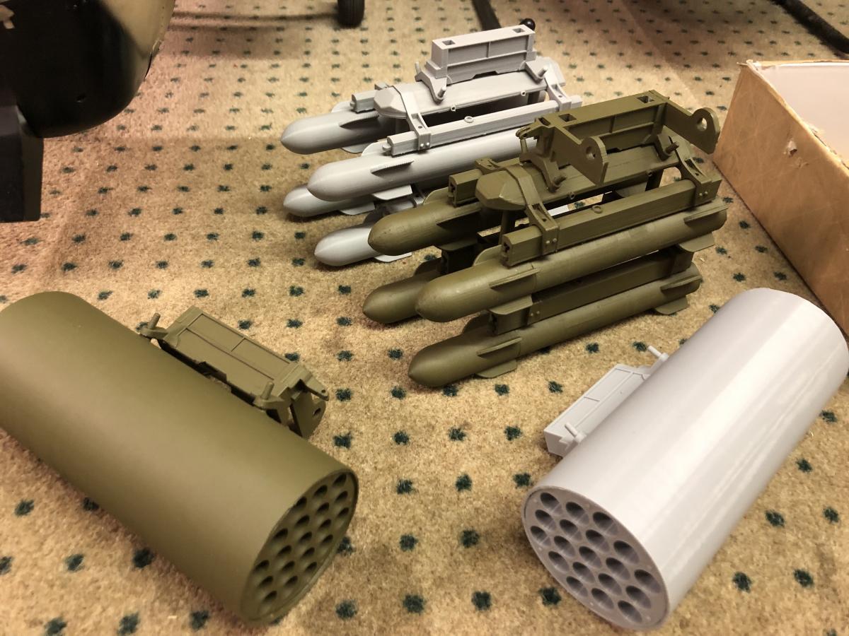

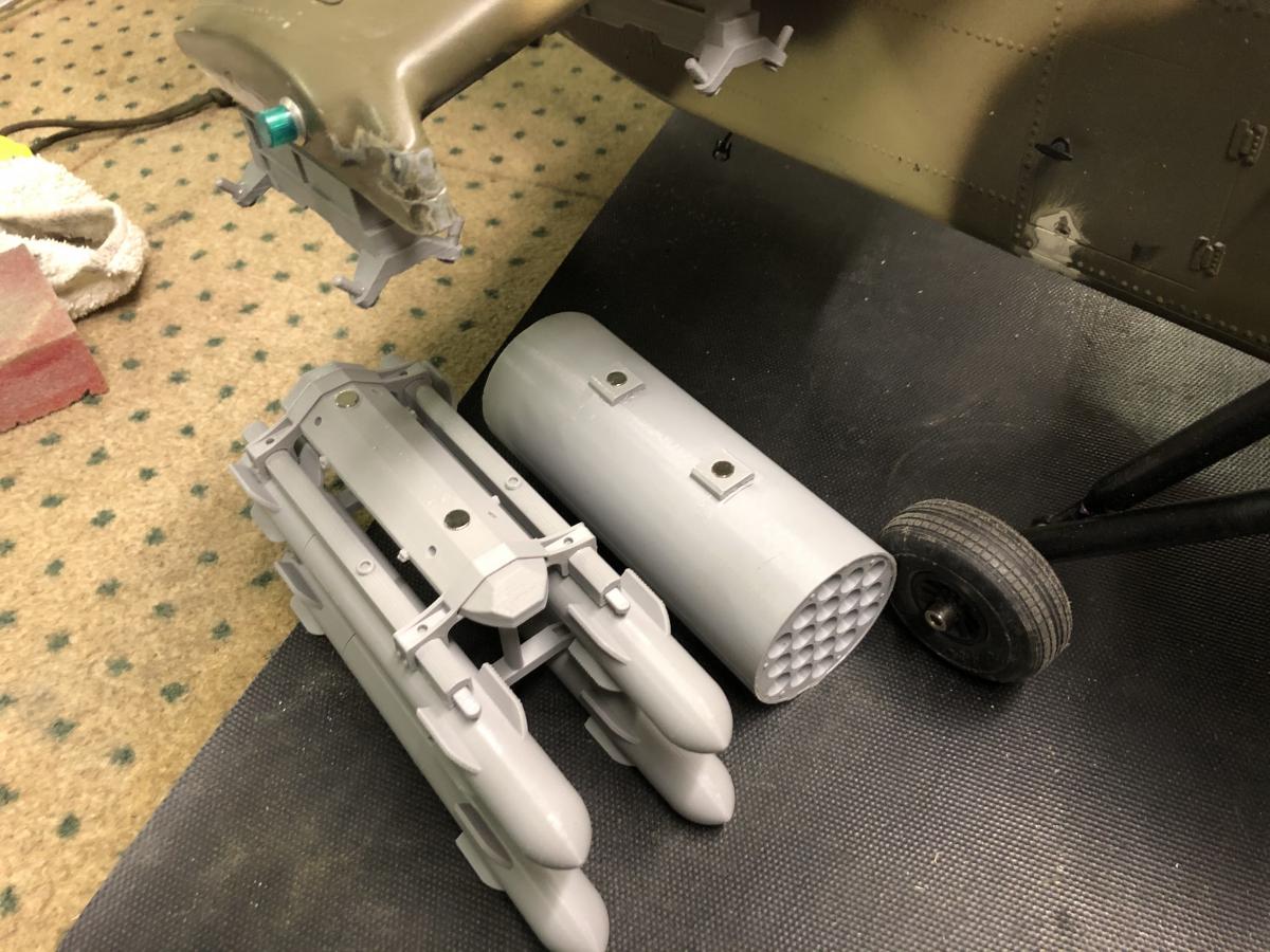

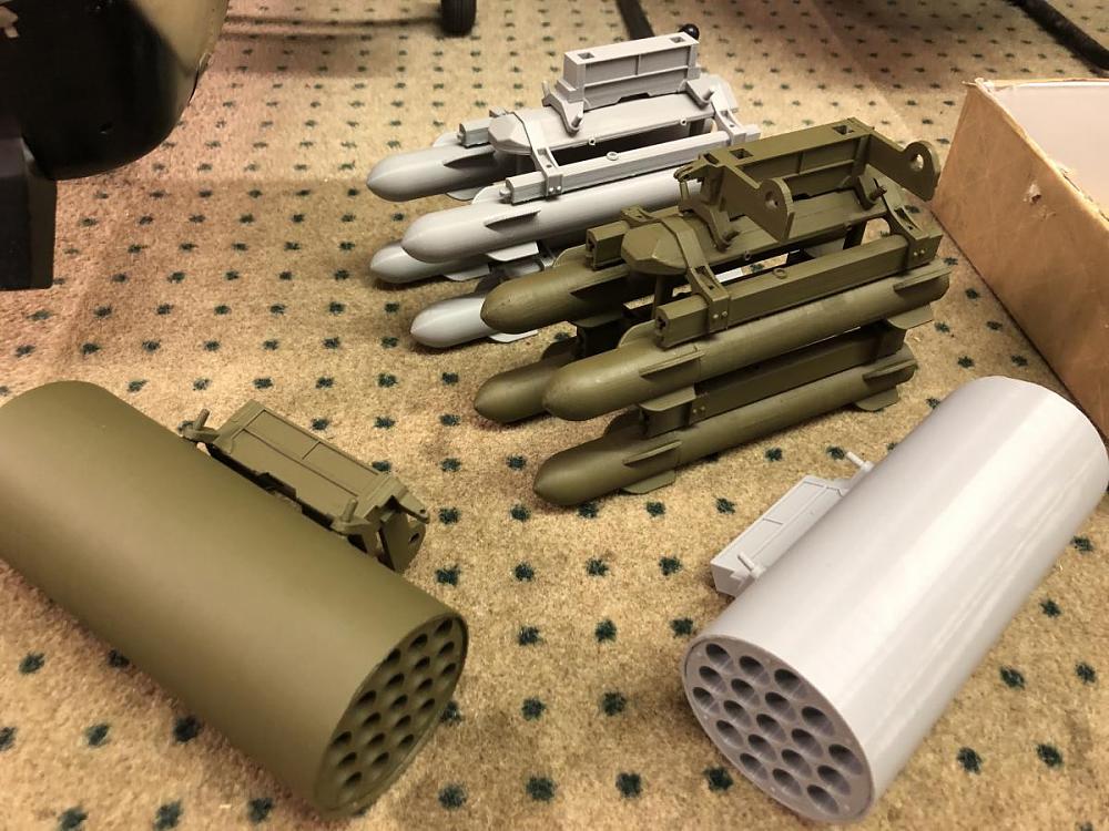

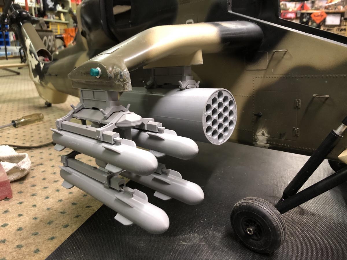

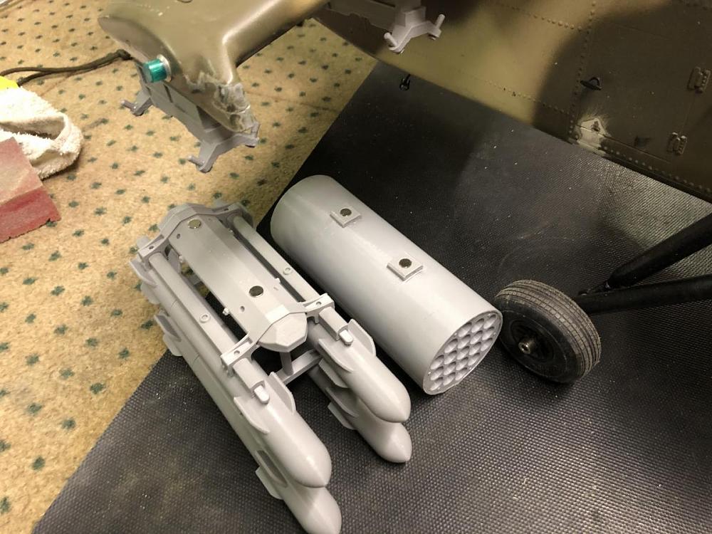

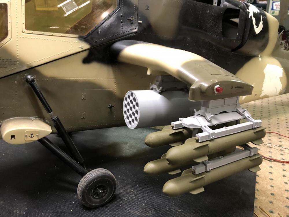

    Some 3D printed ordnance...

    That is going to be gorgeous when completed. The ordnance looks great already
      • 2818
      • Arlington, TX
      Very cool, this is going to look awesome in the air!

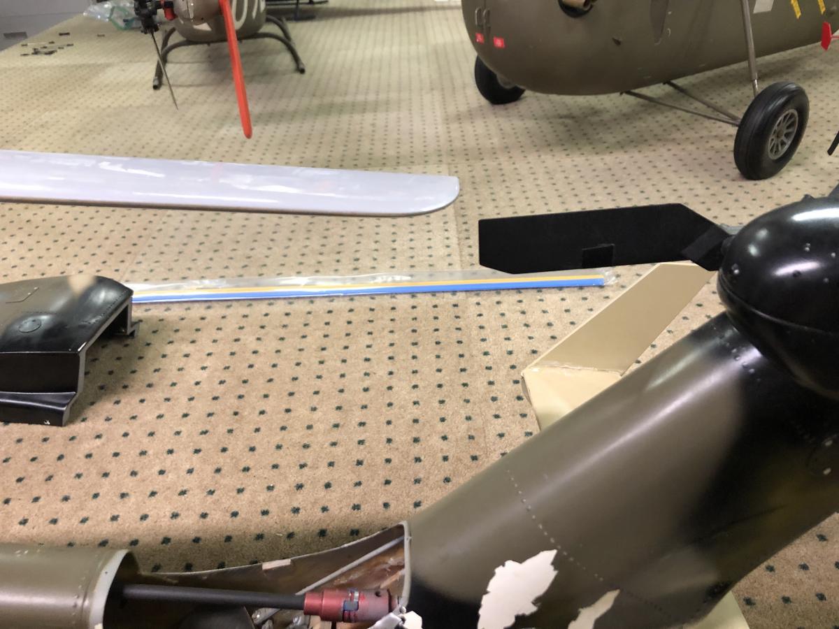

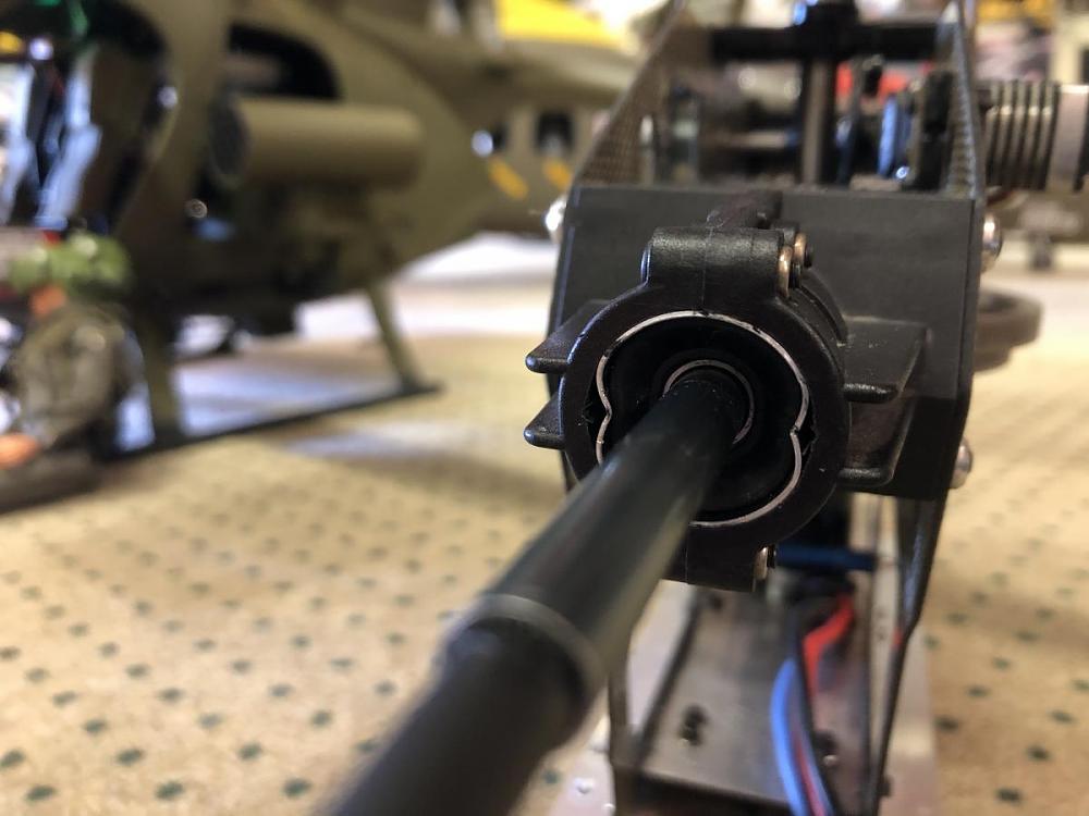

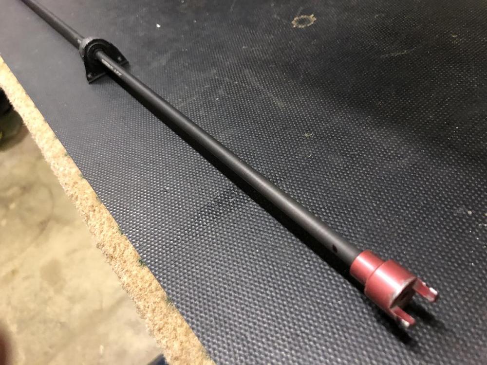

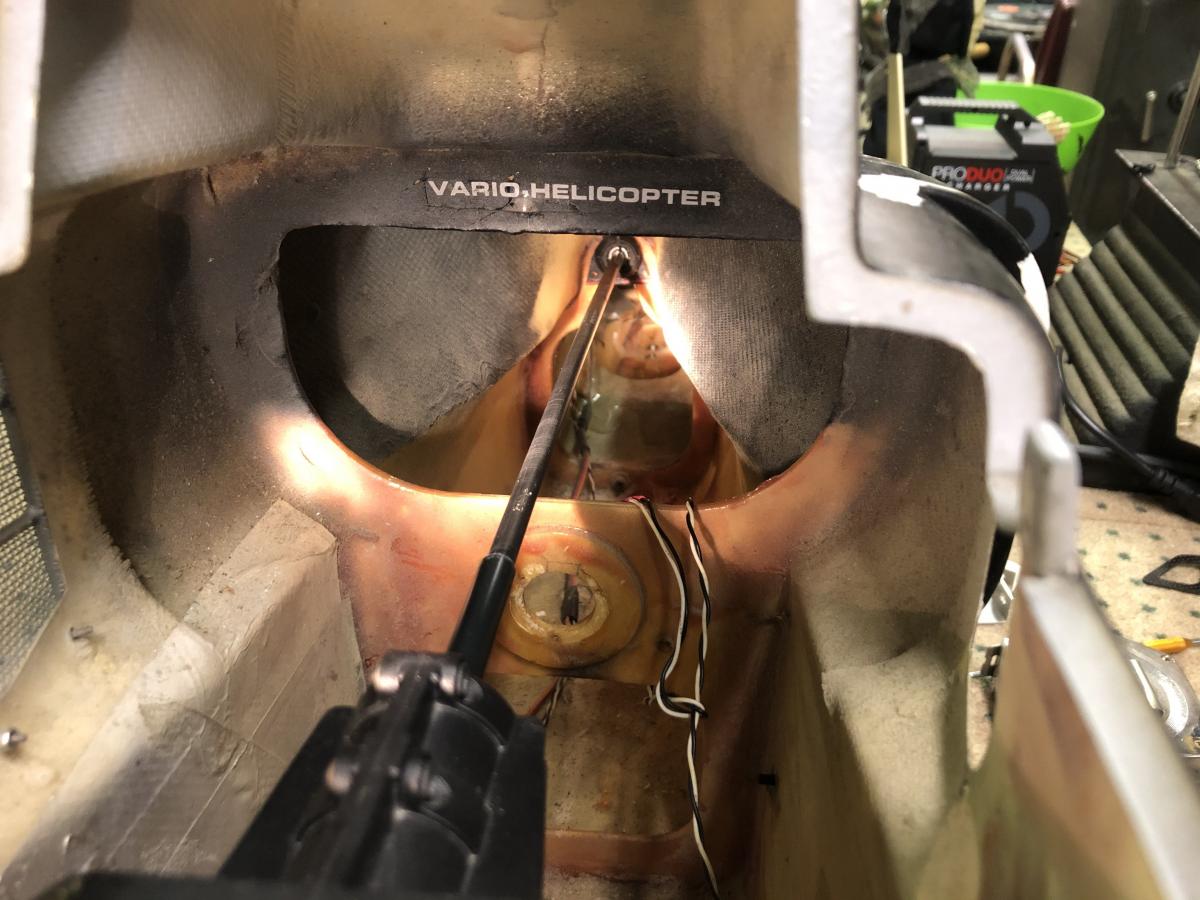

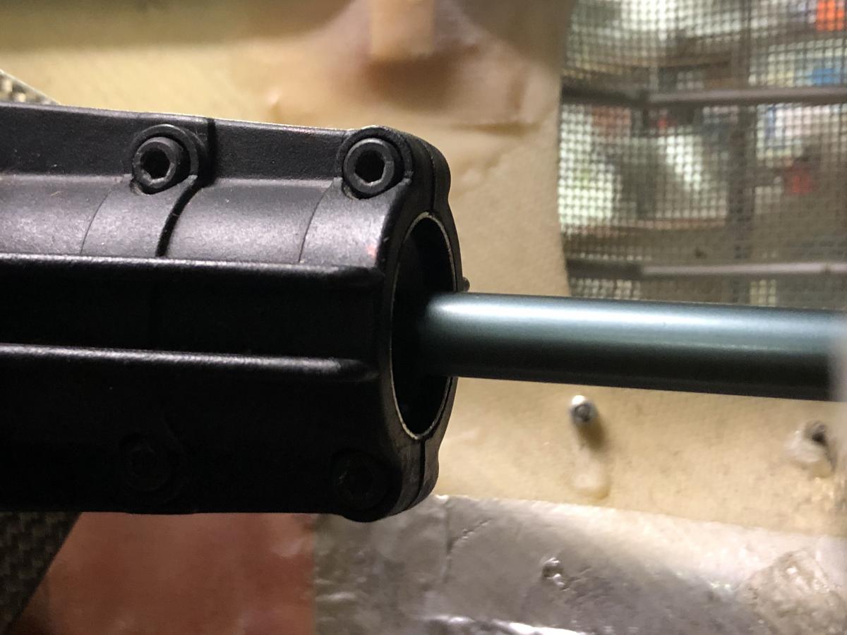

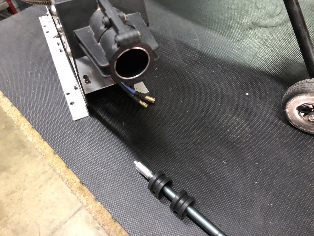

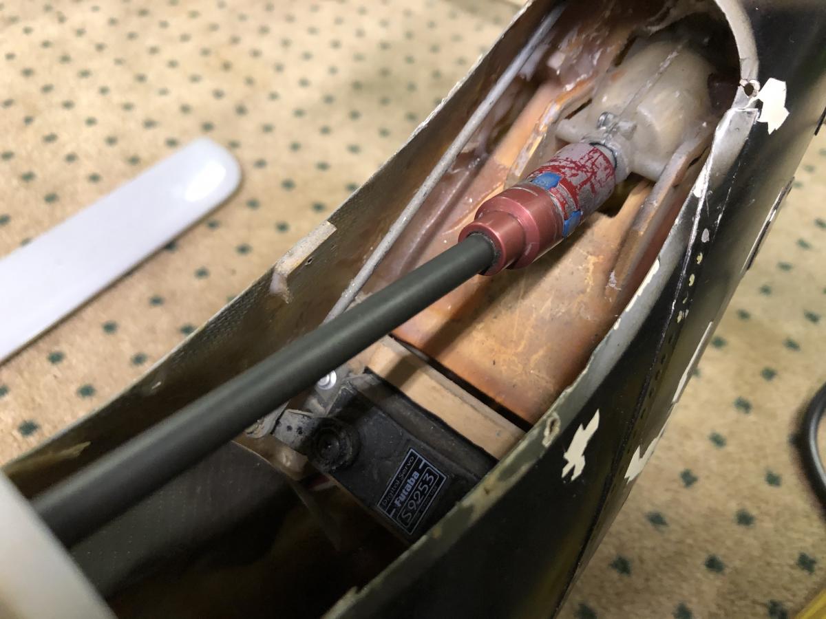

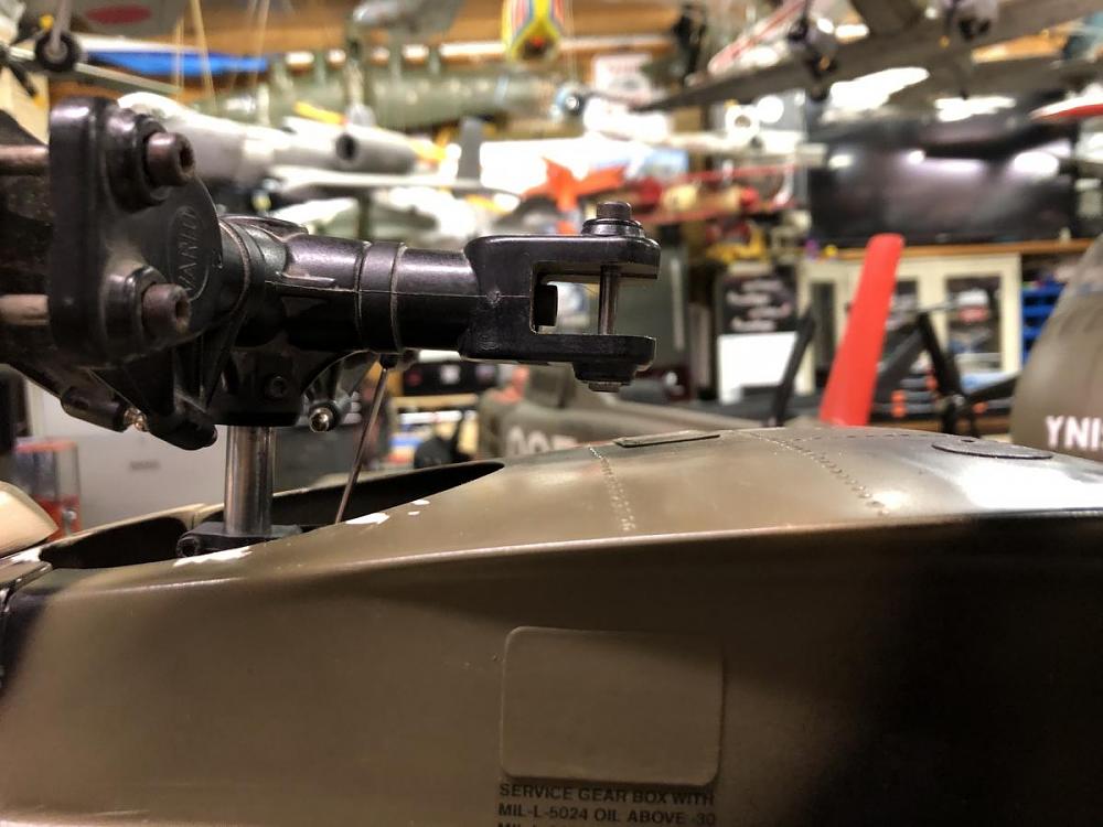

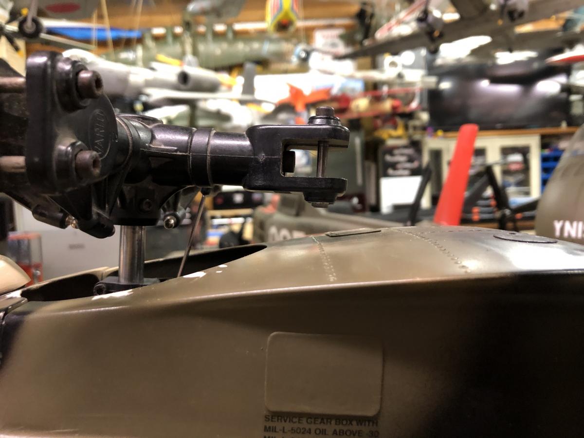

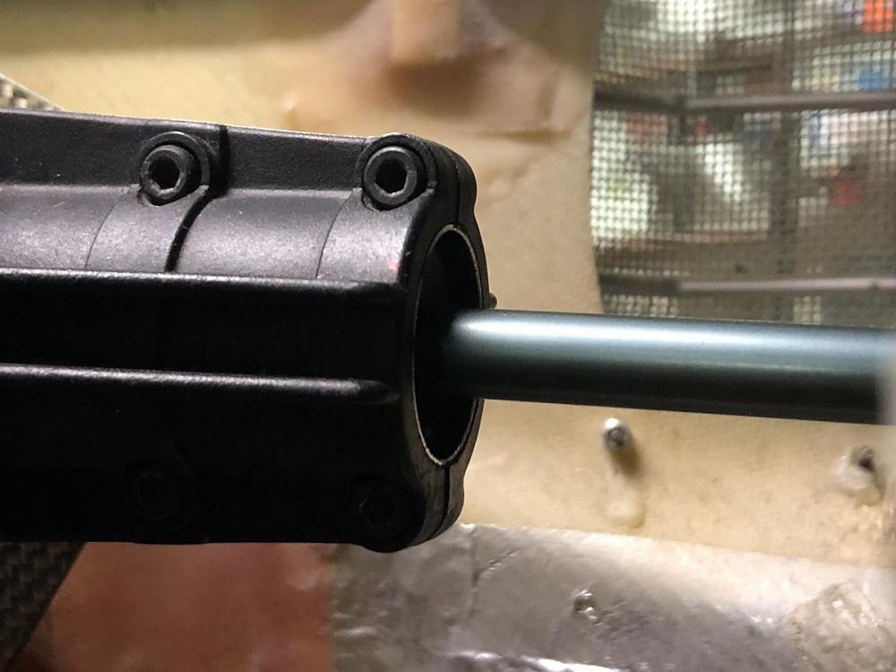

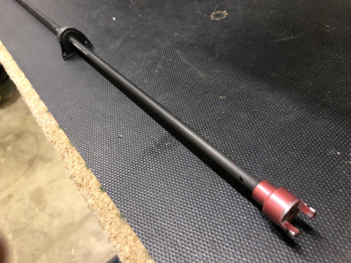

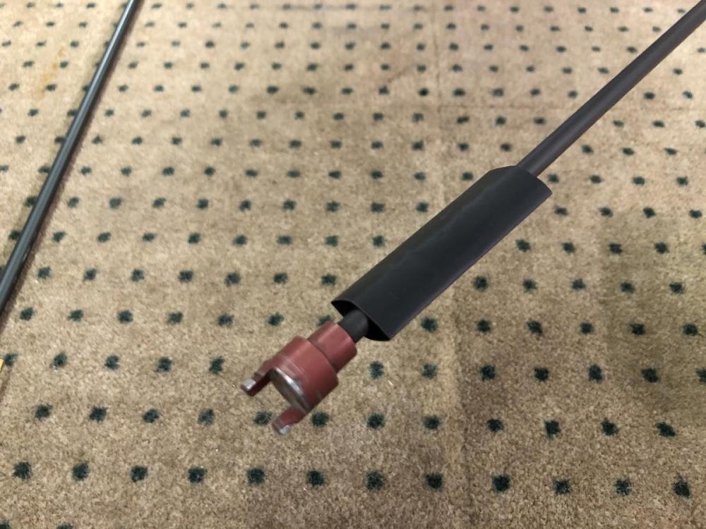

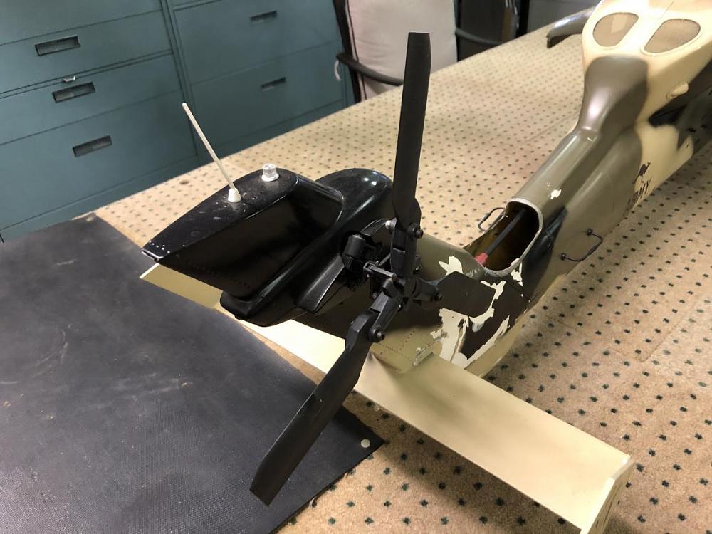

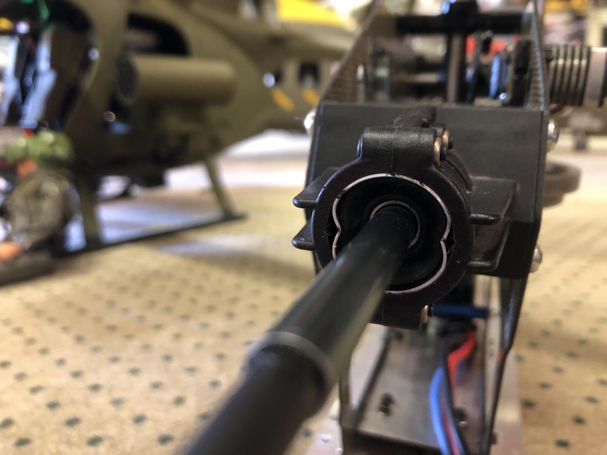

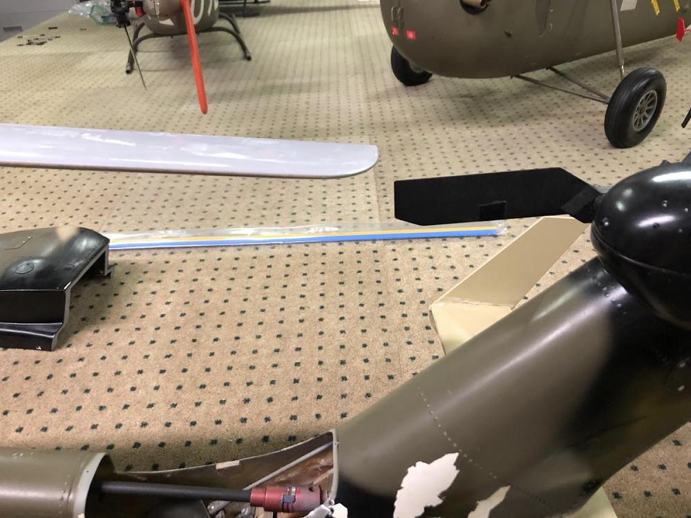

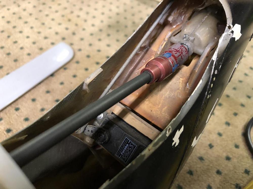

        I finally finished the Align T-Rex to Vario tailshaft conversion, I used two torque tube bearings in the stub tube I made...

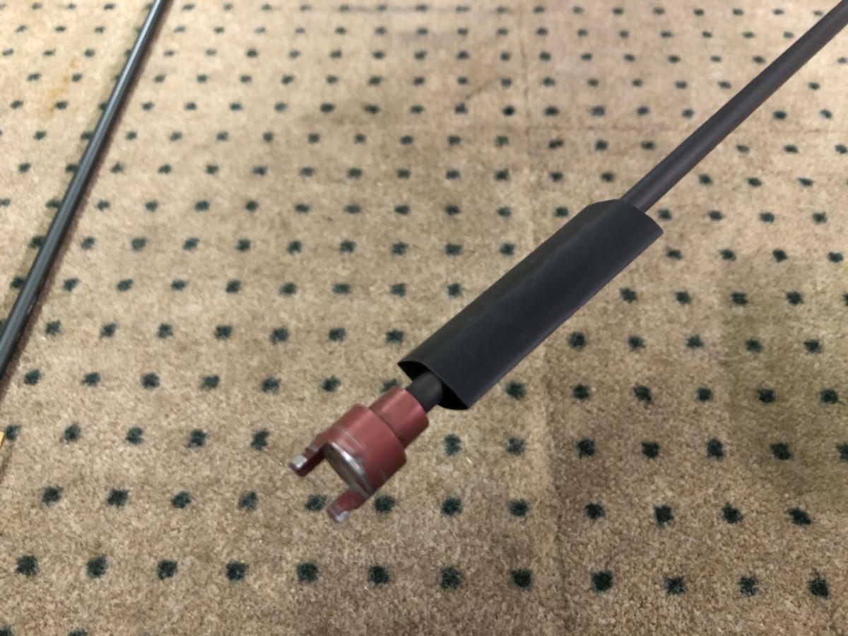

        ...then JB Welded the 6mm Vario shaft into the Align torque tube.

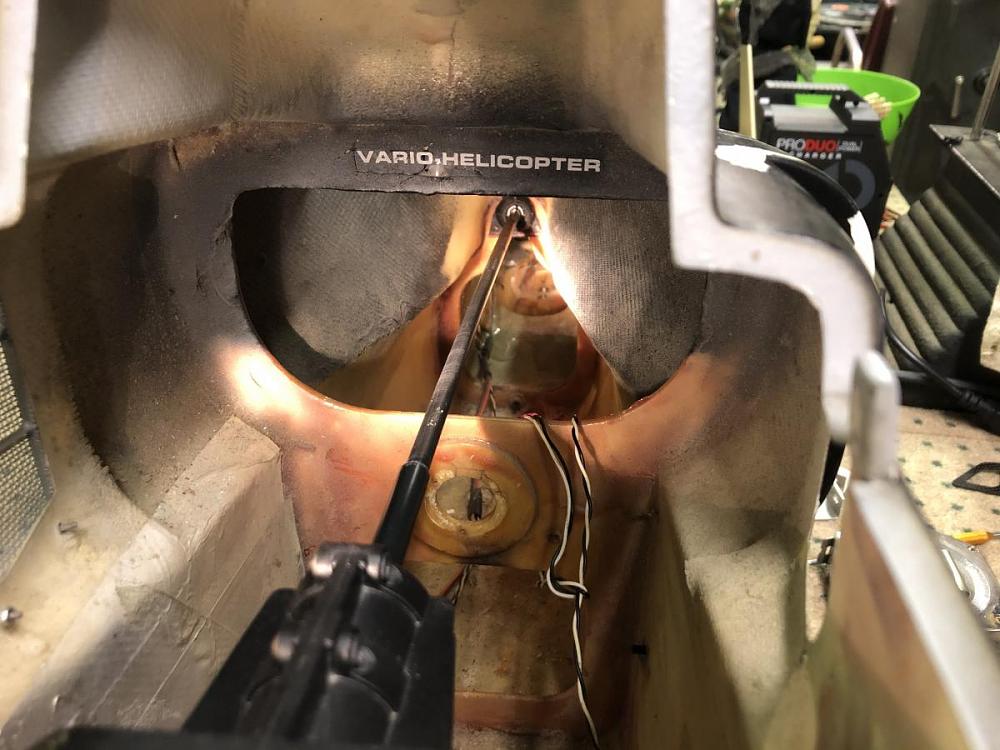

        The 6mm shaft also has a support bearing.

        Pretty close...

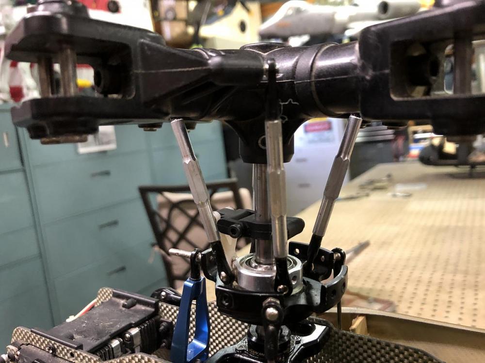

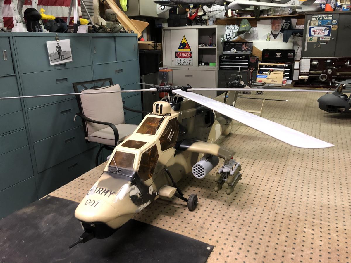

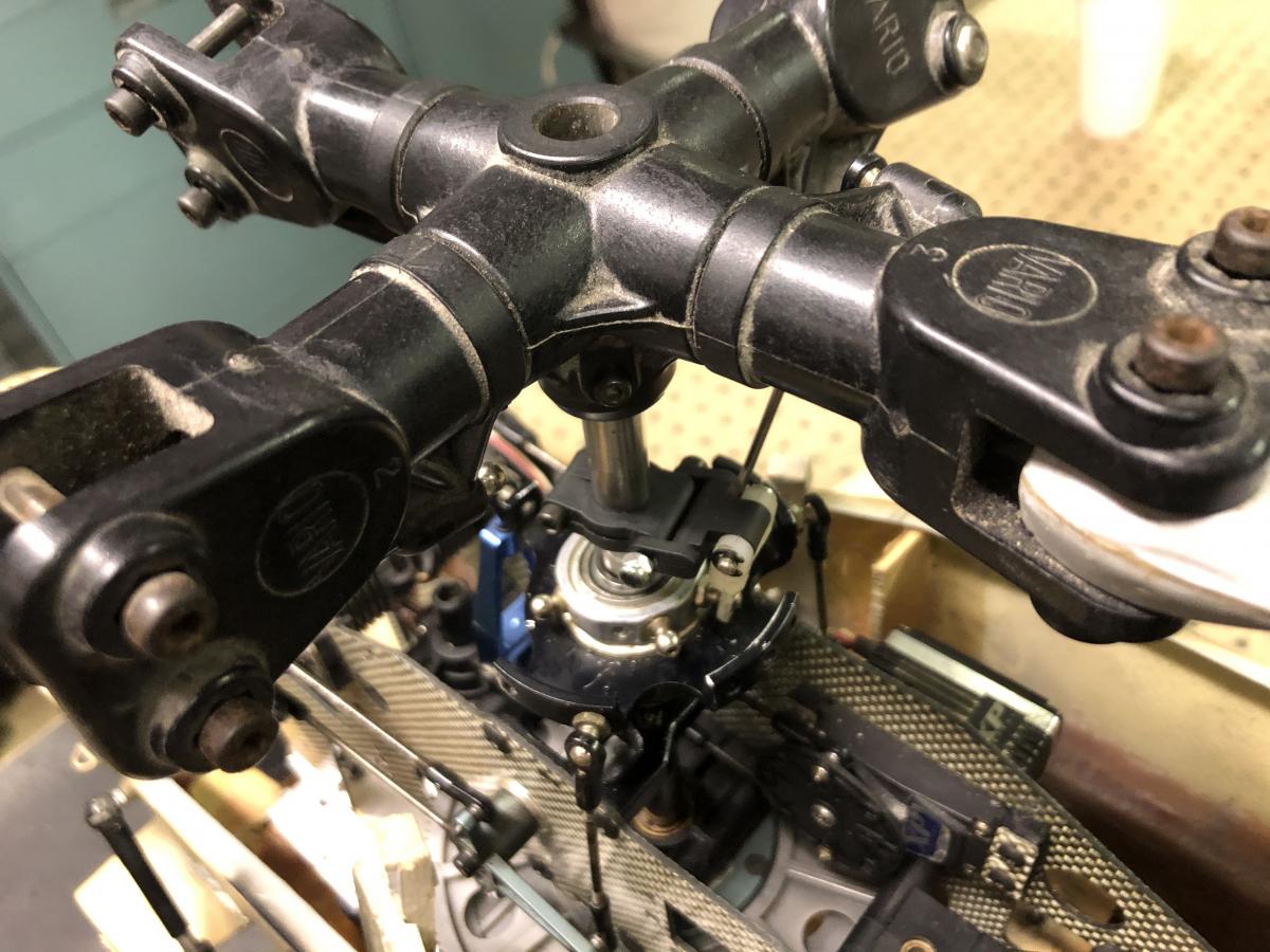

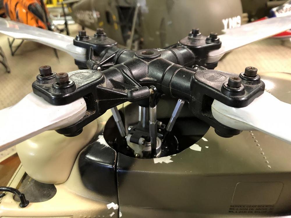

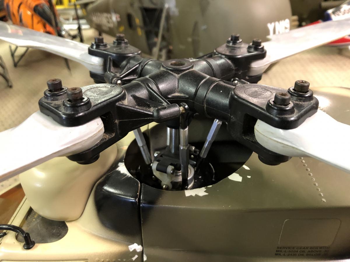

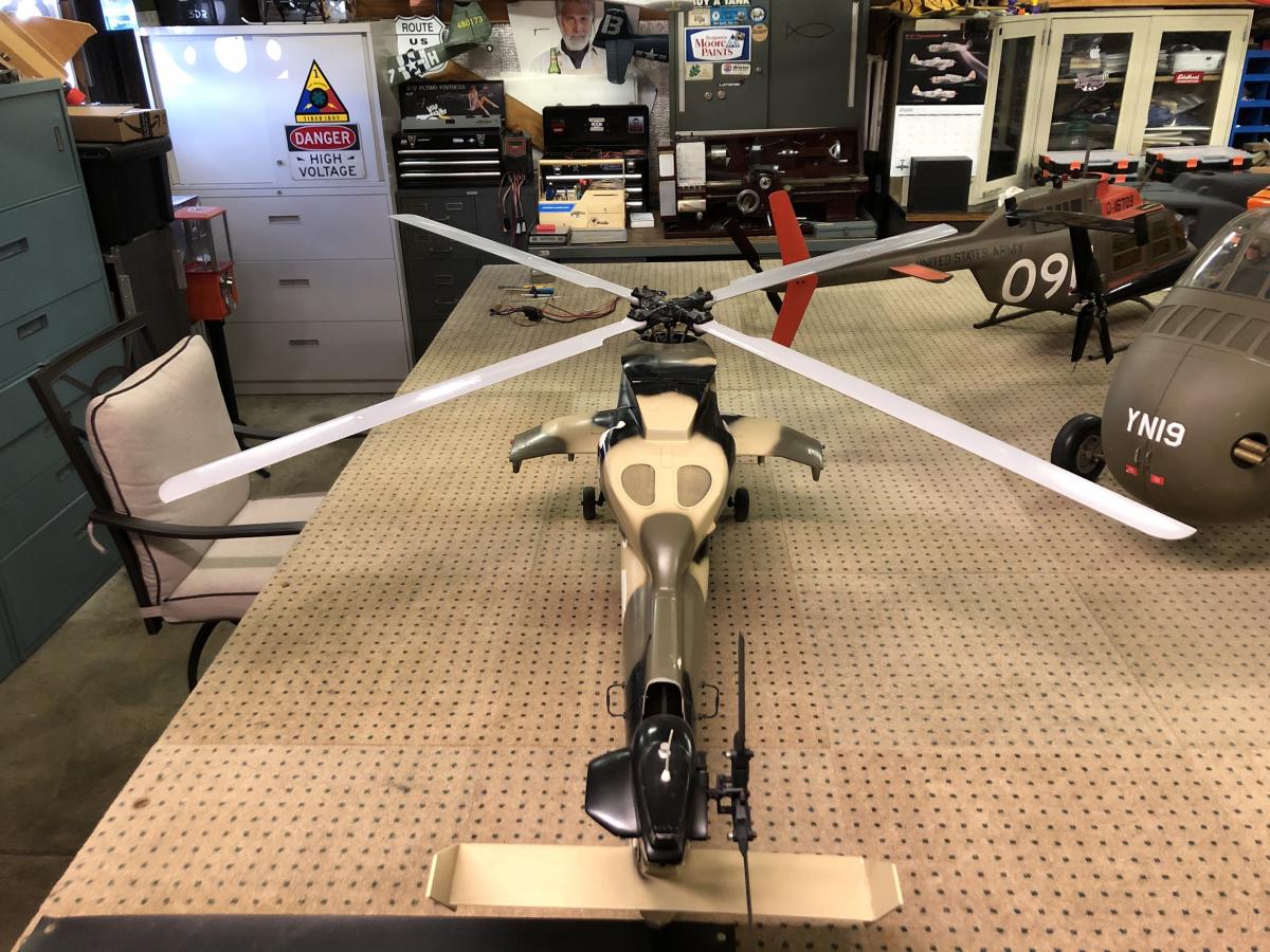

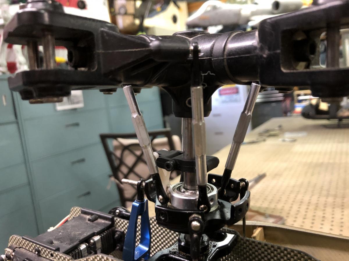

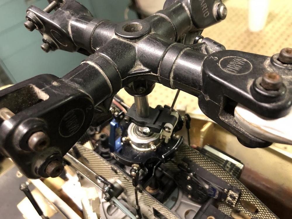

        I picked up an old Vario 4 blade head and some scale looking blades.

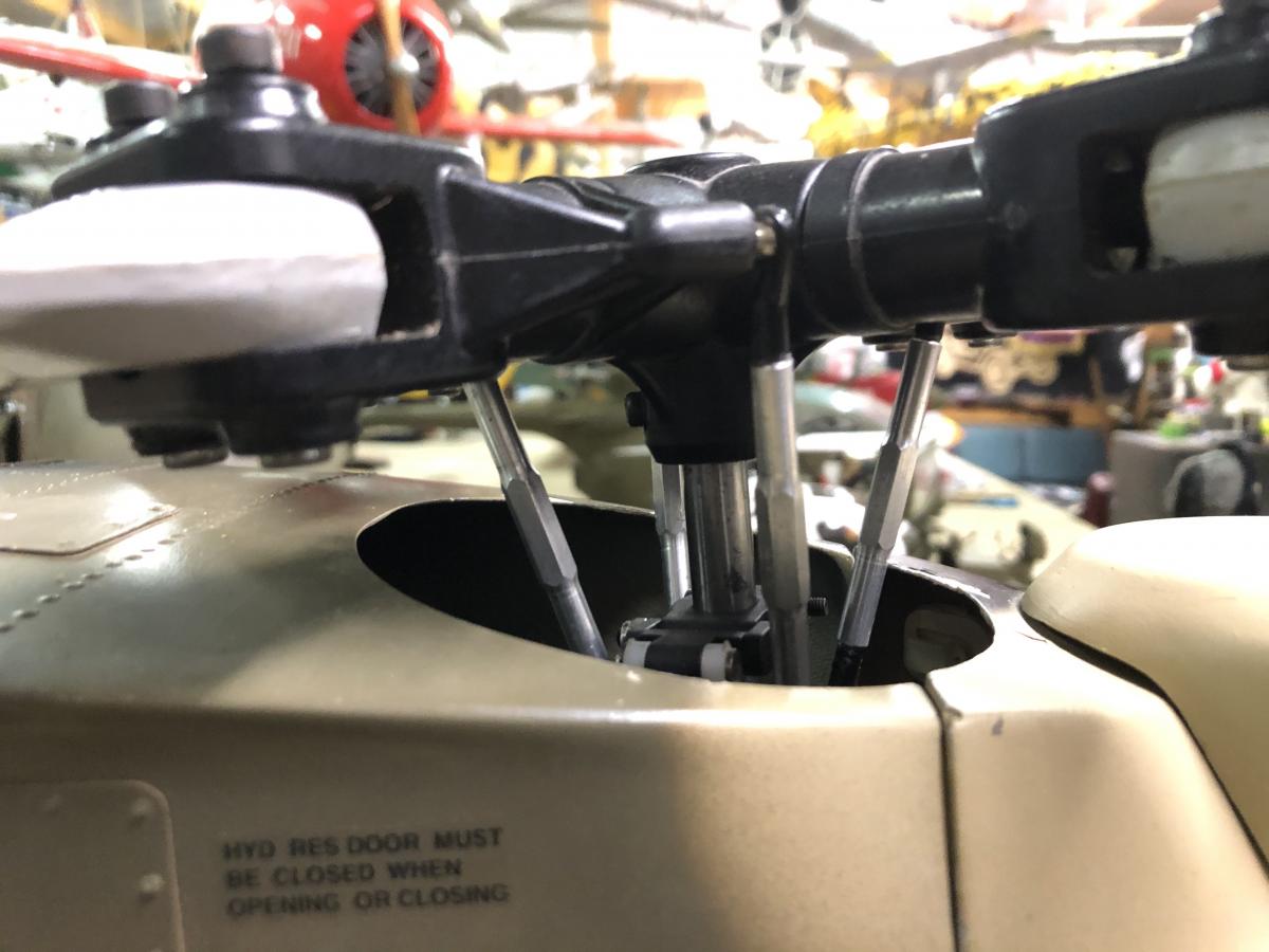

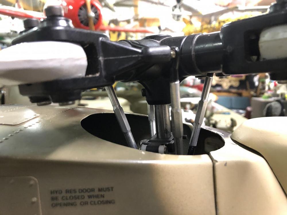

          I made some linkage rods from some Align frame spacers, much beefier
          Click image for larger version  Name:	20191101_170211410_iOS.jpg Views:	0 Size:	117.5 KB ID:	217992
          Click image for larger version  Name:	20191101_180523270_iOS.jpg Views:	0 Size:	109.7 KB ID:	217990
          Click image for larger version  Name:	20191101_233849312_iOS.jpg Views:	0 Size:	91.9 KB ID:	217989
          Click image for larger version  Name:	20191101_180510503_iOS.jpg Views:	0 Size:	196.4 KB ID:	217993
          Click image for larger version  Name:	20191101_180650473_iOS.jpg Views:	0 Size:	188.1 KB ID:	217994
          Click image for larger version  Name:	20191101_180536267_iOS.jpg Views:	0 Size:	118.4 KB ID:	217991

            Great work, those pitch links are certainly not going anywhere! Looks like it’s almost ready to get back in the air!

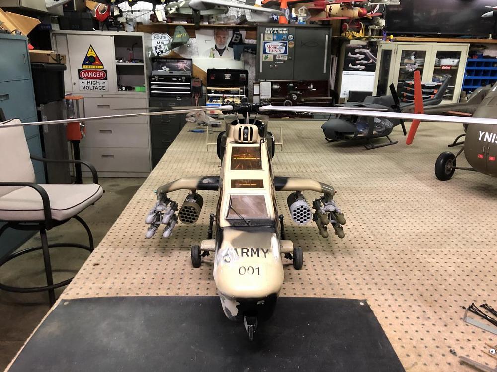

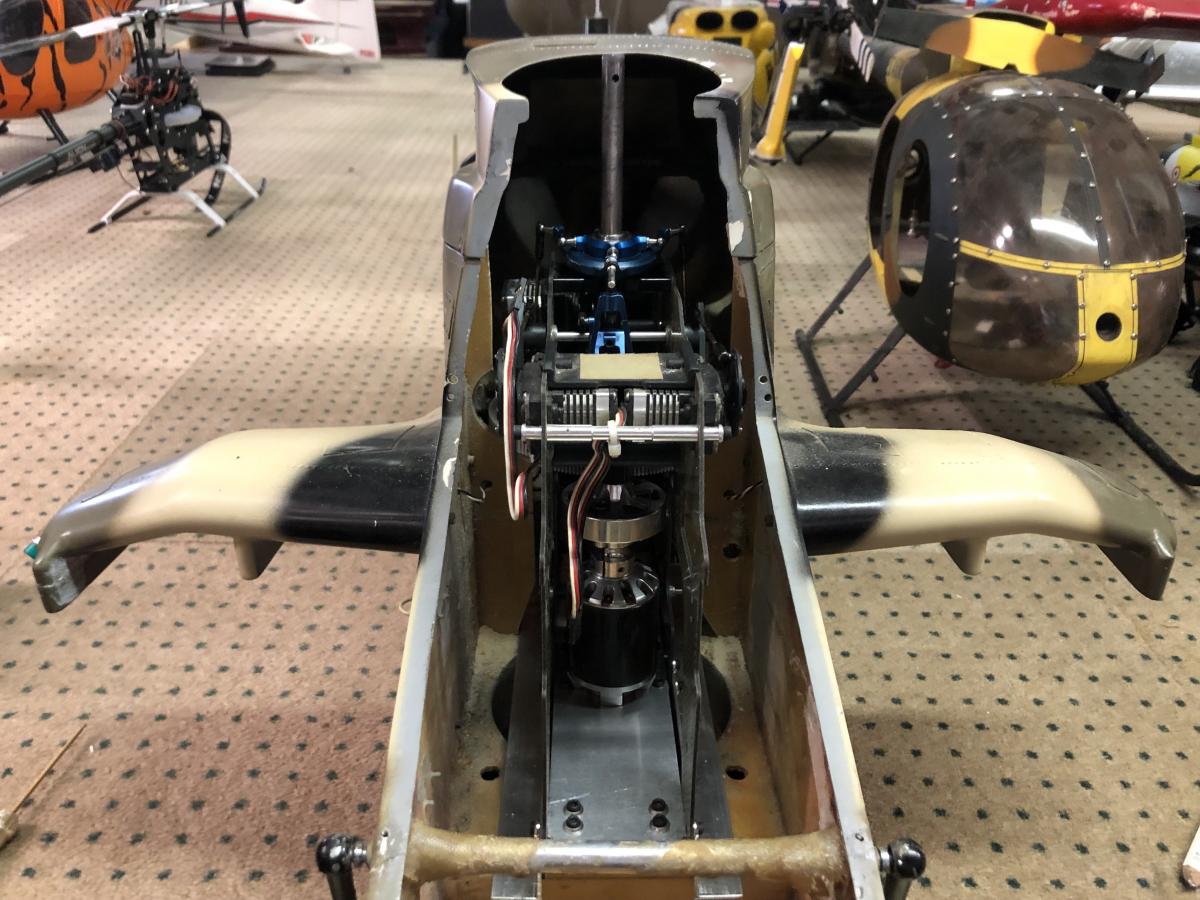

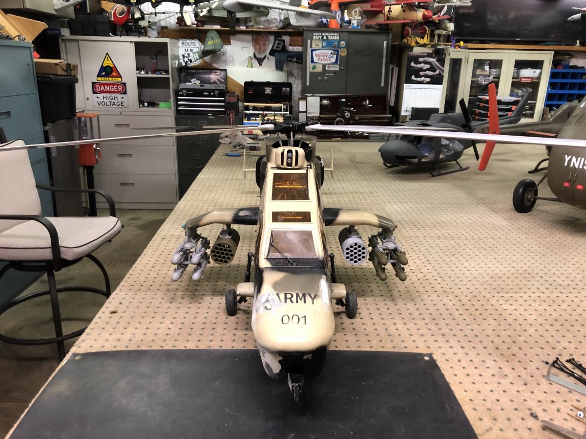

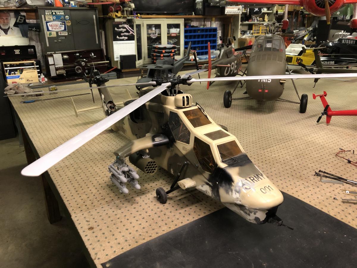

              Got some more done, painted the interior, put a new clutch in and went over everything in the mechanics.

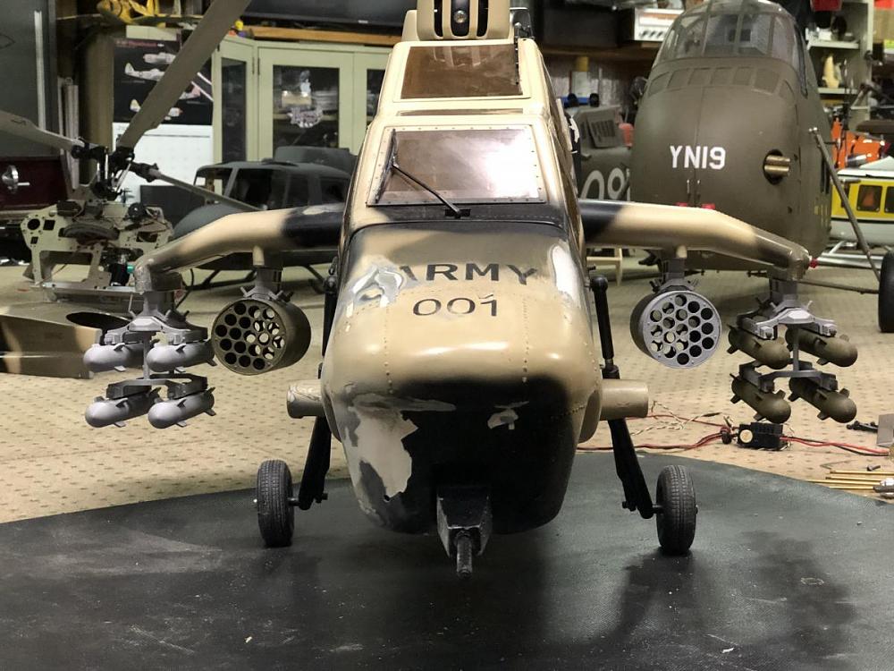

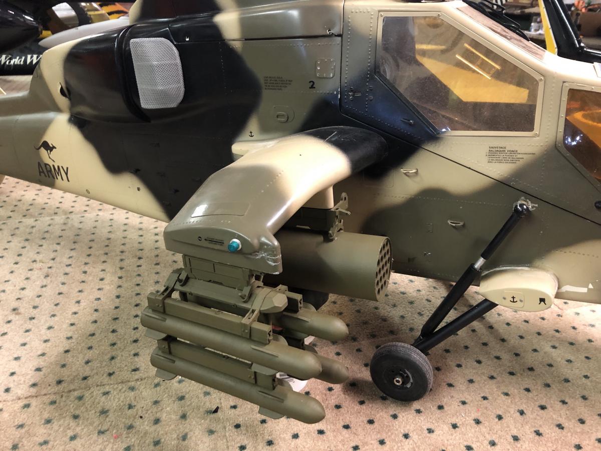

              Fitted all the ordnance mounts on...
