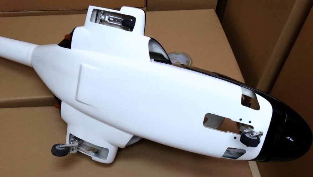

    Can someone who has built this kit please post a picture and some guidelines on how to setup the landing gear? I need to see the servo installation as well as the linkages please. Thanks!

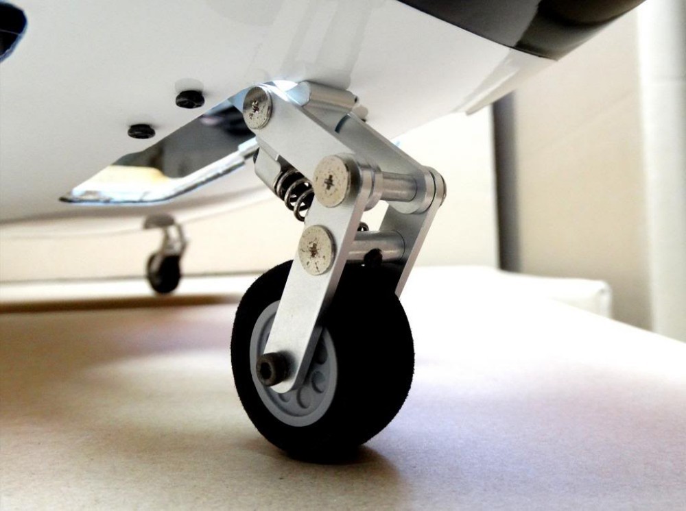

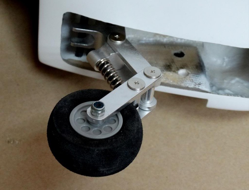

      Hi there Capt. Momo,
      Here are some photos that may be able to help you set up your 600 Size Airwolf landing gear retracts. First thing, Roban came up with 2 different setuo retract system. The first version uses one standrad Hi torque servo and the 2nd version utilizes 2 standard servos with the use of a Y Harness. I will post photos that uses 2 standard servos. I hope this photos helps you and if you have further questions or need a walk through, please call Motion RC at 224-633-9090 and ask for me - Ed.

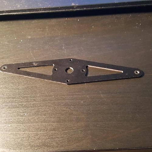

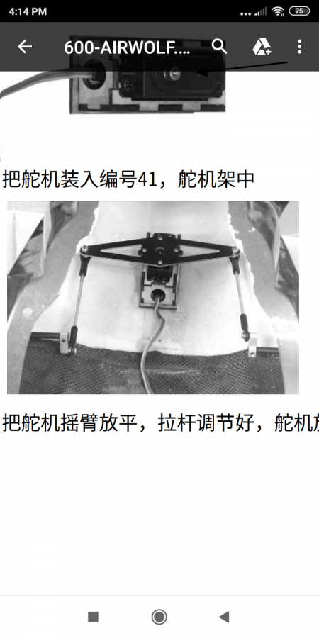

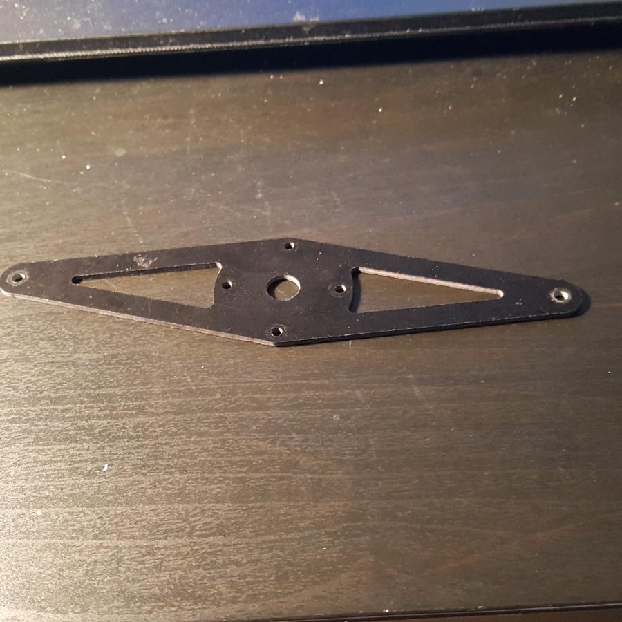

        This is the 2nd version that uses only (1) Hi torque standard servo with servo frame. It is secured in front of the frame using high strength structural epoxy or like Hysol Epoxy. See photo please.
