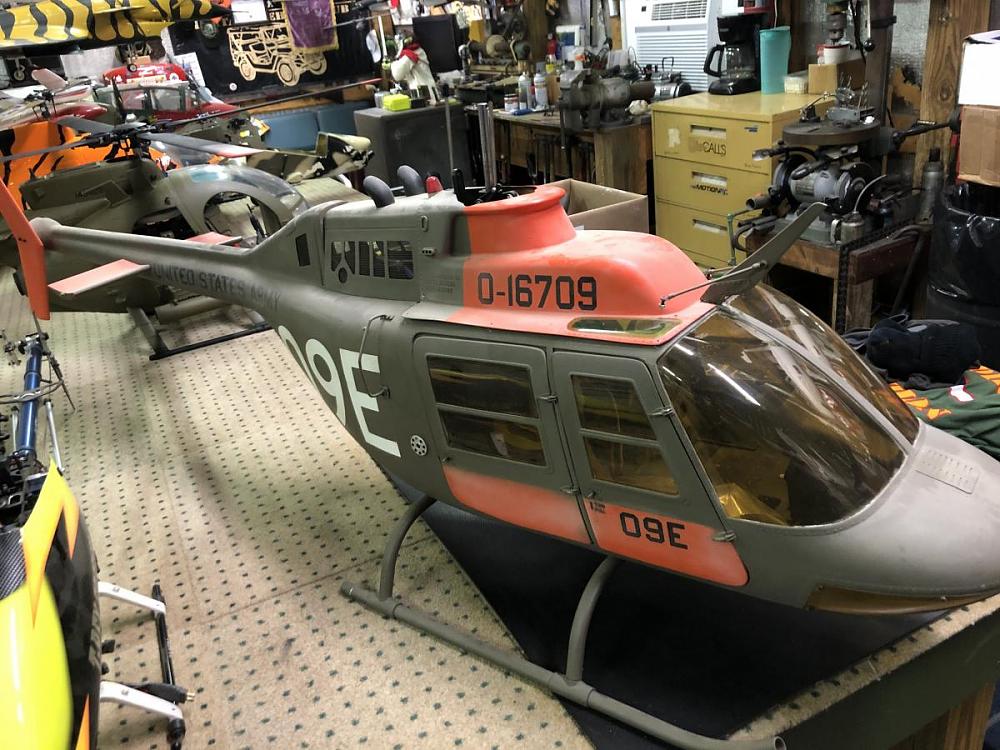

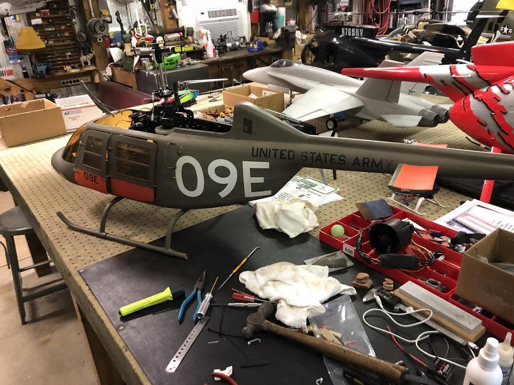

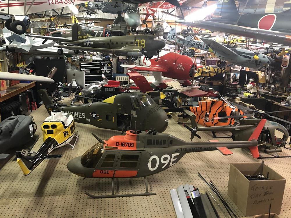

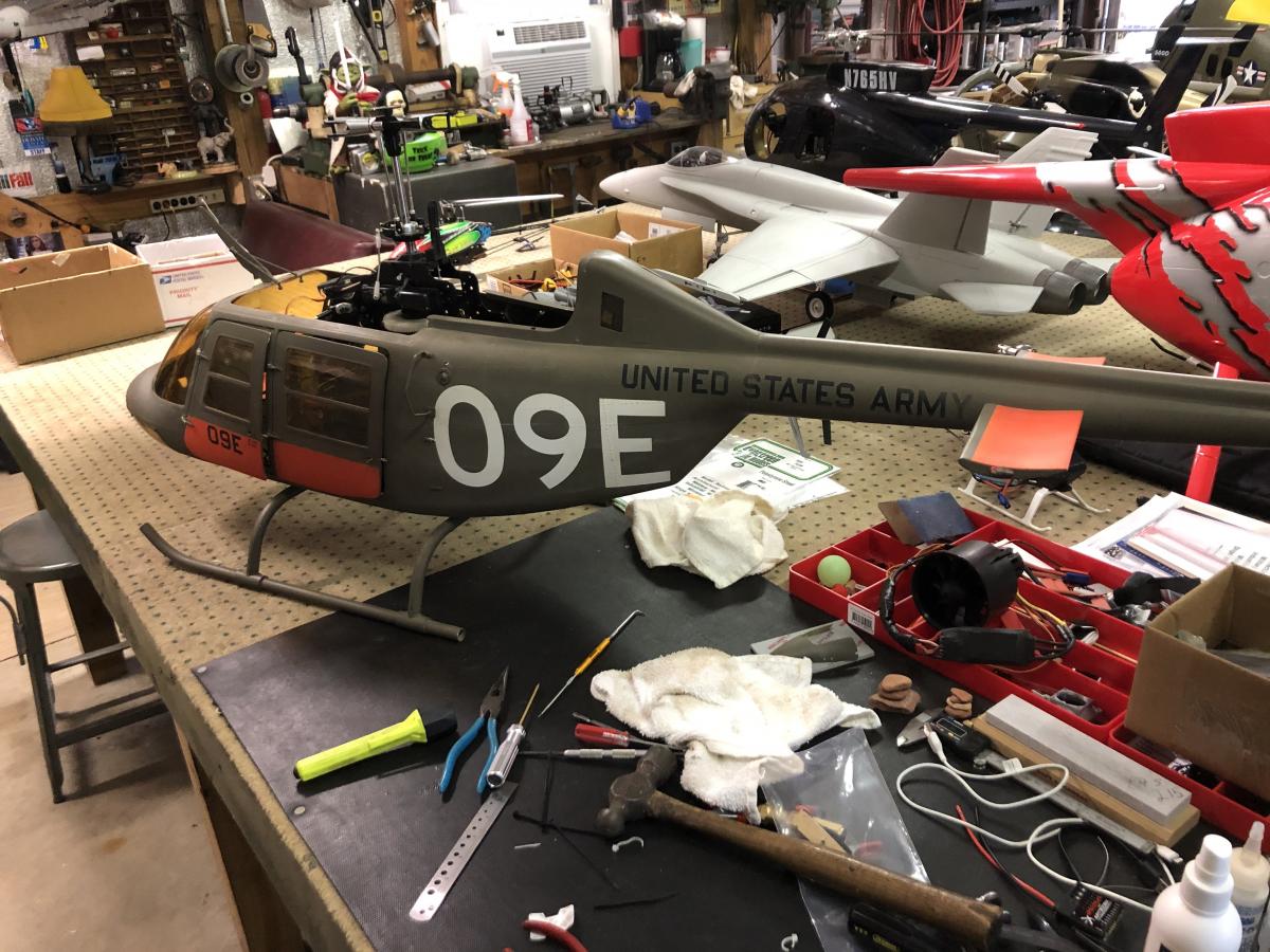

    I picked this up at the Southern Scale Challenge and have been piecing it back together.

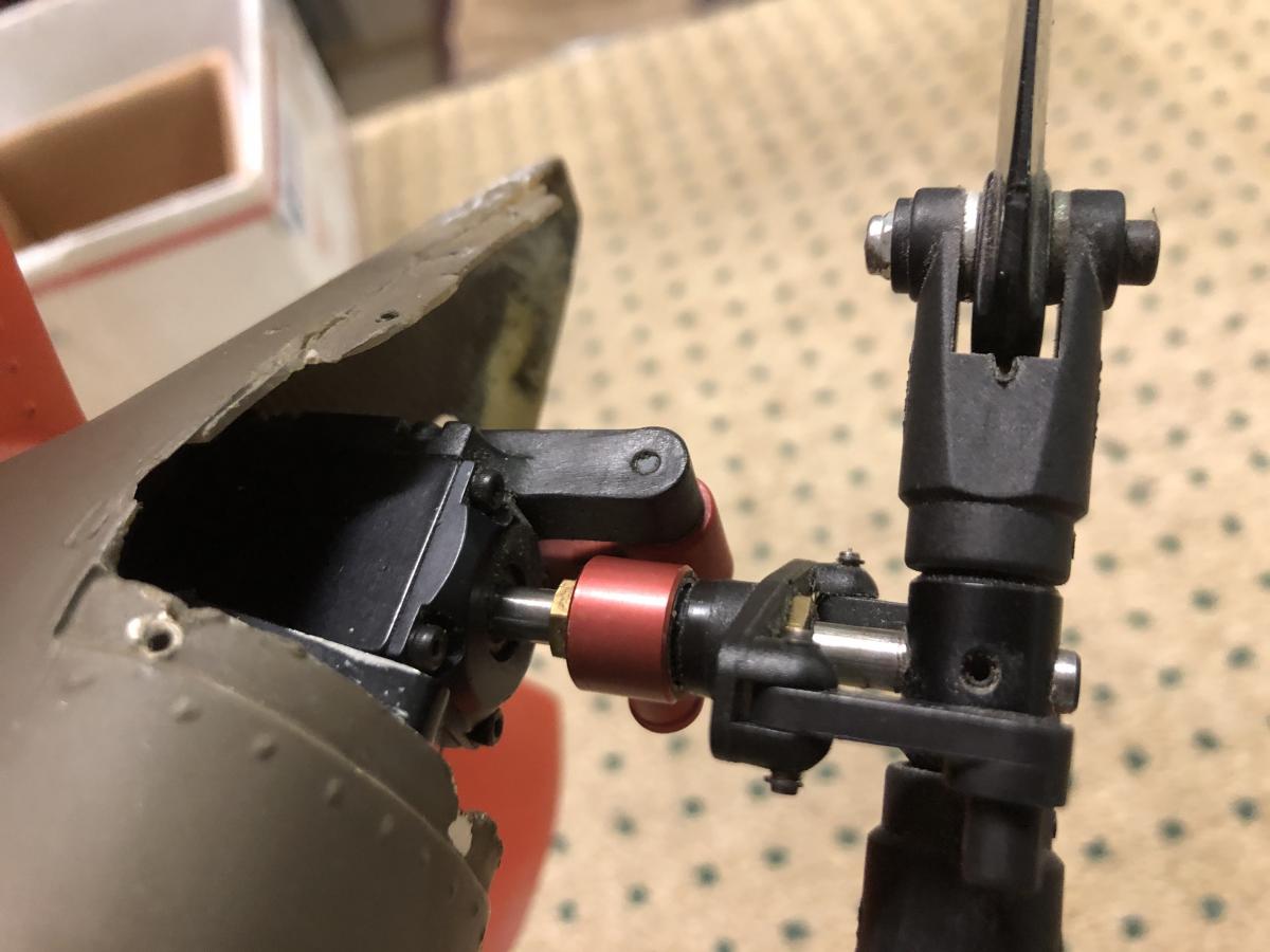

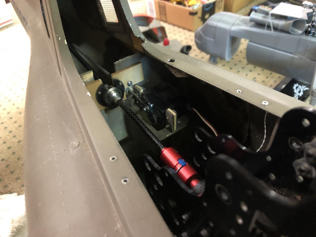

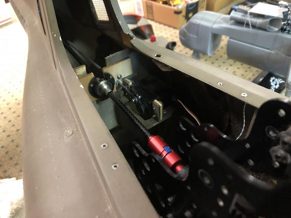

    The fuselage was setup for a wire tail drive so I updated it to a 5mm carbon fiber setup.

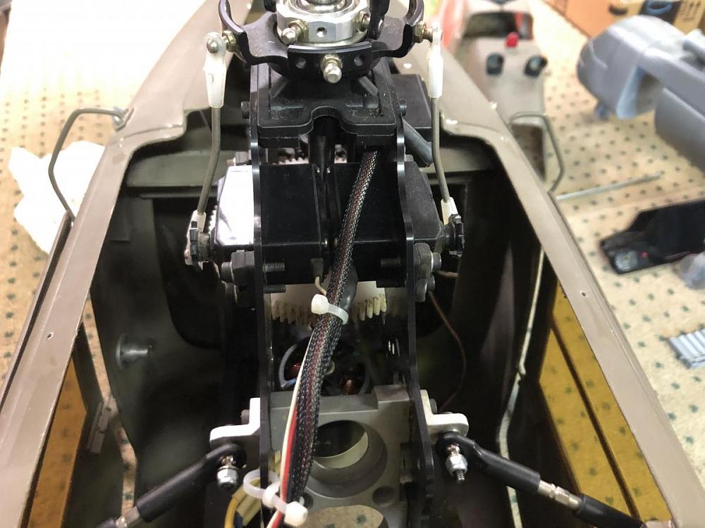

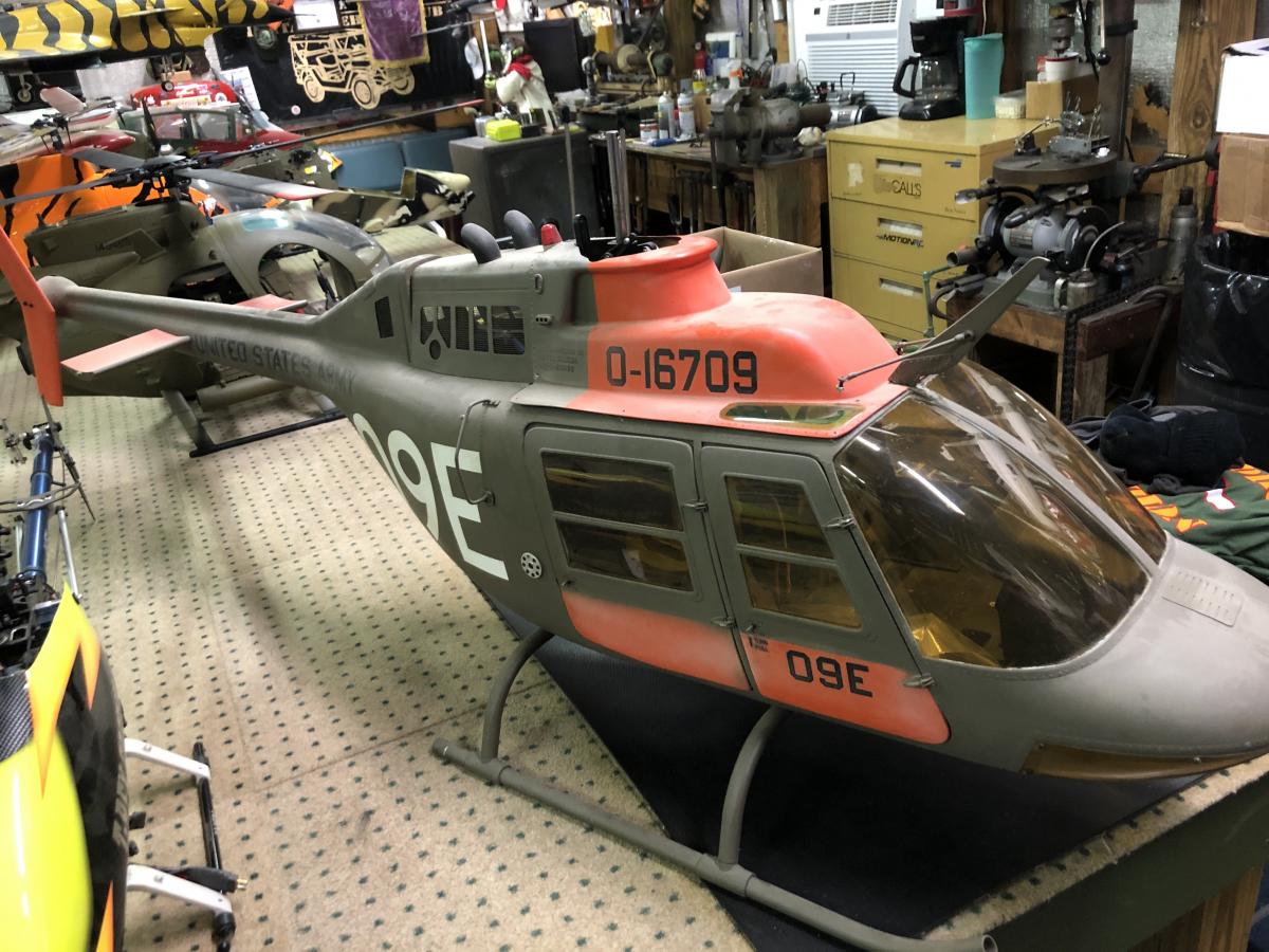

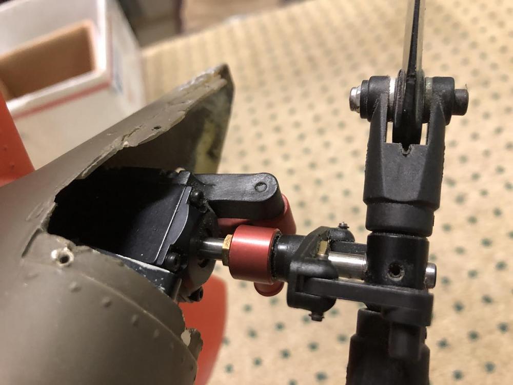

    Braced the top of the frame.

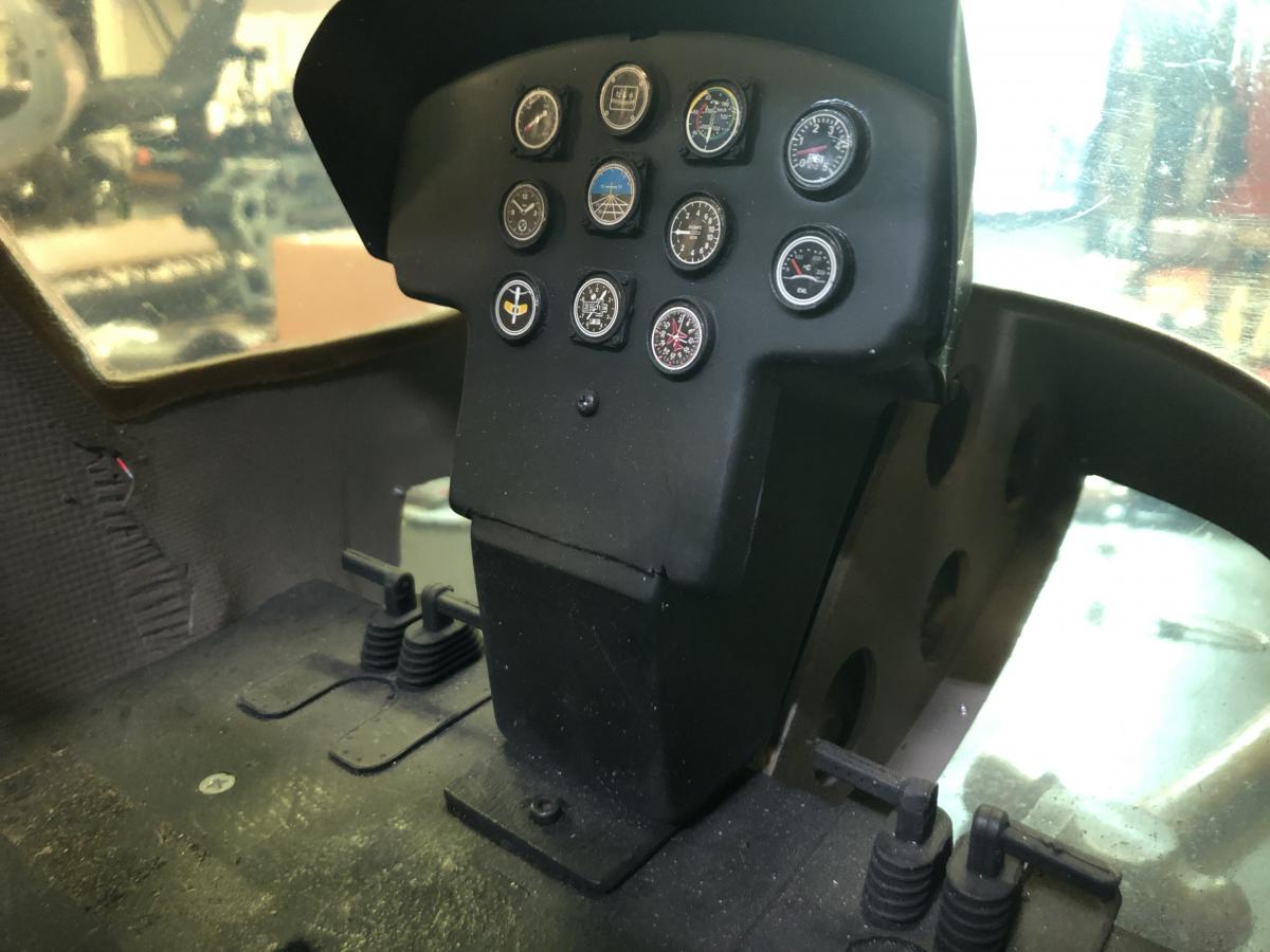

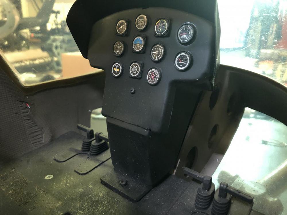

    I may update the cockpit, but I may not...I mostly just want to preserve it and make it as safe as possible to fly.

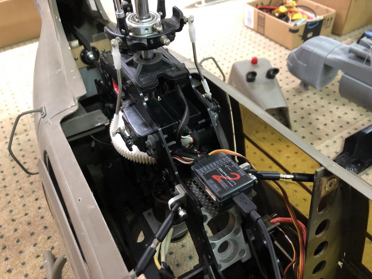

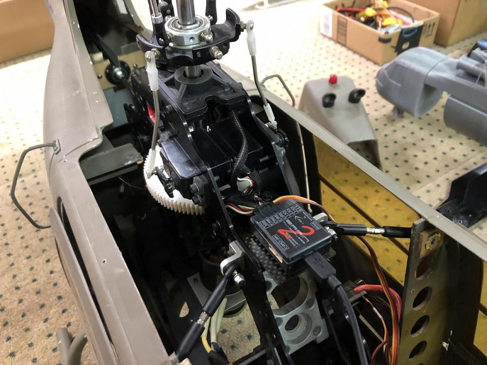

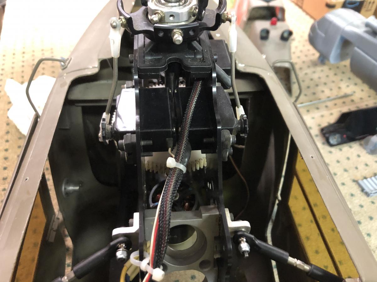

    Added a Brain2 FBL controller.
