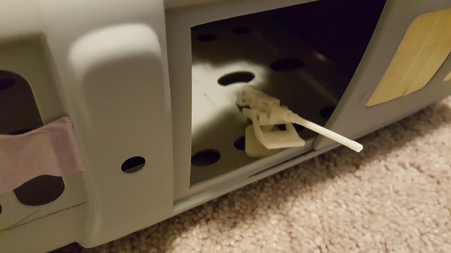

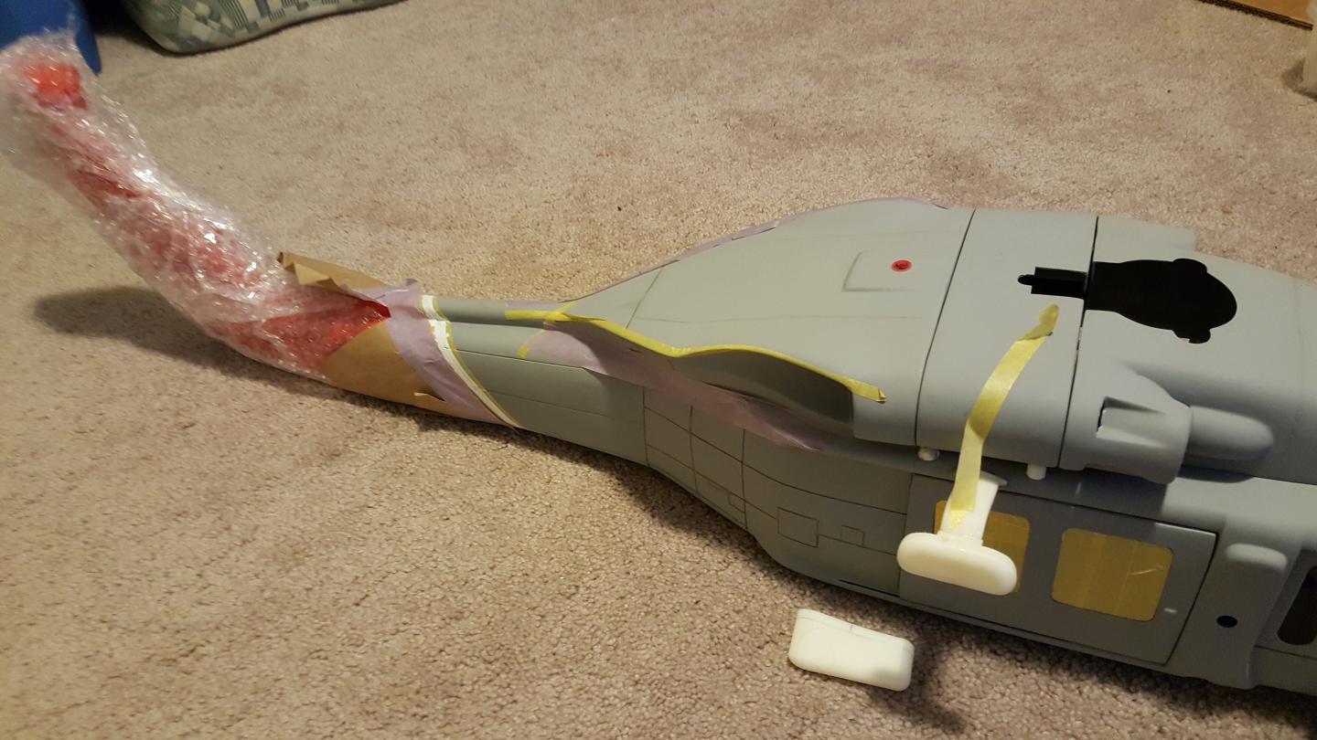

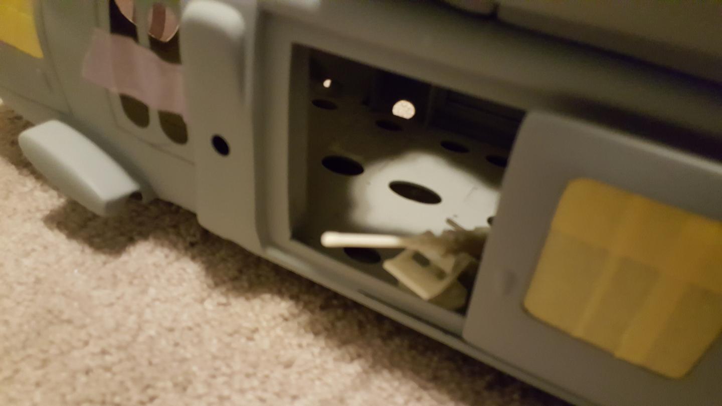

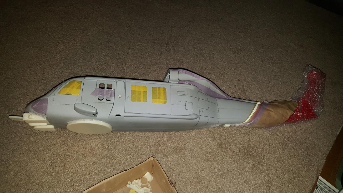

    For some of you who might decide on building this 500 Seahawk I will be posting pictures on this awesome Scale fuselage. I have the following information I have used in building the whole complete frame as well.
    Body : Roban 500 size SH-60 conversion Kit Fuselage (Motion RC)
    Frame; Chaos 500 ESP using the conversion frame the kit came with.
    Motor: Scorpion HK-3026-1100 KV
    Speed Controller : Castle Creation 120A
    Battey: Admiral 3600 mah 6S / 2500 mah 2S ( Separate receiver pack)
    BEC: Castle Creation 20A BEC Pro
    FBL Controller: Bavarian Demon 3X
    Scale Blades : Spinblades (Germany)
    Scale 4 Blade Head (CNC / Align)
    4 Blade Tail Rotor Assy (CNC)
    Decals: Callie Graphics Sea Hawk Scorpions.
    Paint used : Mr. Hobby / Top Coat

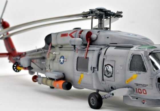

    Full Size SH-60 Seahawk photos:

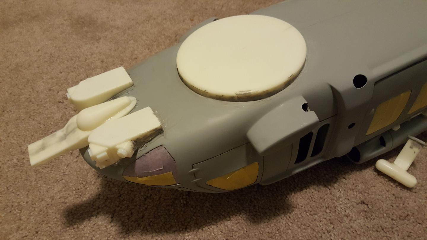

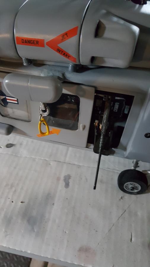

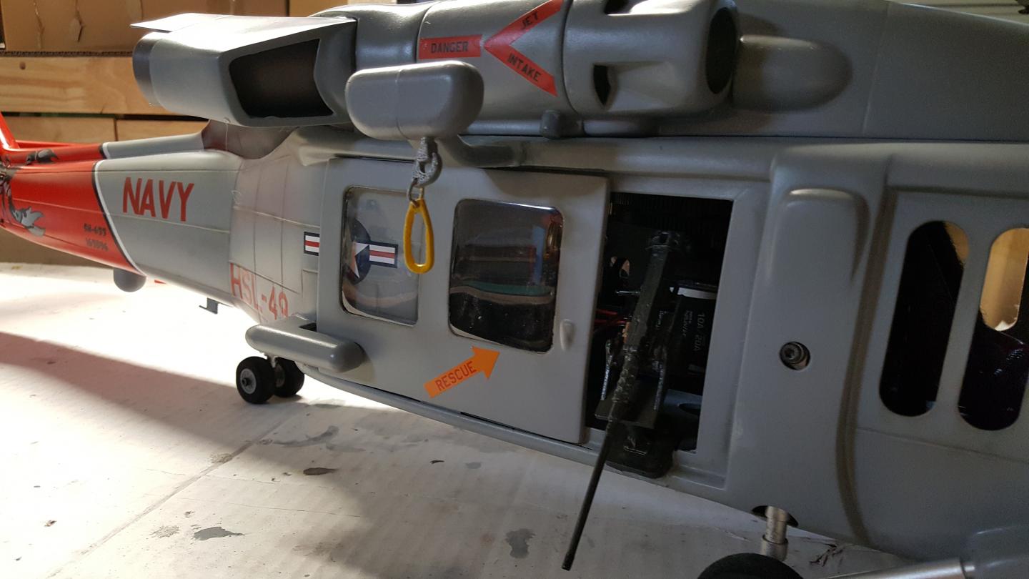

    eawings I like those GAU-16 .50 caliber MGs! They look slick!
    • #3

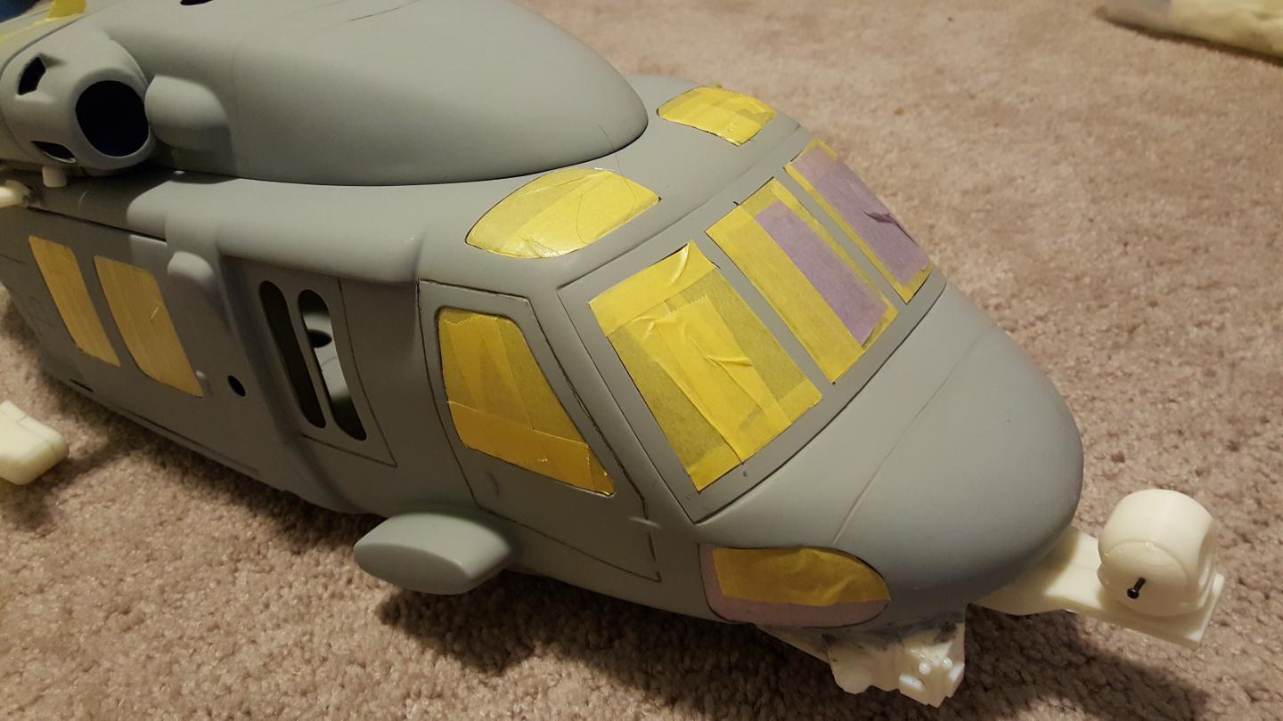

      Thanks Alpha.
      I forgot to mention these are scale 3D printed Kits I got from Fine-scale modela. I have requested Mr. herlambang to make this design prototype for me and is available on his website. No one here offers this intricate 3D print but him.

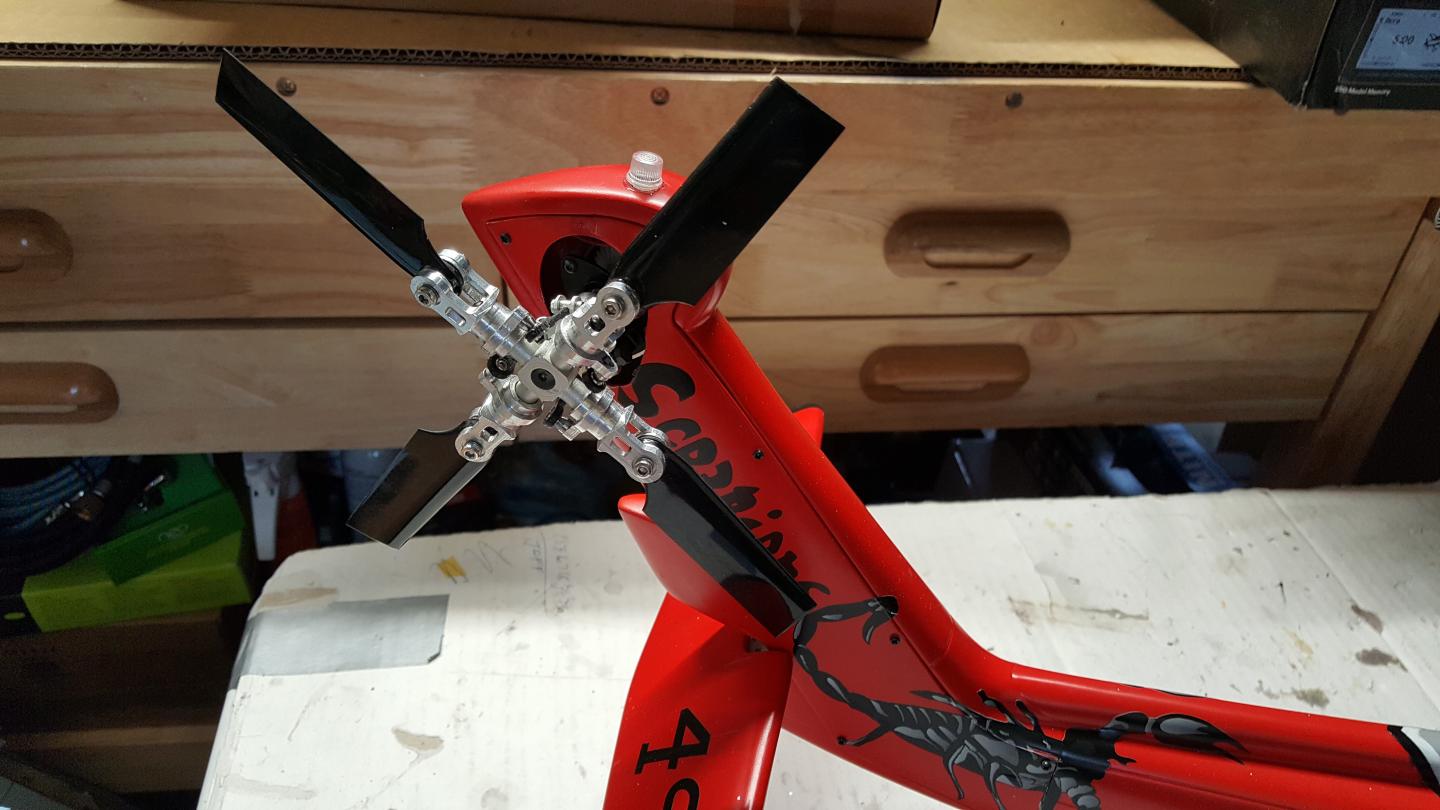

          where did you get this 4 Blade Tail Rotor Assy (CNC) and how much ?
          • #6
            Our stocks at Motion RC for these 500 size 4-5 Blade will arrive within 2 month time frame. I dont have the pricing of these Main Heads presently. Please check back with us.

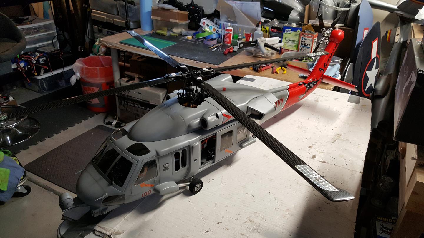

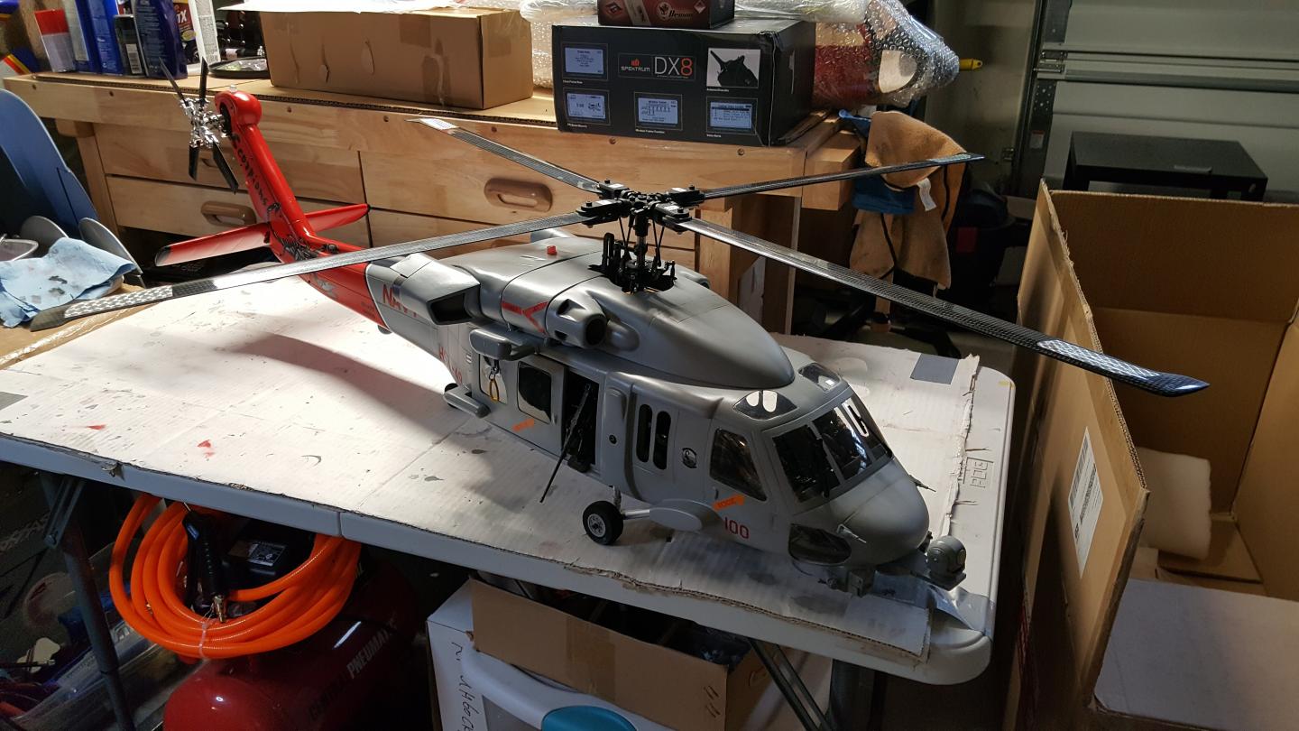

              Here is a finish product my SH-60 Scorpion. Totally rock solid hover using the Bavarian Demon 3X.
              • #8
                Looks great, awesome work Ed!
                • #9
                  Thanks Alex.

                          Can anyone tell me where to source the 4 blade tail rotor? Thanks, Rob
                          • #14
                            The only 500 size 4 blade tail rotor out there is from PKM Hobby. You can contact them through their facebook page.
                            • #15
                              What size tail rotor blades did you use? I have 73mm and 76mm to try. Thanks
                              • #16
                                This Tail rotor I used is not longer in production. It is a 500 size tail rotor. However you can purchased the 4 blade from this link -
                                • #17
                                  Same one I ordered from eBay for my UH60. Haven't mounted it yet. Hoping it all works fine. Also trying to figure out what size tail blade size to use (76mm) or ??? Thanks
                                  • #18
                                    You can use the Trex 500 carbon tail blades.
