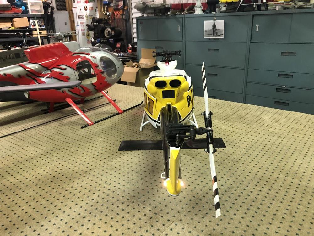

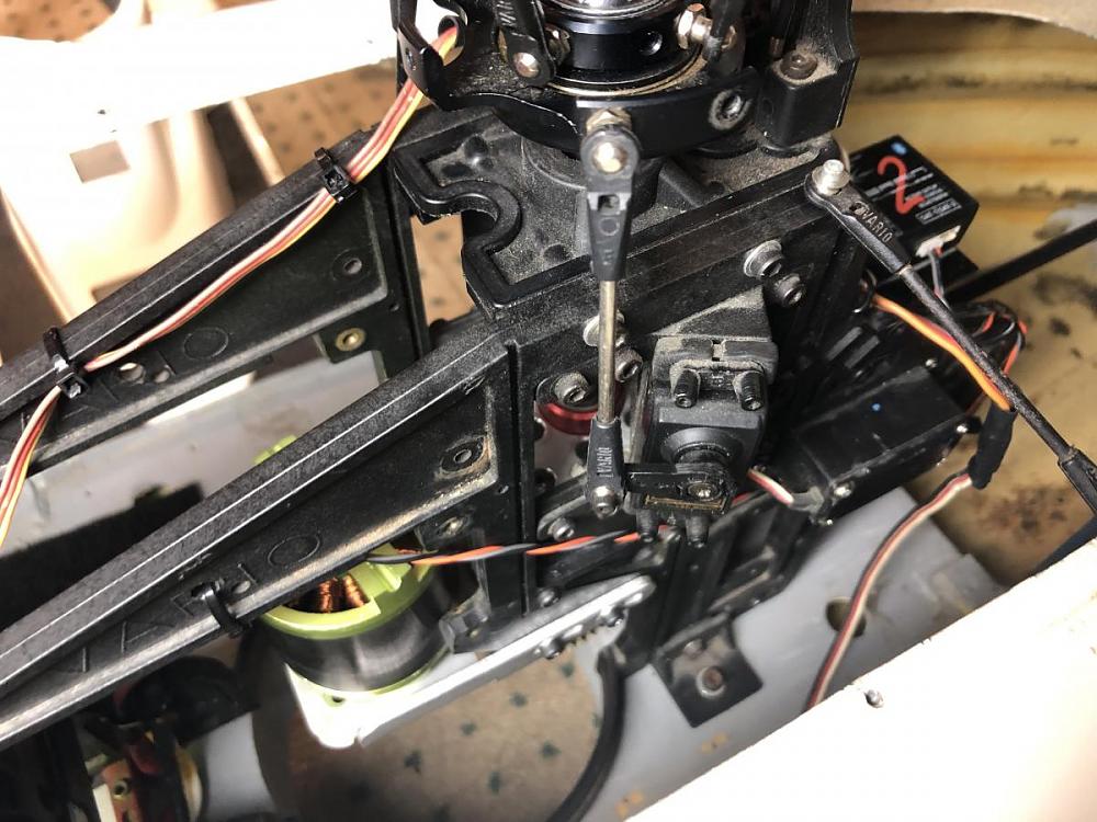

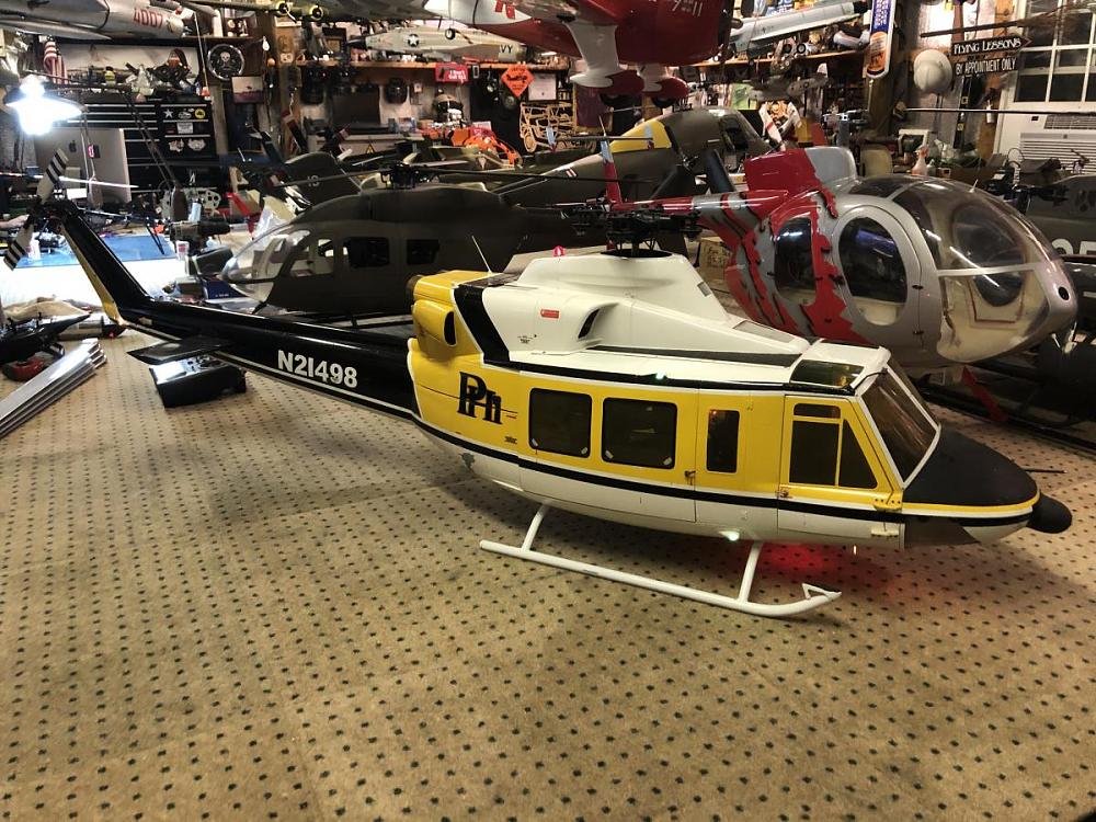

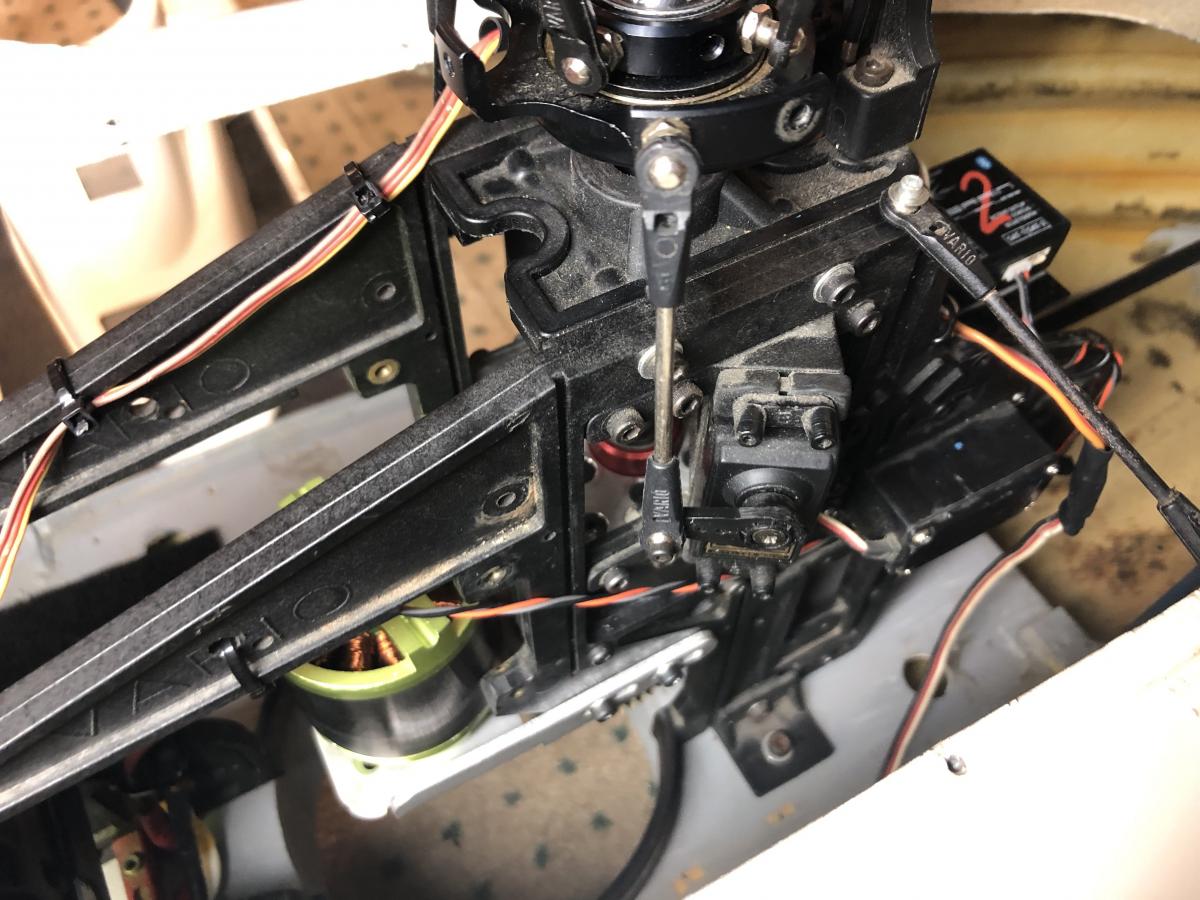

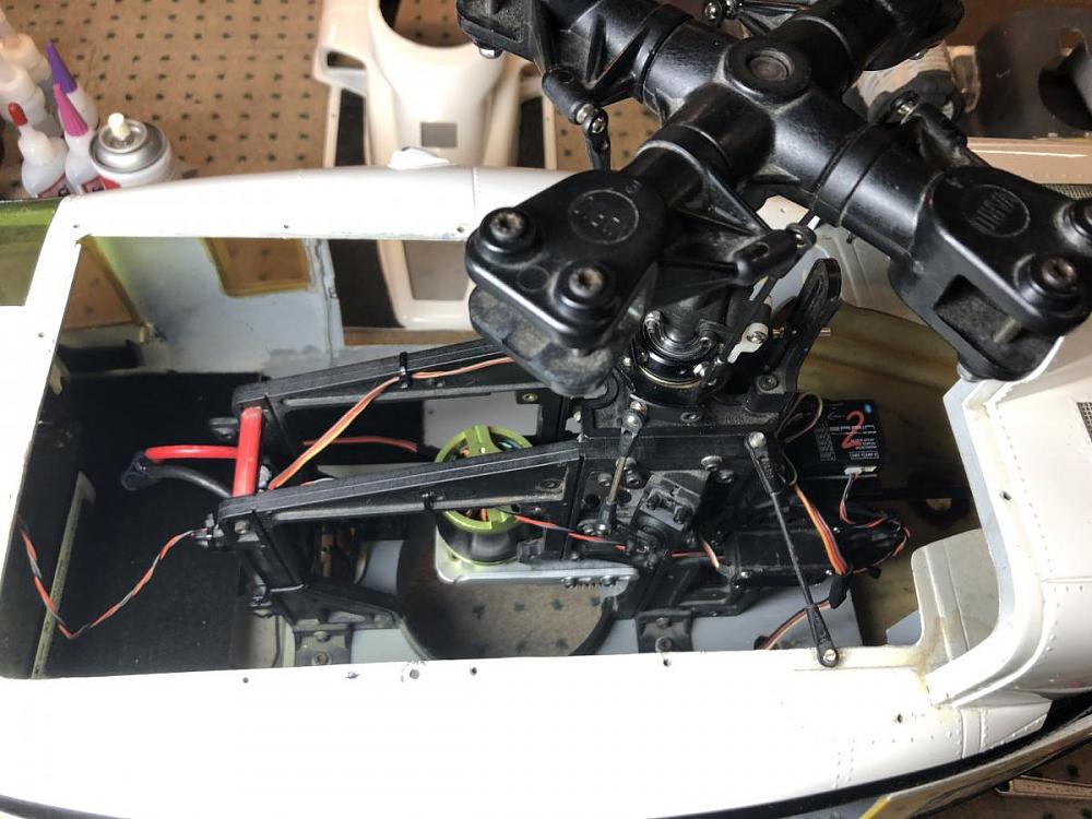

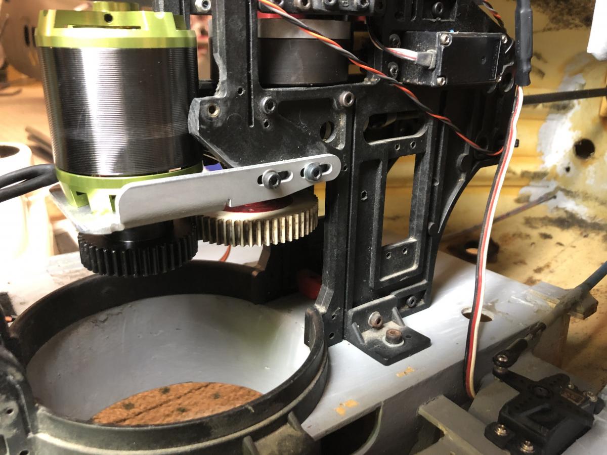

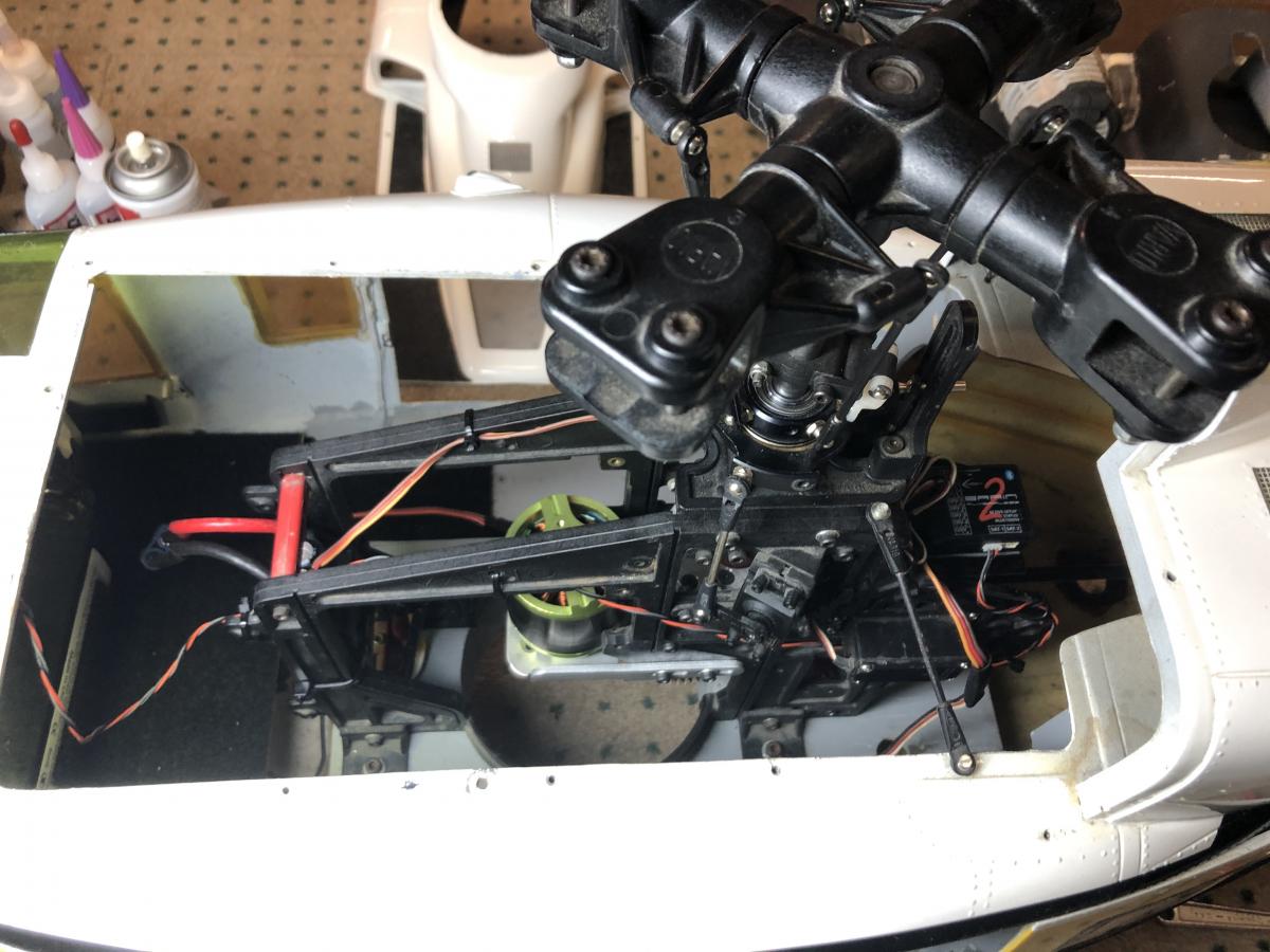

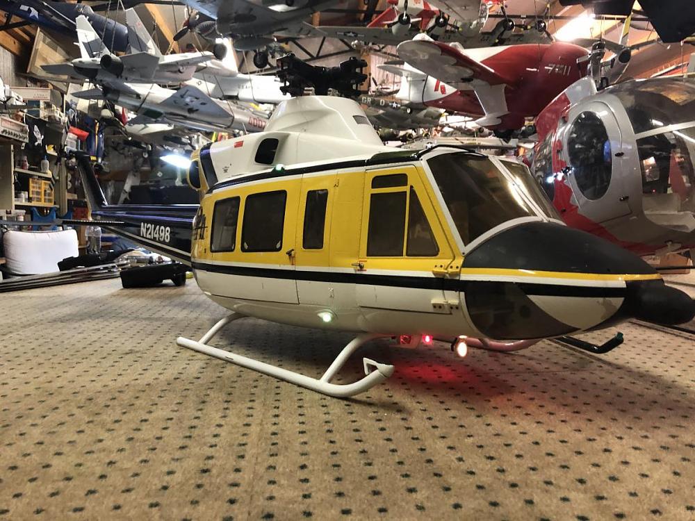

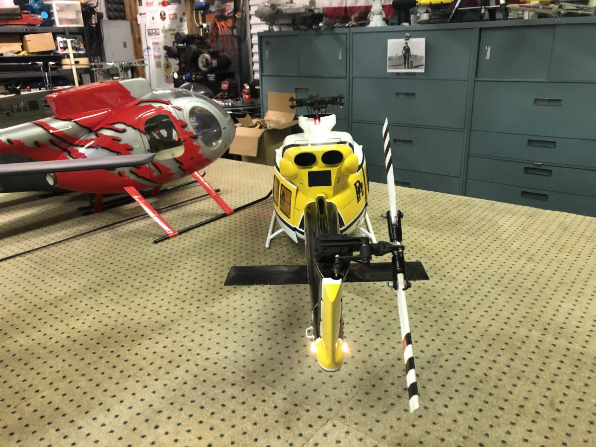

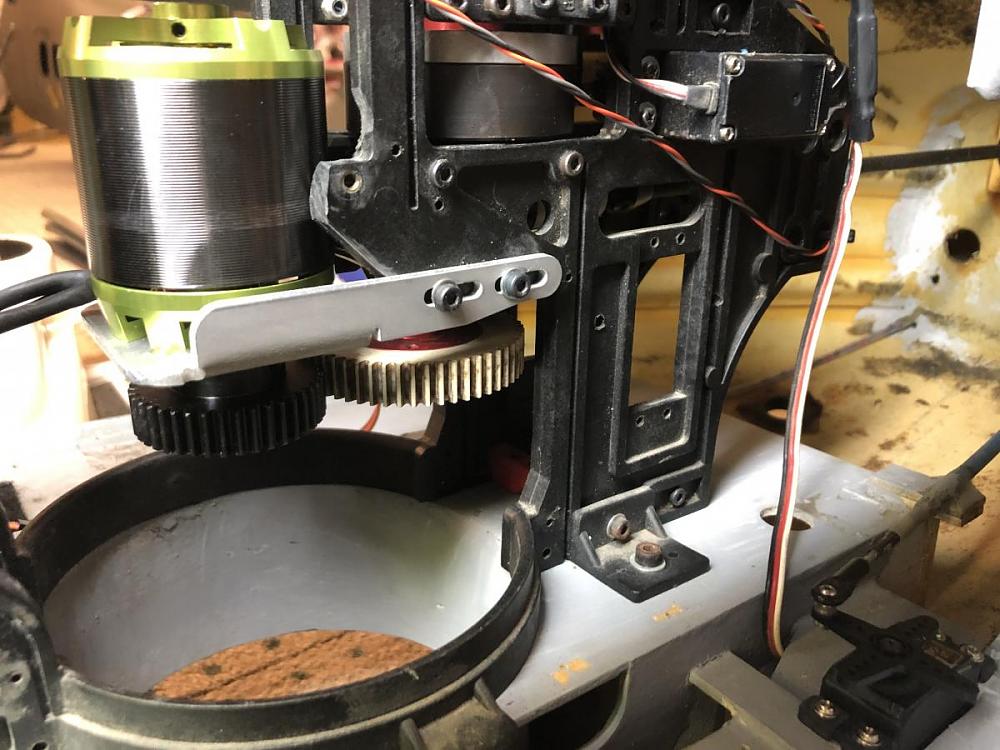

    I picked this up at the Southern Scale Challenge back in September and have been piecing together parts to convert it to an electric gear driven setup. I finished it up today, I used a Tacon Bigfoot 60 (400kv) motor I picked up for a FMS 1700 Mustang I never used, a Castle Ice 100A ESC, Brain2 BT flybarless controller and 6S 6000 mAh Graphene battery.
    This Heli was build several years ago by Paul Hudd in Texas, I just revived it😎

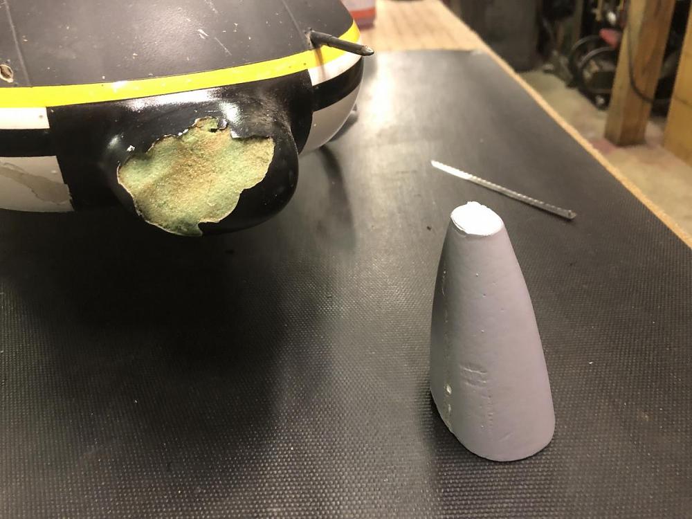

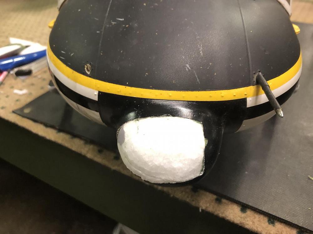

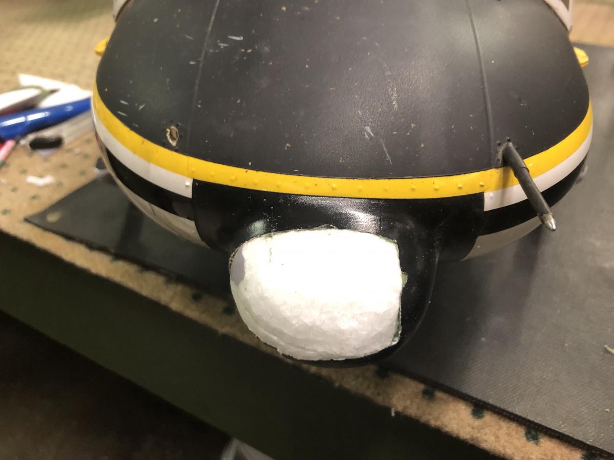

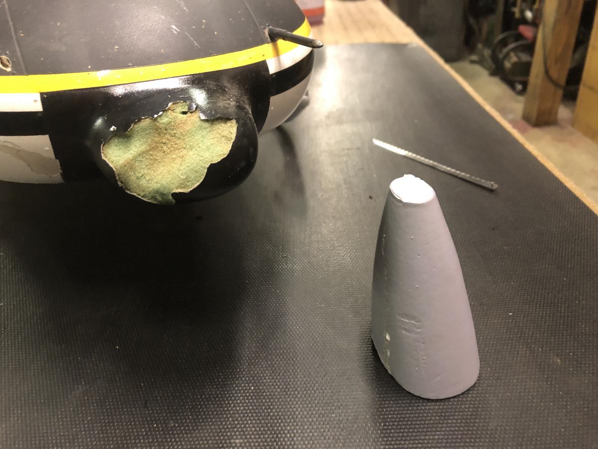

    It had been flown through a tree before I got it and had a big chunk torn off the nose.
    Click image for larger version  Name:	Chunk_01.jpg Views:	0 Size:	113.2 KB ID:	234095
    Click image for larger version  Name:	Chunk_02.jpg Views:	0 Size:	82.3 KB ID:	234092

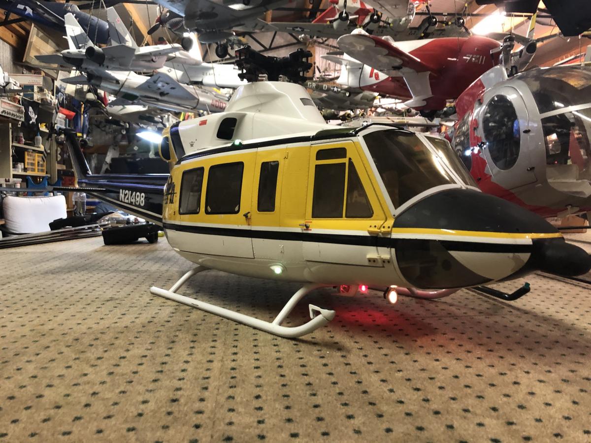

    Good to see that 412 getting some love again. I saw it fly I believe back in 2002 when Dave McGirt owned it
    • #3
      Finally got a break in the rain and got a test hover in...
