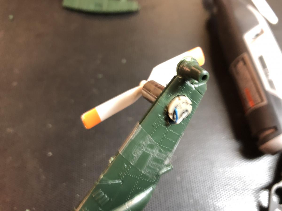

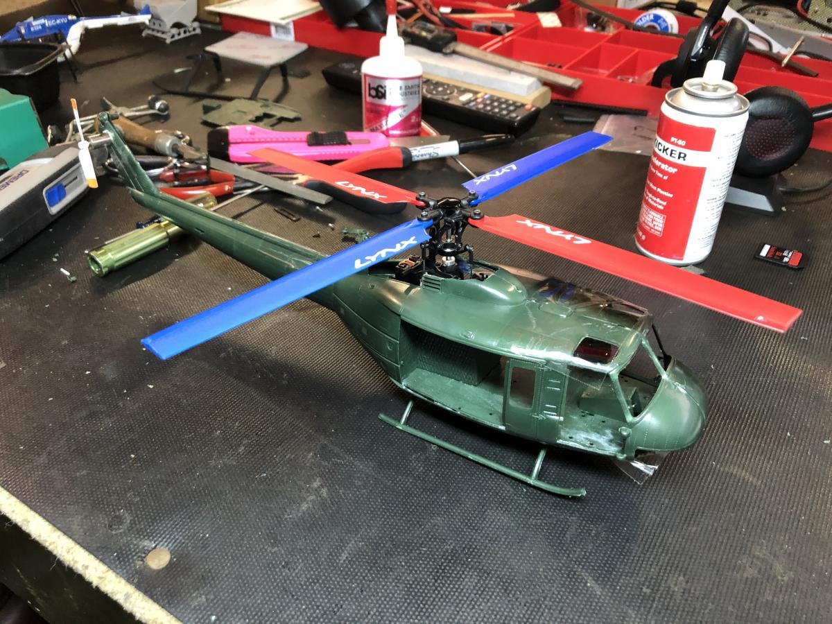

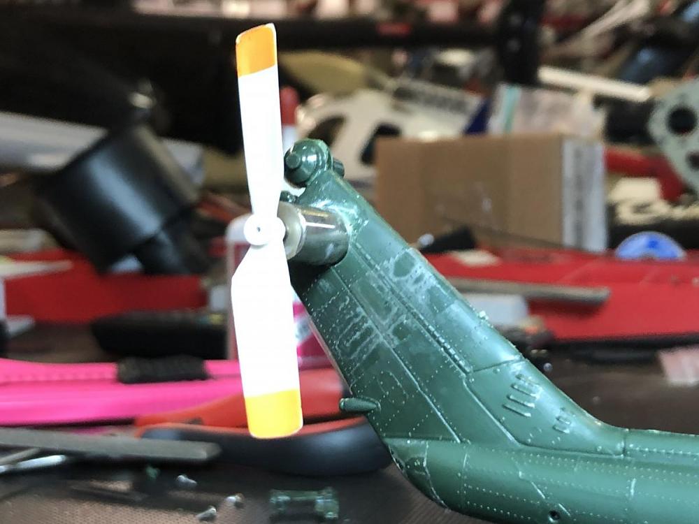

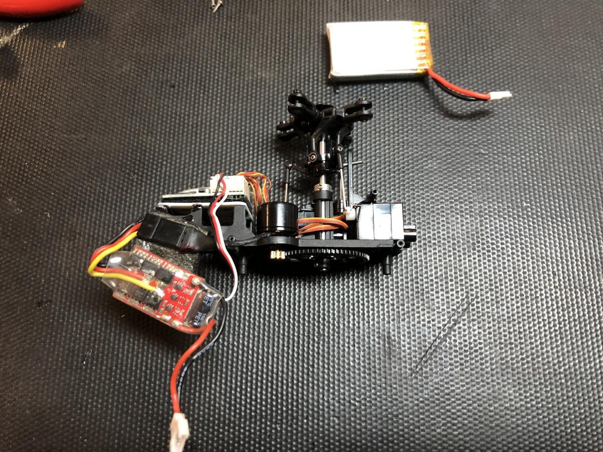

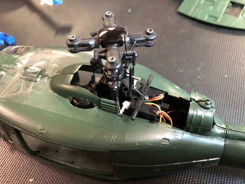

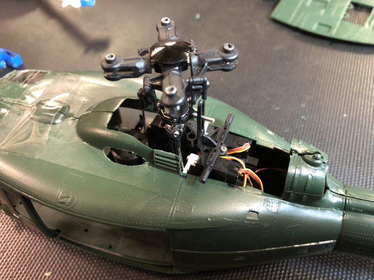

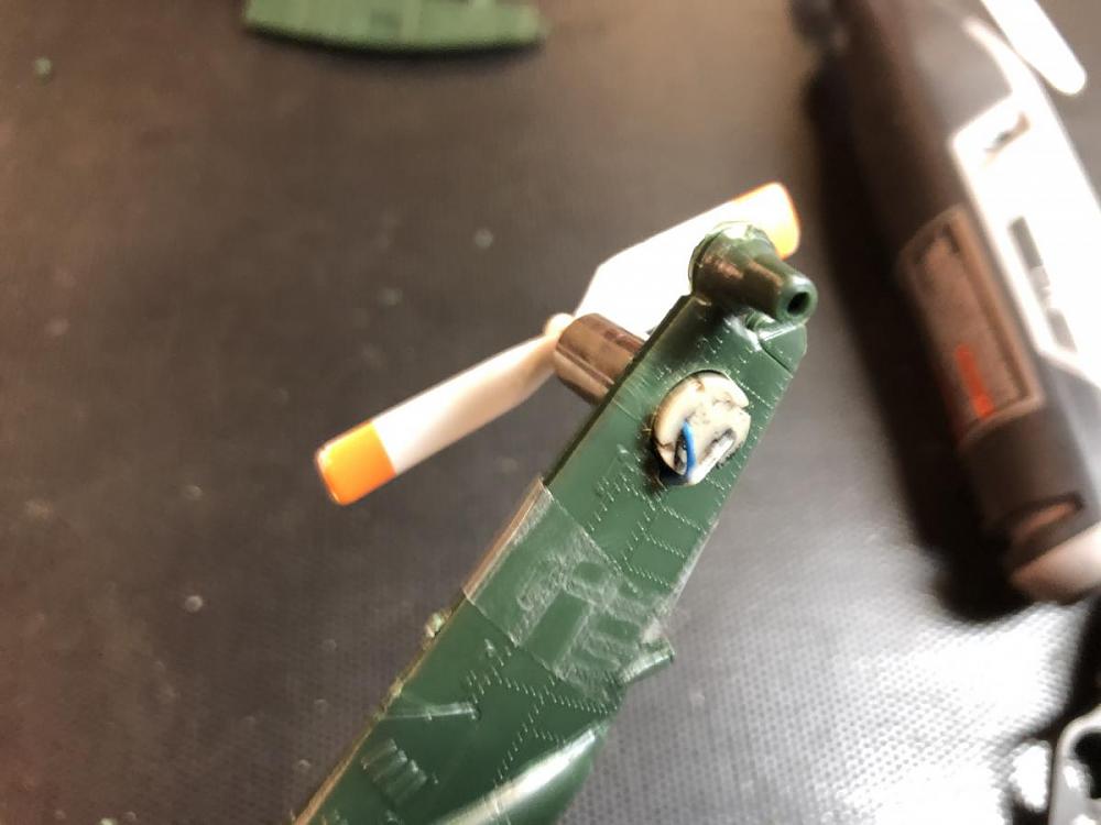

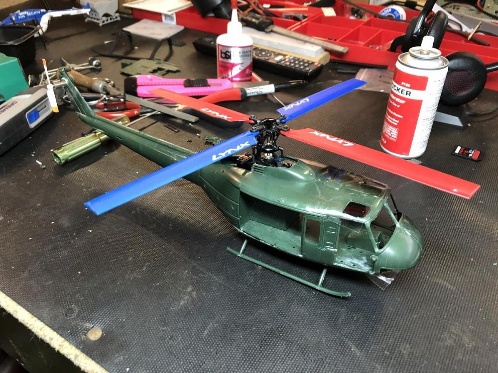

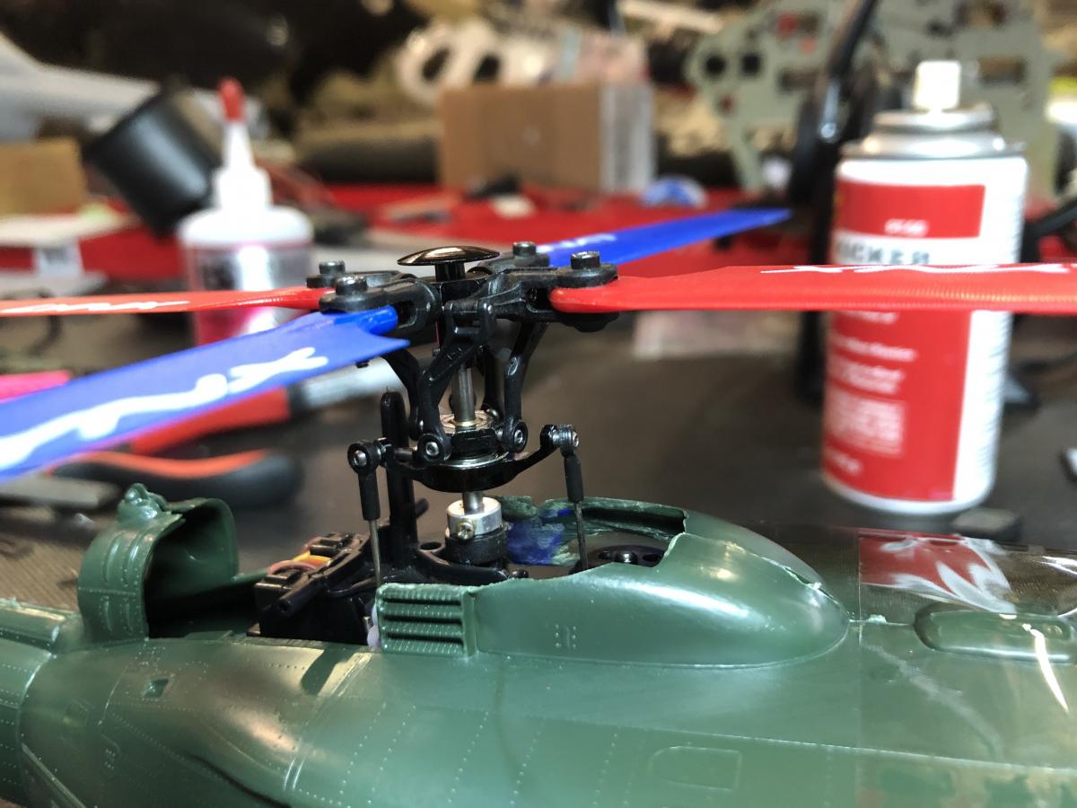

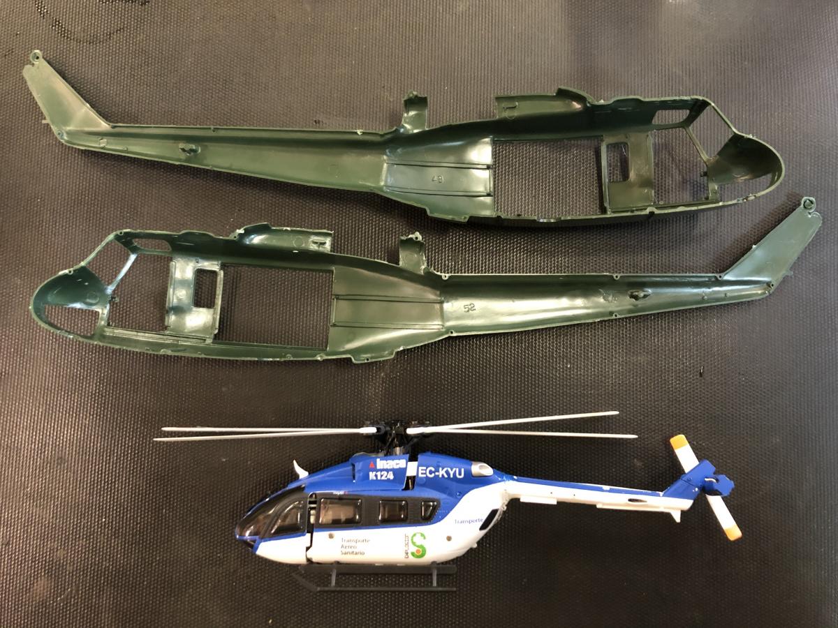

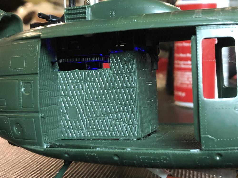

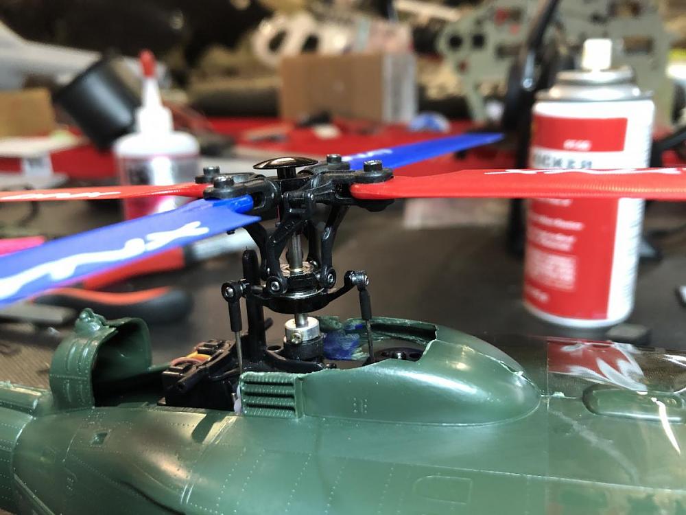

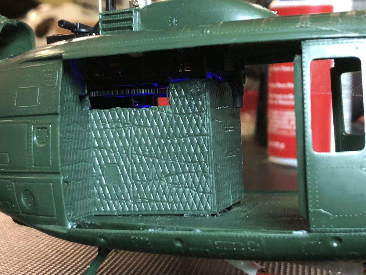

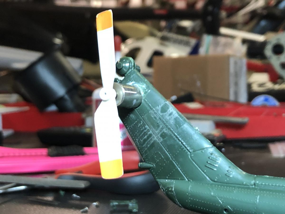

    I really beat my little XK K124 (EC-145) up pretty good, I basically learned how to fly with it so after breaking the boom off 5 or 6 times and replacing the swash once I decided it needed an upgrade. I used a 1:32 Monogram model and it’s turning out great. I cut the front part of the frame off and moved the electronics under the mainshaft inside the diamond pleat padded section and mounted the battery underneath the cockpit. The fuselage left half is only taped on until I'm happy with the setup.
