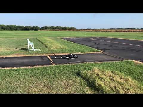

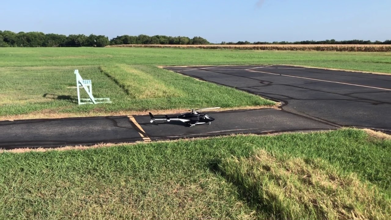

    I just finished installing the Airwolf fuse on my 600DFC. It was fairly simple and not major modification needed. I did have to set up the retracts with one single servo, that was the hardest thing to rig because I also needed the room to be able to slide the 12s packs. To achieve the proper height for the mechanics, the extra servo mounting box was perfect. Used it for the front of the mechanics and stacked the spacer for the back.
    This was the maiden flight, mechanics have been flown plenty of times and will need to readjust pitch/throttle curve, is set up for +/- 13 and the only thing I did for the maiden was reduced the head speed.
