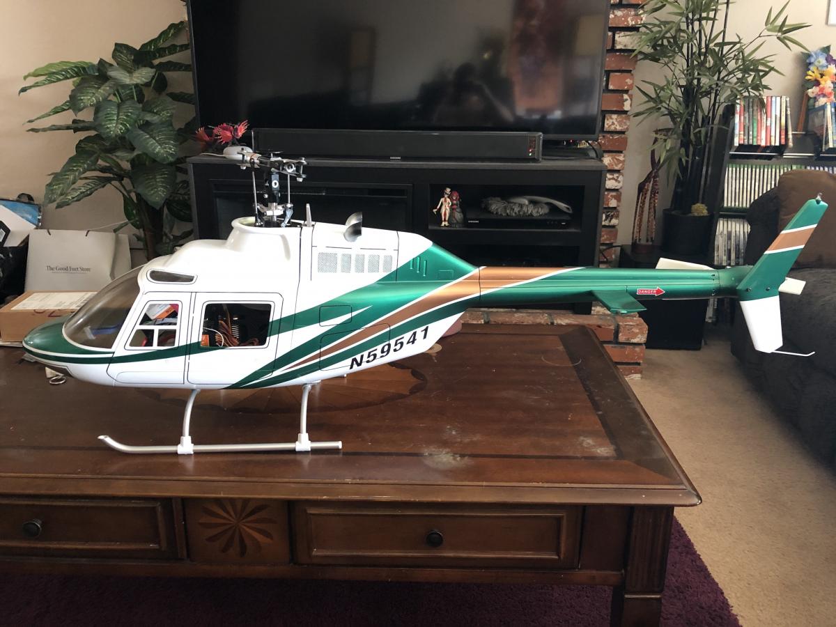

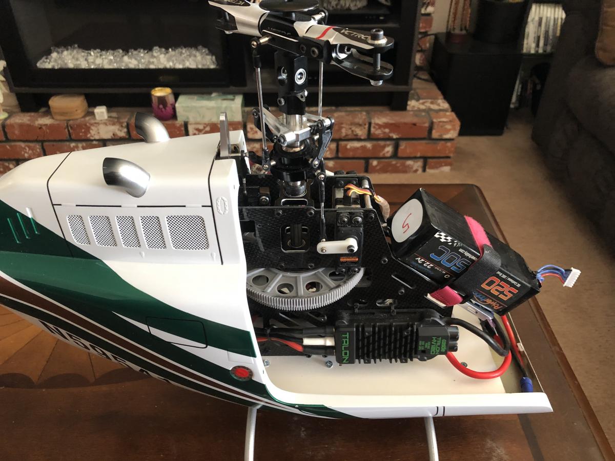

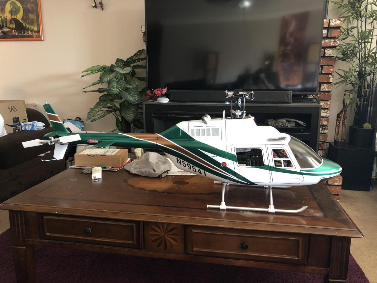

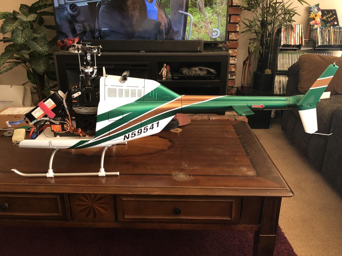

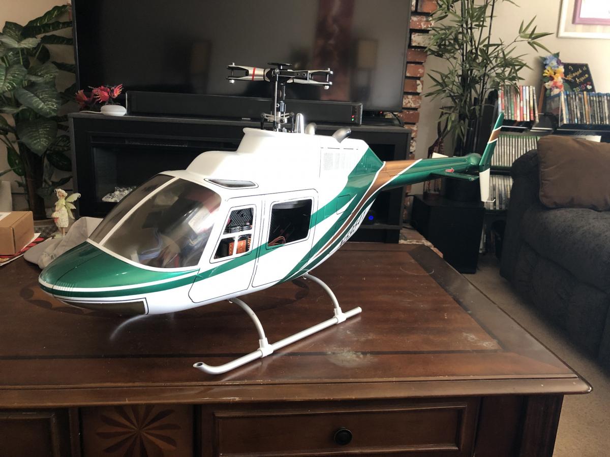

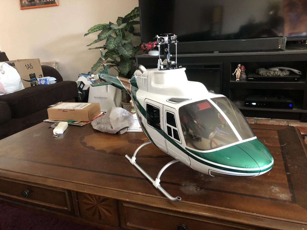

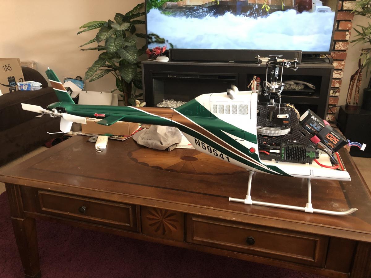

    Well I just finished it up. Tomorrow will be the maiden with the fuse. I have flown the 550 a few times.
    it’s a jet tech Bell 206. The body is super clean. I’ve been working on this for about 2 months waiting for parts and such.

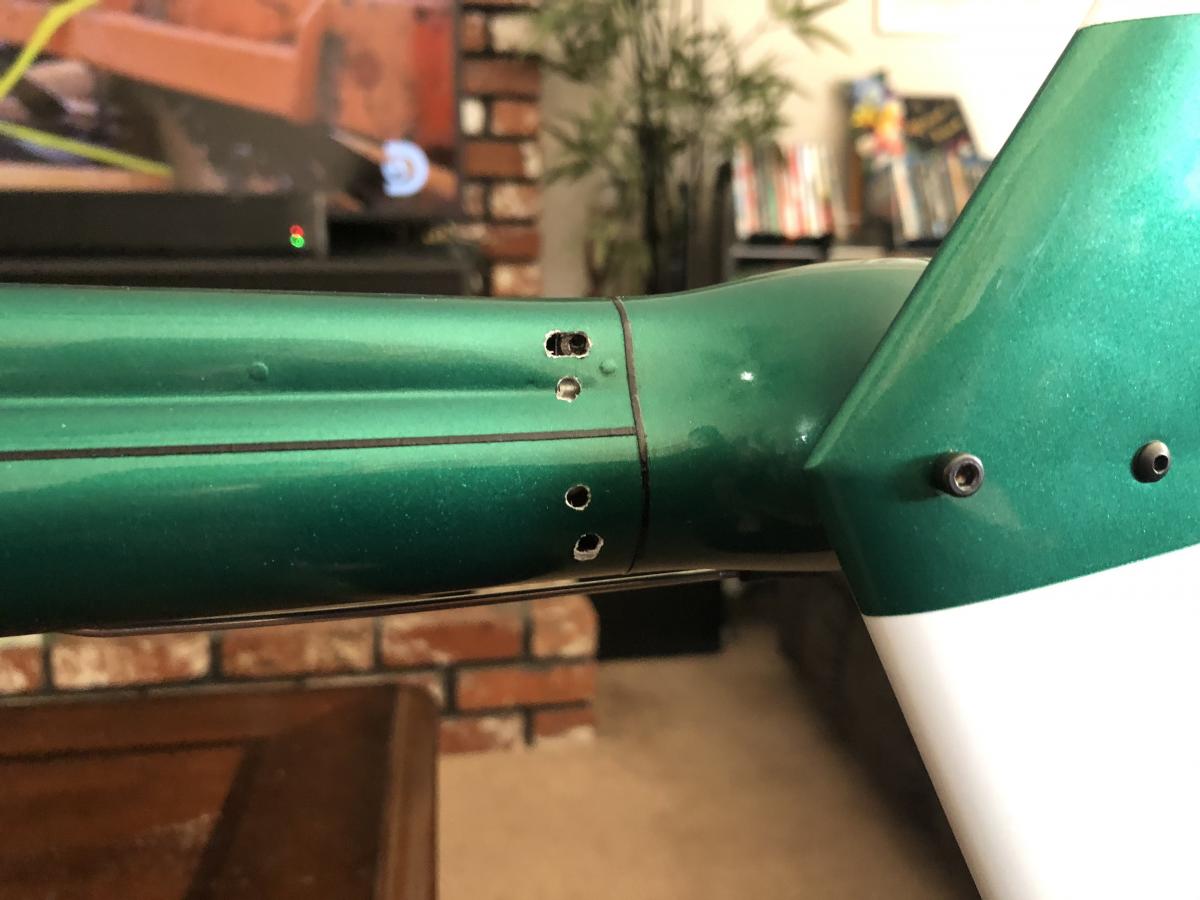

    i do have some patch work to do on the tail. I followed the instruction on where to drill the holes. That was my mistake. I should have measured to tail set mount screw holes and used that measurement.
    after I fly it tomorrow, I’ll patch it and try to color match the green.
    gravy

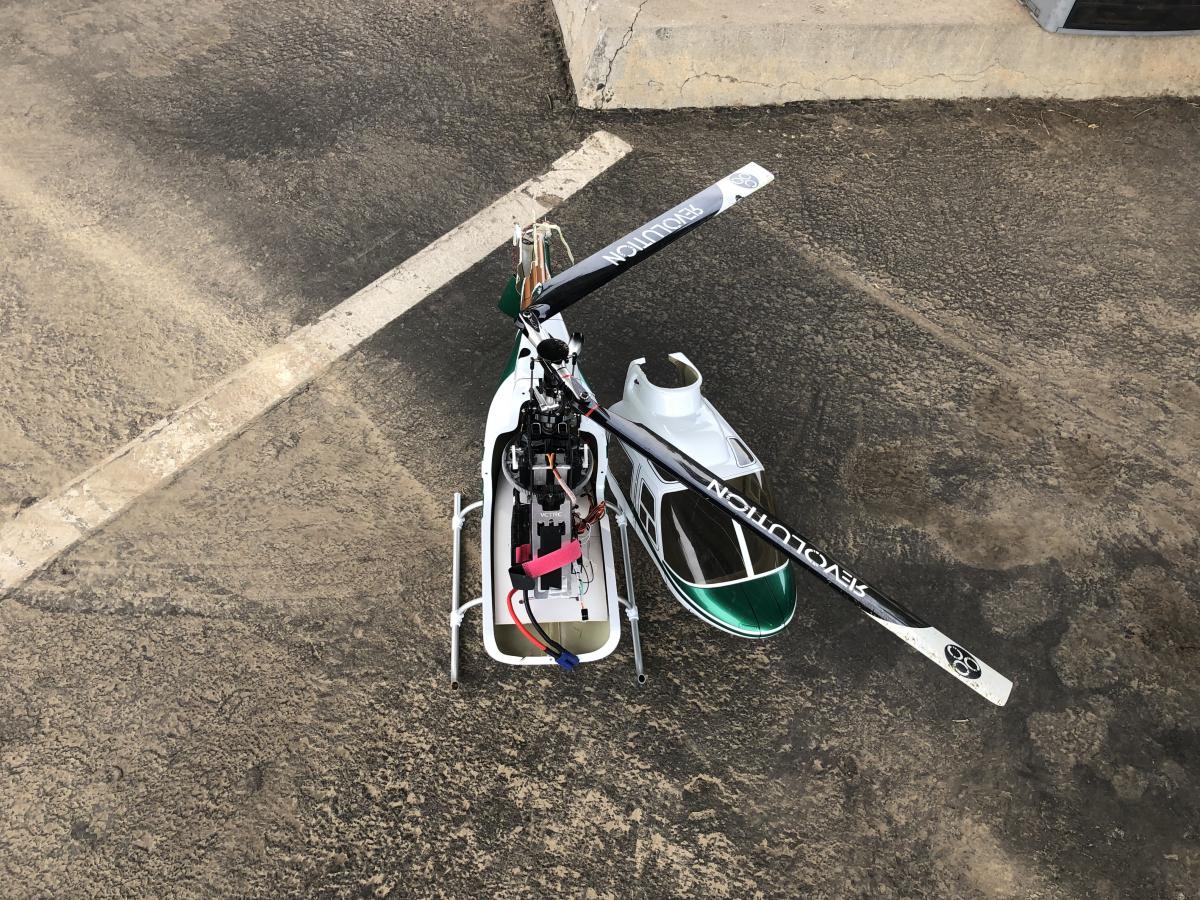

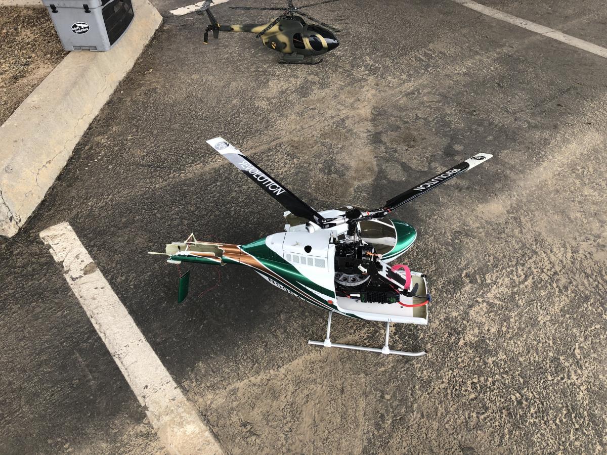

            Well after weeks of building, testing and adjusting, today was the day to fly her. I was happy with the test hovers this last week.
            First pack was a hover shack down. Ended up having to add high torque compensation to keep the tail straight on punch outs. Also ended up with a little high setting for gyro on heading hold than most of my other helicopters. But I was confident with it after the first pack.
            second pack was flight time. Spooled her up and got into a nice comfortable hover. Things felt good. So away we went. She felt and flew good. Had a great 4 minute flight. About half way through the hand shakes were gone.
            then it was as time to bring her in. Came out of a nice easy left bank / turn and started to back off collective. She did not drop much so I ended up about 8’ off the deck when I fleered. And that’s when it happed. Lost all tail control. It was over before it started, yep that fast.
            two heli wrecks in to week.
            not sure what happened exactly, but I know the tail was the bane of my issues over the last two week. So something wasn’t just right from the get, I just never caught it.
            Gravy

                  Probably hard to tell... looks like the whole tail section broke off... but any stripped gears? Any screws missing? What headspeed were you running?
                        no missing screws, all gears except auto rotation gear had stripped teeth. Only servo the I thought was stripped was left side awash. But it ended up being the servo horn that was stripped.
                        when it hit, it hit hard. Boom is like a pretzel. Only thing that might be a smoking gun, is the tail rod ball connectors. The rod was pulled out of them and inside threads completely stripped. However that could have happened during the crash and not before.
                        head speed was around 1900 rpms.
                        i had a great 5 minute flight, tail was locked in, no porpoise with collective adj up and down during level forward flight. Turns felt smooth and controllable. Like I had said it felt so good about it my maiden hand shakes where gone the last minute or so of flight.
                        it just all went to crap when i fleered to land.
                        now my fleer is me normal fleer style. Come in at about 10-15 mph, pull back and kick nose to right and roll to the right, then level off to point away from me whil in front of me. So a hard stop with a twist. So maybe the torque on the tail stripped the rod out of the ball link. And that caused it. I did have the end points mapped in the FC so the servo should have stopped before over torquing. Maybe it was just the load torque.
                        I’ll never really know I guess.
                        Gravy
