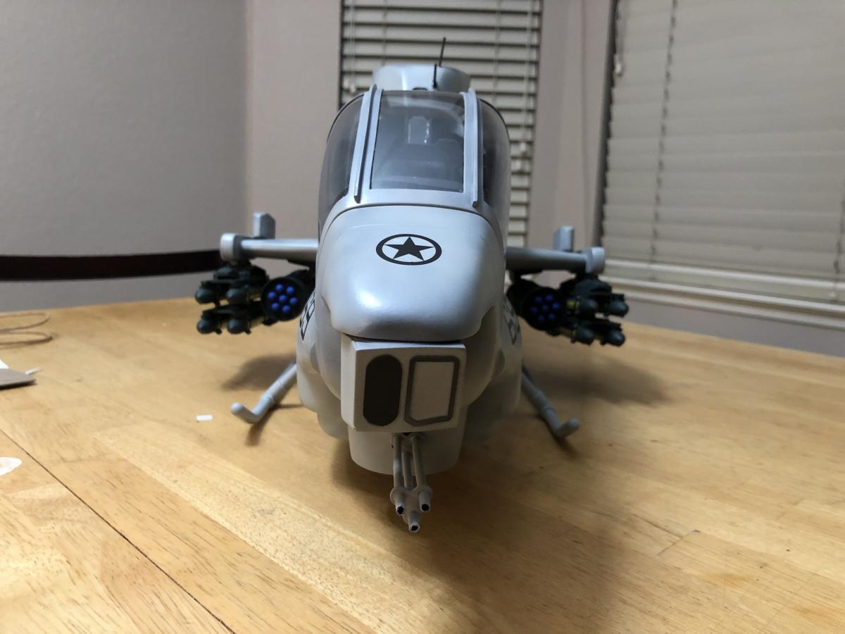

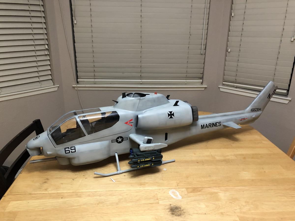

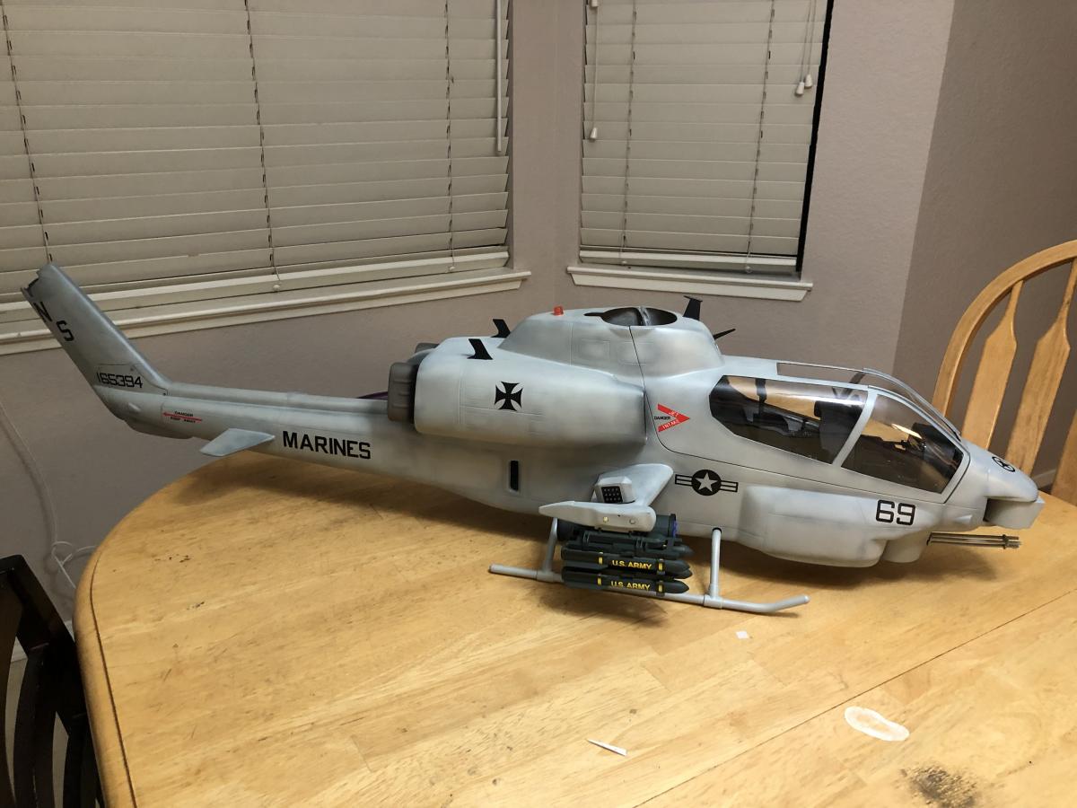

    Almost done with my 500 AH-1Wx. I know it’s not scale but I was going to modify it to a Z but with everything else going on and only have 1 of 7 helicopters fly right now due to maintenance and repairs, so I’m keeping it simple. I already had the 4 blade head and tail rotor, So I’m going with this was the 4 blade head AH-1W experimental before the Z model.
    anyway it’s all painted up and sealed so I should be able to stuff the heli in her this weekend and maybe fly her. I really am liking this size over my 700 Apache.

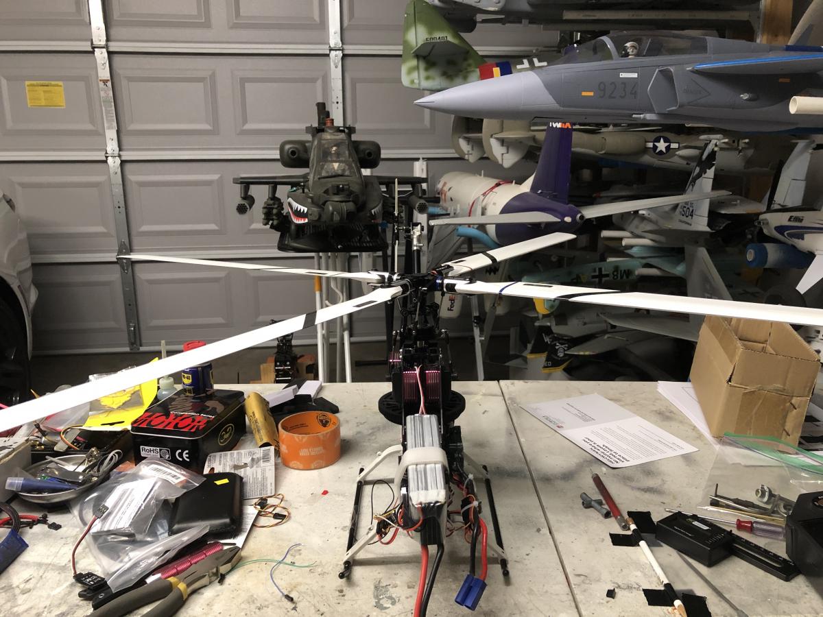

      install of mechanics was a PITA. I have some damage to repair. Insertion with the bottom half of the tail riser does not really fit and ended up causing all kinds of crack damage. On the bottom of theAH-1 boom. Then the access plate on the tail to get to and attach the rest of the tail riser is no big enough to get the job done with out a lot of cussing and tweaking and more damage. I’m almost done. But I am so done with these damn builds. It seam like none of them go together like they are supposed to. Now I understand why DCORSAIR like the MD-500’s so much. Just straight forward install.
      I’ll post more when I’m done doing damage repair and touch up paint and ready to fly.

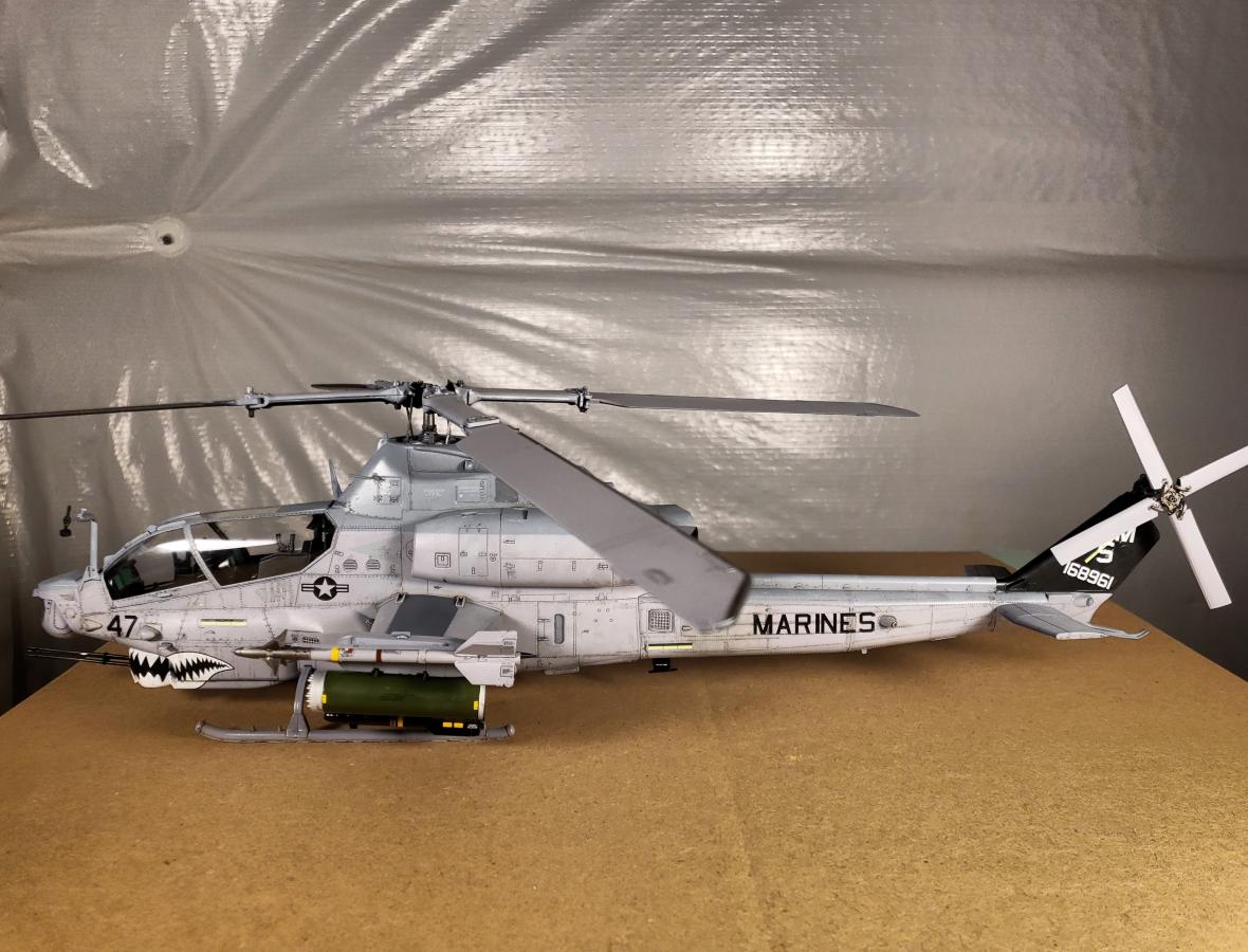

          well she flew. Just light stuff in the front yard. I will fix up the damage and she’s ready for a mission. I will never pull the mechanics out of it again. Ever. Never ever.
          she did look good in the air though.

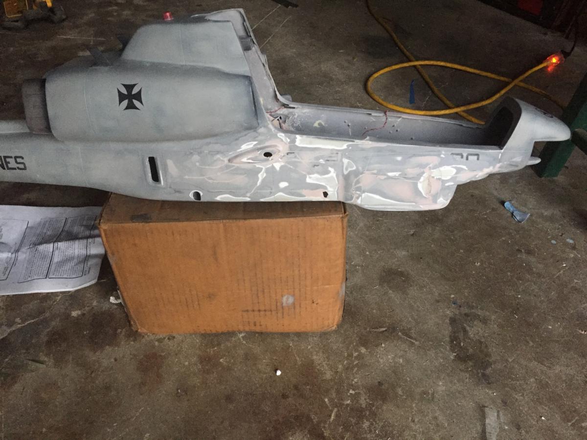

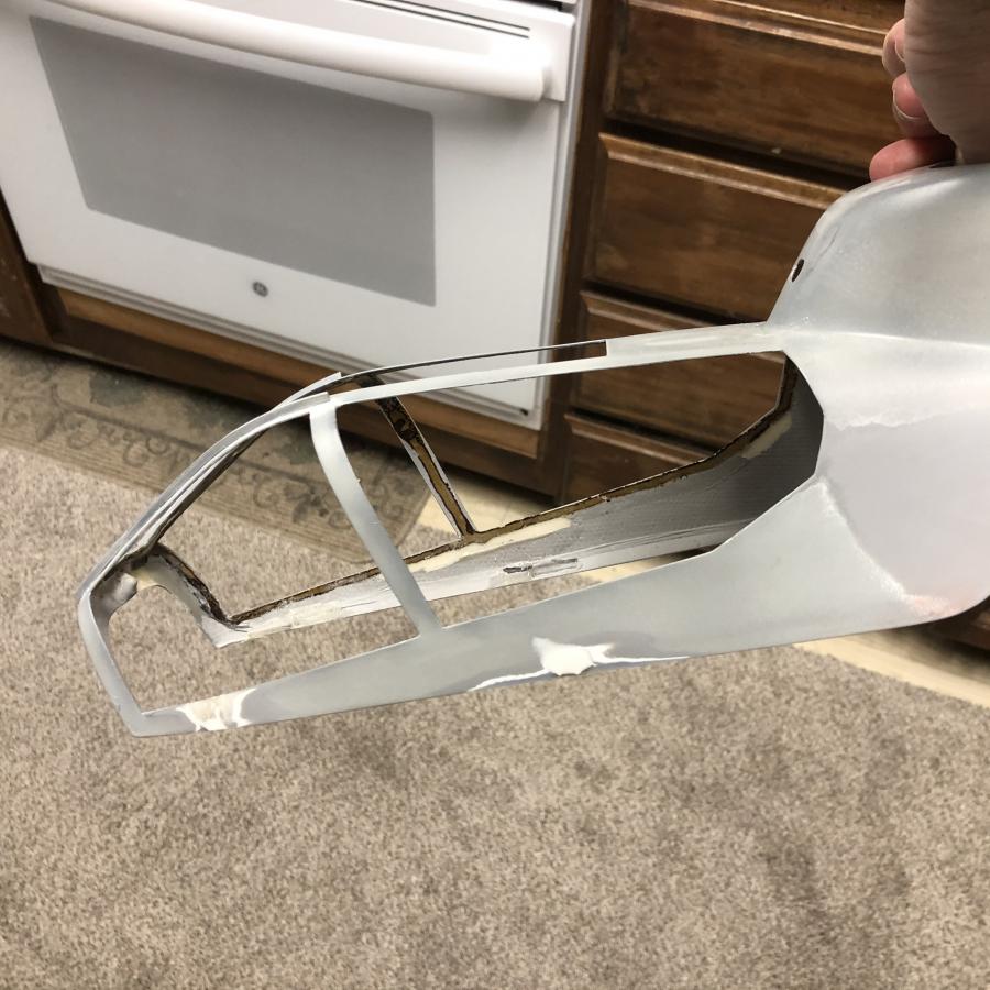

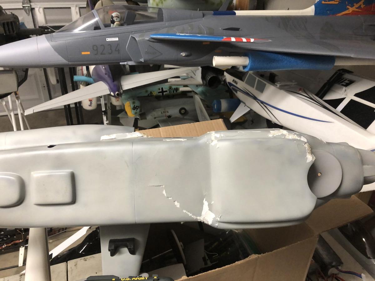

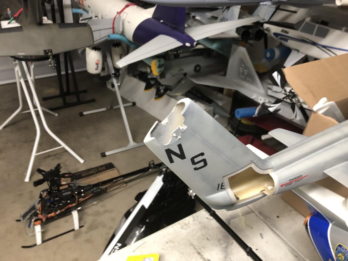

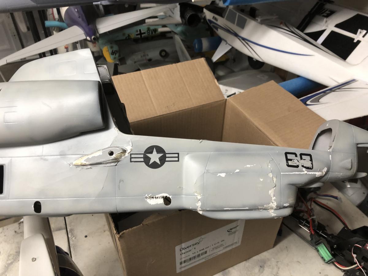

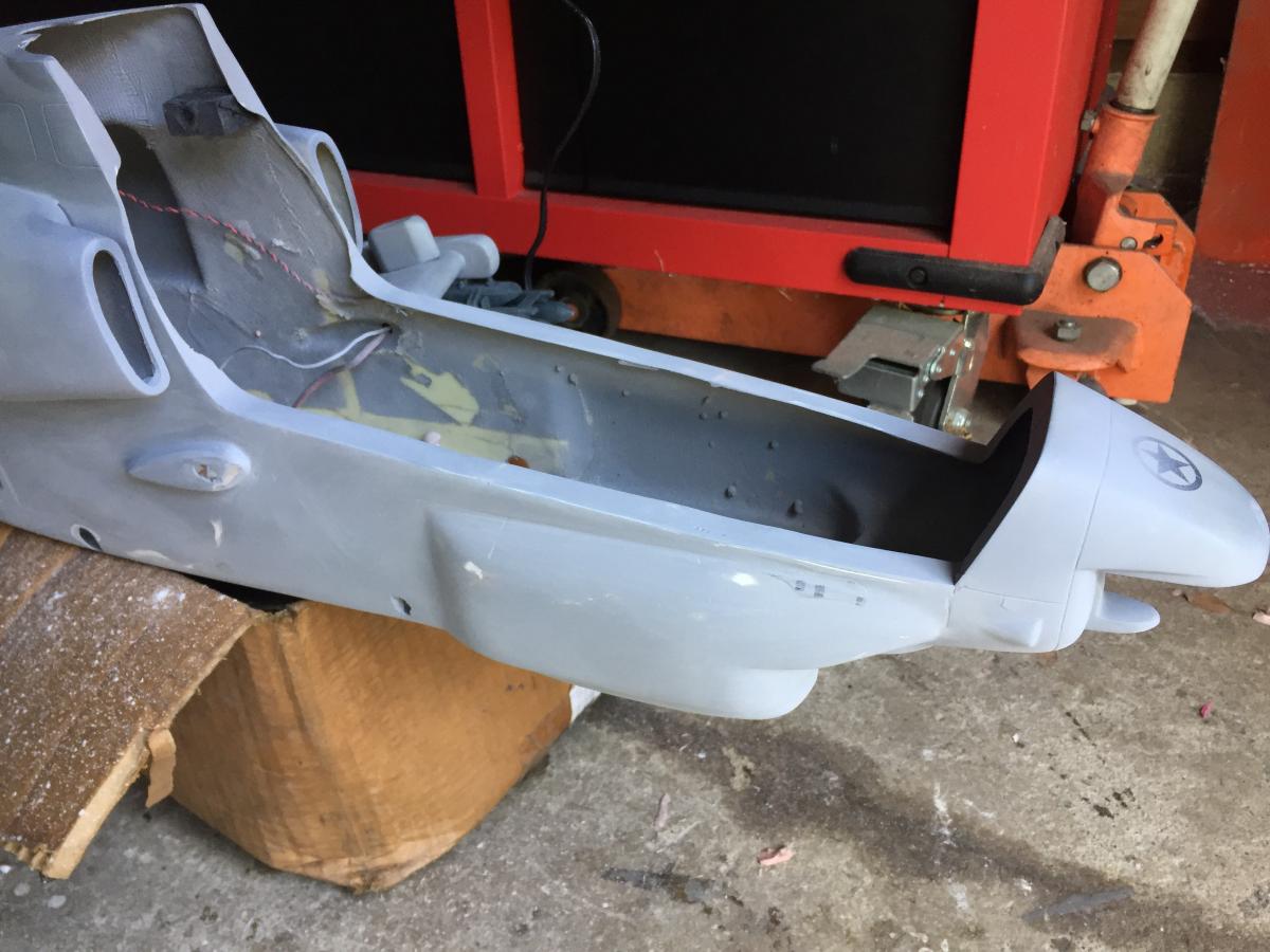

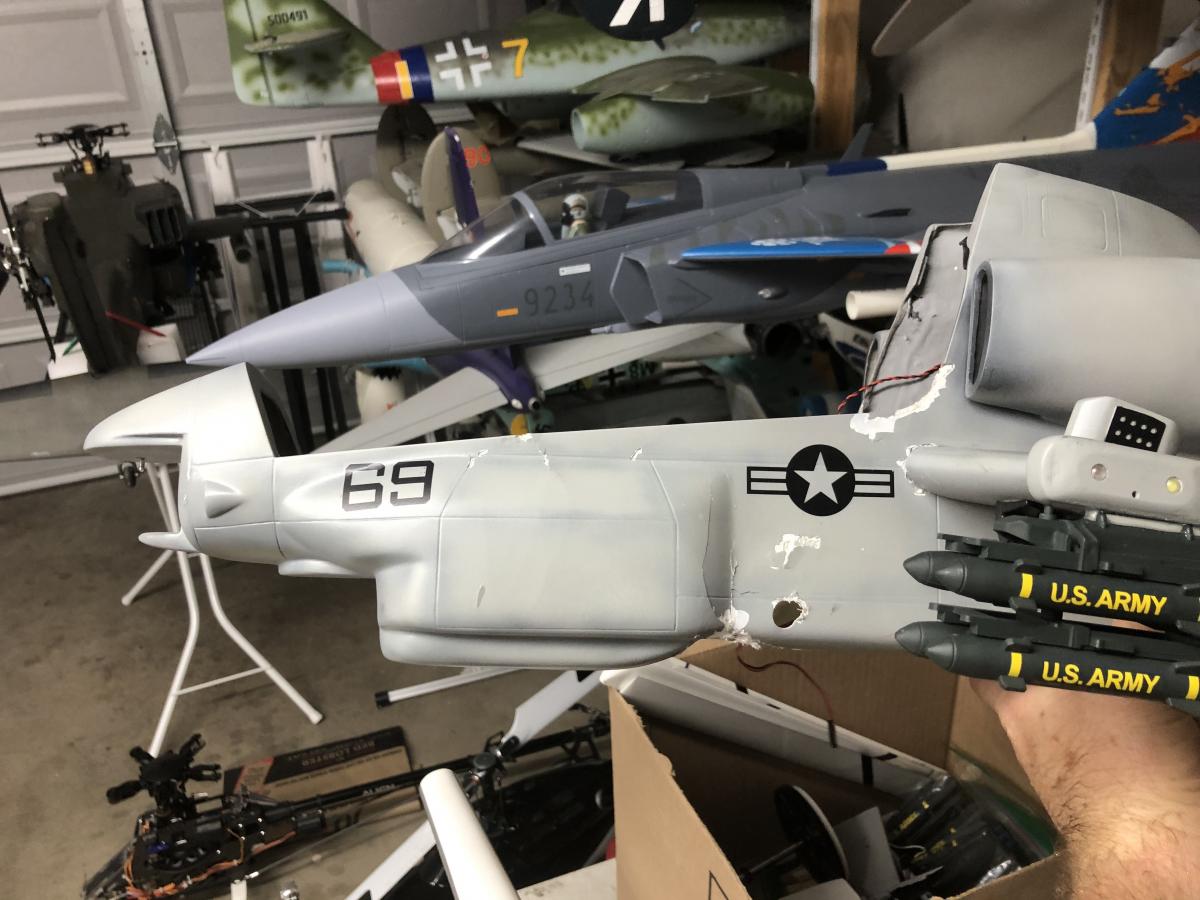

                                crashed her a couple weeks ago. She dropped out of the sky about 15-20’ high, while doing a slow flyby. She was for sure my best flying helicopter up to that point. Cause, no thread lock put on my washout arm bolts. In other words bad building attention.
                                I shelved it for a couple days then decided to take a look to see the damage. When I took a look finally I decided it could be fixed, but would need help from a friend that is good with FG.
                                Damage.
                                canopy glass cracked and missing pieces.
                                canopy cracked and damaged, too rails cam off.
                                fuselage front damaged with cuts, gouges and missing chunks.
                                gun turret damaged
                                right wing and weapons damaged.
                                right side skid mounts broken.
                                Inside wood frame and mounting plate broken off fuse.
                                front plastic mounting adapter broken.
                                most gears striped.
                                couple blades have a small chip missing.
                                Parts ordered.
                                Canopy windows
                                skid set, (won’t need)
                                Parts I had.
                                Replacement gears.
                                extra blades.

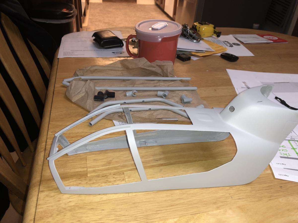

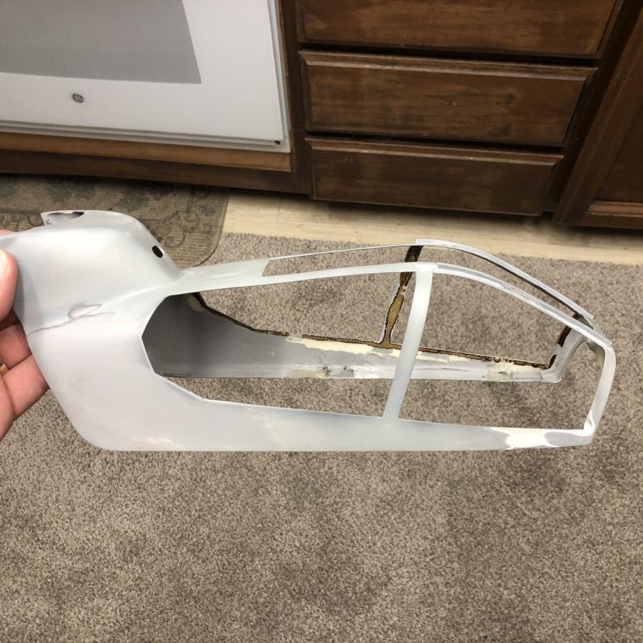

                                parts repaired.
                                canopy, I fixed this with some resin, glass cloth, plastic fill putty, sanding and super glue. It will get primer this week and it will look like it just came out of the box.

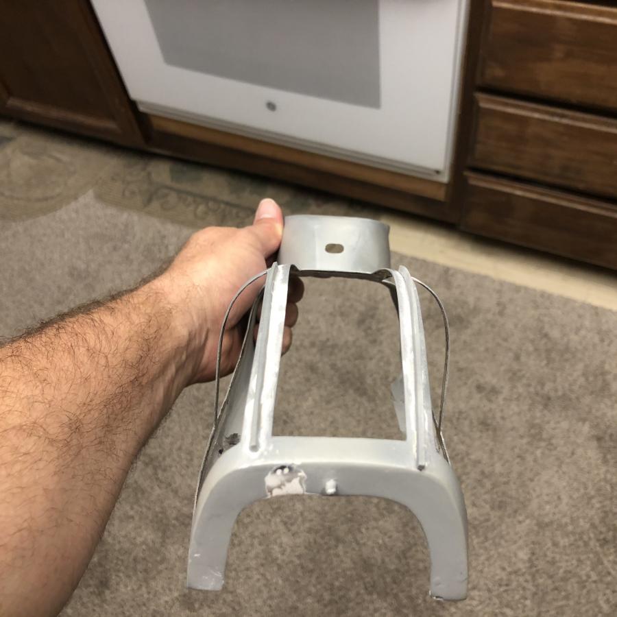

                                I 3D printed a new front mounting adapter and skid mounts on my resin printer.

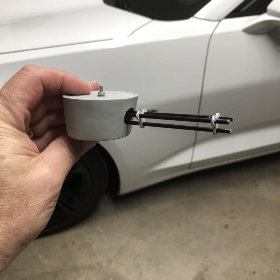

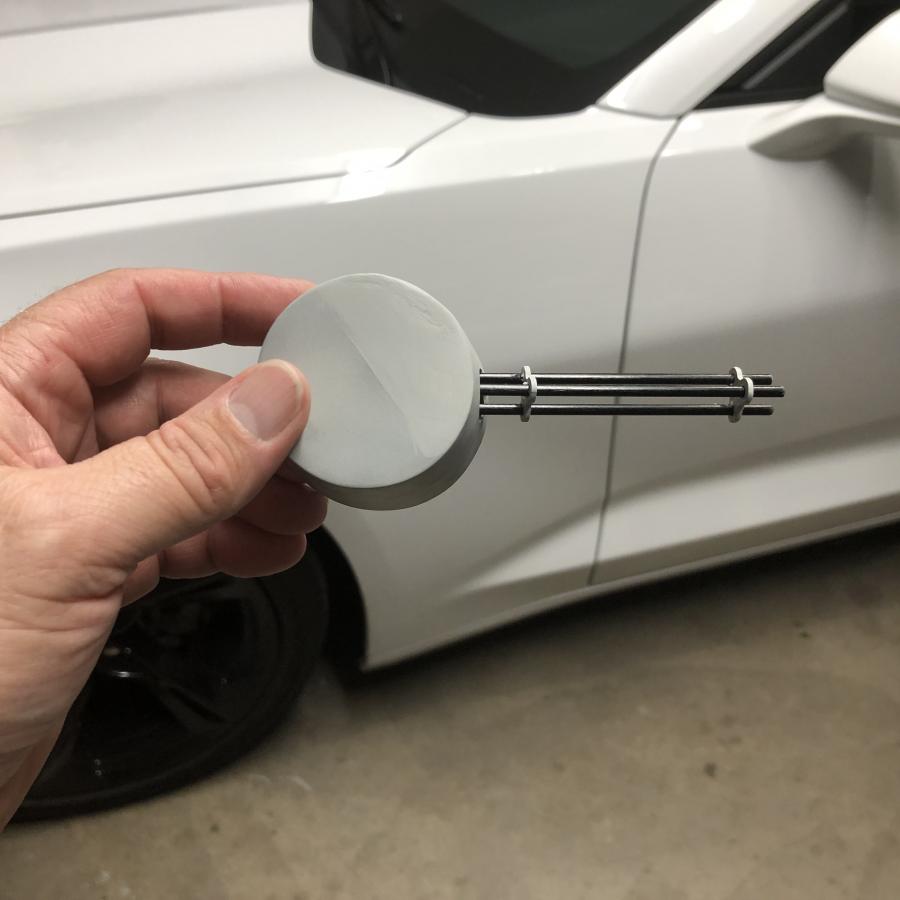

                                I repaired the gun turret and used CF tubing. Looks new and stronger too.

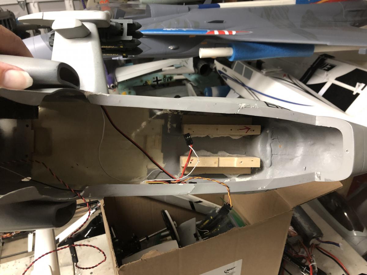

                                fuselage is almost done and from pics looks good. I will have some things to do to it when I get it back, but when done and painted, should look new.
                                mechanics are all fixed and ALL bolts going into metal are now thread locked.
                                I bought a new scale tail setup from GrandRC which should look better.
                                when I get the Fuse back I will need to make and attaché all new wood work inside.
                                I did find that the original was glued crooked and that’s why I had to use shims to get the mechanics to sit flush, so that will get fixed.
                                It will get all new paint and hopefully decals. I’m really trying to figure out how to scale them and print them out. I have the paper needed.
                                Not a total loss but a lesson I wish I wouldn’t of had to learn.

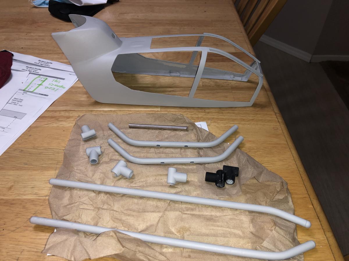

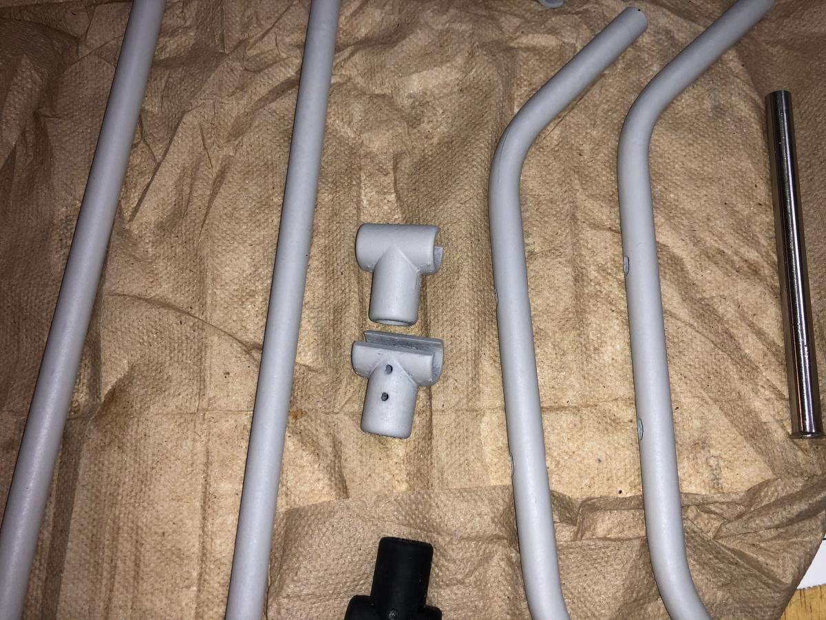

                                    I got the canopy and the landing skids primed.
                                    also the new skid adapters. I designed them with cutouts so the skids will sit flush. I also put some screw holes so I can put some screws in to hold everything tight and in place. I printed them in grey so if the paint starts to peel it won’t show black.
