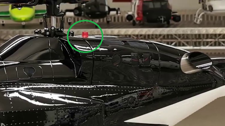

    Hi guys, does anyone know where you can get lens covers like the one show in the picture? I have been able to find clear ones at motionrc but none other than clear - was looking for some red ones. Thanks.

    Just get the clear lens and paint it with Tamiya Clear red. It's a transparent paint. You paint the inside of the lens. You can get lens as dark or light as you want you just paint a coat on it, let it dry, then add another coat if you want it darker. Just do that until you get the lens the shade you want it.
