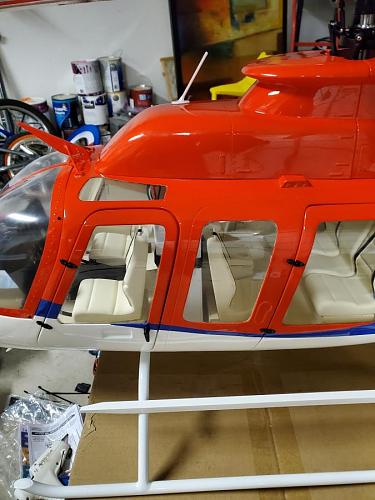

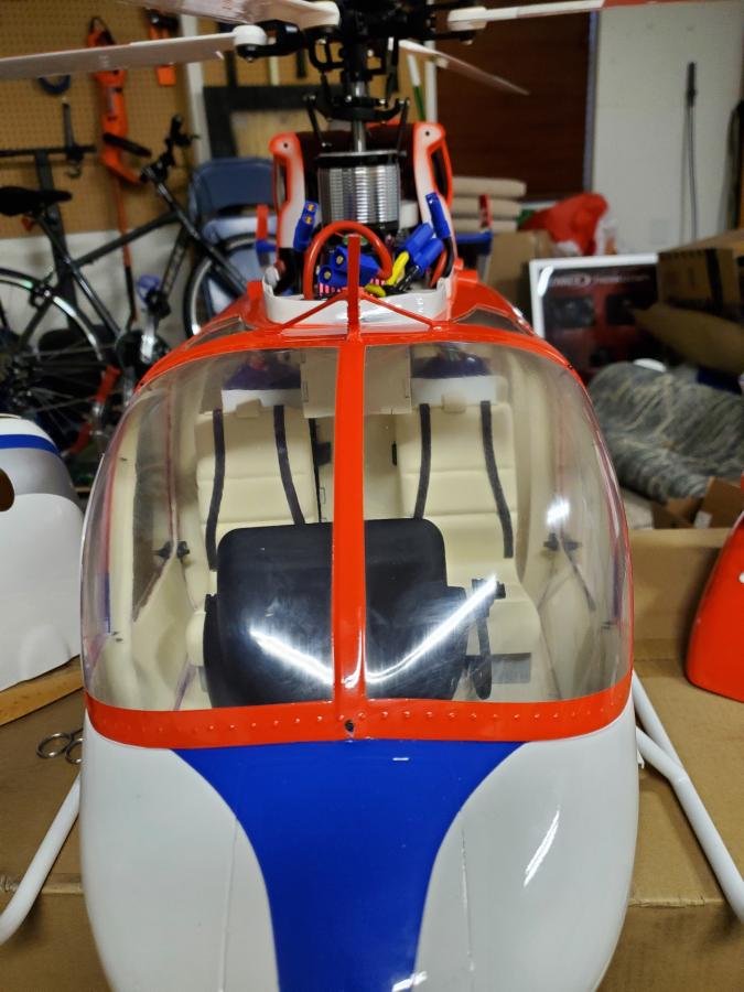

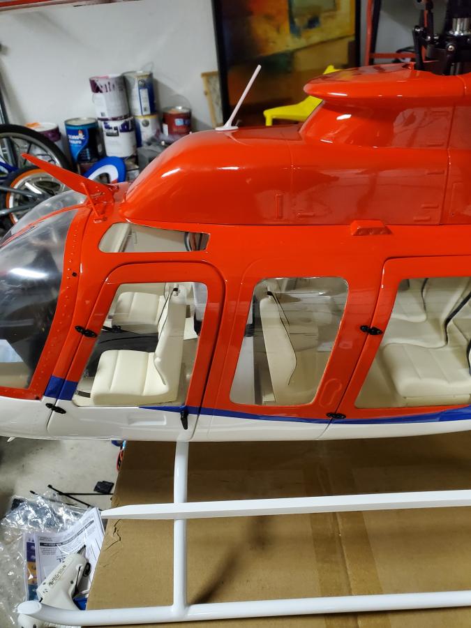

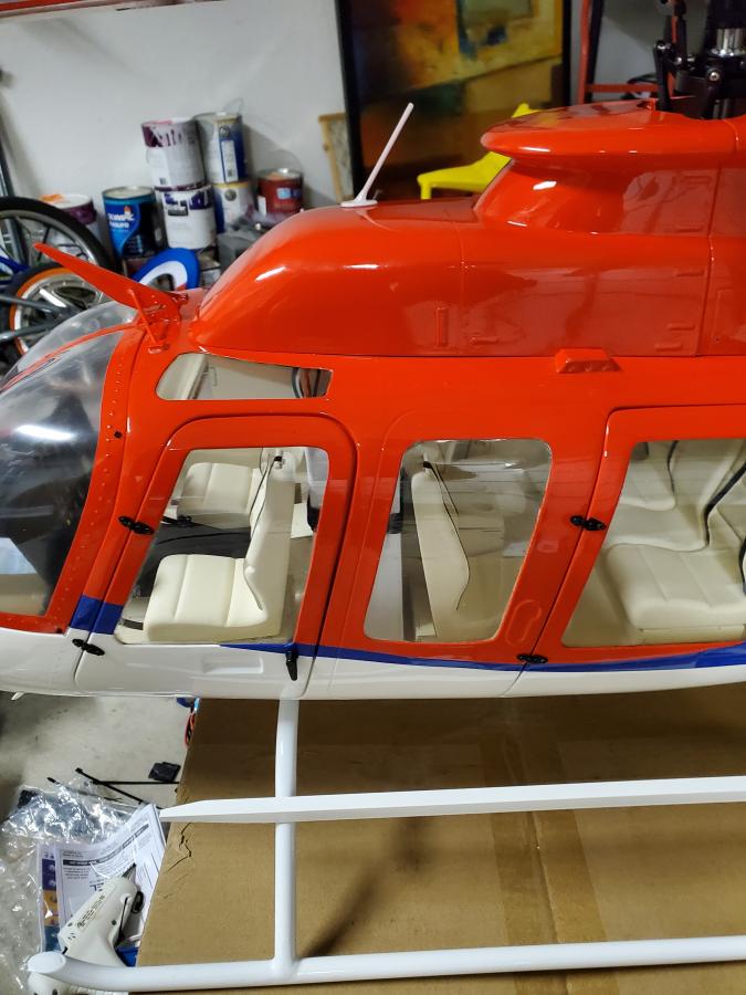

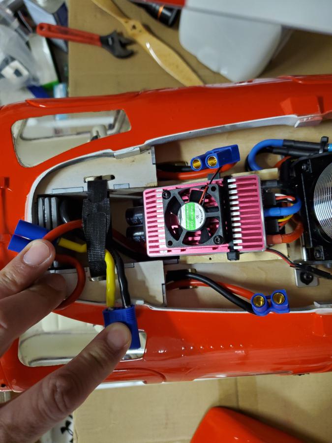

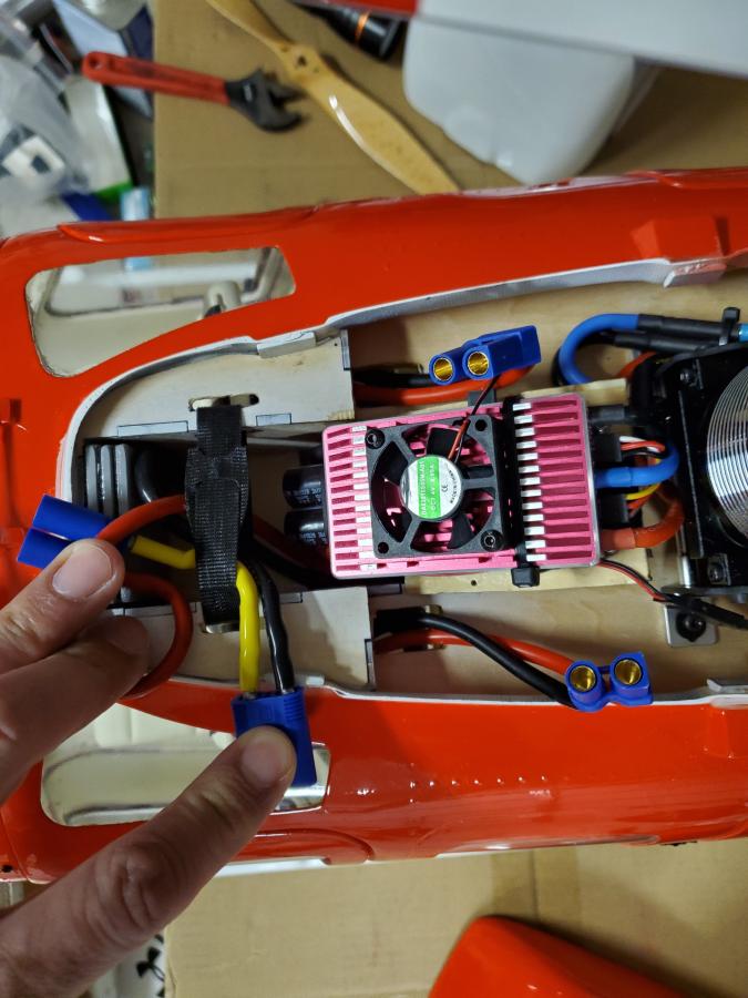

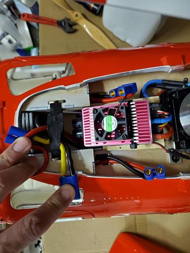

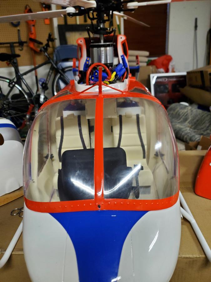

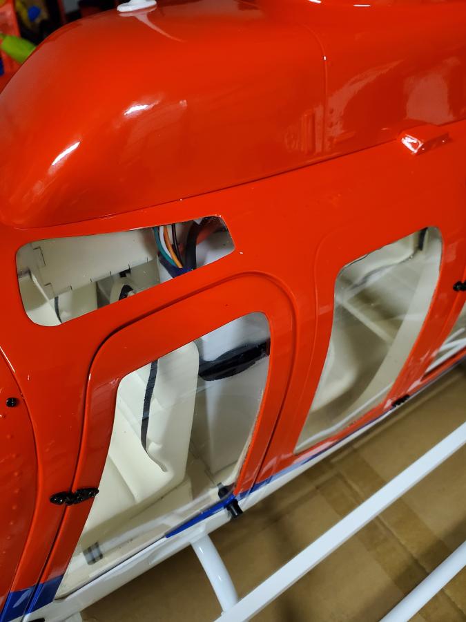

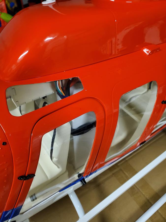

          The dimensions on those Turnigy Nano Techs are 153x49x52.8mm and they fit snugly. However, I ended up not installing them on their compartment. I could not fit my ESC on the side of the frame as suggested in the manual. It will not work on that location. You would need a very small ESC without a fan. So, I had to install the ESC upfront and the LiPos in the cabin. Covered the LiPos with white adhesive vinyl.

            Nice work. I considered lt1pwr’s solution also but wanted to keep my medical interior detail so opted to mount my CC Talon 120 in the rear and run longer wires. I did install my 2S LiFe receiver pack between the seats, ‘tho.
