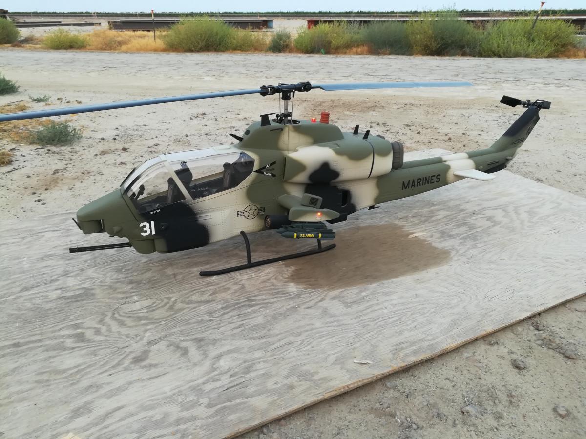

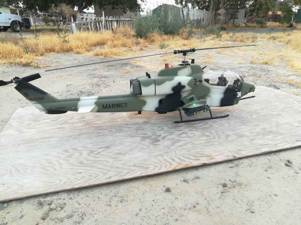

    Hey guys, got a new Roban 700 Cobra I purchased from PawPaw, he did the build on it and never flew it, awesome guy to deal with and did an awesome job on pkg to get it from Texas to Ca. safely.
    I finished it up and got if flying, flies really good and is a showstopper for sure. All I got left to do is get some pilots. Here is the very first hover with it, also a few pics and a walk around video. I did get a video of one flight but it turned out blurry on most of it so maybe next time, any questions on it just message me.

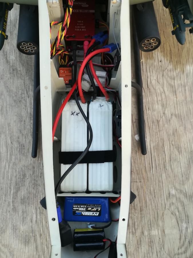

    Roban 700 Cobra MKS 1220 cyclic servos
    KST 1035 tail servo
    Kontronik 160 ESC
    Futaba R6203SB rx
    Scorpion 560kv motor
    Protek 2100mah 6.6v life backup battery
    Microbeast Plus 4.2
    Stock light controller
    Stock 800 blades with stock 105mm tail blades

              Why is your mechanics so hard to get out? I can have mine out in about 15-20 minutes maybe less, I just pop off the short tail pushrod, loosen the short boom and pull it out, remove the two stabs, loosen the front two bolts, unhook 4 wires from the Microbeast and mine are out...
                Hmmm... I wonder why I'm always using a cutting torch...
                J/k... but barely. My cobra fuselage alone made me invest in a dremel tool. I had to trim so much around the cockpit area its crazy. When I was initially trying to get the mechanics inside, I had the tail servo pointing down like the pictures, but there seem to be no way to get the right angle to get it past the bottom lip on the interior of the fuselage. So I finally rotated the servo to the top side of the boom and use a golden rod from the servo to 45 degree gearbox, and was finally able to get it mounted. Every time I put the tail cone fuselage on, it feels like I'm just on the verge of cracking something trying to get the gearbox all the way thru.
