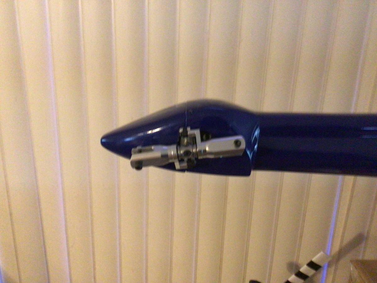

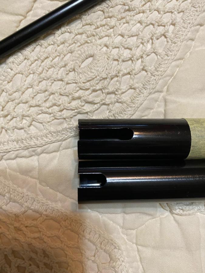

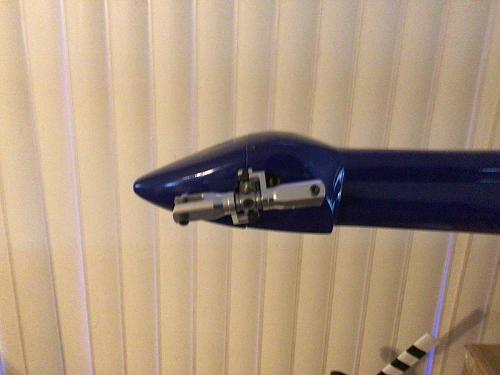

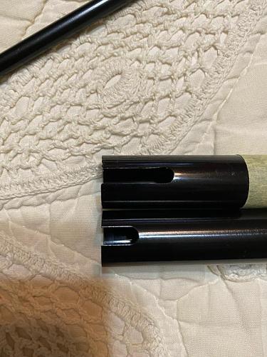

The builder will need to purchase a Trex 700E torque tube and torque shaft for the 600 mechanics. The good news is the 700E torque shaft is a drop in fit, but the builder will need to modify the 700E torque tube to attain proper positioning of the tail rotor housing in the tail boom. This required less than an hour to do with a tubing cutter and Dremel on mine, using PhoenixTech 600 mechanics. Chaos 600 should be the same, but Trex 600ESP may be different. Per the photo, the Align 700E tube has a more shallow positioning slot than the 600 tube so the 700 slot needs to be cut longer to match. For my PhoenixTech 600 mechanics, 29.4mm was required to be cut off the tail end of the 700E tube (not the slotted end!) to center the tail housing in the tail boom cutout. Again, I can’t say how much (if any) will need to be cut if using Trex 600 mechanics.
