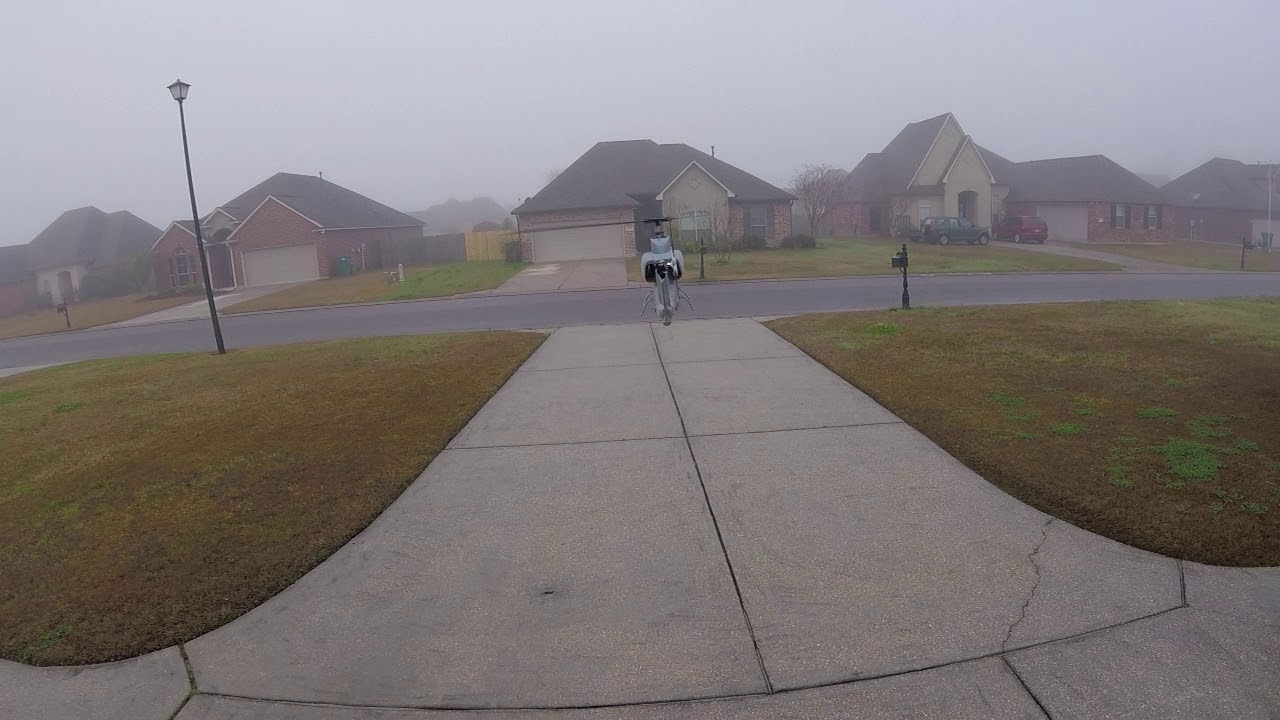

      Well obviously it's a subjective thing to try and judge by sound, but I would say the Apache in the Roban video is in the ballpark of 1200-1300ish. I don't have a 4 blade to compare too (yet... have a EC-135 waiting on me lol).
      Here's a video of my Cobra. When I take off I am 1250~rpm; around the 1:32 mark I switch to Idle Up 2 which is 1350~. I get a 'little aggressive'... All things considered cool foggy morning, 750mm blades x2... The 1350 Cobra to the Apache video sound similar to me.
