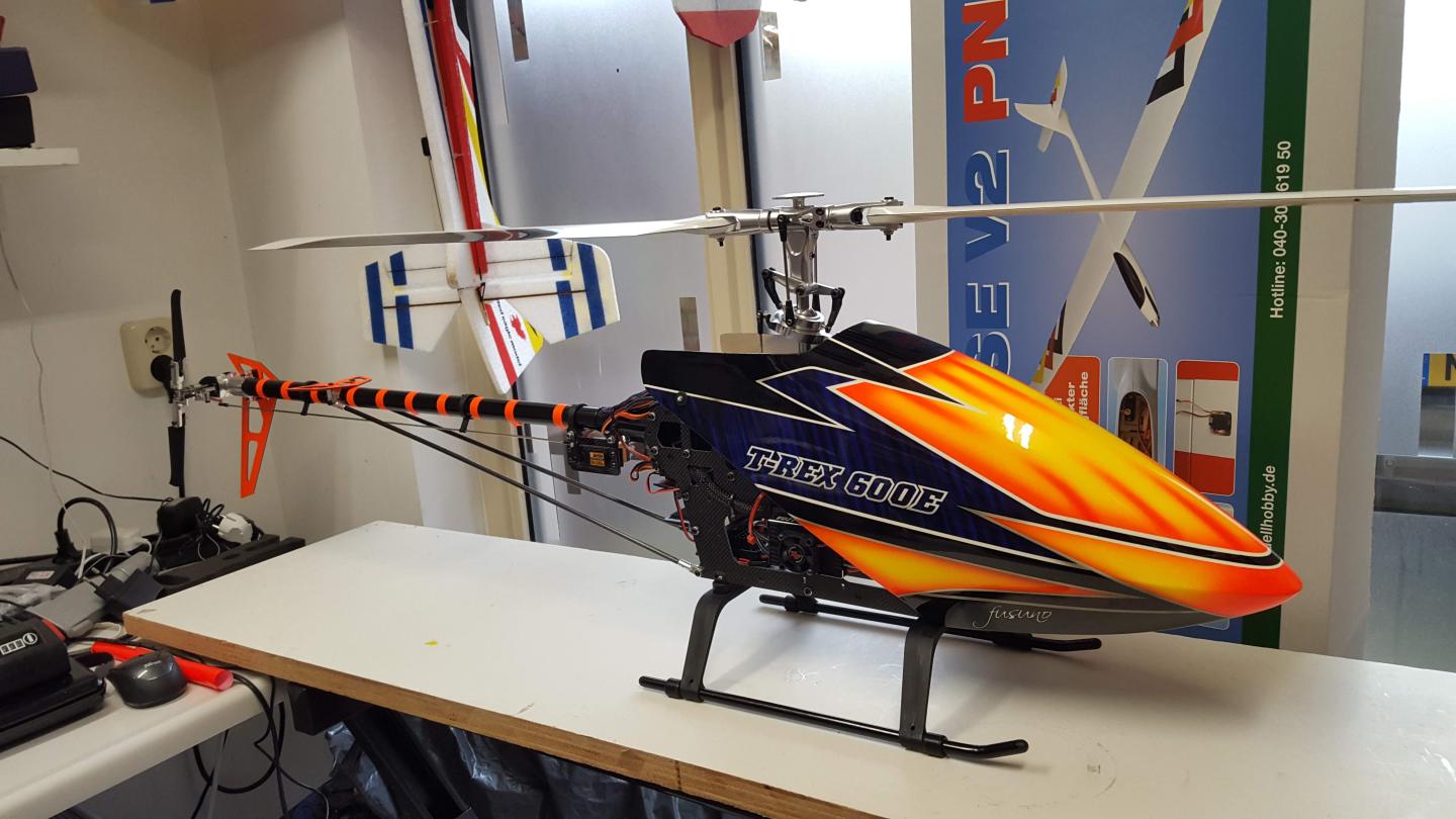

    You can combine most of the parts , the width between the plates are bigger when you have flasher/phoenixtech mechanics
    I have the flasher mechanics now in a 212 fuselage and the quality is good for the price
