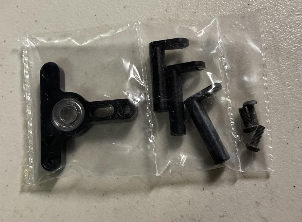

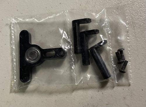

    I've begun building my Roban B429; can't seem to find these parts in documentation. Can anyone shed some light as to what they're for???
    Could this be a packing mistake???

    It’s not in the documentation, but it is a shaft support for the pulley. Scaleflying.de has a video of the installation here: https://youtu.be/iEqE7KebqmY.

      Thanks F106DeltaDart; like to have mysteries resolved to avoid disassembly!!!

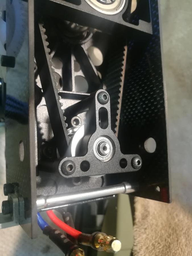

        Yep, that part had me scratching my head as well when I built my first Roban Hughes 500D, you will need a long shaft motor for it to fit properly and help support the motor, I had to purchase another stock shaft for my Align 750MX-450kv to get the support bracket to work, someone had cut down the shaft on the used motor I bought for it.
        Here is my 700 Cobra mechanics with the bracket installed, hope this helps you too.
