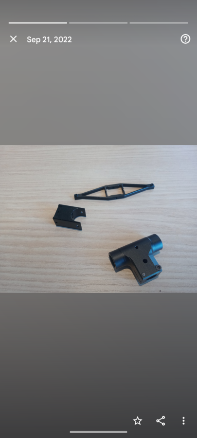

      This is what I actually received in the package along with a flybar that has round weights on the ends and assorted screws.

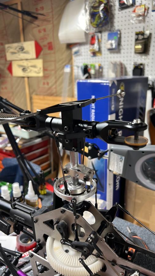

        This is the end result AFTER I ordered a Roban two blade rotorhead and installed the dummy scale rotorhead parts onto it. That of course set me back another $99.

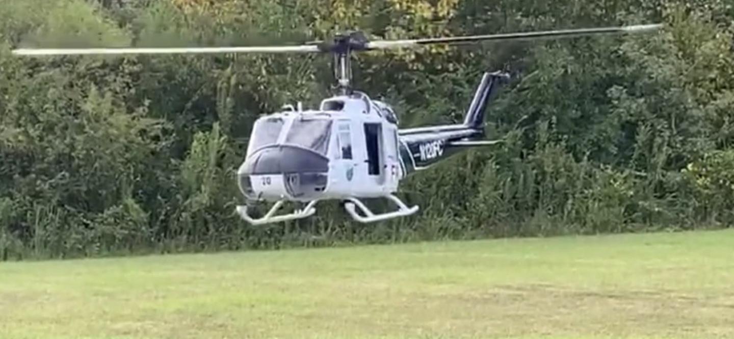

          Prior to installing these mechanics back into my Huey I had a buddy who is a great pilot test hover it for me due to high winds which at least were partially blocked by my privacy fence. I installed a demon 3X flybarless gyro and since it’s the first one I have done I was hesitant to try the first test flight. Turns out the head flew awesome and will really look the part in my Huey.

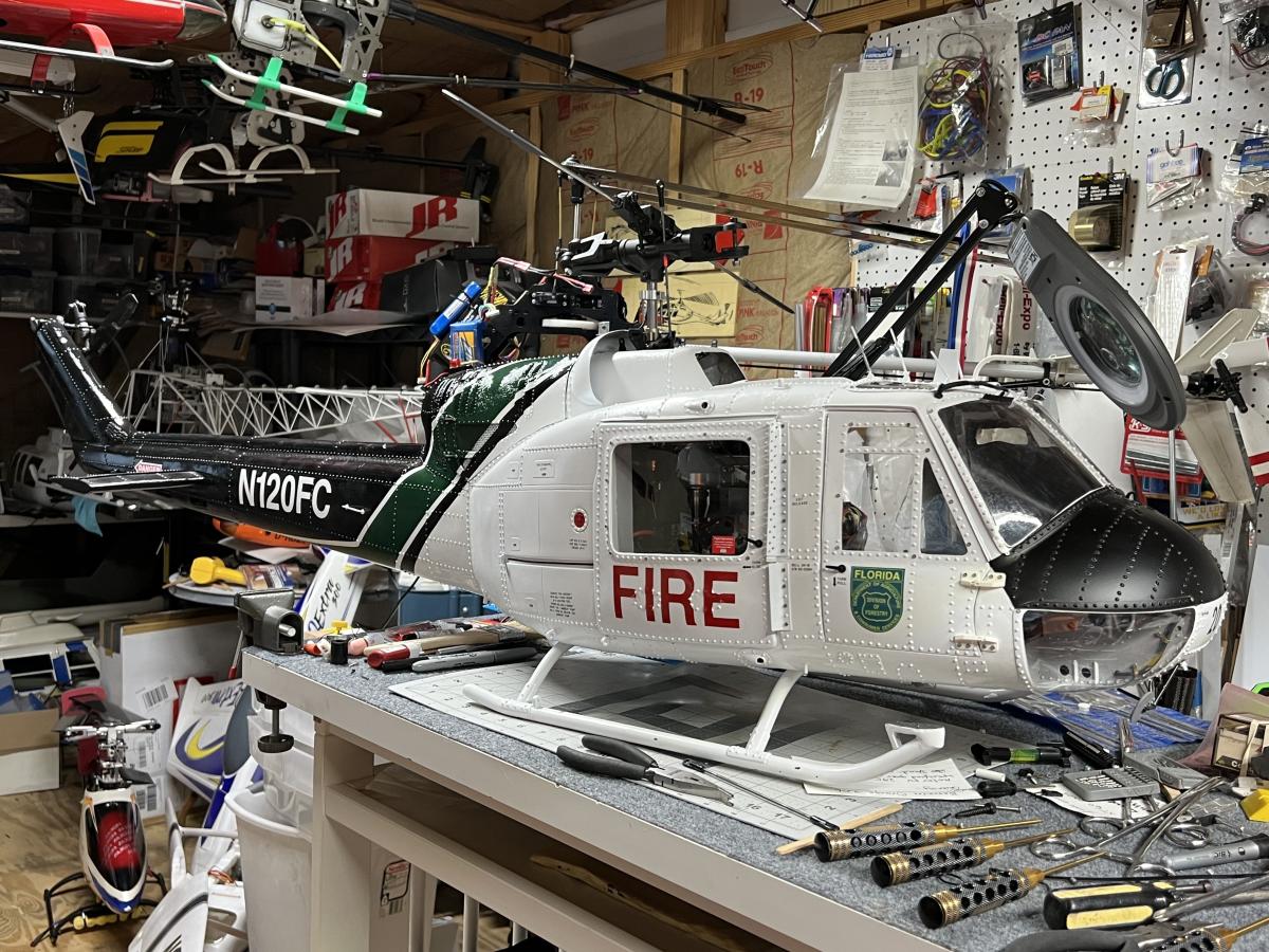

            That's a good looking fuselage! Where did you get it?

              Thanks
              That is a Unique Models fuselage out of Dalton,GA. It is very scale accurate and comes bare and I handmade all the scale details to include all the hand laid rivets.
