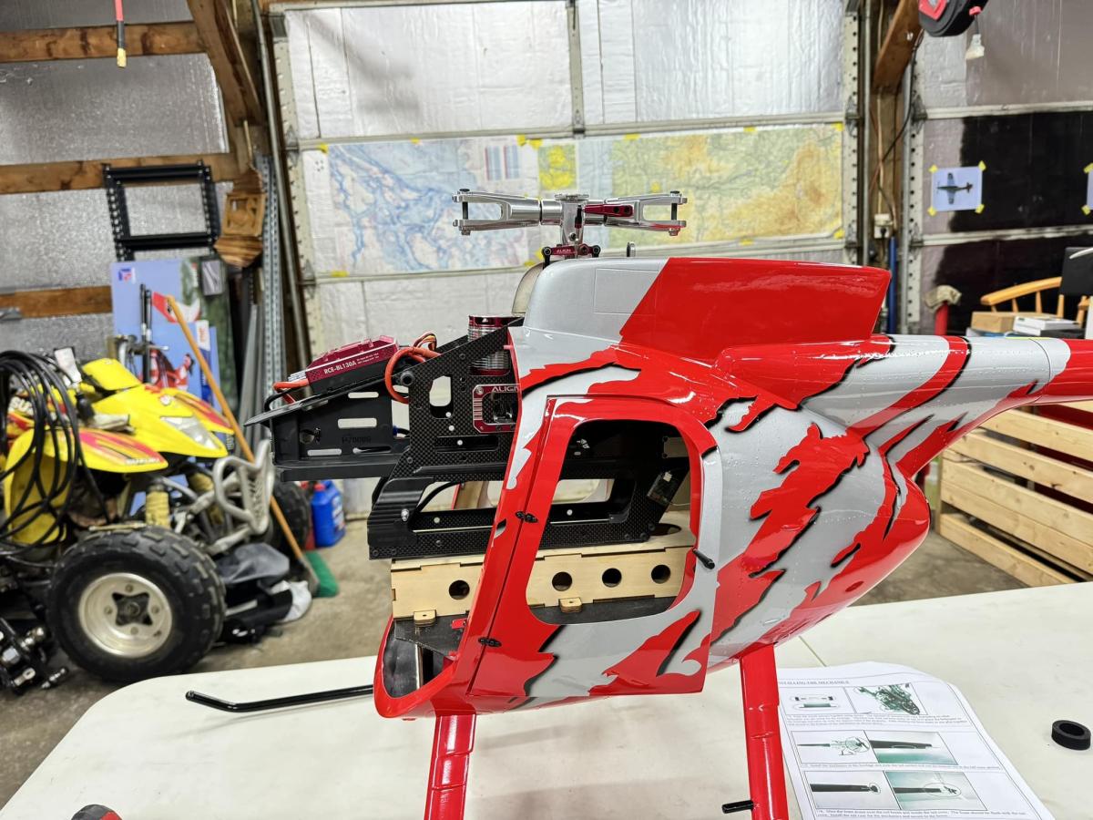

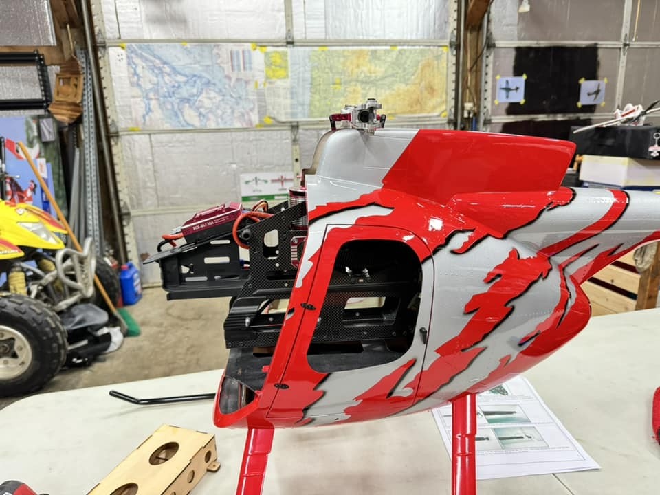

Putting a Trex 700l into this fuse, and I am looking for some info on extending the mainshaft, stock is 12x194.1, and as you can see if I space up the mechanics so the blades are close to high enough, the nose wont fit on as itll hit the frame and motor. If I drop the mechanics enough to get the nose to fit, the blade grips hit the top of the doghouse. Anyone else extended a head? I am assuming Ill need the mainshaft, and 3 linkages to the servos, but what about the anti rotatation thing on the back?
