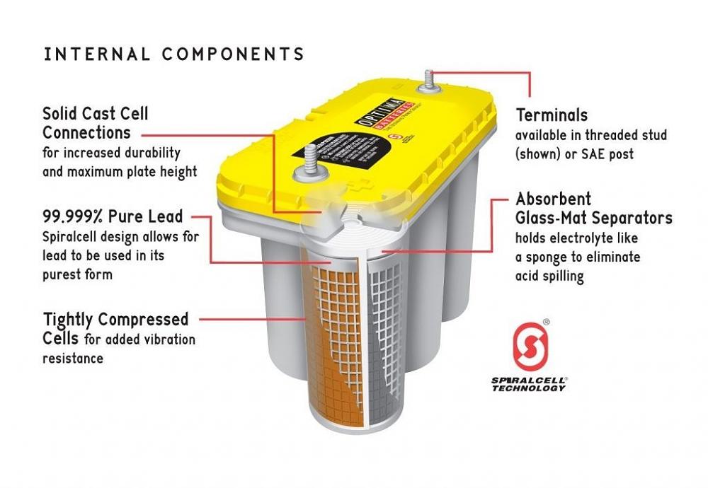

                      I'd recommend a deep cycle, AGM battery. CCA won't be as important for a non-starting battery, though if you plan to use it as your standard battery as well as for charging your RC devices, it would be best to get both. I personally would recommend the Optima Red Top or Yellow Top battery as the best car battery for field charging. If you have enough of a need, you might consider getting one of these in addition to your regular car battery. It can be wired into your trunk, inside of a vented battery box and will be charged by your alternator but won't take away from your starter battery. This is common on performance vehicles and aftermarket stereos to handle the increased load.
                      Best Car Battery
