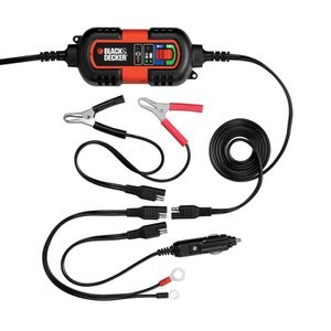

                    This is what I've been using for the last 3 years. 18 bucks at Pep Boys.
                    Mike Click image for larger version

                      The recommended B&D is only a 1.2A max charge and would take 24 hrs+ to bring the same 60Ah battery back to full potential. It is essentially a "maintainer" type charger.
